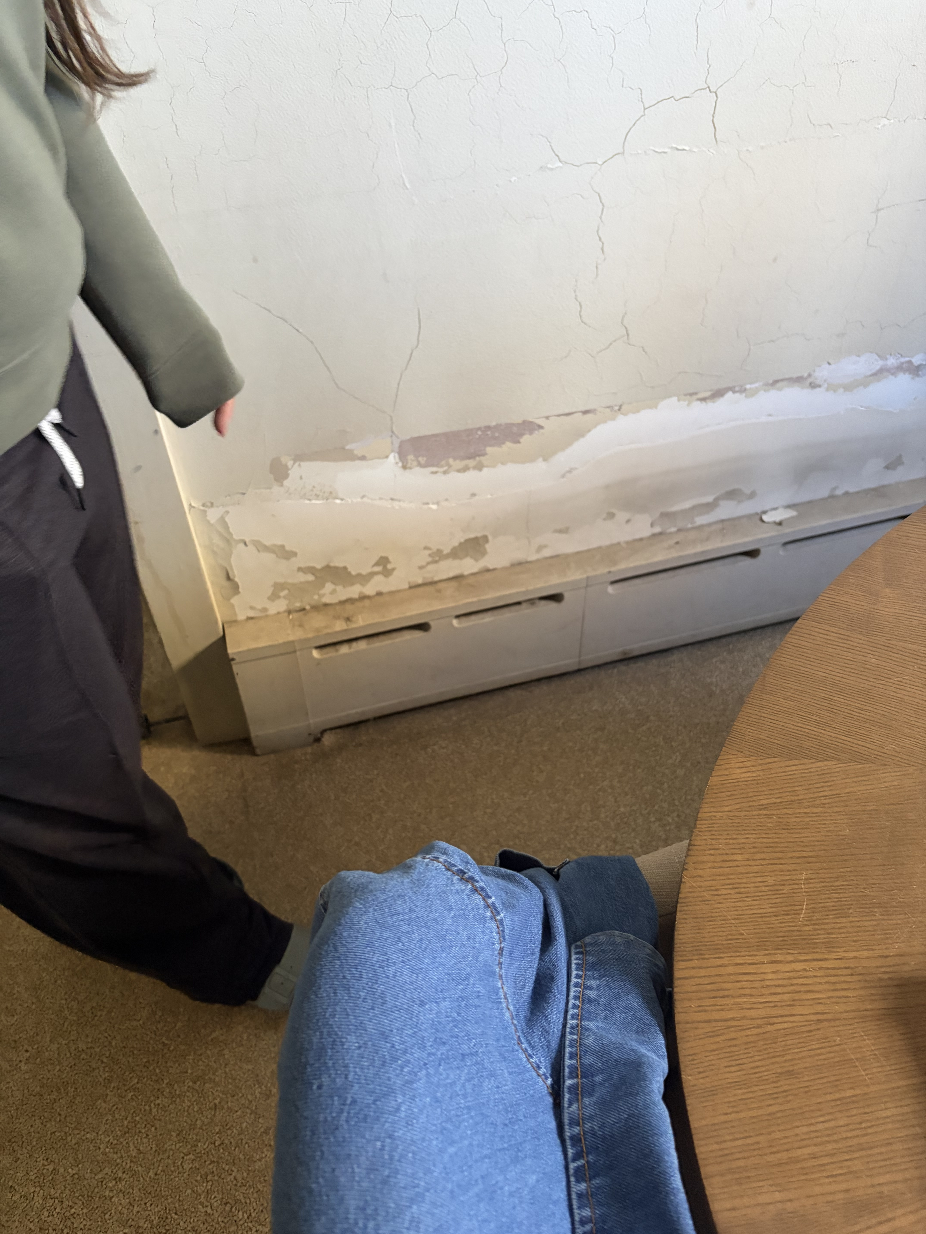

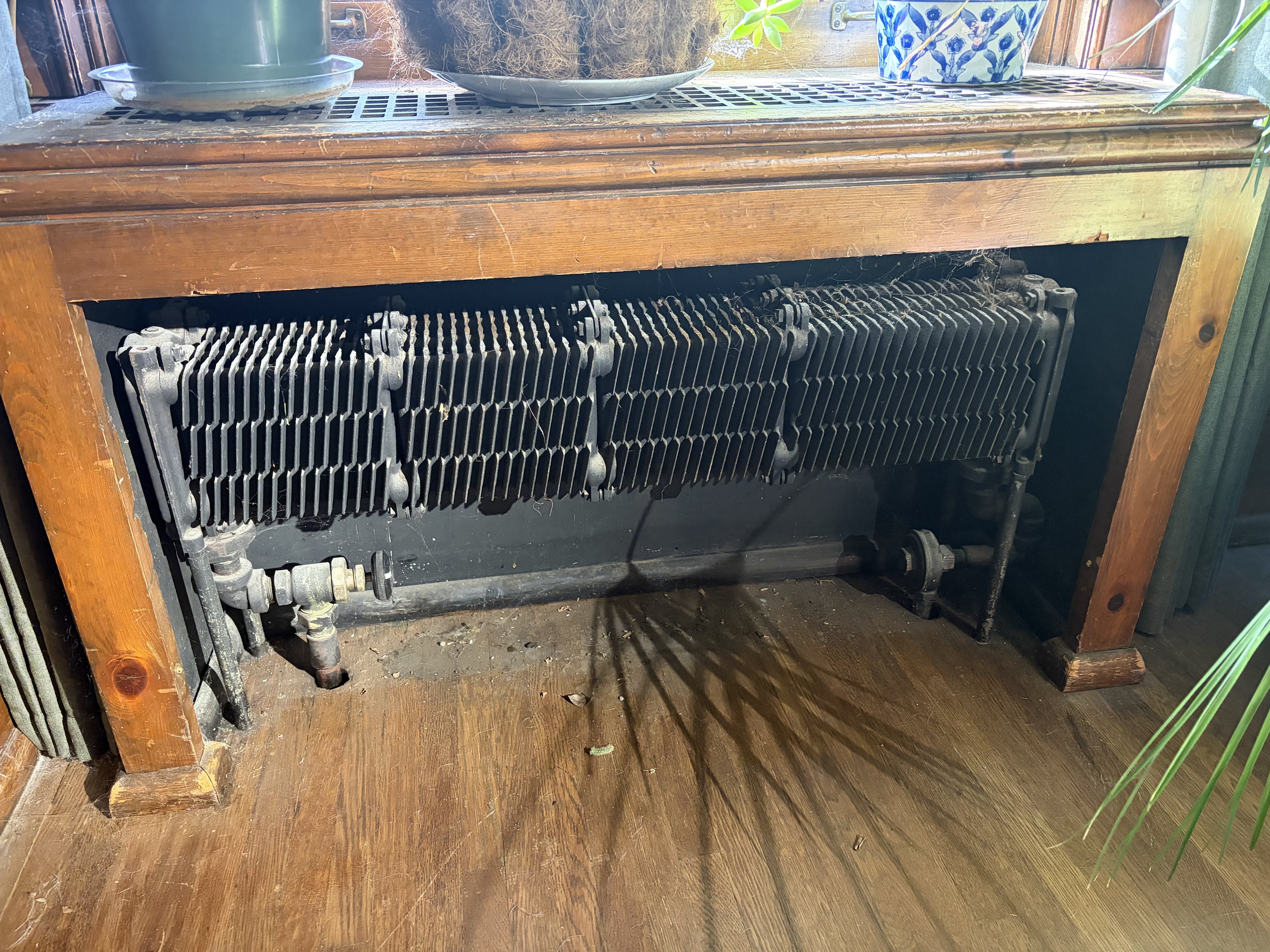

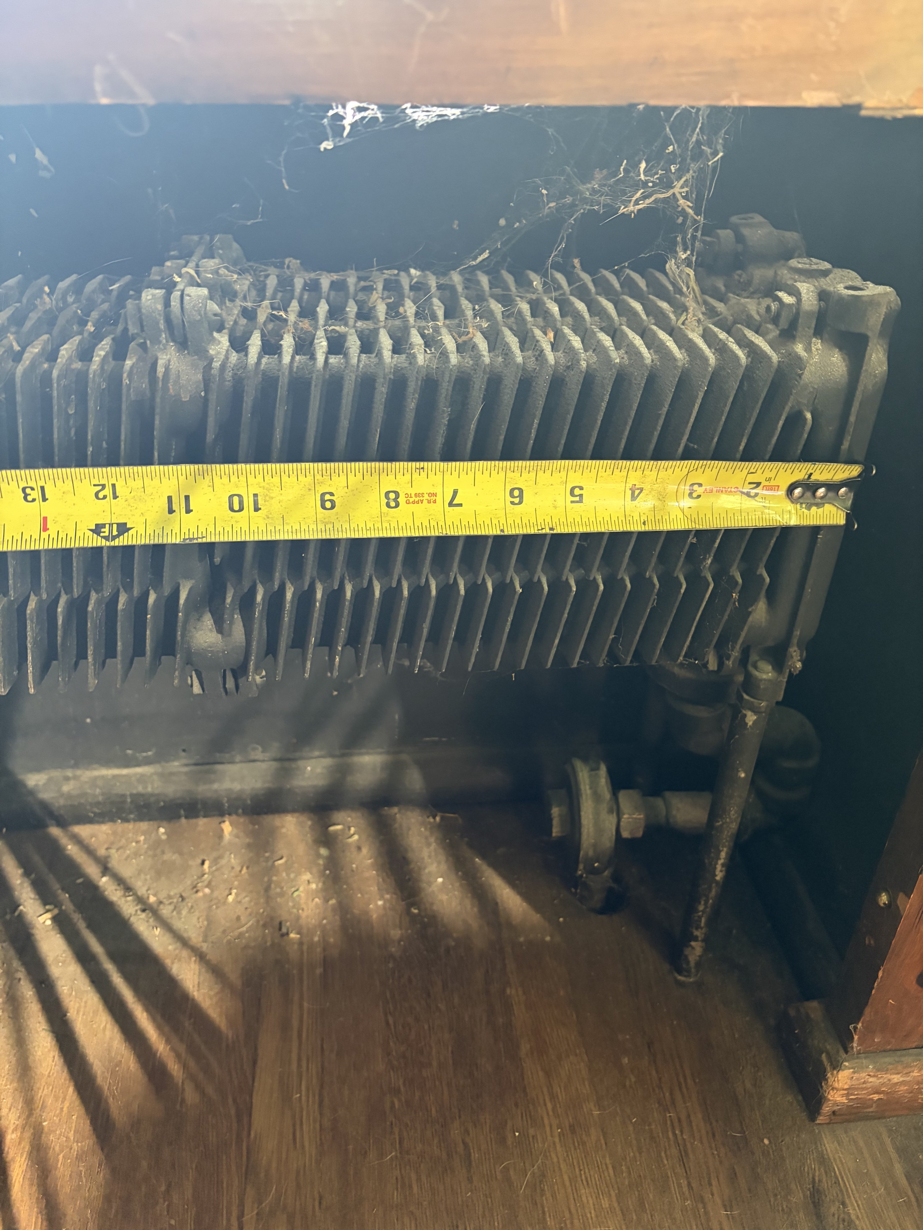

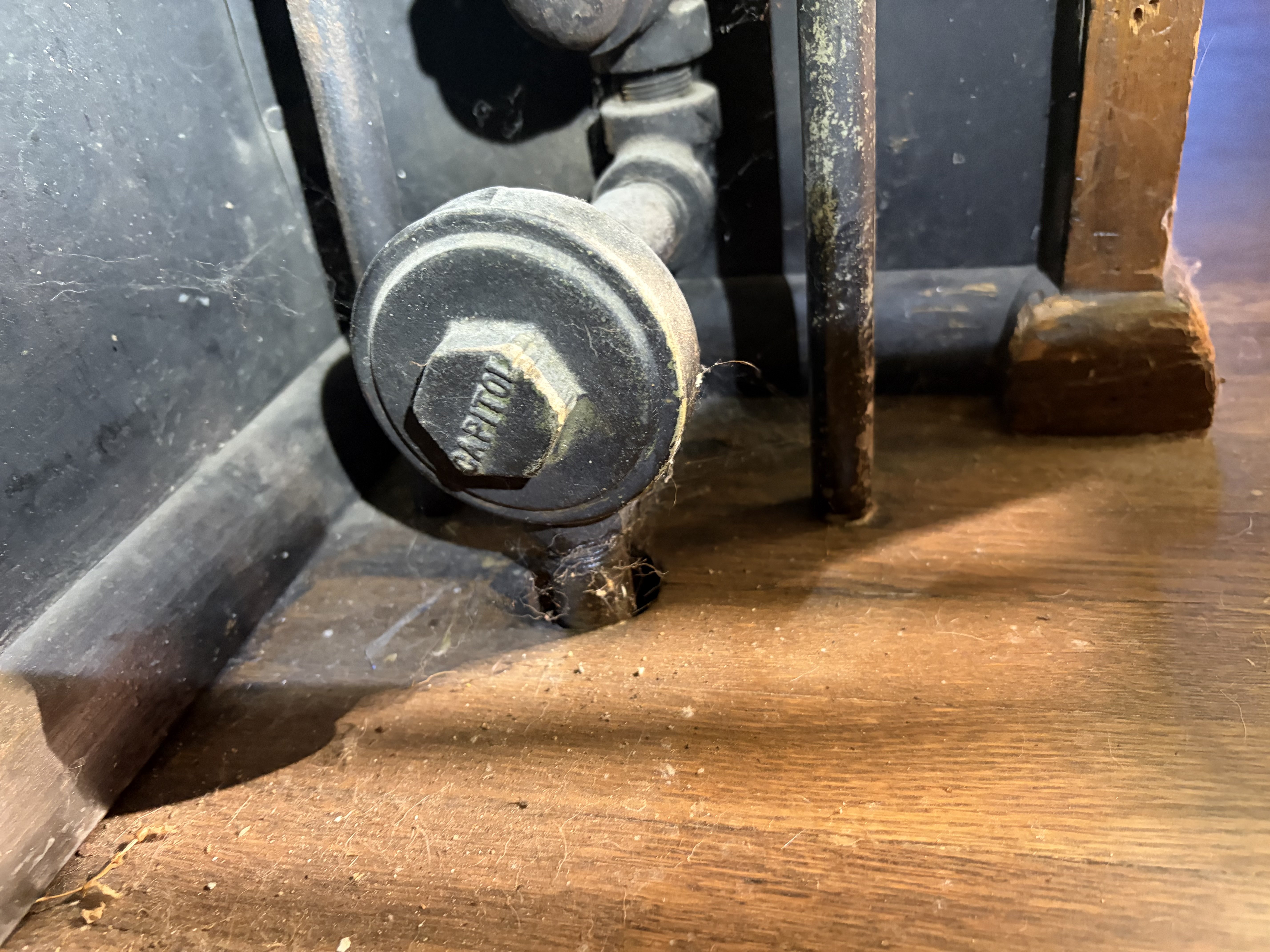

hey all. I have an old Moët vapor system that I’m working on that mainly has original column radiators throughout the house but in two rooms there are radiators with traps. I’ll include photos. The kitchen was re done in the 70’s and they put in cast iron base board with traps. I’m guessing the traps should not be there since it’s vapor. Also in an office there is a unique radiator type that I have not seen before that also has what looks to be old traps. I plan on using Orphase plates as some of the hand valves have need replaced and would also like to remove the traps at the same time to keep my “A” dimention down. If you could help me identify the radiator type and let me know if they should have traps that would be a huge help.
    having traps on a vapor system won't hurt anything as long as they are good or failed open. they should never do anything if the pressure is kept under control and the vapor valves are set up correctly or they have orifice plates. I would encourage you to rebuild the original valves if at all possible.
    that "radiator" is a pretty standard convector cabinet with a cast iron element, although I don't know the brand. The cabinet acts as a chimney and is vital to getting the rated output of the convector.

    ok thanks for the info and that makes since. As for the base board unit would the theory be the same?
    it is the same but you maybe have to be a little bit more carful about not getting condensate trapped in the baseboard. still not the first thing I would think of if a CI baseboard isn't heating on 2 pipe, but it is a lot more likely to be a problem than on a standard CI radiator because the passages are so much smaller.
    none of the returns should be steam hot, if you are having trouble with things not heating or banging looking for that and fixing it is the first step.
    Don't bother to remove the traps unless they are failed — and then you just have to replace the element, not the whole thing. As @mattmia2 said, having them wont hurt anything — and as I said just now in another thread, the key to a vapour system is keeping the pressure differential where it belongs; a vapourstat set at 7 ounce cutout or less, and a 3 ounce differential usually works.
    If you have original vapour valves, don't replace them. In fact, don't touch them until you find out that someone else has messed them up. They were probably set correctly in the beginning, so leave them alone.

    AFAIK, the Mouat system used special return fittings on the radiators. These had small water seals in them that kept steam from reaching the dry returns, and small holes that vented the air. Thermostatic traps will work in this system, but you want to keep the air throughput low so the rads with traps won't overheat. One low-throughput trap model is the Hoffman #17C.
