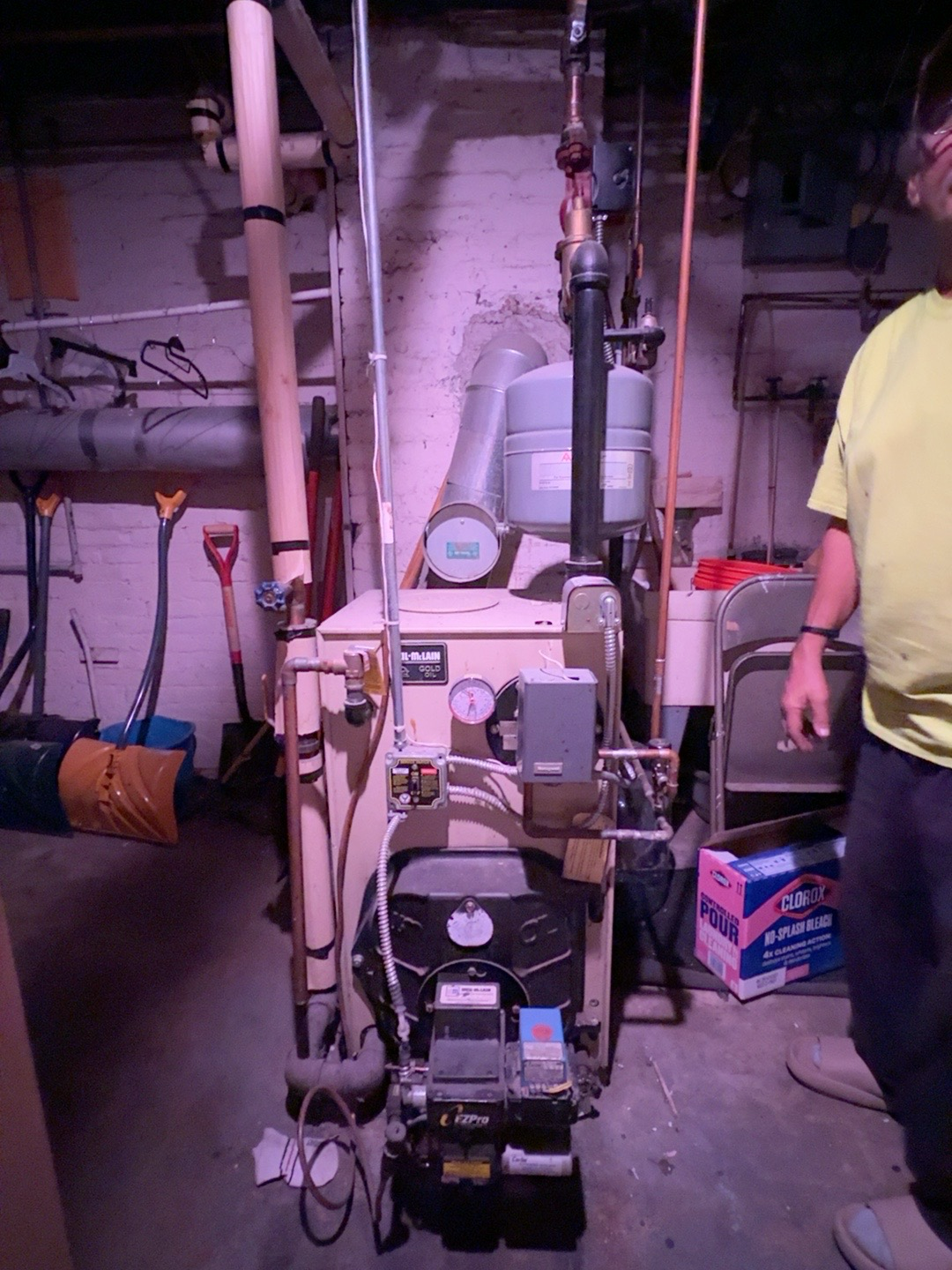

boiler keeps energized for heat call

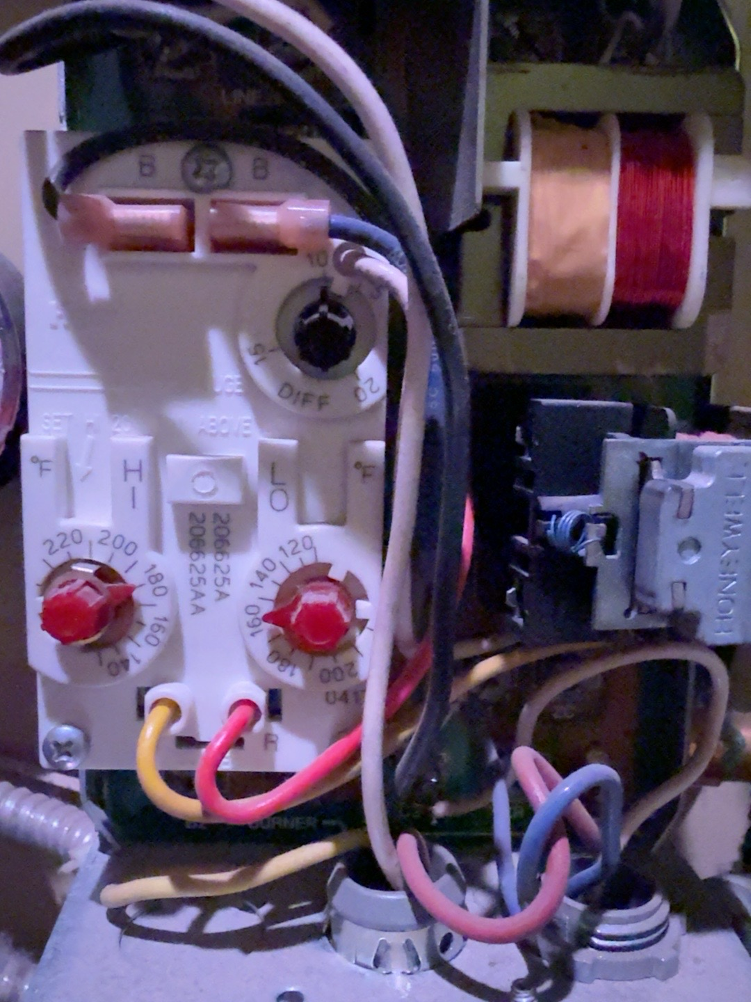

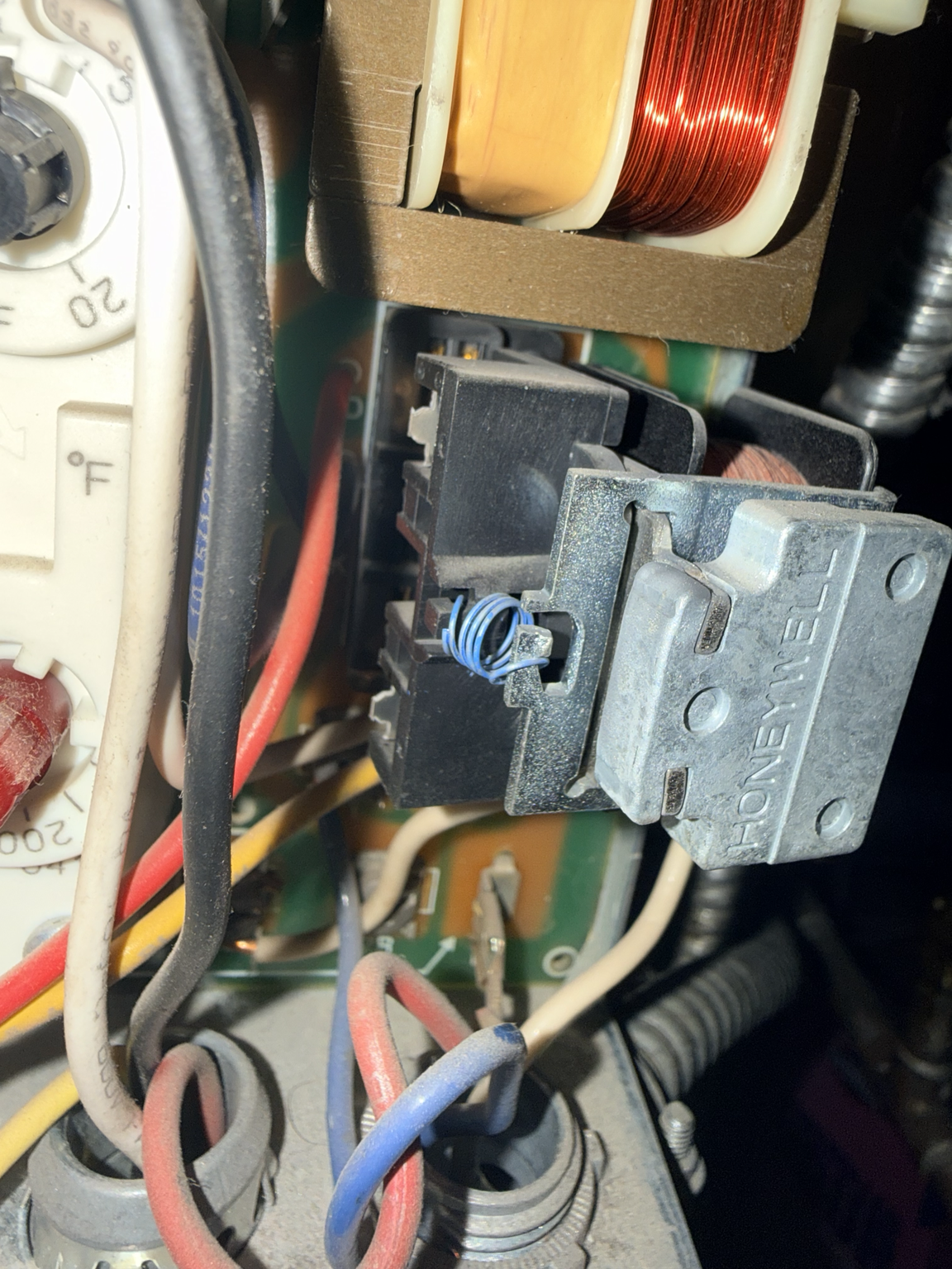

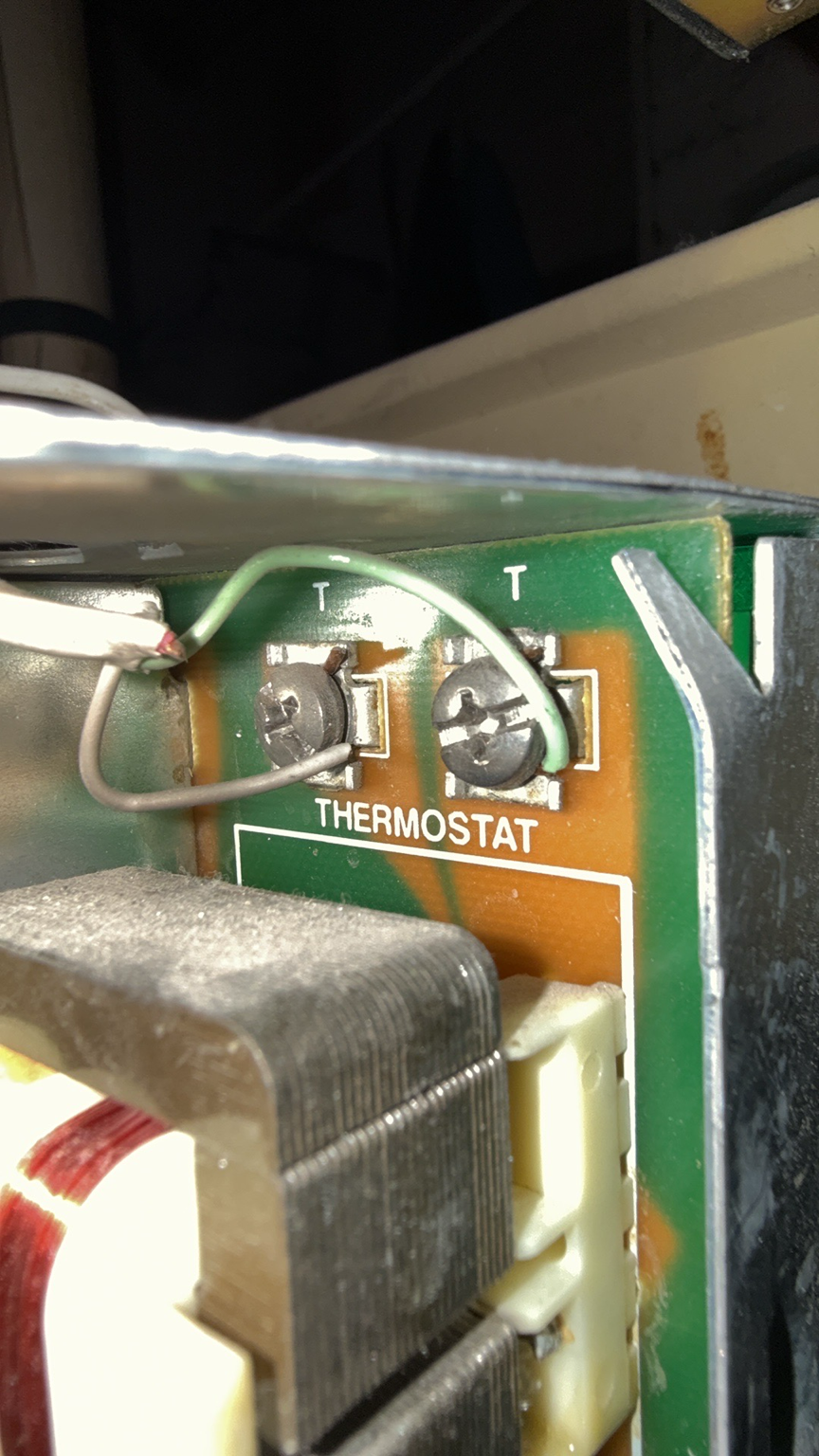

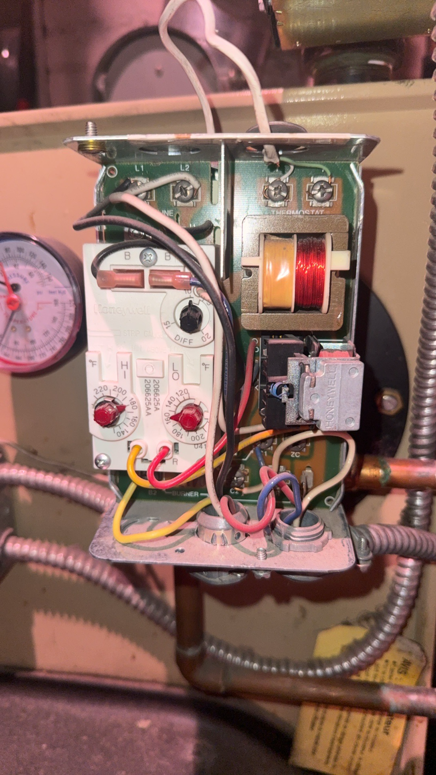

I disconnected the thermostat and the two T-T on the limit control. The boiler and the circulator both keep energizing and calling for heat. I noticed the relay doesn’t engage, I don’t hear a click, and the armature doesn’t pull and magnetize, but as soon as i put the power on the boiler it engages and acts as if it would be
    109A_5 Posts: 4,759
    The relay contacts may have welded or the return spring may have failed. Some wire touching something it should not be touching.
    Boiler Make and Model, Aquastat Make and Model, pictures may help.

    If you've got a meter you can make sure there's 24 vac at TT in the switching relay proving the thermostat circuit is open. Then check 2 to 4 on the relay (4 being hot going to the circulator?) to see if there's 120 vac. If there's is 120 vac at terminal 4 while TT is open, the relay is shorted. The old clapper had a good life.
    Disconnect one of the wires on T-T at the burner control. The boiler should not fire. OK? Now reconnect that wire and go to the other end of the two wires which connect to T-T at the burner. Disconnect one of them. The burner should not fire. OK? The voltage is irrelevant.

    So the relay is not pulling closed? but you hear the pump, and is the burners firing?

    This sounds like a relay contact is welded closed. Try exercising the relay manually and electrically several times. If that doesn't solve the problem, the relay should be replaced.
    Don't purchase the same type. Get an electronic relay instead; they are less expensive.
    Hydrolevel 3150 or Honeywell L7224C which is the lowest cost

    Yes the relay doesn’t pull closed. But the pump and fire burn simultaneously. I can’t breathe in here lol

    This. The only way I can think of that the pump and burner will fire is if the contacts at the relay are made either in the relay itself or behind the PCB.
