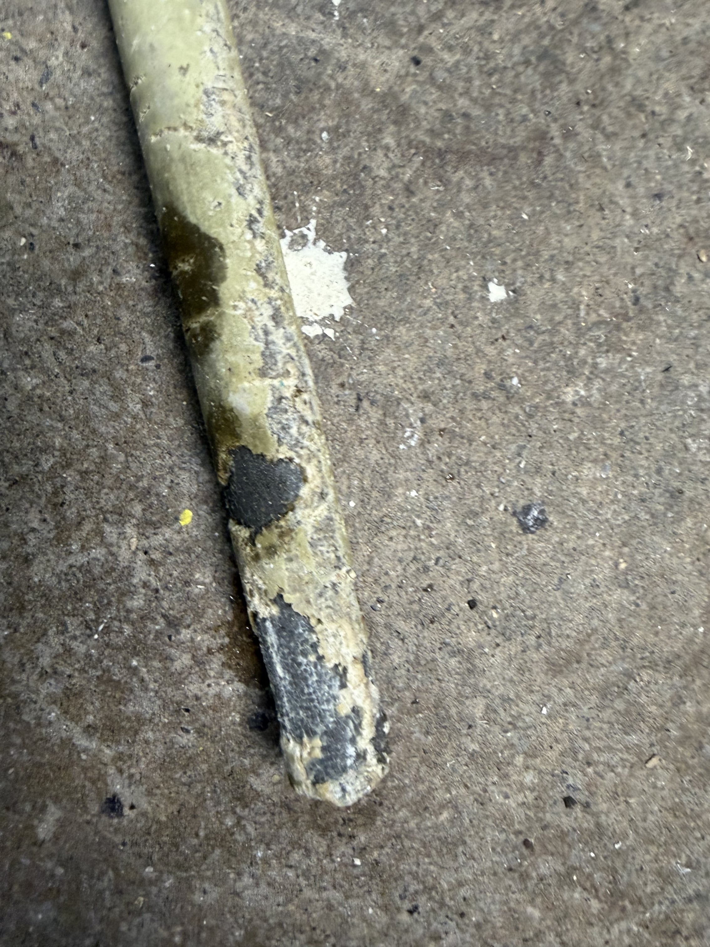

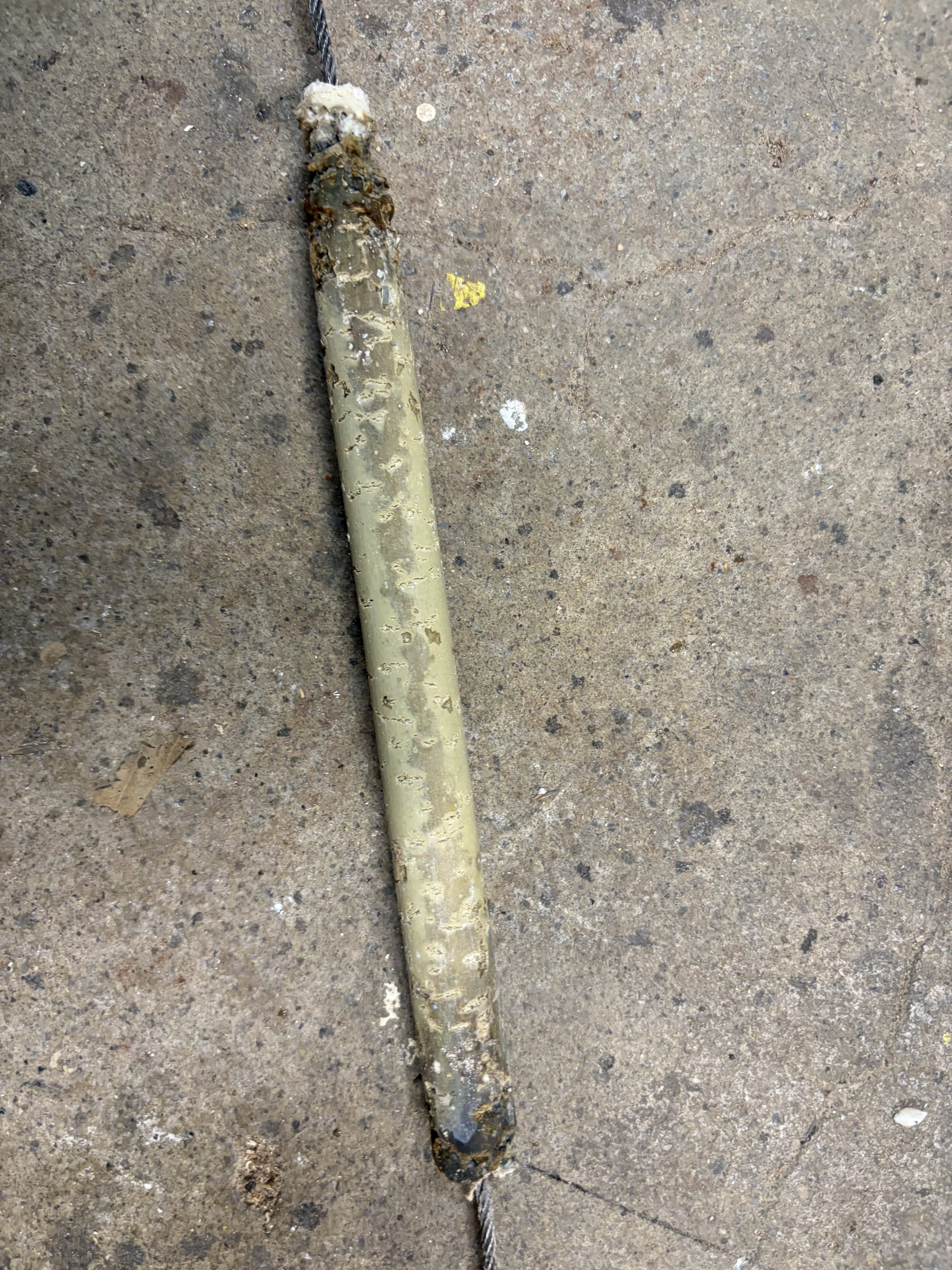

i replaced this anode after 18 months thinking the metal had been completely replaced by some sort of mineral/sediment.
after replacing i took a hammer to the crust and found the metal is somewhat intact under 1/8 inch of crust. Do these things still protect like they’re supposed if completely encased in sediment? Just curious for next time I open it up to check on it.

    Yes — the sediment isn't waterproof! And certainly not negative ion or electron proof — and that's what the game really is.
  • Hi, That could be a passivated rod. When the water is pretty clean, the anode can coat over like that. So, if the water has low TDS, I'd consider a powered anode.
    Yours, Larry

    passivated eh? I learn something new every time I post on this forum!
    I don’t think it’s particularly soft water. Philadelphia suburban tap water. No softener. Tds somewhere around 250 last I checked.
    ill look at the powered anodes next time i am going to flush it and take a look inside. I assume the new rod I just put in will do the job for a while.
  • Hi, As long as you used a magnesuim anode with no resistor built in, it should be doing some good. 250 TDS should give sufficient conductivity. 👍
