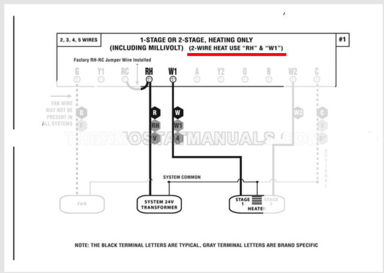

    I am installing a Lux TX9100Uc battery powered thermostat to replace a Lux 9000.
    It is only 2 wires. I would have sworn on my children that I had the wires right, but this is now happening: I had the thermostat programmed to activate the boiler at 65 degrees. It was in the mid 70's, so no activity, as expected. Then, when it got to about 70, the heat turned on! I was surprised, but not as surprised as I was when it got up to 79 degrees. It wouldn't shut off!
    I shut the circuit breaker off and shut down the electrical to the boiler for good measure, and that eventually stopped it from running the boiler.
    There is a pre installed 'jumper wire' (?) from the 'RC to the 'RH' terminals. The 2 wires that ran the old thermostat are black and white. I connected the white one into the 'RH" terminal which already had one part of the jumper wire, and the black wire to the 'W1' terminal. This was the configuration under which that scenario occurred.
    My question is, what happens if I reverse those wires, putting the black to the 'RH' terminal and the white to the 'W1' terminal? Again, I would have sworn I had them right, but that is the only thing I can think of to try at this point. Is it a 'no harm, no foul' situation, or am I going to need a whole new whatever if I try this? As they say on Game of Thrones, 'winter is coming!' Help! Thanks so much.

    EdTheHeaterMan Posts: 12,996
    edited October 16
    After taking a close look at the manual for the LUX 9100 thermostat, I believe there is one instruction that you need to follow. It is even posted on the wiring diagram for a Heat Only system.
    I have made all the other terminals faded out. The heater is a one stage system and the RC is not necessary. If you connect the wires this way the system should work just fine. If it does not, then there are too many adjustable settings to go thru, so I might use the HW RST Hardware Reset feature to start over from scratch. If that does not work you can try the SW RST Software Reset to remove all user entered variables and put them back to the factory default.

    Ed the heaterman, that is the diagram I used, simply those 2 wires. It couldn't be any simpler, right?
