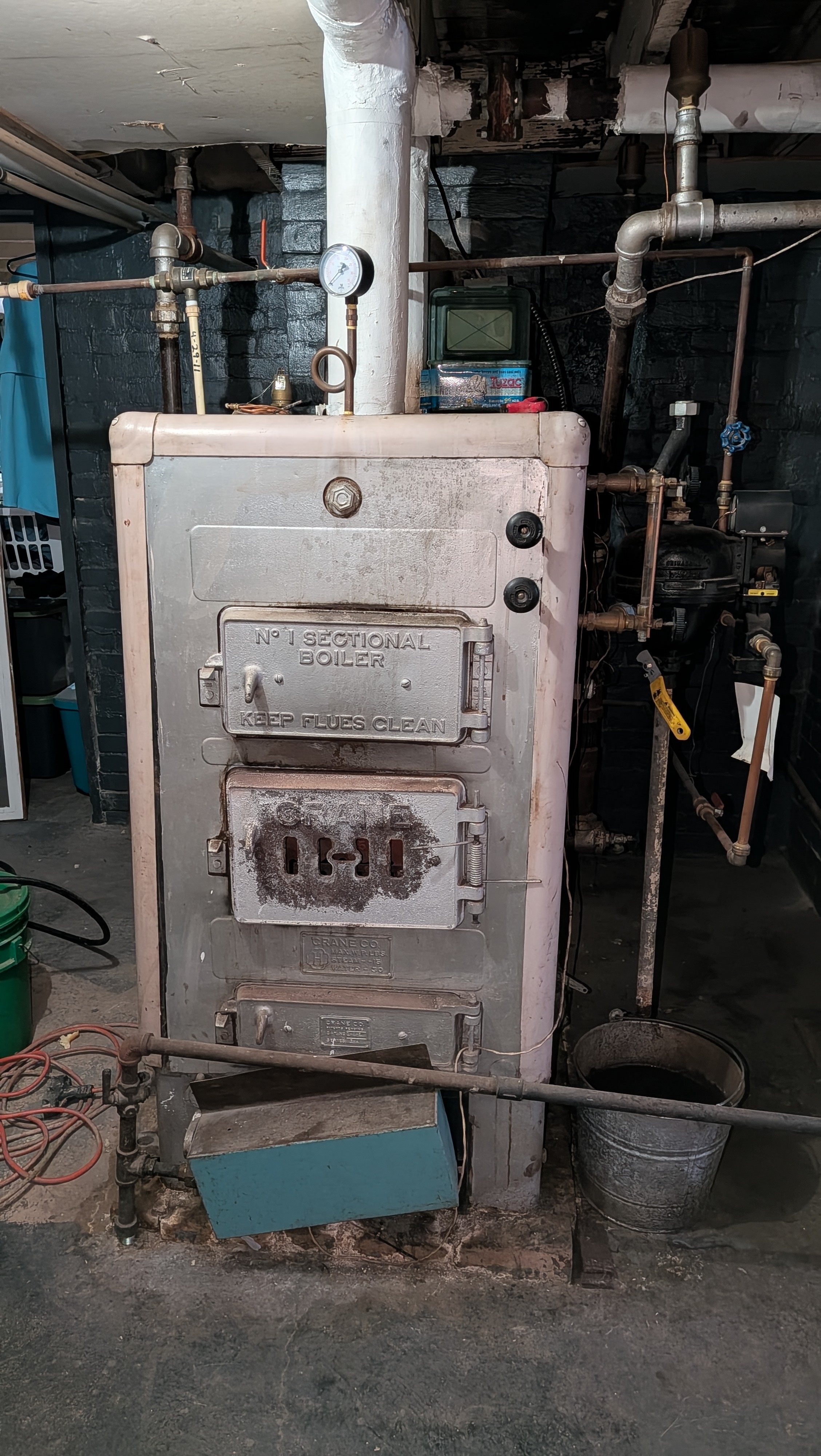

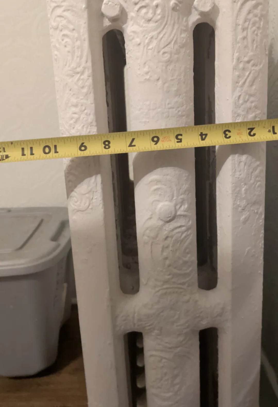

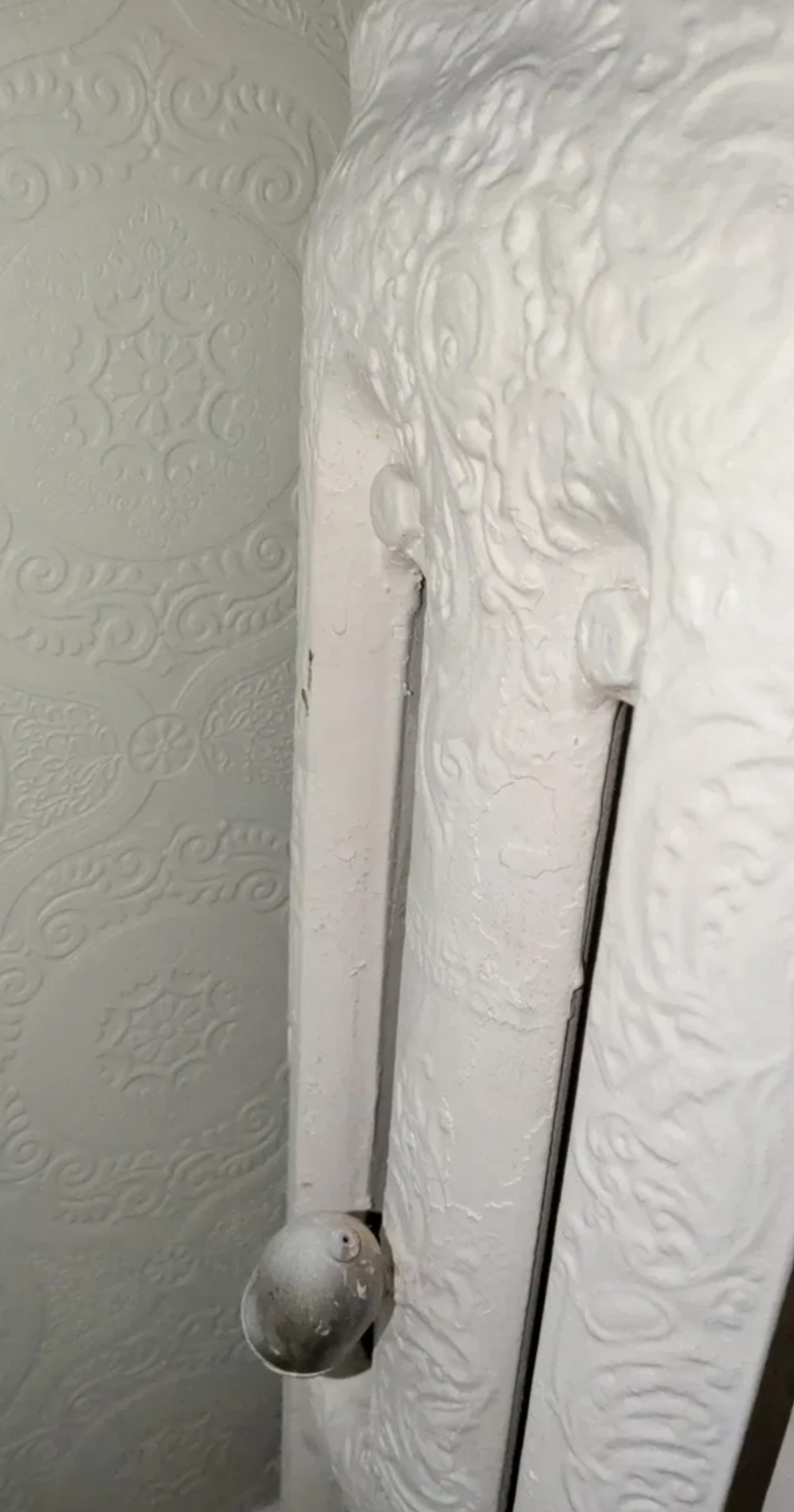

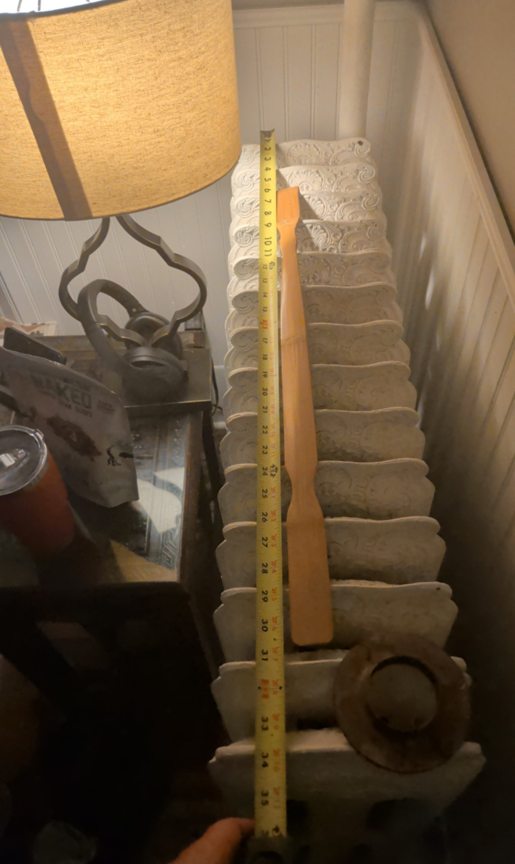

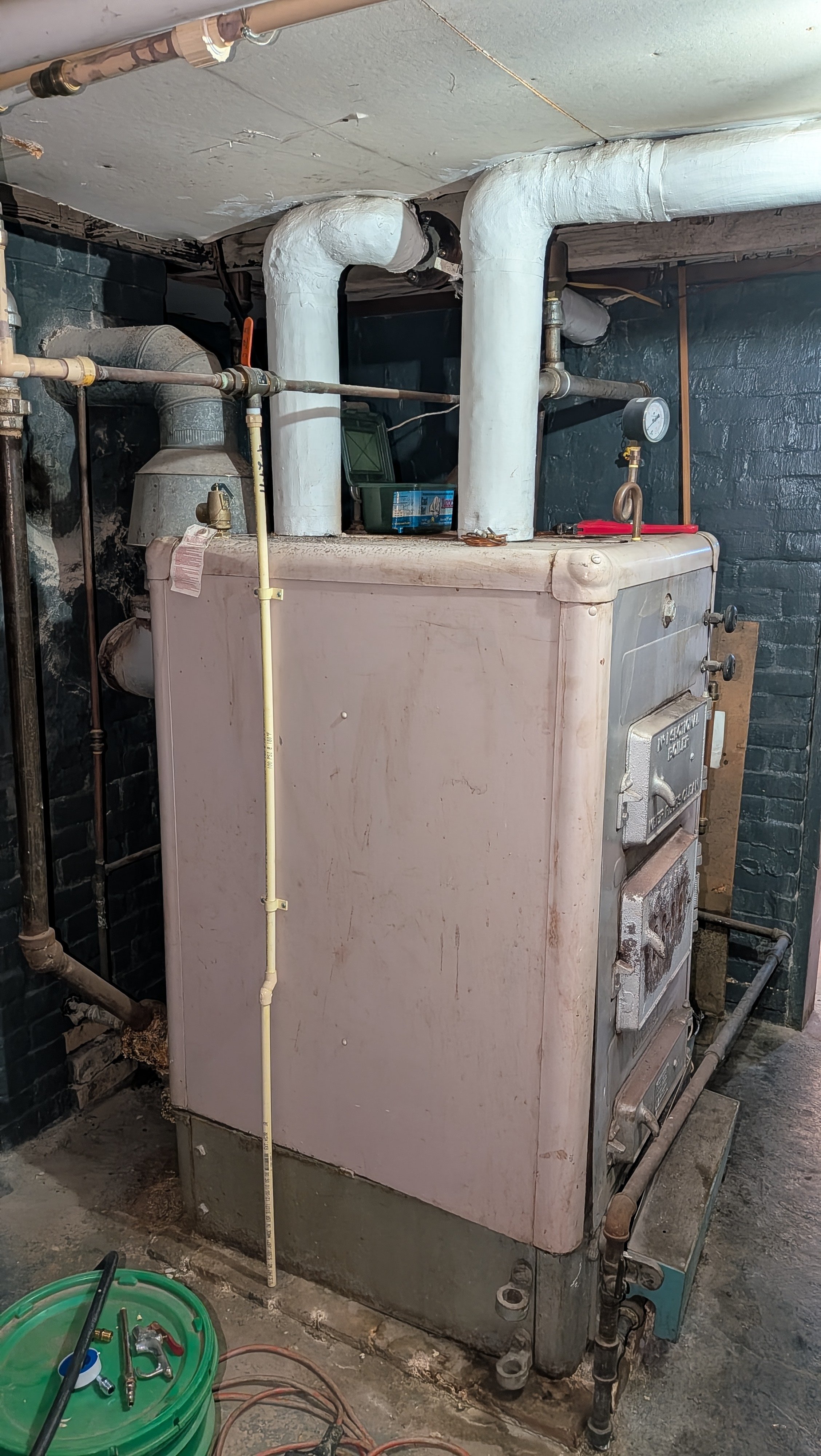

Morning all - I need to replace my 80 some year old boiler and I have two quotes - one is pricing an EG-45 the other EG-40 - with AI helping calculate using photos and a tape measurement - we determined the estimate: 71 sections at about 5 EDR is roughly 355 sq ft, plus a few for the bathroom unit.

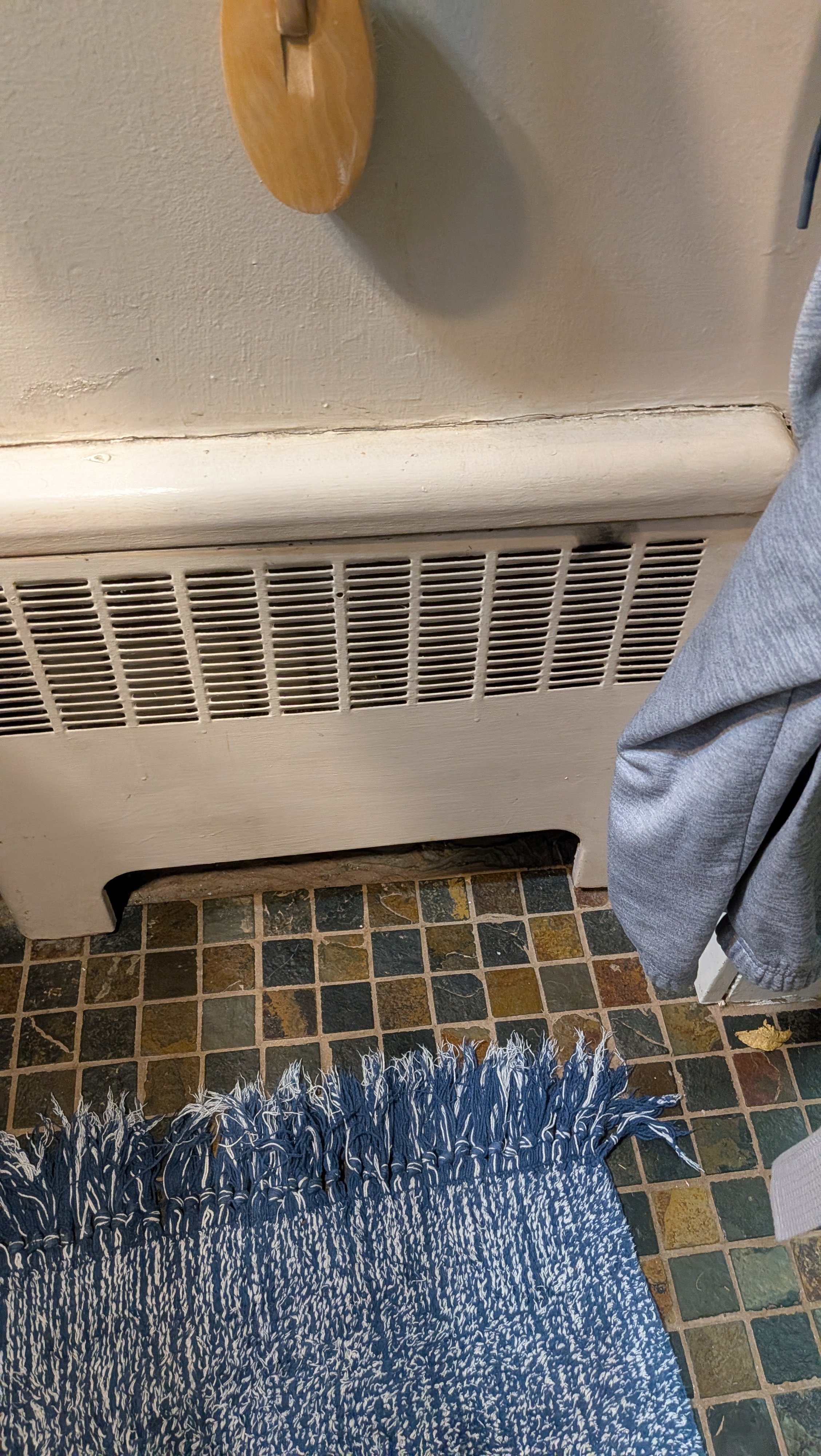

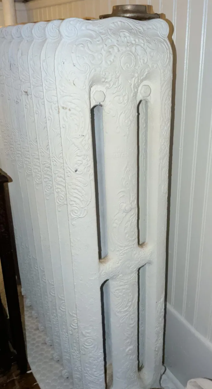

Here are photos of the boiler and the radiators 1 bathroom small register the rest are like sectional that are 38" tall.
Any help identifying the radiators and our needed radiator catalog edr rating to determine which prices boiler is a better fit for the house.
Thanks

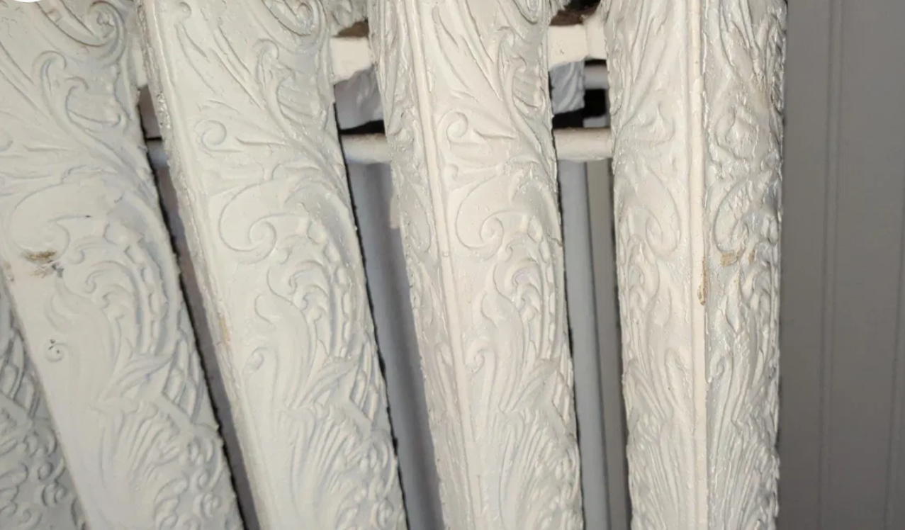

    arco rococo? is there a name on them?
    there is also a 30's arco catalog with convector cabinets, mmight be yours

    All I can see on them under the paint is American Radiator

    I'm not opposed to replacing boilers but I wonder if there is a reason aside from age. A few pictures of the whole boiler from a couple paces back would be very informative.

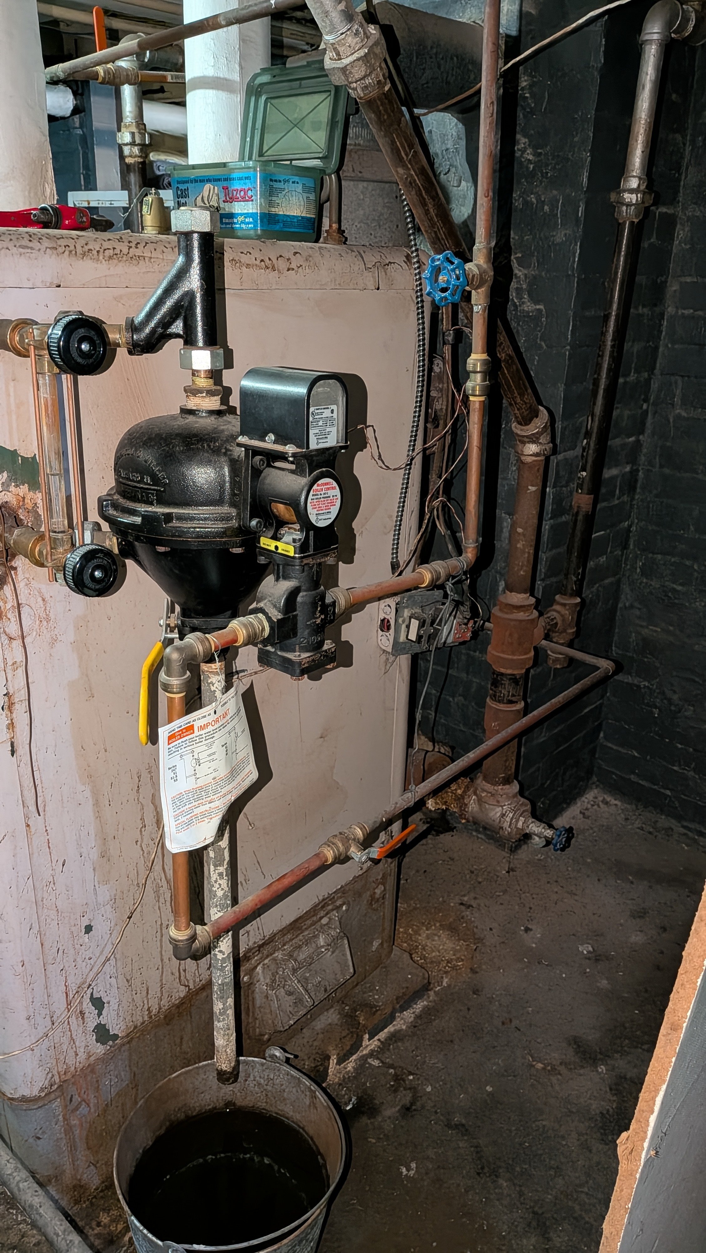

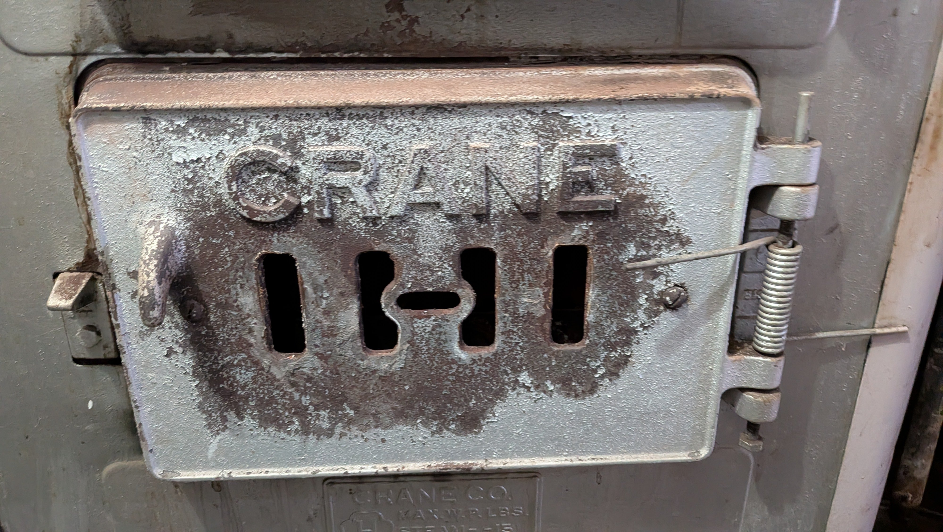

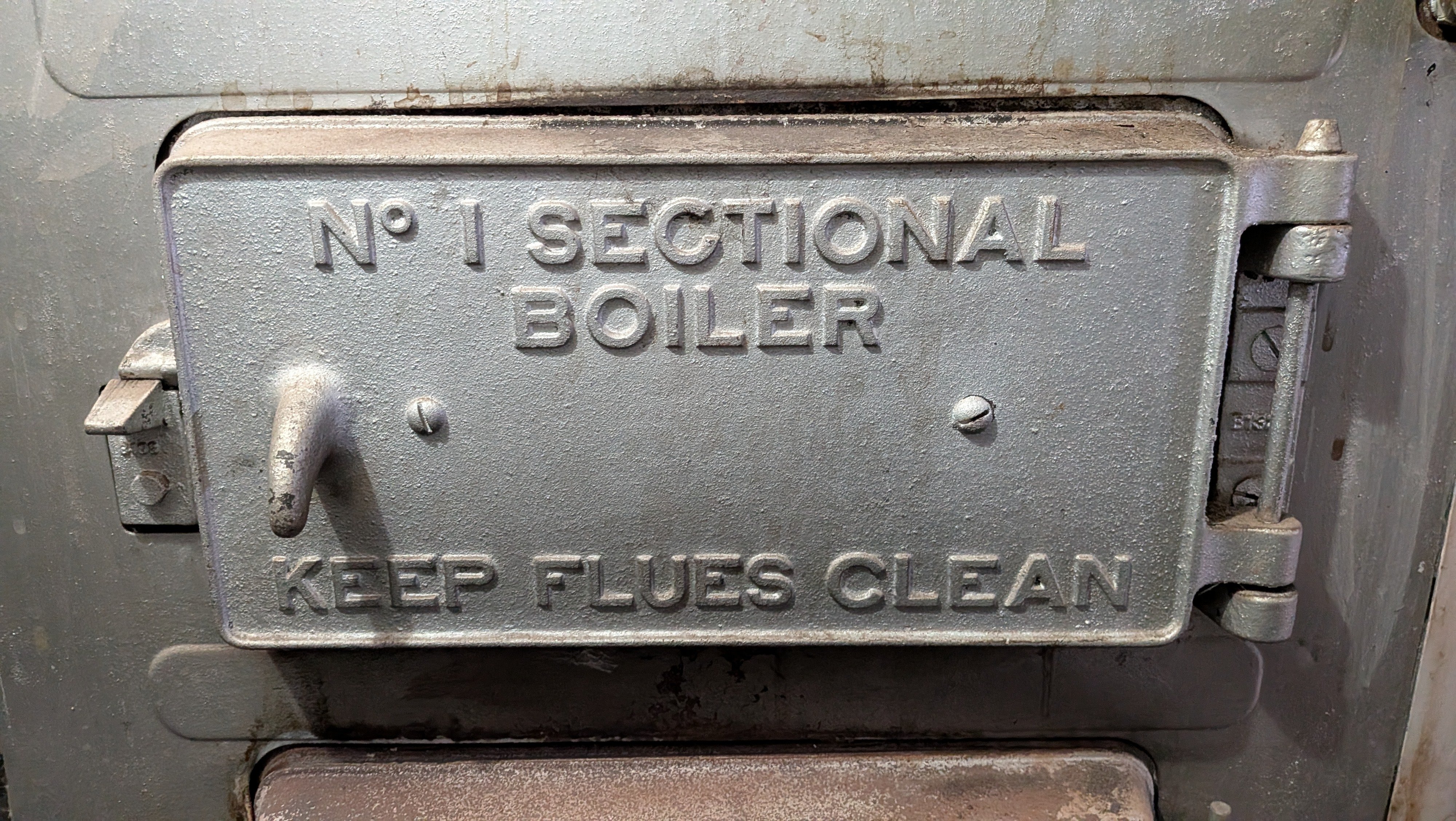

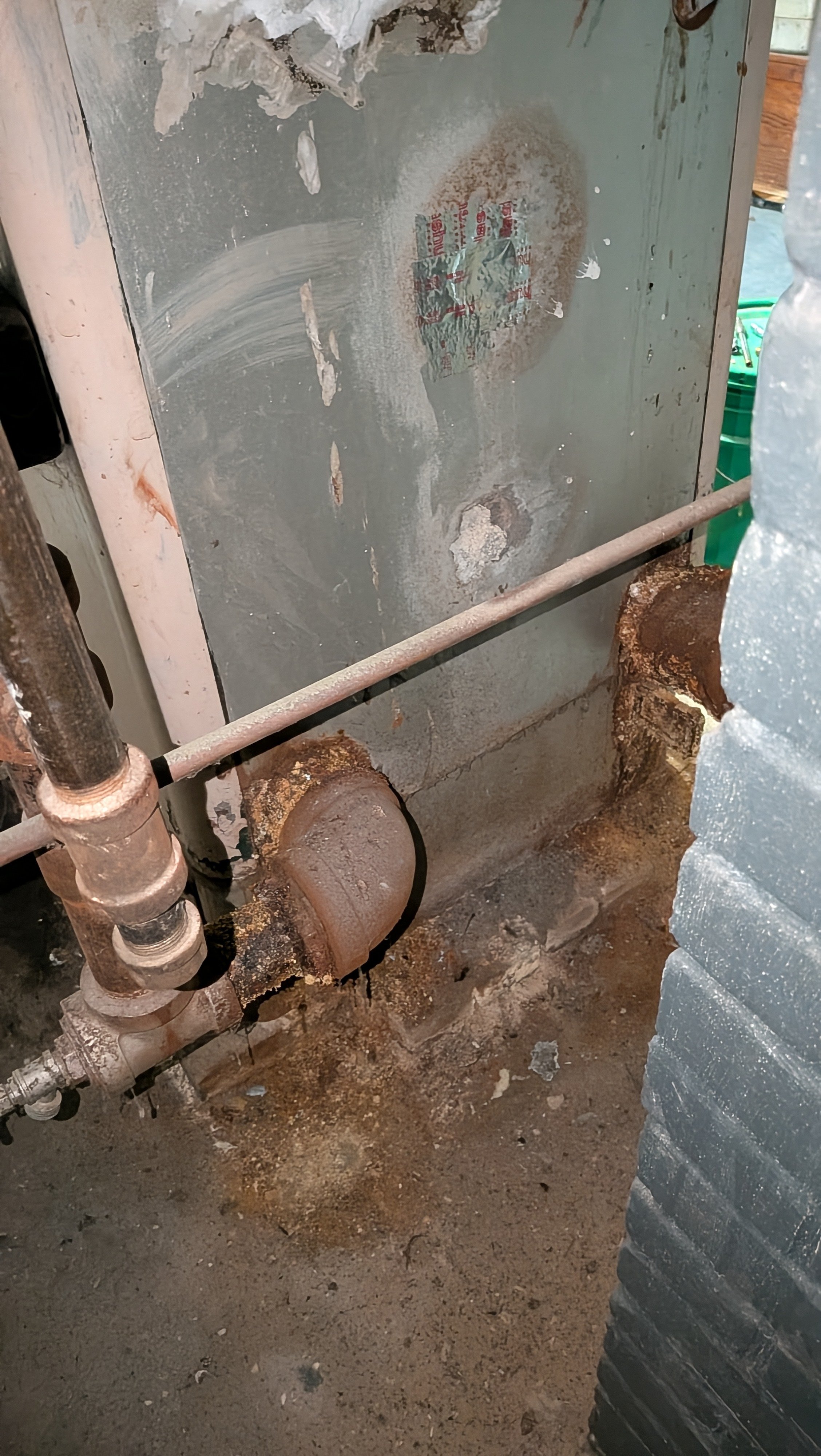

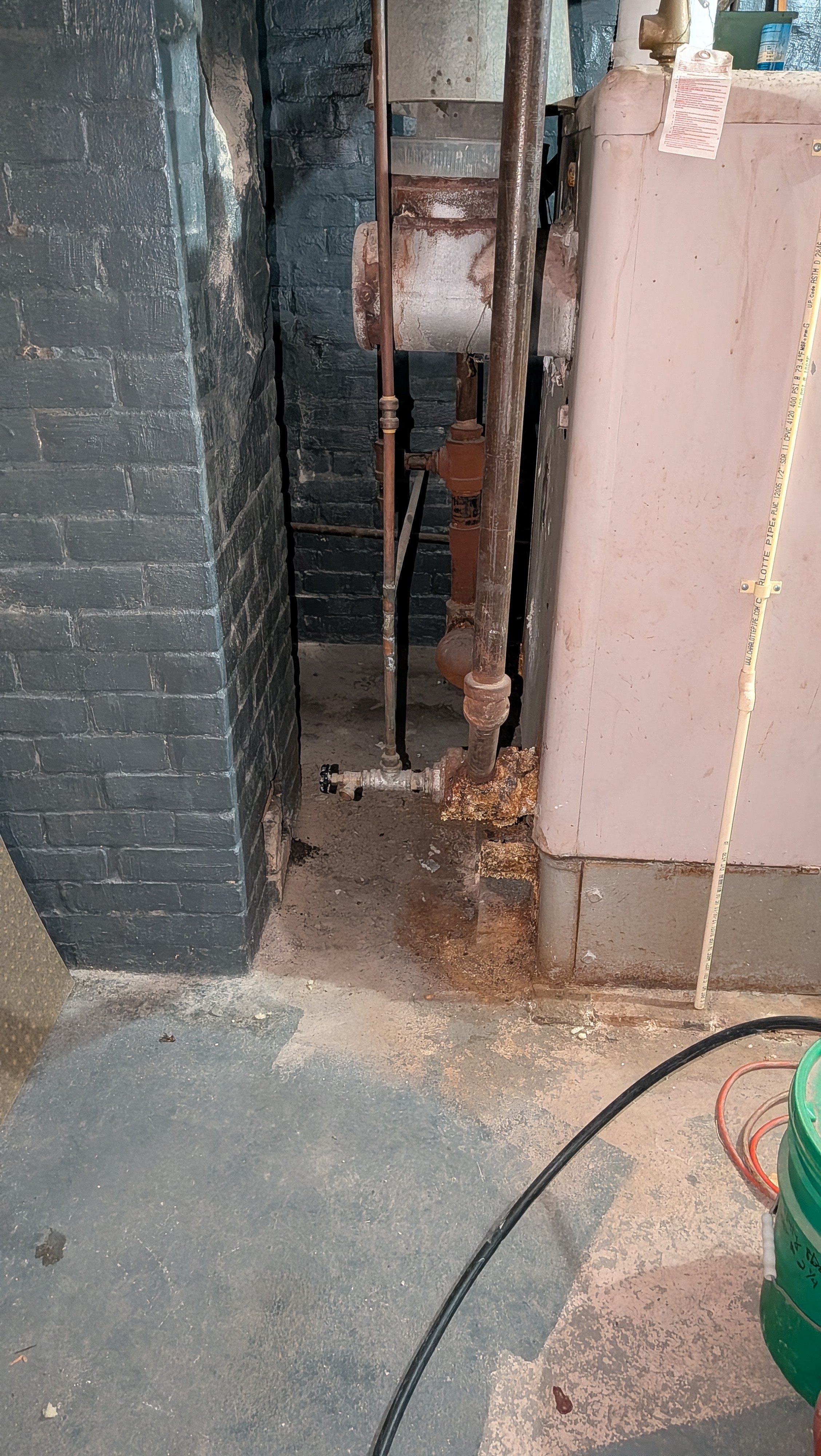

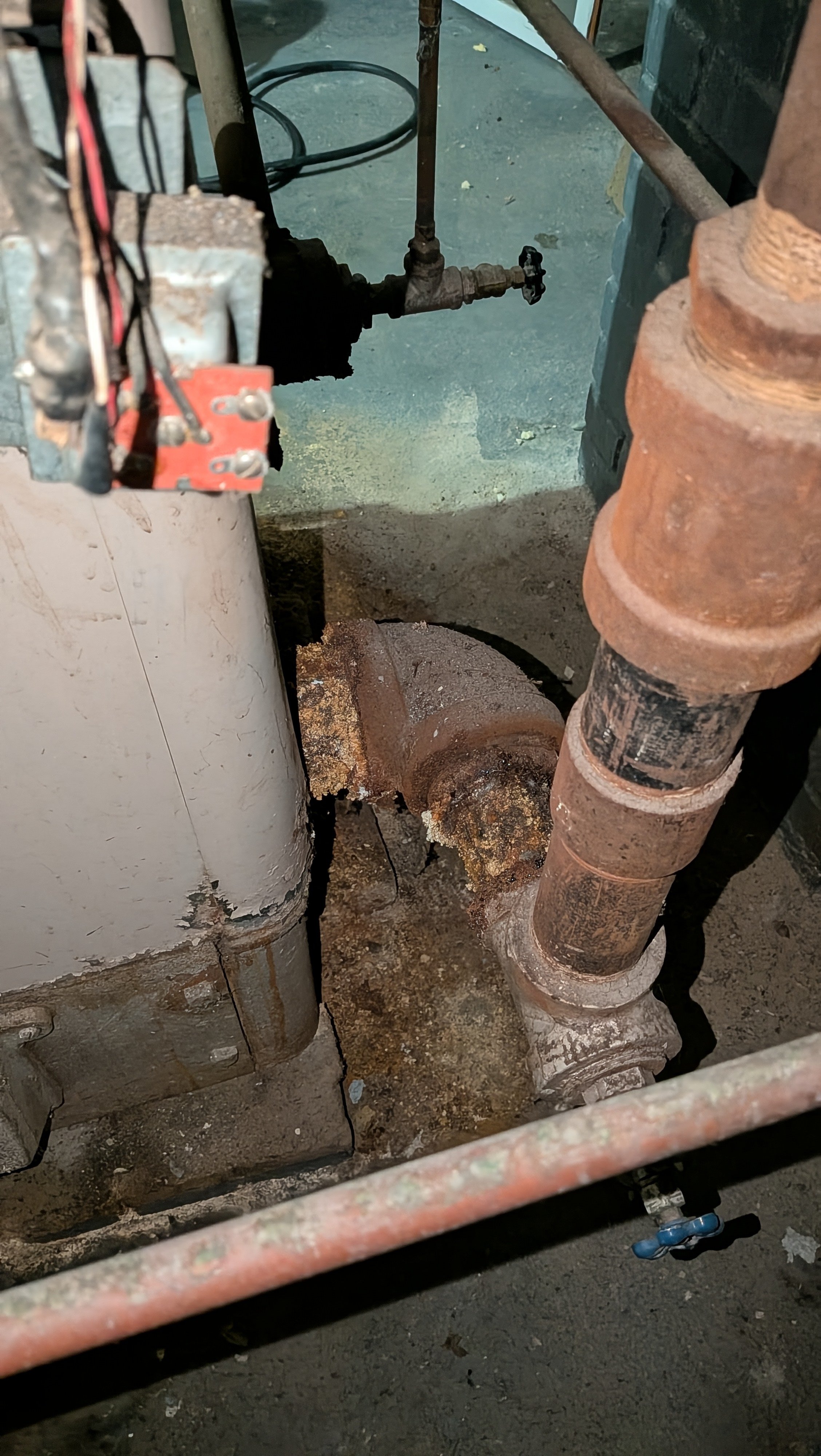

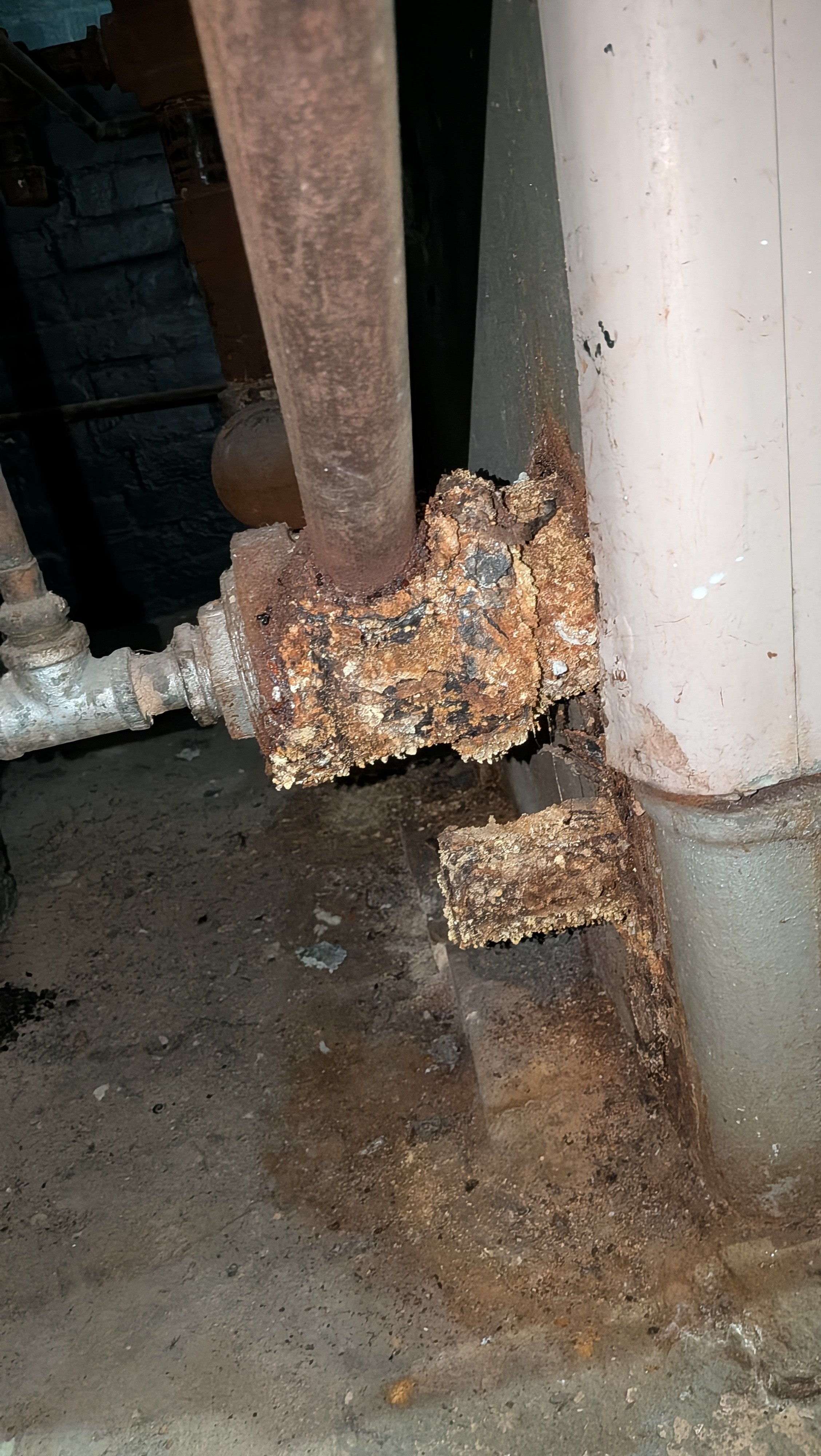

    The worry is the bottom pipes where the condensed water returns:
    The top where the steam goes out to the radiators - the joint where the pipes connect leaks like crazy (main reason I asked the plummers to come look at it) these saw the back pipes and said when those go, there will be no repairing it.

    That beautiful radiator is an American Rococo, as shown in the 1897 catalog. It was probably made around the turn of the 20th century.
    The convector is probably a standard type. If the other catalog doesn't have something similar, this book will:
    https://www.heatinghelp.com/store/detail/e-d-r-ratings-for-every-darn-radiator-and-convector-youll-probably-ever-see/
    The piping in back of the boiler can be replaced, as long as the cast-iron boiler sections haven't rusted out.

    I had landed on the Rococo based on the links ya sent, with the only difference being a width on 9" roughly not 8" or 10" and I did not see the through bolt

    how old is the house? i suspect that may be the second boiler. needing to replace returns below the water line is pretty common on steam systems.
    EBEBRATT-Ed Posts: 21,328
    @DAXQ_2
    I am all for fixing old boilers and the rotten piping can most likely be fixed regardless of what your tech said. but you gas burner is not looking so good either.
    Best bet would be to post your location. We may know someone in your area.
    There are not a lot of steam experts around and you need to try and find someone that really knows steam.
    I mention this because a lot of heating guys don't know steam very well. You going to spend a lot of SSSS and we want you to get this right the first time. We see too many horror jobs posted here.

    there may be a name on the element or inside the cover if you take the cover off the convector

    My initial thought when the kid said those rear returns were headed for catastrophic failure was just put some rust eater or famers friend on those rear pipes to slow down that rust - but AI said that would be a bad idea - one of the guys quoting who was here agreed with AI and said he wouldn't touch it - might last us 3 to 5 year or fail this winter.
    Steamhead Posts: 19,007

    Just got the book today, id have to say based on this book - these radiators could only be the Rococo three column radiators (pg51) circa 1916's or possibly the Florentine three column (pg117) circa 1920's but since both have the same 5 square feet per section of 38" high - should calculate very similar if not identical EDRs -wouldn't they? Given the through bolt - they are nippled not threaded to connect the sections (not sure what that helps - I would never try and take em apart). All of which is also indicating the house was probly built in the 20's
    Those radiators say "American Radiator Co." on them, therefore they are Rococos. The Florentine was made by U.S. Radiator Co. Look at the base around where the pipes connect, if there isn't too much paint there it probably says Rococo.
    The rods and push nipples tell us that's an early Rococo model. By 1915 at least, Rococos were made using right/left threaded nipples and didn't have rods. The last year for Rococos was 1920- that's the last time they appear in any "Ideal Fitter" catalog I've seen. By 1922 they were gone.
    The 1897 catalog, here:
    https://www.heatinghelp.com/systems-help-center/american-radiator-company-catalog-1897/
    shows a Rococo with rods.
