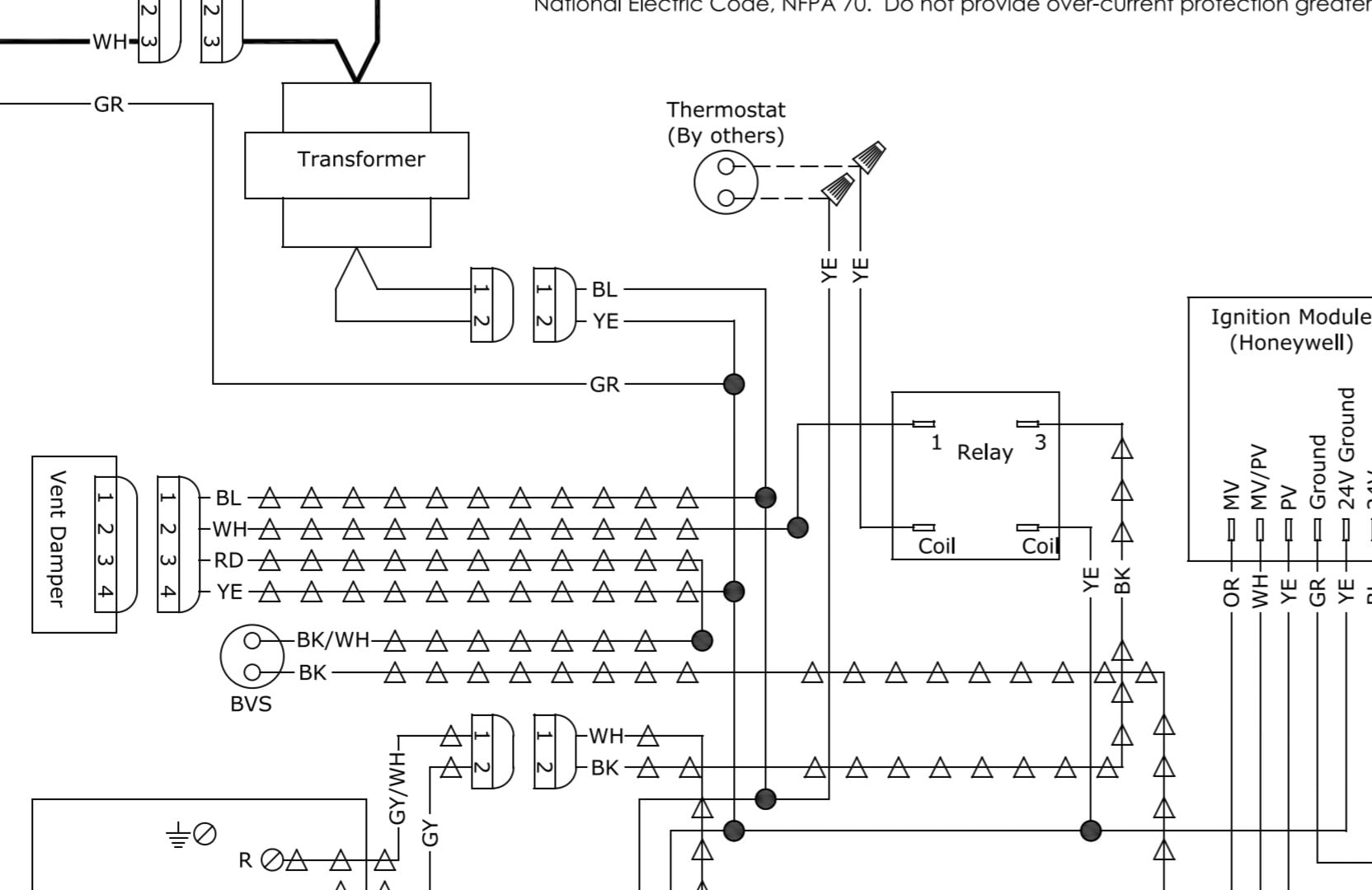

Powering a WIFI thermostat from a Burnham Steammax boiler
The C-wire should be the wire from the transformer that becomes yellow.
My problem is that the TT wires are a dry loop, so that they are there only to be closed and there is no clear distinction between the R and W thermostat wires. One goes to the relay and the other connects to a blue wire, based on the wiring diagram. The latter would be the R, to my mind. But the voltage reading to it to a C is a phantom 4.7 VAC; to the former is 0.
How to get 24 VAC to the R wire? Should already be 28 VAC from the blue wire side. Puzzled. Sorry if this has been answered, but couldn't find same.

    EBEBRATT-Ed Posts: 21,370
    Burnham's wiring diagram SUCKS because they change colors all over the place which makes it confusing.
    The BLUE low voltage wire coming off the transformer changes to Yellow and goes to the thermostat that is the HOT -RED ® terminal on the stat.
    The other YELLOW coming from the thermostat pulls in the relay coil that is the "W" wire to the thermostat.
    The "COMMON" wire "C" on the thermostat connects to the "YELLOW" low voltage wire coming off the transformer. This wire goes to the other yellow wire on the relay coil.
    Trace these wires out to make sure they are correct as the changing wire colors makes it a mess to figure out.
    You need to pay attention to the yellows. The Common coming off the transformer is Yellow (2). Thats the C at the thermostat. Splice it in where you can.
    Rh and W are both Yellow at the boiler wire tails. You need to make sure the yellow wire thats connected to the Blue wire (1) from the transformer is connected to Rh. The other Yellow wire at the tail is W at the thermostat.
    109A_5 Posts: 4,790
    I basically agree with @HVACNUT. Here is why. Transformer's secondary Yellow wire (circuit 2) is bonded to ground (follow the Green arrows), so that ground bonded side is the 'C' wire. That makes the Non-Grounded wire on the transformer the 'R' wire Blue wire (circuit 1). To control the relay the thermostat 'R' is switched (closed) to 'W' which energizes the relay coil. The R and C power the thermostat.
    Since you have a meter using the boiler jacket as the reference (Black probe), when the Red probe contacts the correct yellow wire that is the 'R' wire there should be 24 VAC (nominal) present, this is with the thermostat disconnected or inactive.

  • Thanks much for your thoughtful reply! These all do trace through. And after verifying everything, it became clear that my tap off of the transformer was iffy, so the voltage to the common wasn't as it should be. The description of the TT loop being "dry" was making me wonder if I should see a voltage there. Think I'm good to go. Be nice indeed if the wiring were more clear. Or have some terminal blocks in it. Or post a notice on how properly to attach a C-wire to the SteamMax series. But love my steam heat, anyway.
