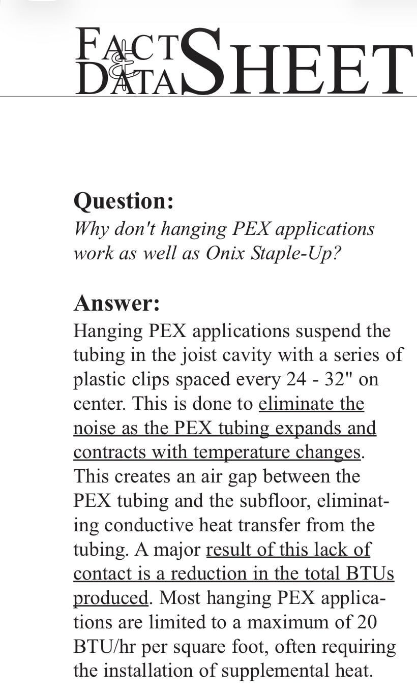

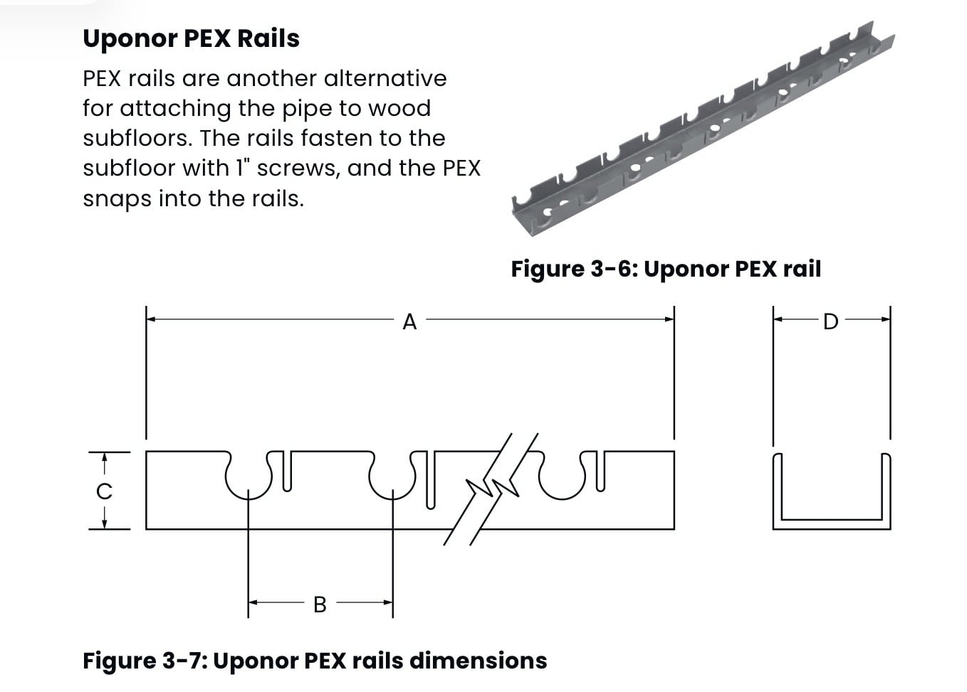

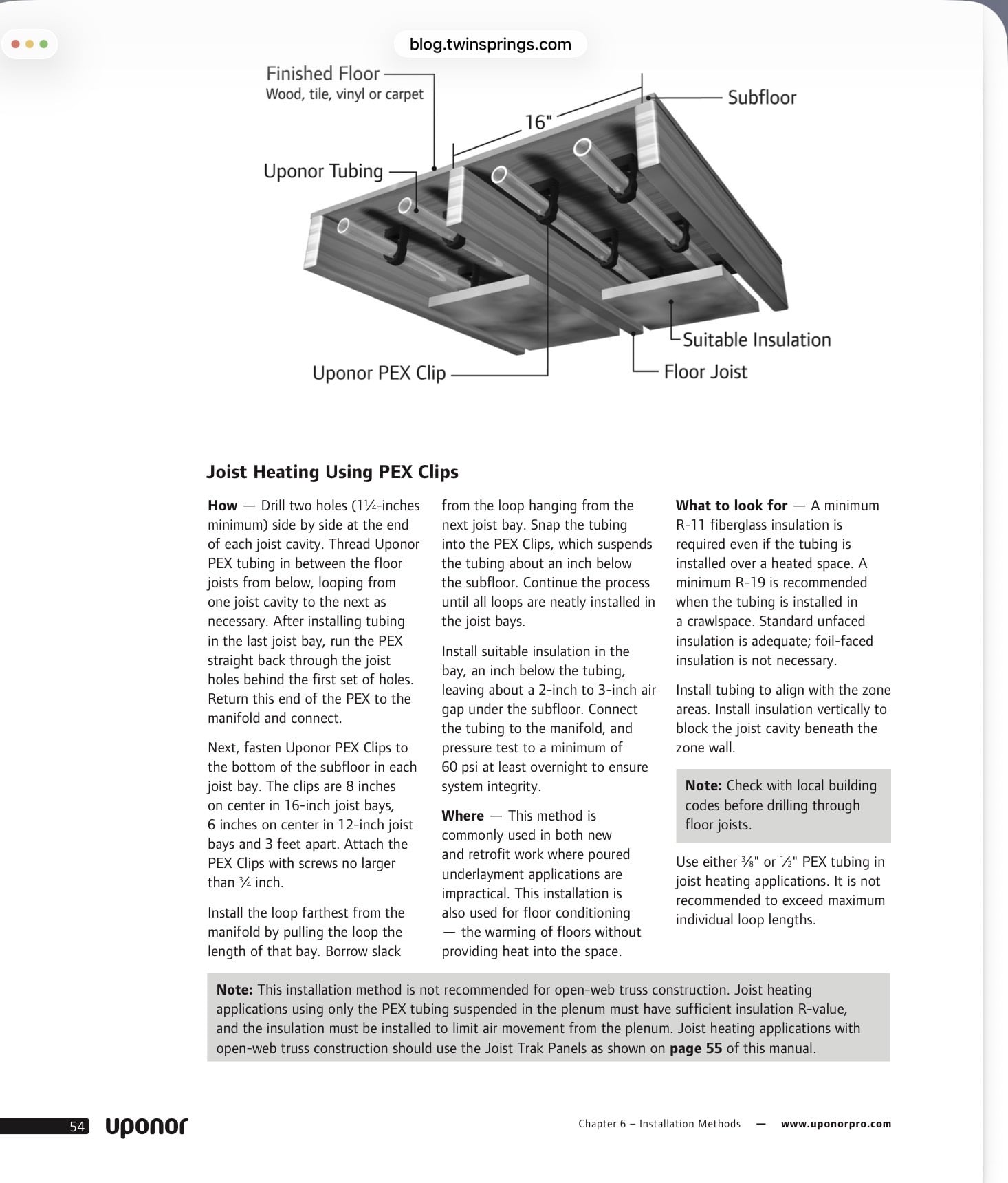

We are installing several loops of 1/2” HePex from the underside of the subfloor for an existing space. I’m wondering if you need to use the Uponor clips, or could it be installed using plastic two hole straps? The homeowner did not want to use the transfer plates, so we’re trying our best.

    Uponor calls it joist bay heating, they have a track for installing the Pex.
    These tend to need high supply temperatures, 140 plus.
    Do you have heat load numbers for the various rooms?

    The key to any radiant installation method is getting the floor surface temperature up. You get about 2 btu/ square foot per degree difference.
    So a 82 degree floor surface in a 70 degree room = 12x= 24 btu/ ft
    Getting the floor surface that warm by heating the air in the space is the question.

    Watts Radiant has been claiming up to 20 btu/ square foot per ft with suspended pex. It may take 180 supply to get that.

    This is intended to heat the space, along with (2) toe-kick heaters. I saw the tracks, but the homeowner was dead set against using them because of cost. We explained it may not work as well, but I can’t argue with them.

    Thank you for this. So essentially securing the tubing directly to the underside of the subfloor below would be the best bet if not using the tracks?
  • JS41190
    JS41190 Posts: 20
    Nope, I just found your post online and it’s saying the pex will cause noise. Guess I’ll be using the clips instead.

    yeah Pex squirms a lot especially when you run it up to high temperatures needed with joist bay application. Use an attachment designed for quiet movement. Avoid the pex touching or crossing itself. The outer layer can create a squeaking noise when it rubs. The loop ends need to be unfastened to allow the pex to grow in length, quietly.
