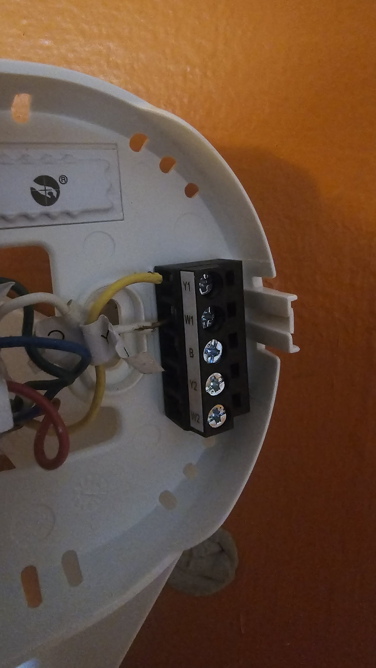

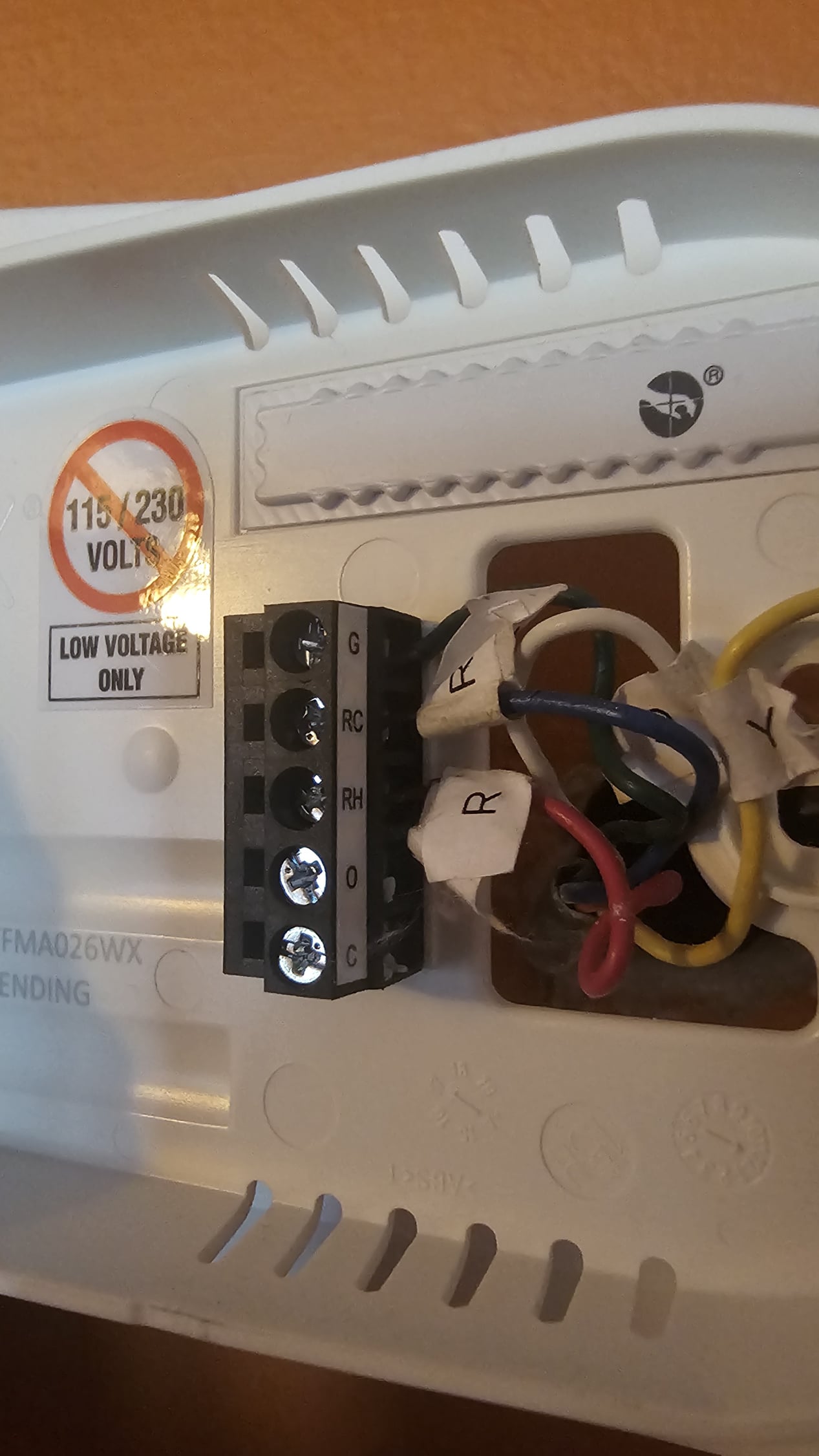

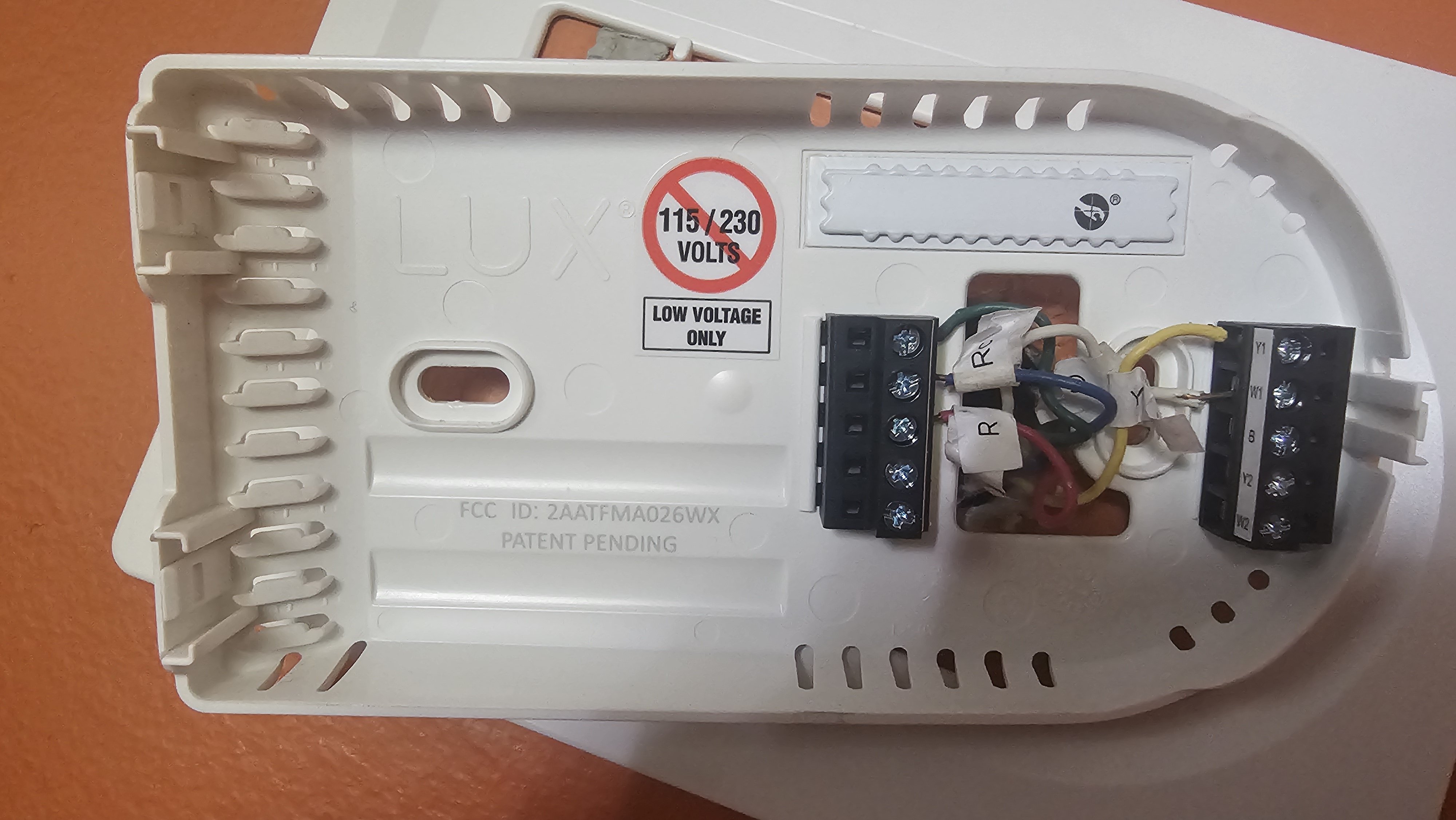

So I've been using a Lux Geo thermostat for my single zone heat/AC setup. Well apparently the company shut down the servers so I can no longer use their app. So I'm looking at the ecobee essential thermostat now, but I don't have a C wire. I know I can use the ecobee c wire adatper kit, but I'm wondering if it will work with my setup. Currently, my lux geo is using an external USB power supply as that was a main feature as to why I got them. I also have 5 wires connected to the thermostat.
Blue to RC
Red to RH
Green to G
Yellow to Y1
White to W1

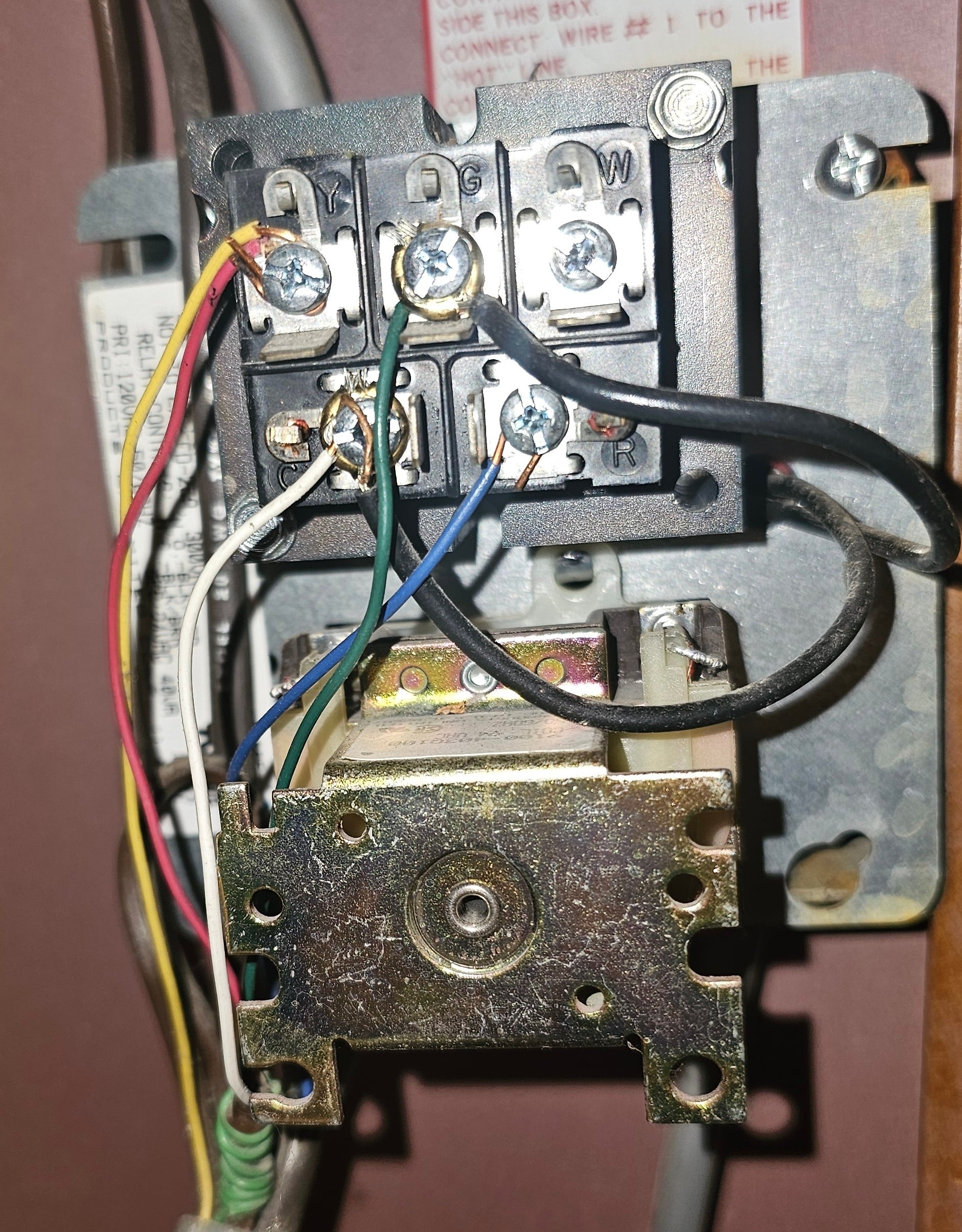

When I look at the furnace, the wires are connected as follows:
Yellow and red wire both to Y
Green to G
White to C
Blue to R
The W terminal has no wires.

    No. The wires you're seeing at the relay are not all the wires from the thermostat. The Red on Y and White on C should be going to the AC condenser. Rh and W at the thermostat go directly to TT on the burner according to the diagram.
    It can be done if you're handy. You need a heat isolation relay using W from the thermostat energizing a 24 volt coil to close normally open contacts to TT on the burner. That will allow you to use only one power source (Rc and Rh jumped) at the thermostat. @EdTheHeaterMan might draw something up for you if you're nice to him.

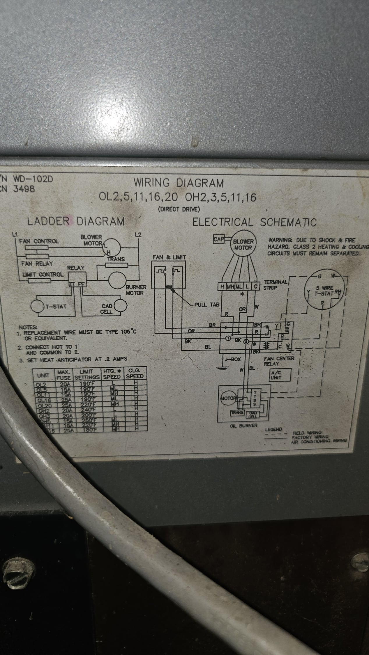

    OK I'm back. Now I need to know that you are using an oil burner and that you have a regular central air conditioner. I have your wiring diagram and I will fill in the colors as best I can on the Low Voltage side. The line voltage side is just hot and neutral so I will leave that alone since there is no change there.

    OK here is what I have come up with using 5 wires.
    Click on the diagram and you can zoom into the Low Voltage wiring. You will need to purchase a RIB U1C relay and connect it as a heat realy to isolate the transformer that operates the AC and Fan from the transformer in the R8184G. That RIB relay uses the White/Blue wire to connect to C on the Fan Center Relay. The White/Yellow wire connects to W on the Fan Center Relay along with the White wire from the thermostat. The solid orange wire from the RIB goes to one of the T terminals on the R8184G and the solid Yellow wire goes to the other T terminal on the R8184G. Any unused wires on the RIB relay get capped separately with wire nuts or scotch locks.
    Look closely at the C terminal on the fan center relay. There are 3 wires that go under that screw terminal and sometimes with different wire types like strand THHN and 18 gauge solid thermostat wires that can be a little messy. I would place all three wires in a solderless terminal and crimp them all together, then place the single tab under the screw terminal so there is a secure connection.

    If no crimp tool, just splice them with a wire nut adding a fourth wire to connect to C.
    @ylomnstr , the RIB relay can mount so the wires are in a junction box, or surface mount. You'll do surface mount because its all low voltage, and likely mount it on the same side as the fan center relay. I don't use the screws they provide. I use 8x3/4 hex head drill screws. Shorter and easier. Pre drill both holes, then send the screws from the outside in, so the sharp ends aren't sticking outside the furnace cabinet. No you can't just zip tie it to the wires. We're gentlemen.

    Actually the heating speed is connected to the Fan/Limit control like the L4064B and the cooling speed is operated by the fan relay. This is the old school fan relay like the R8285D, not a printed circuit electronic fan timer like the ST9103A.
    By adding the heat relay you are doing the same thing the Beckett 51950U AC Ready Kit, but less expensive, since the 40VA transformer is already there from the factory.
