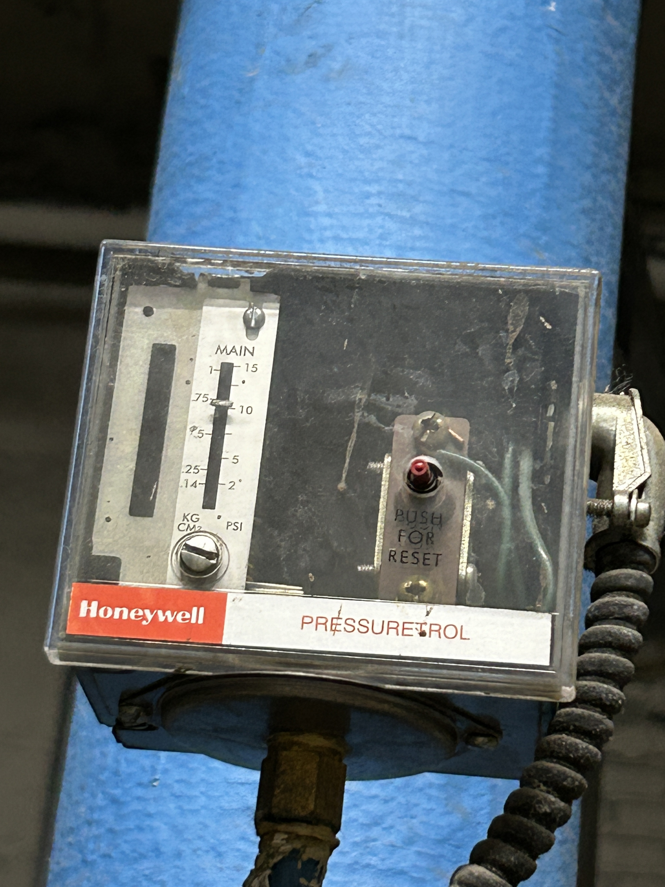

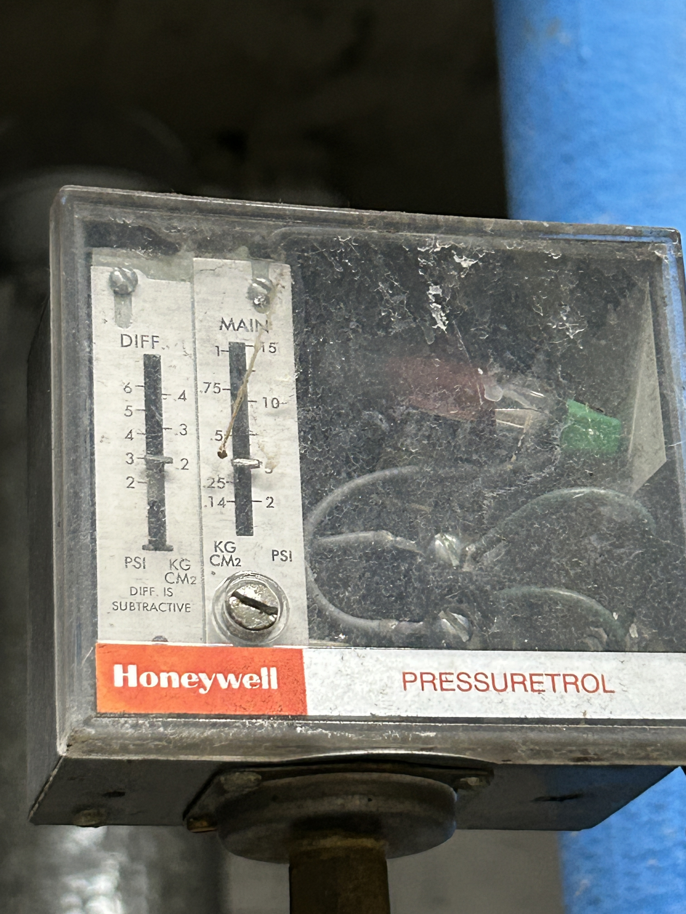

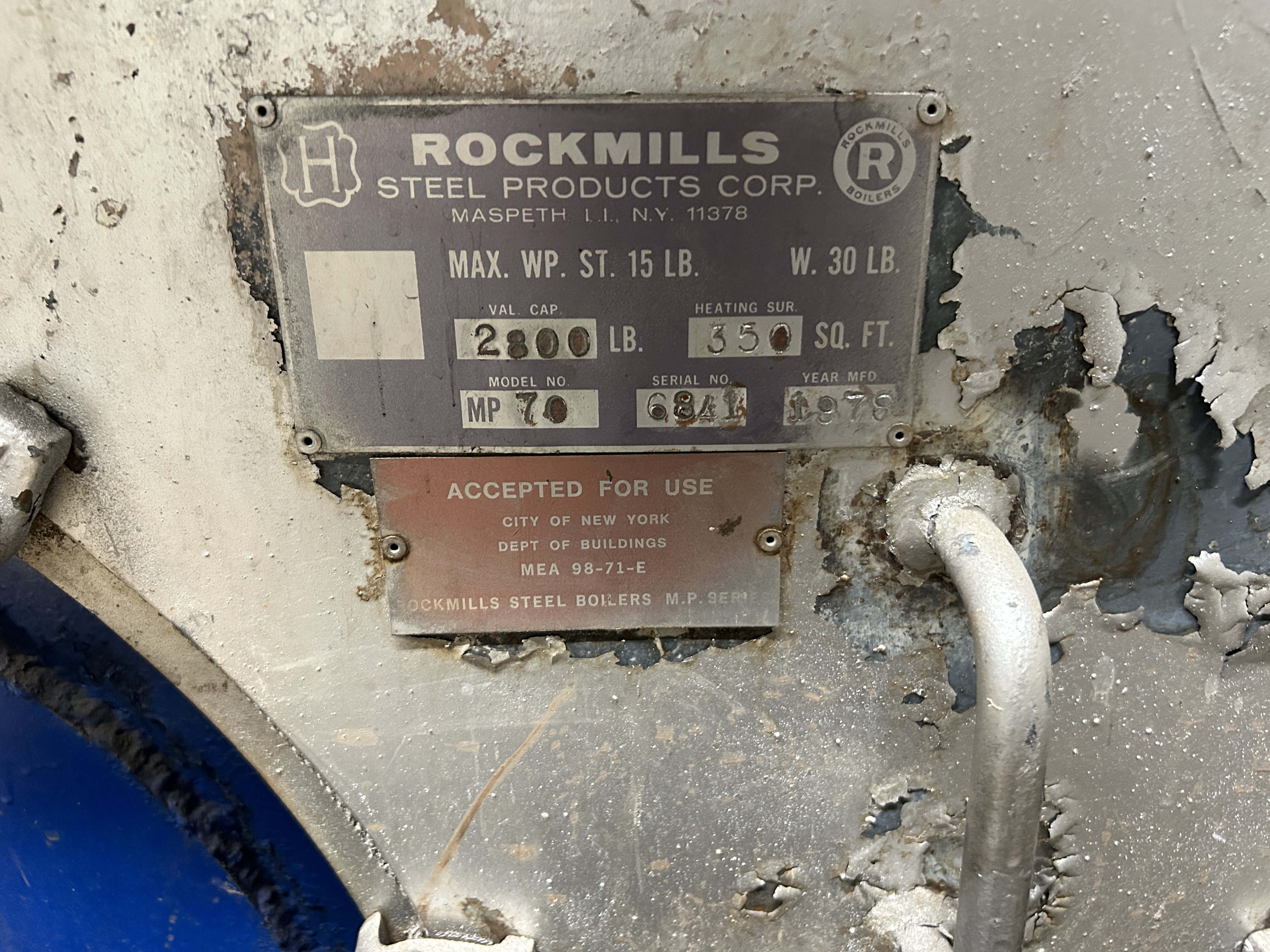

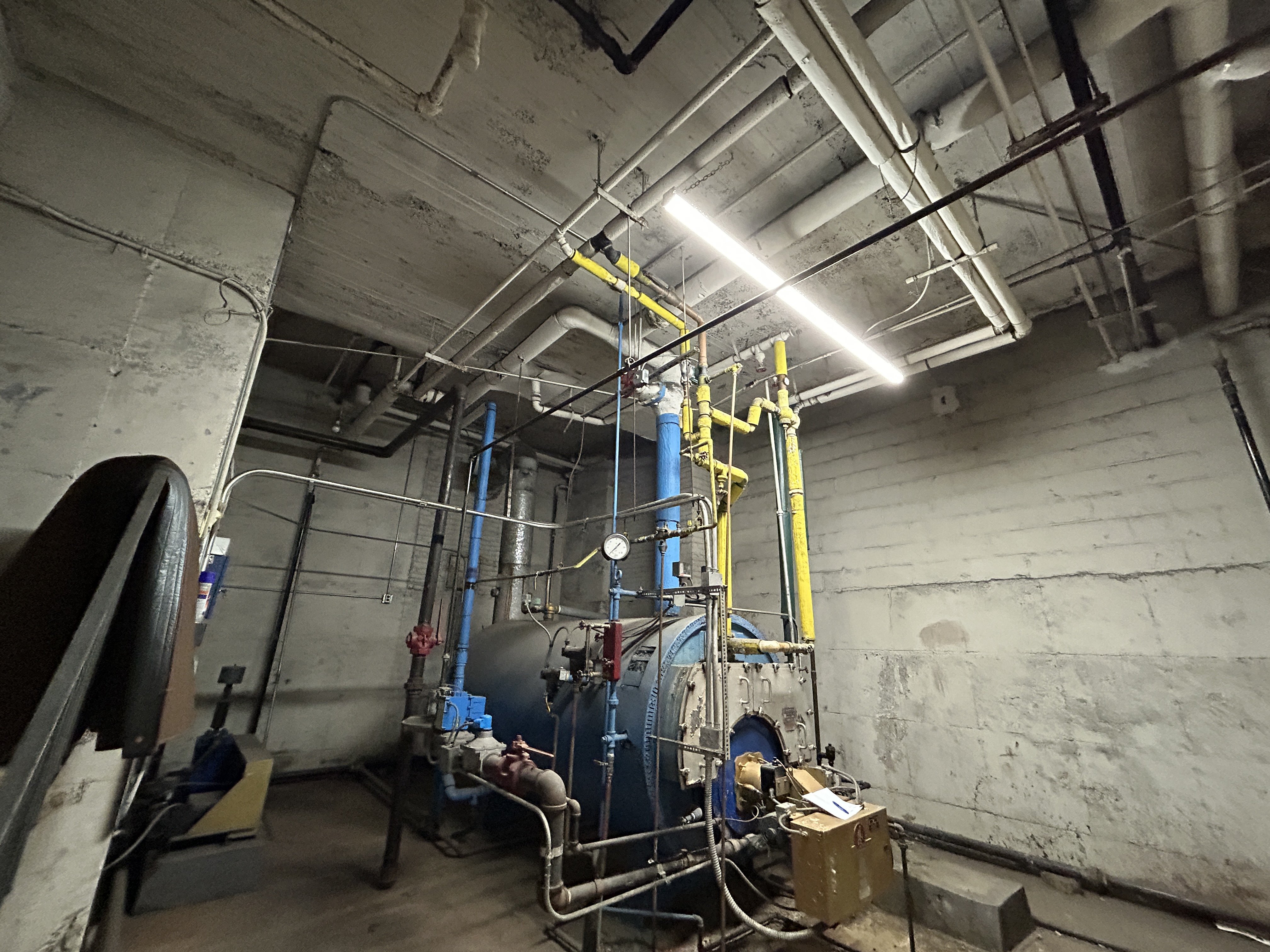

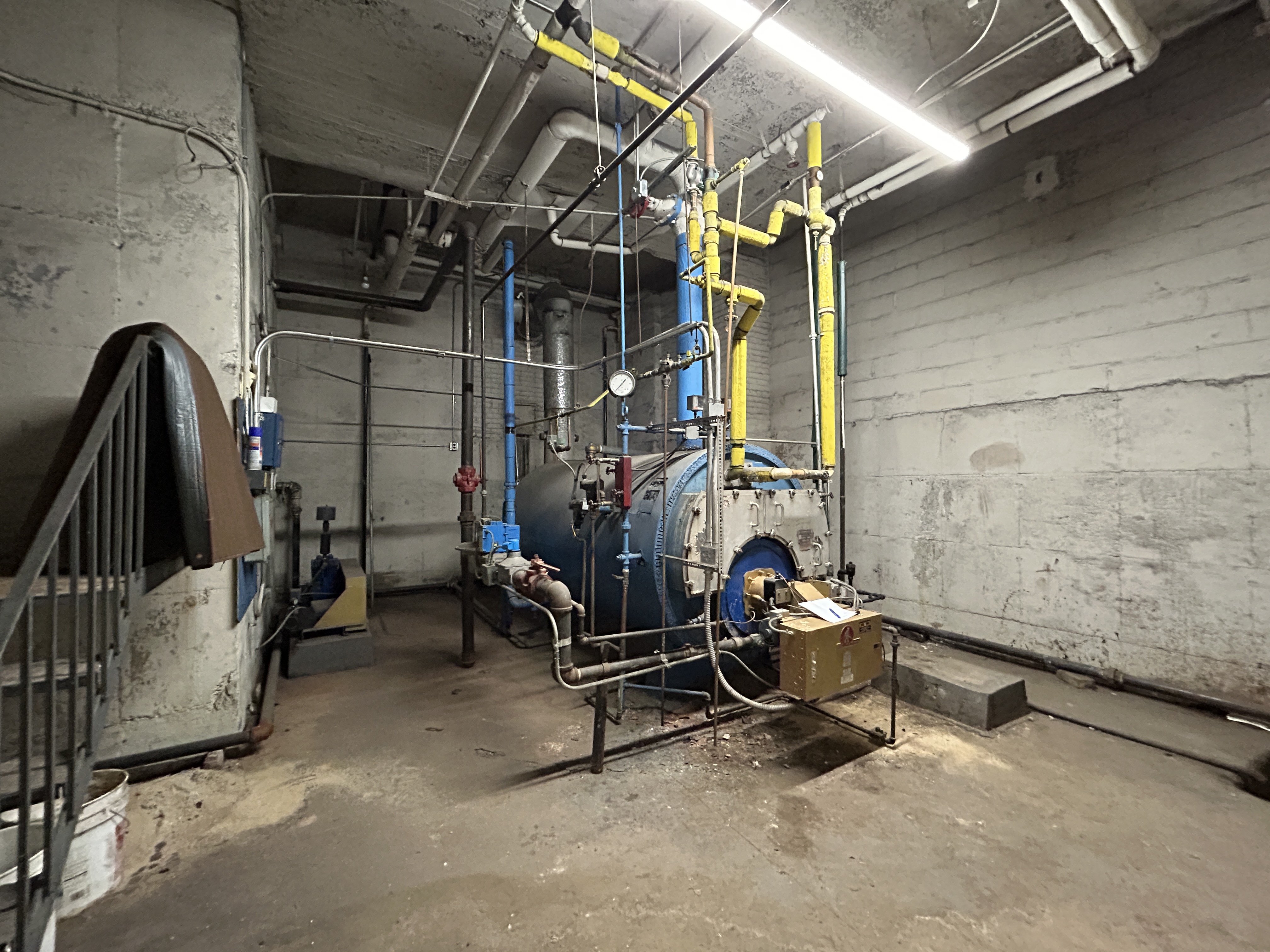

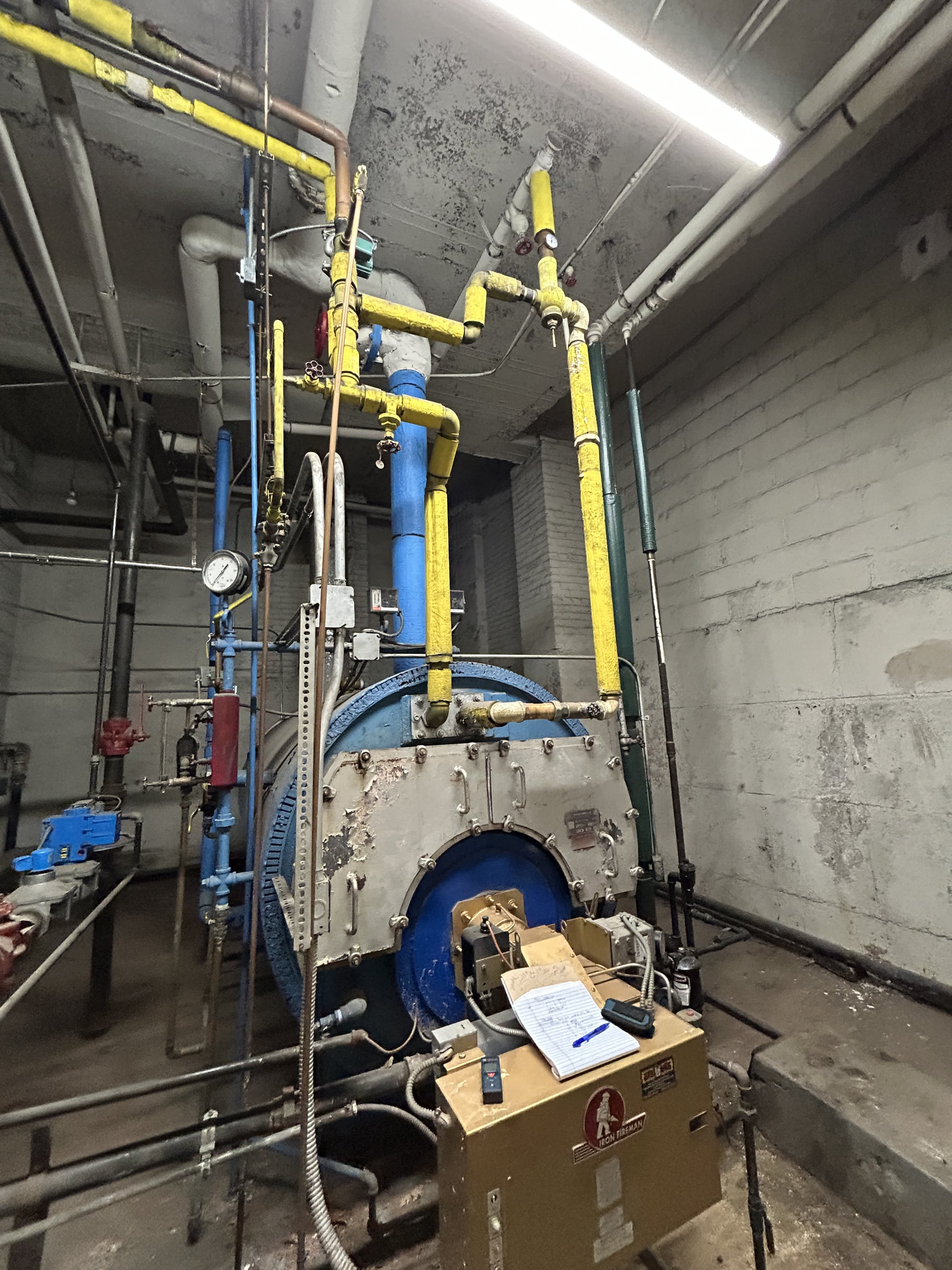

I am working on this building which has been having water hammering issues for the last 20 years and more. It is a one pipe steam building with gravity return. Have attached the picture of the boiler specification tag
I tried to diagnose the issue as per the detailed description given in "The Lost Art of Steam Heating"; Chapter 14 (Shoutout to Dan Holohan) . I verified the near boiler piping, traced all the main steam lines, the riser connections to the apartments, main vents and condensate lines coming back to the building. I have attached the steam schematic and vent photos

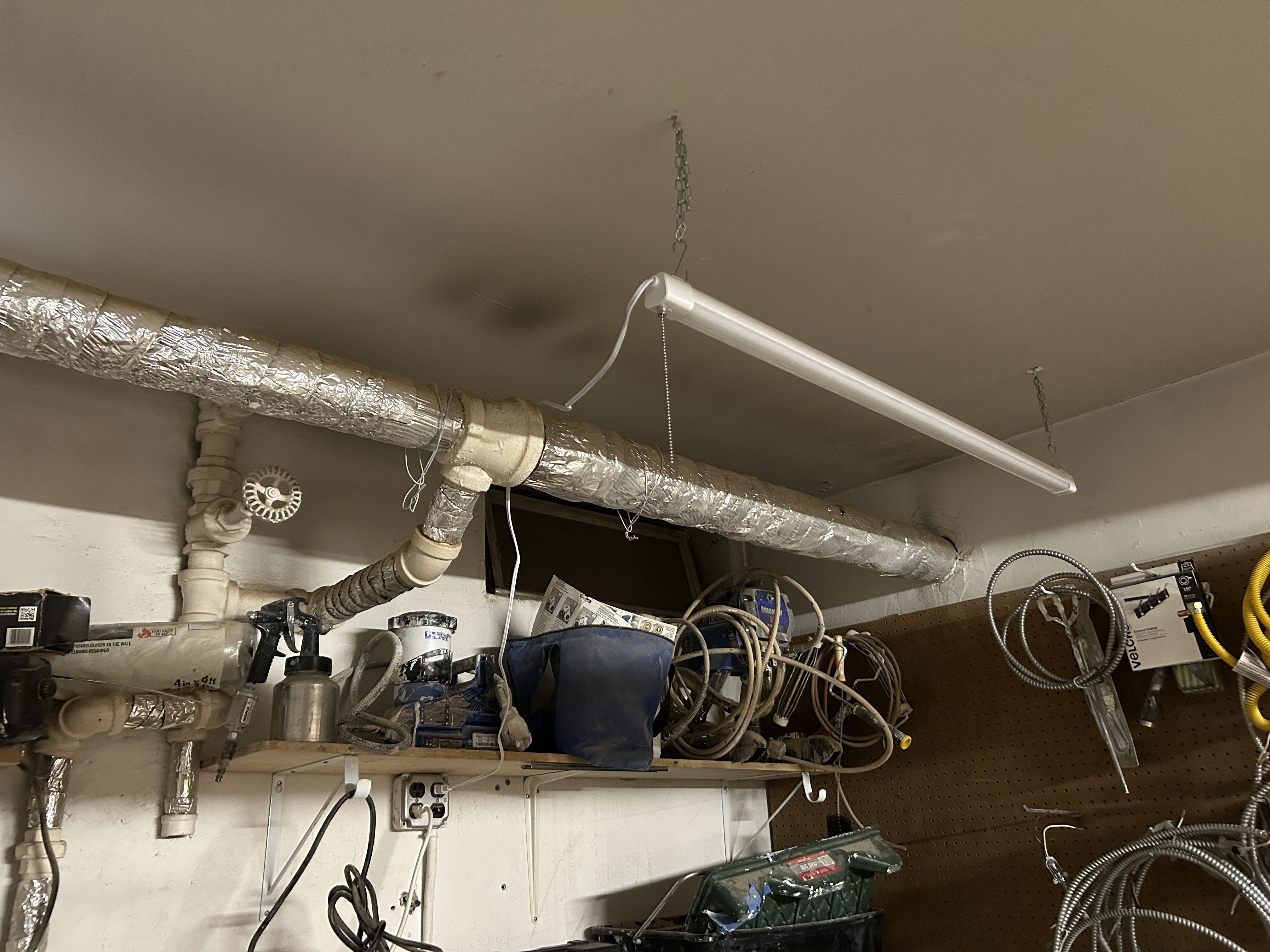

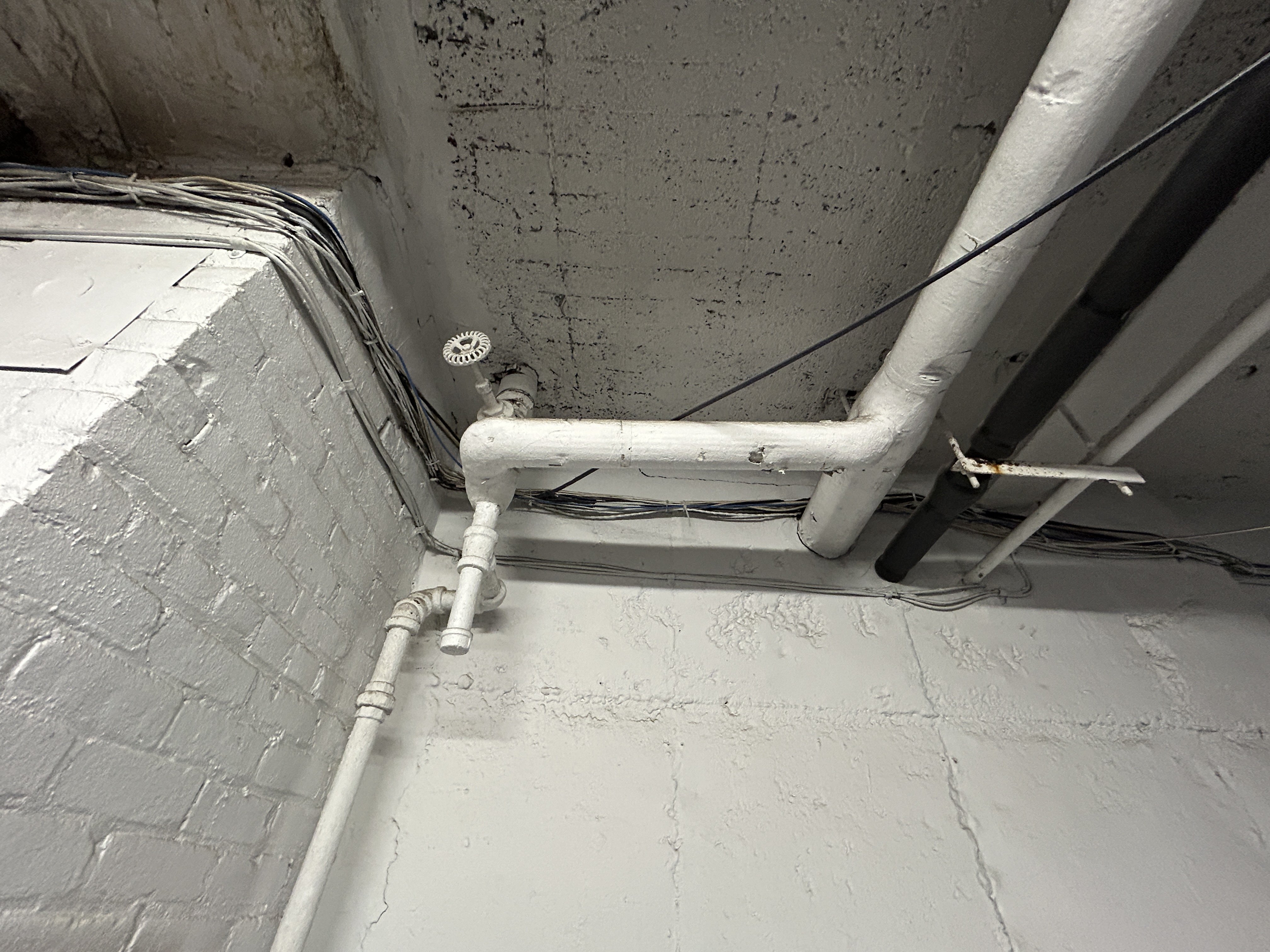

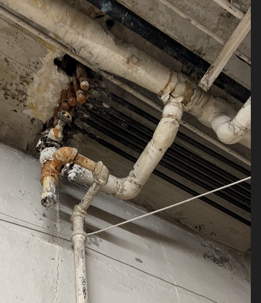

Main Vents
The building doesn't have enough vents with enough capacity to vent the air out of the system. As seen from the steam schematics and photos, , they only have four (4) vents in total.

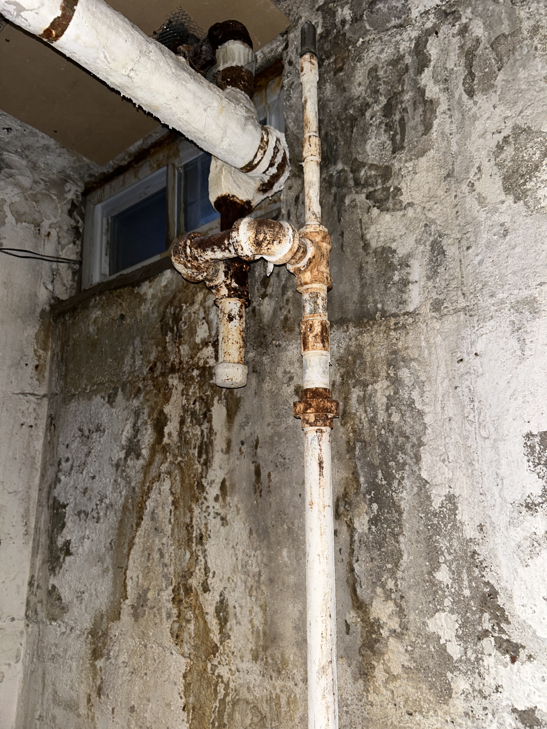

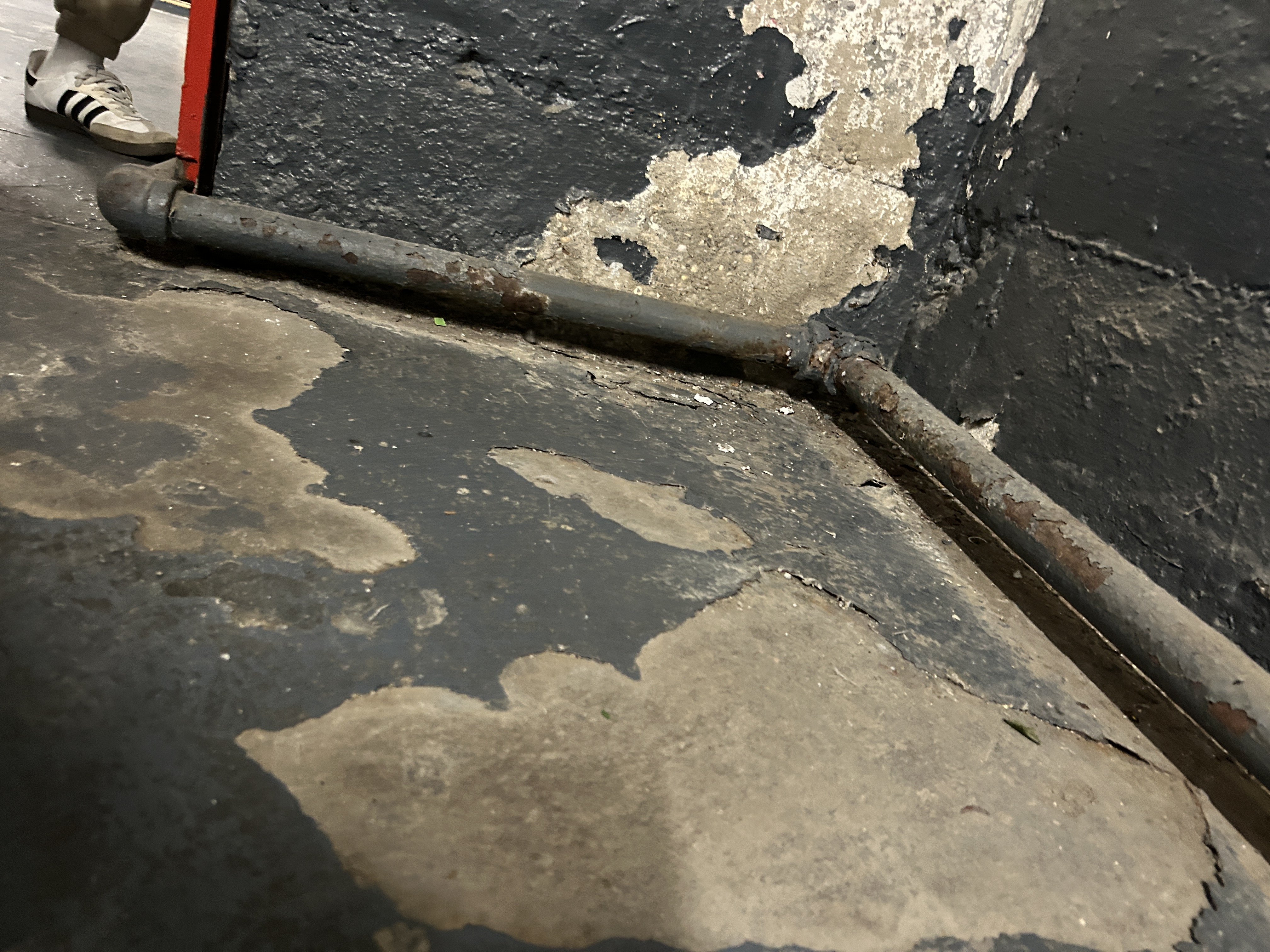

One of the G-line Riser not heating
One of the riser on the G-line (Every floor has 6 apartments with letters as suffix, for eg: for first floor its 1A,1B upto 1G) is cold all the time during boiler firing cycle. Have attached photo of the riser below. Its located in the boiler room. The temperature was around 77F-80F all the time. The riser is in bad condition and might be clogged?

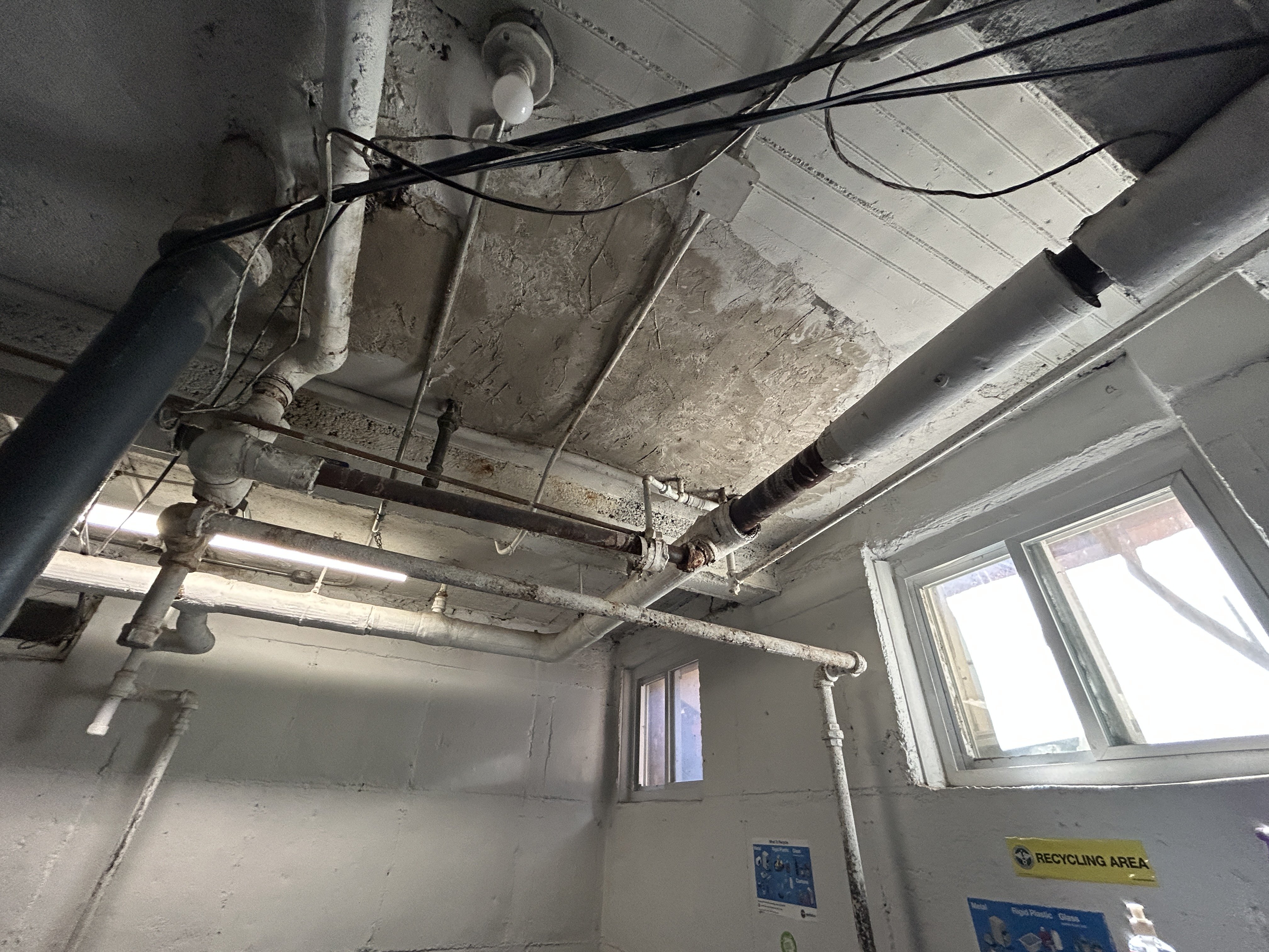

1.Concentric Reducers
The reducers are concentric rather than eccentric reducers as seen in the photos below
20261007_160014608_iOS.jpg 20261007_160008930_iOS.jpg 20261007_163732268_iOS.jpg

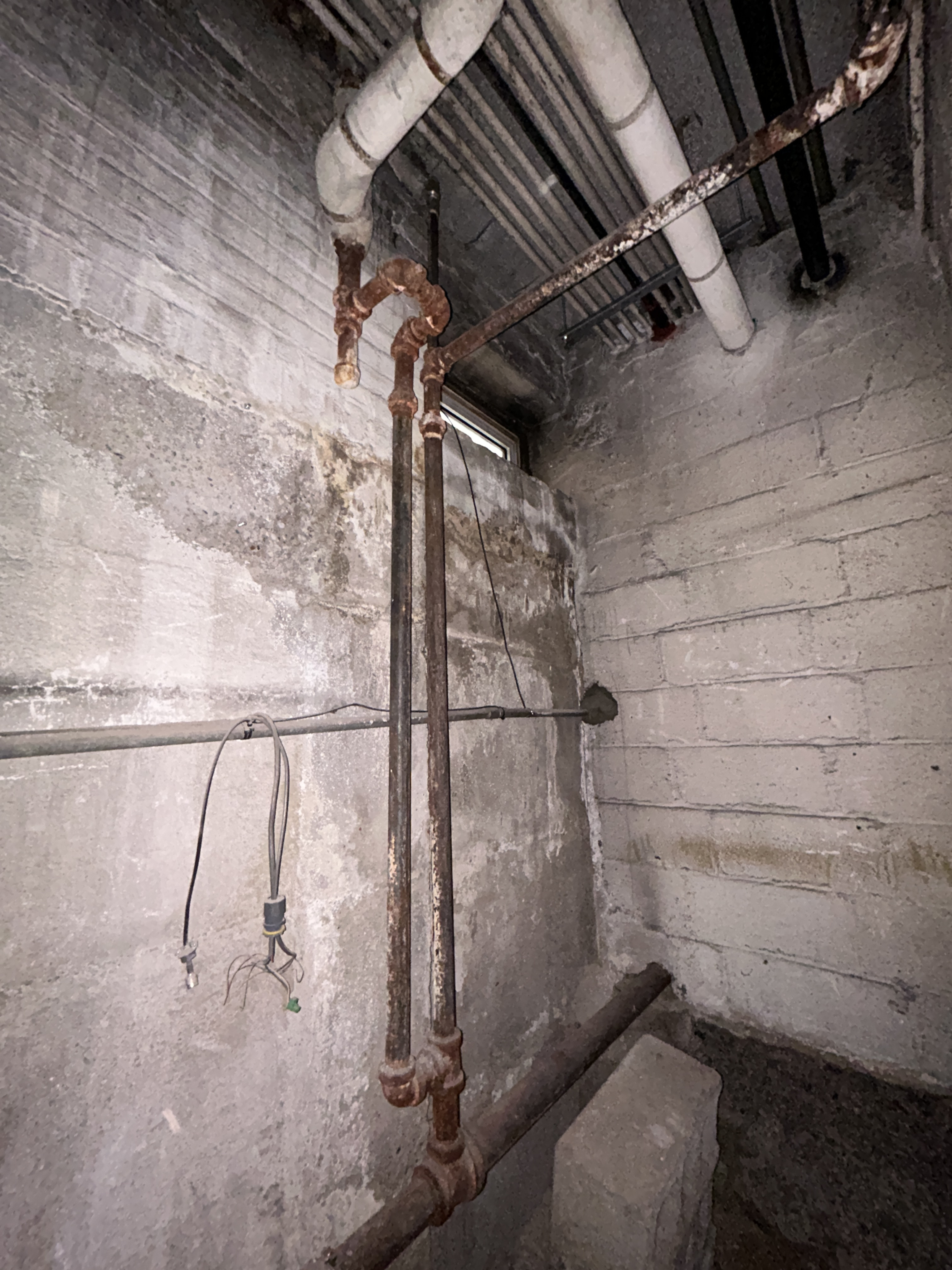

2. Not Enough A dimension
The condensate line from Loop 2 and Loop 3 (in the steam schematics) combines and comes to the boiler room as a single line. The condensate from Loop 3 comes as a standalone line. From my observations, I believe the system doesn't have enough A dimension to generate enough static pressure to push the condensate back to the boiler. I have attached an isometric drawing of the boiler room, which has boiler water line and the dry returns coming into the boiler room along with their height from the ground level. It gives a clear picture of the current "A" dimension problem.

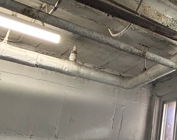

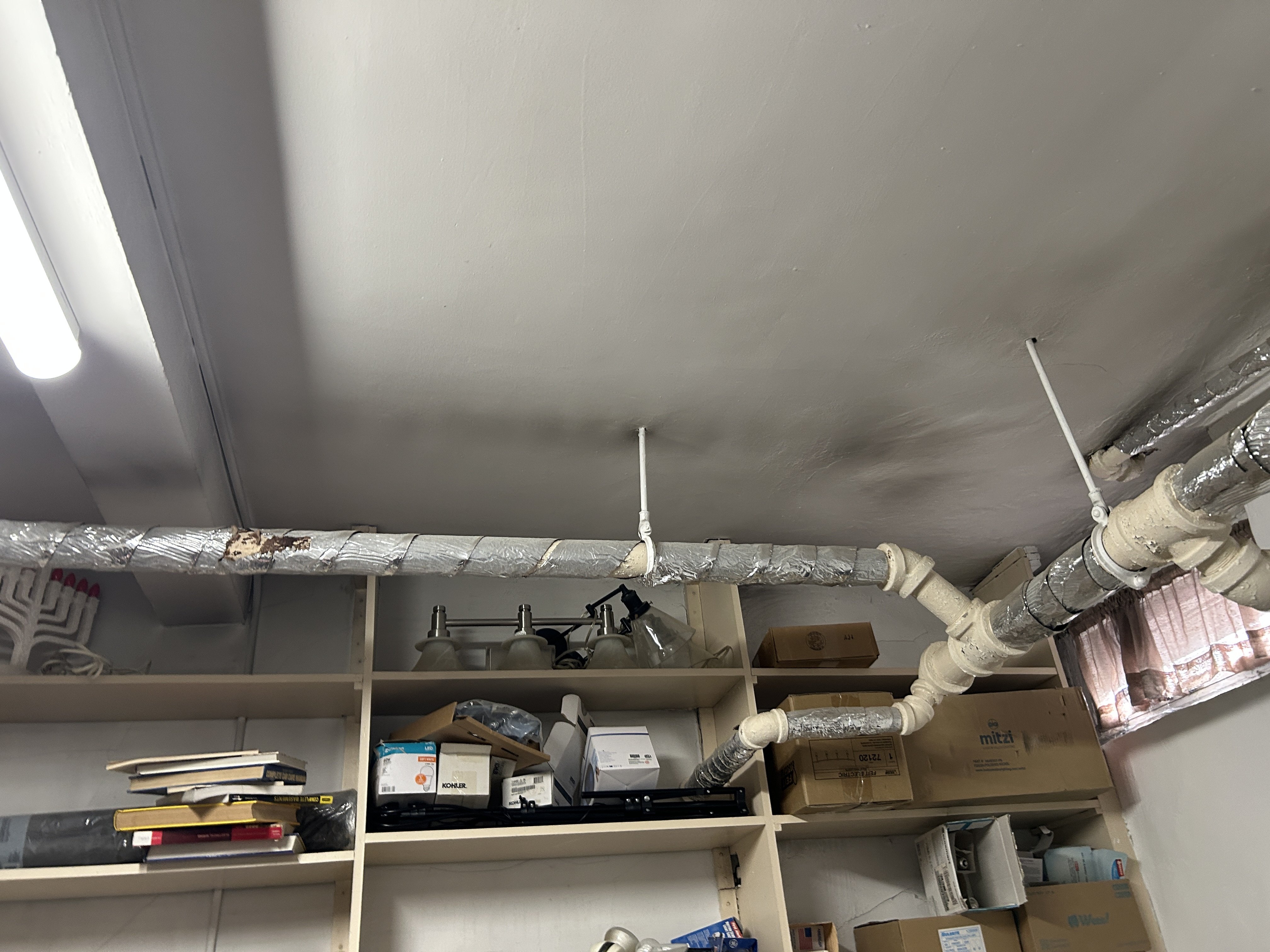

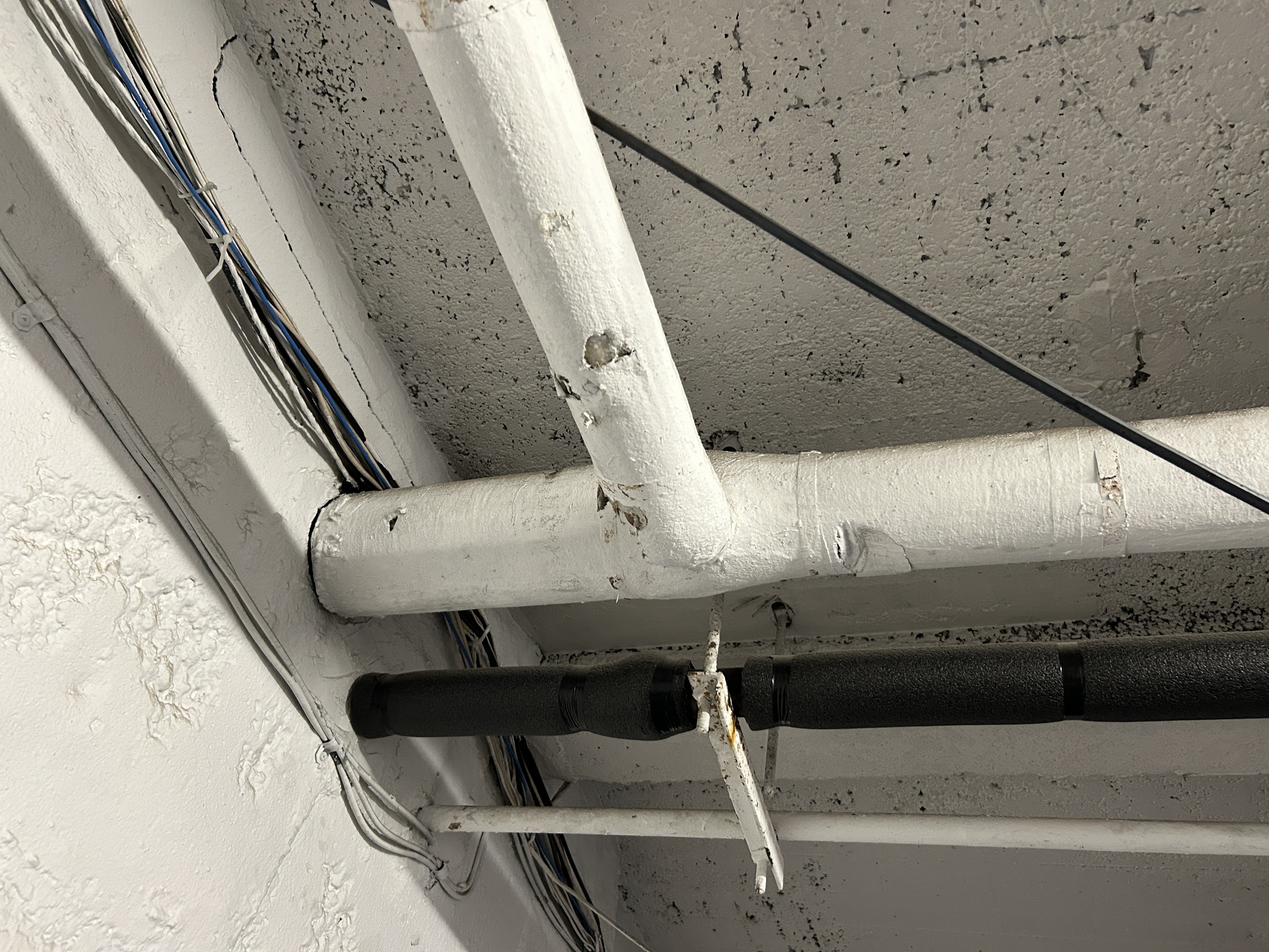

3. Pipe Insulation
Some sections are not insulated or not properly insulated
4. Improper Condensate Pitching
Some sections of condensate piping doesn't have enough pitch or has a positive slope.

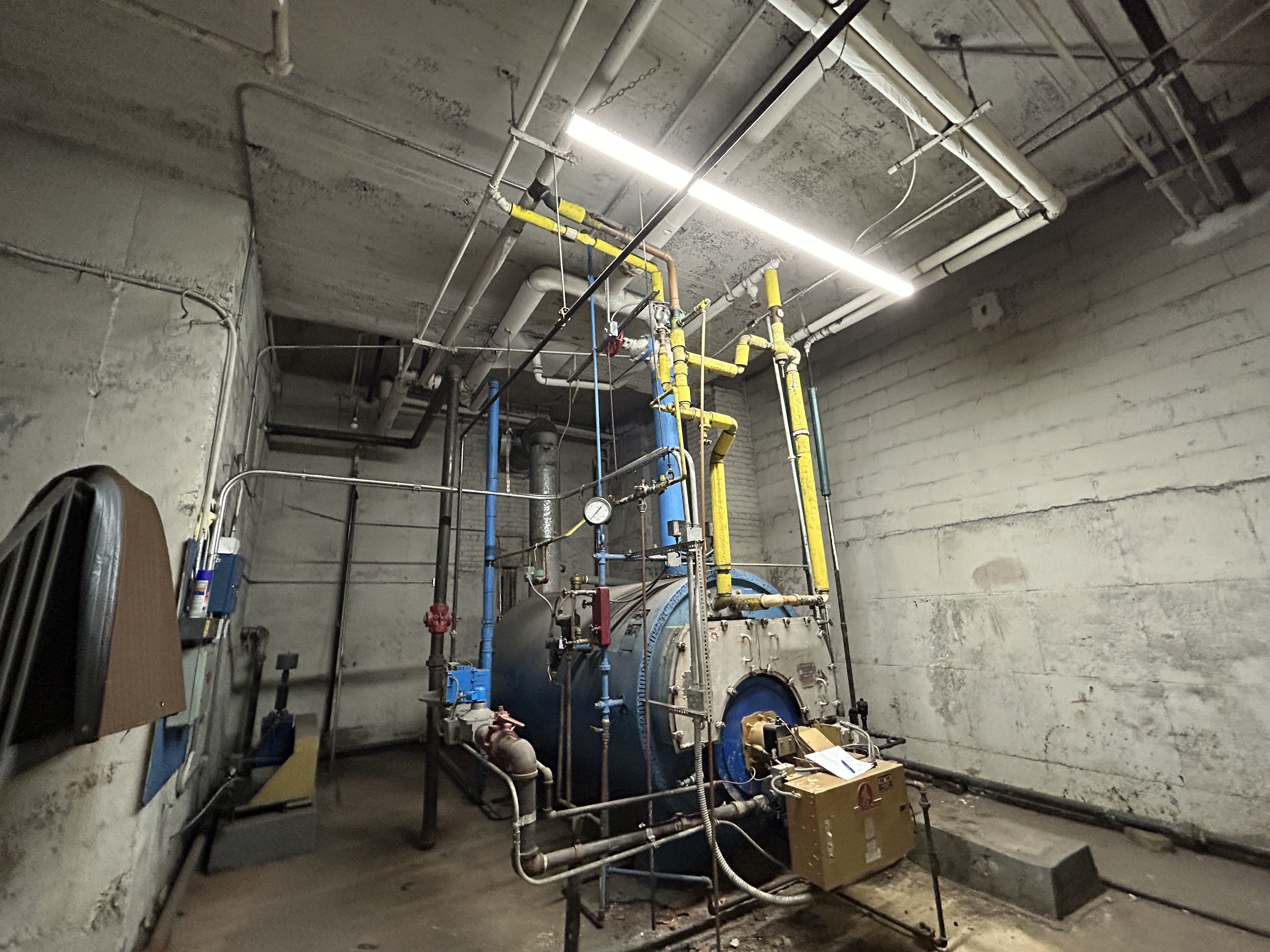

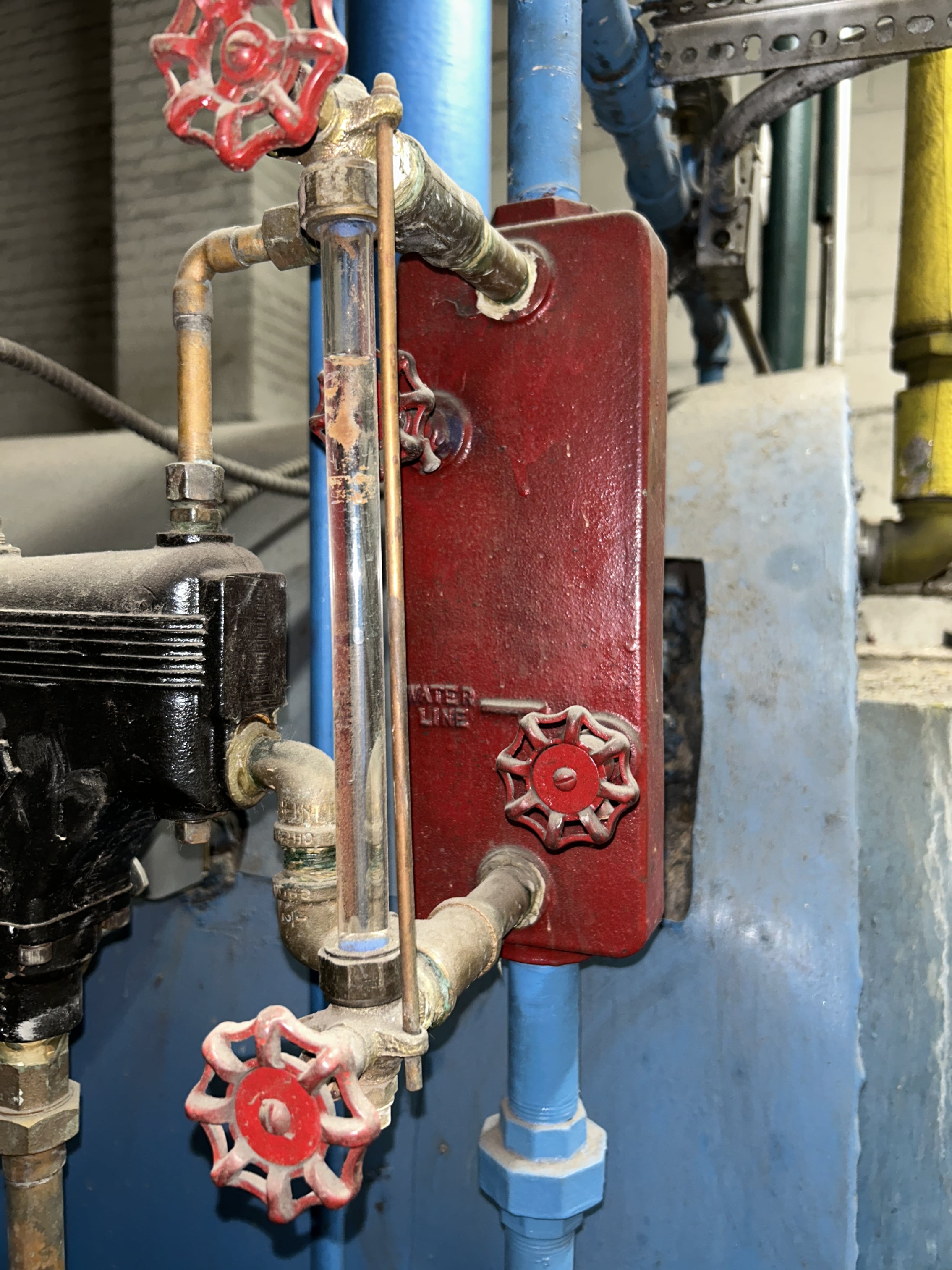

    EBEBRATT-Ed Posts: 21,100
    Lets see the boiler header and the boiler piping. Is the water line steady when it is steaming?
    mattmia2 Posts: 18,158
    i'm not super familiar with that type of boiler but it looks like it is afire tube boiler. i'll let others comment but it looks like the interior of the boiler is completely filled with water not giving the steam any place to separate from the water.
    the rules about headers don't apply the same way to an older boiler as they do to a modern boiler, the interior of the boiler should have more space for the water and steam to separate, making it less critical that the header is set up to do that job.
