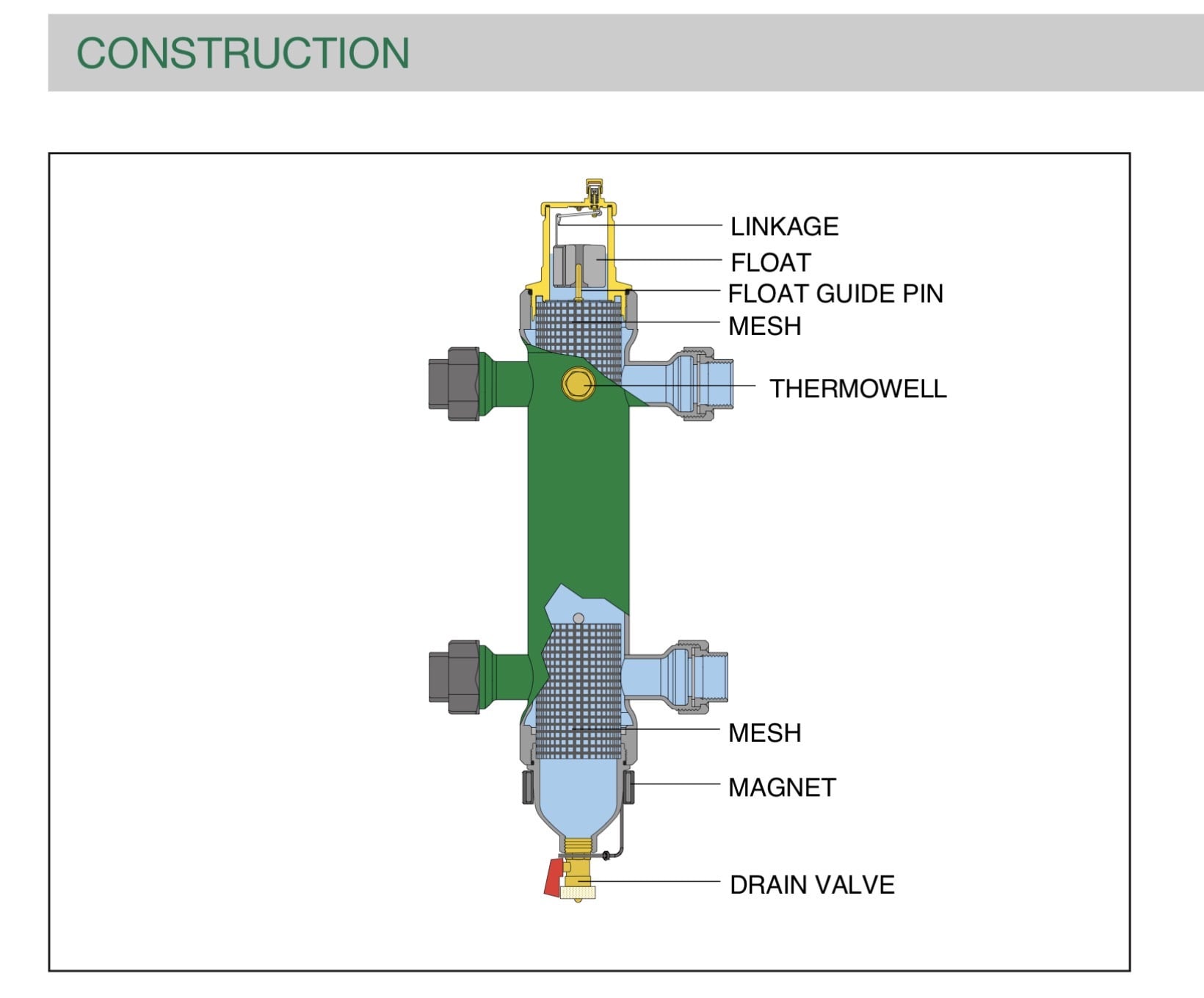

    A quality separator would have a microbubble air eliminator inside to speed air and microbubble removal. A good sep should be high 90% efficient for air removal. As well as other features to protect the system.
    Seperators are sized or should be by the velocity in the center barrel. If you want additional fluid capacity a small buffer tank is an option. We see wall hung buffer tank versions in the 7-21 gallon range available now.

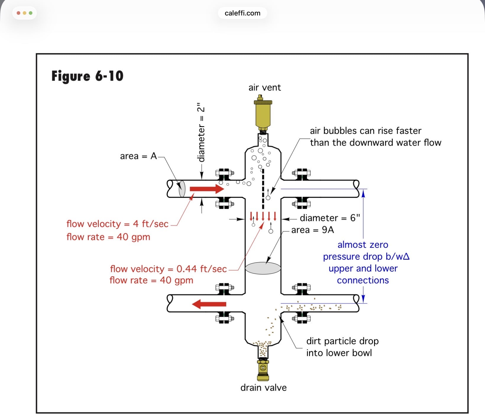

    Here is the math on Caleffi seps
    The barrel is 9A, nine times the size (area) of the connections, on smaller sizes that is about 3-1, so a 2” sep would have a 6” barrel.
    The goal is flow velocity top to bottom near zero.
    I have tested some brands of seps that don’t separate ! The barrel size is too small and fluid blasts across.
