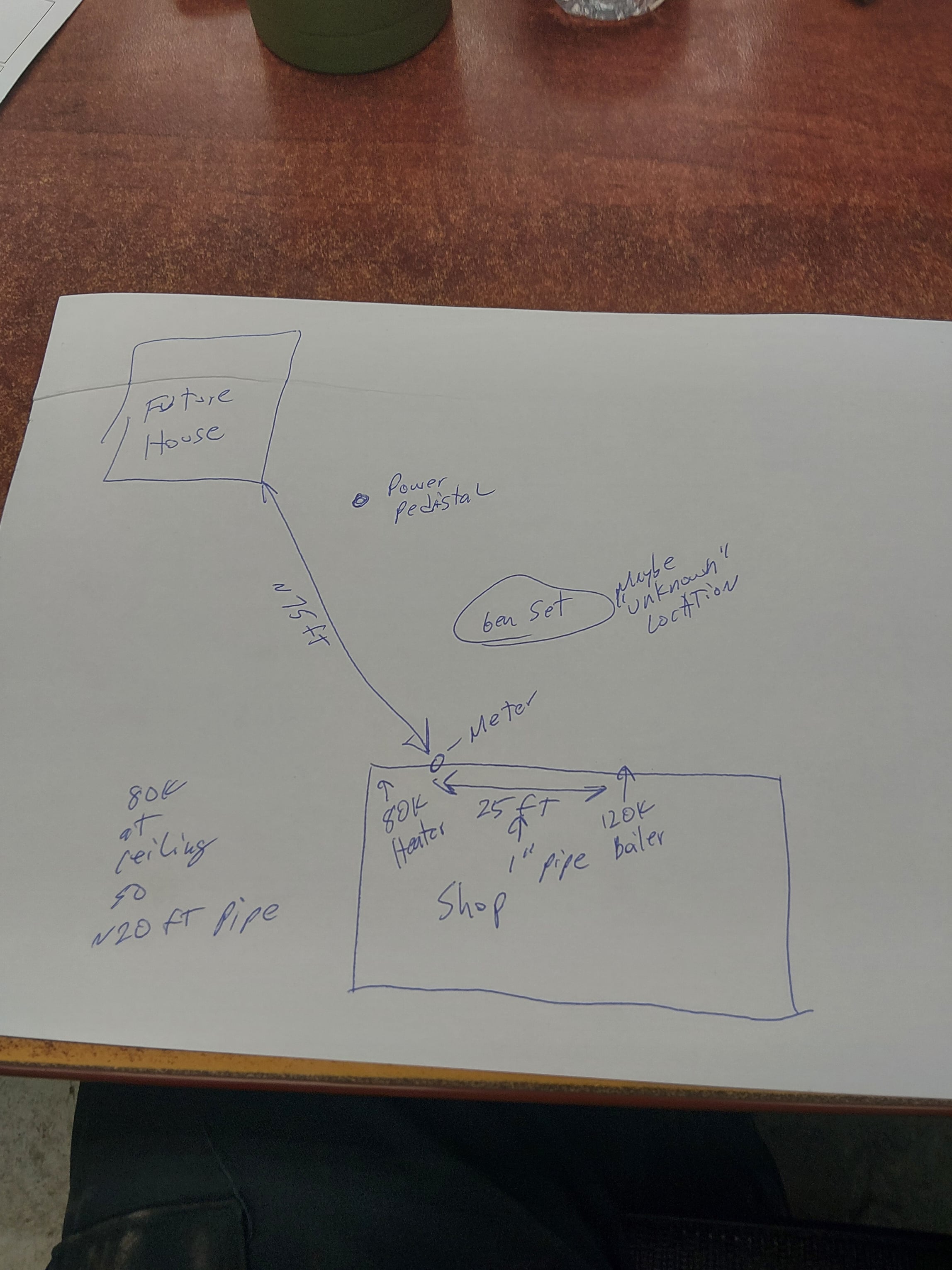

    Meter is on the building. Manifold would be at the meter. 1" in the shop, never said 3/4" other than that is the existing pipe.
  • nate379
    nate379 Posts: 185
    Drawing. Sorry not a good drawerer, but gets the idea across, least to me me it does. House and gen set don't exist now, so hard to say exact figures.

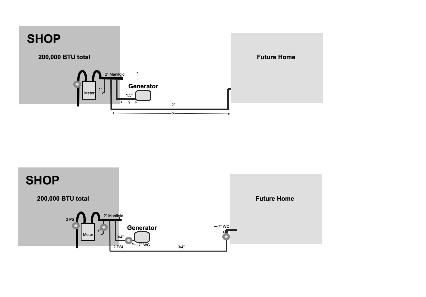

    Will the new building piping start at the manifold and go to the new building at the lower pressure? You will need bigger pipes. If the gas company will allow higher pressure, then you can use smaller pipes with a second stage regulator at each termination.
    The second stage regulators will drop the pressure from 2 PSI to 7" WC where you enter the building and just before the generator. You can use smaller pipes for the 2 PSI Gas.

    It's possible to do 2psi, though don't think I can do it now based off of speculative work. I have to prove it's required. Also from what I'm seeing, all the piping would have to be done by a licensed plumber and get signed off by gas company. Where std setup, they just inspect the meter through the wall and it's on you after that.
    I suppose either way would regulate down before the shop, so piping would need to be same size for the 2 heaters I'm dealing with now.
    2" burial line is fairly cheap, so not sure it would pencil out $$ wise to deal with the 2psi. That's a future me problem I guess!

    Make the 4 port manifold at the meter make that 2". Leave the tee for the house and tee for the gen (future) at full size 2" because you don't know the pipe size yet.
    Off the manifold run 3/4" to the boiler and 3/4" to the new gas heater. If the heater and boiler are coming off the same manifold branch use 1" up to where they split.
    Obviously the meter has to be sized for the entire load although the boiler and heater will probably not run at the same time.

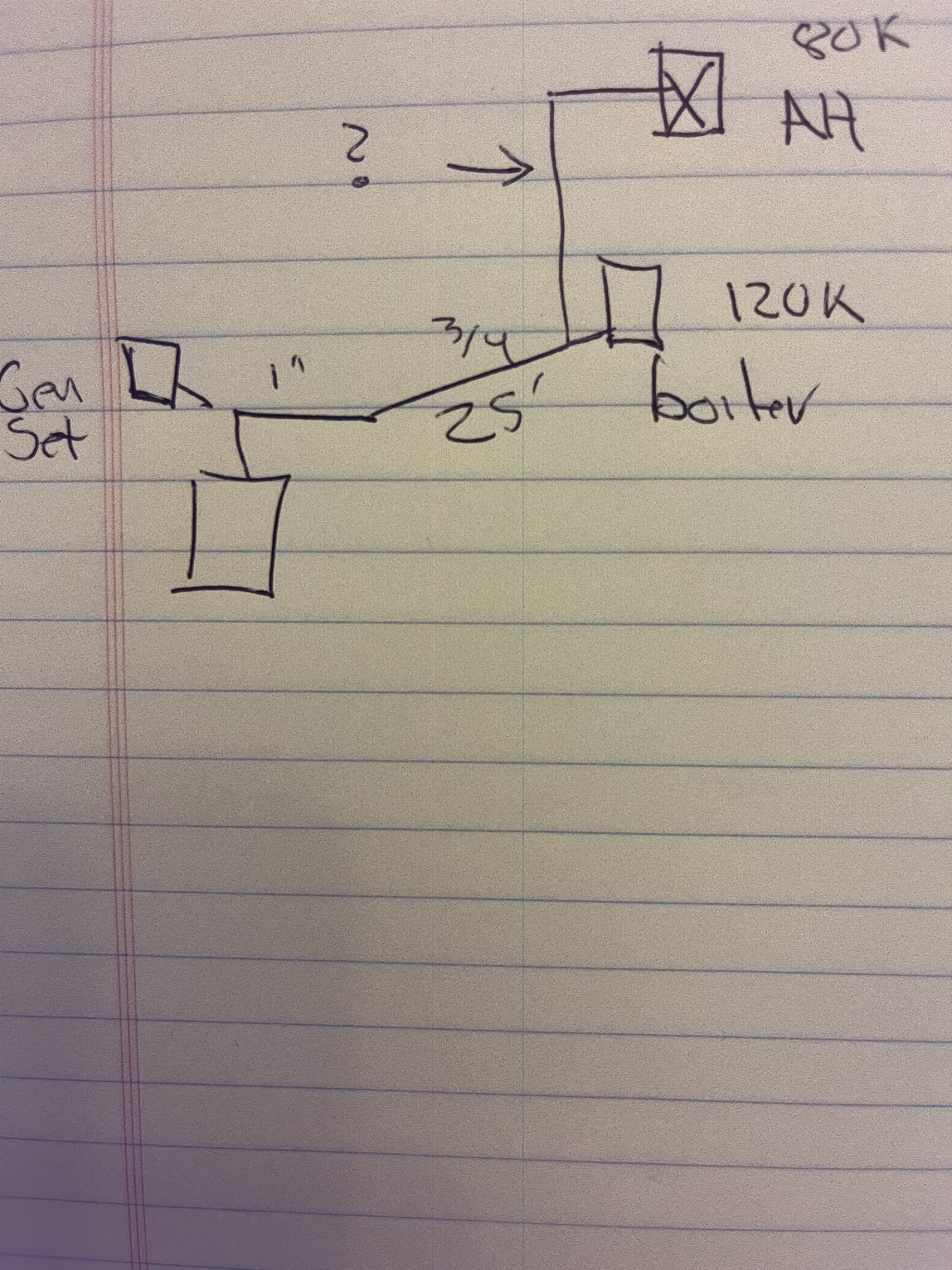

    Boiler and heater likely will run at the same time. Like if the shop door is open, or something cold is pulled in and it cools down the building. It's not the arctic, like where I work, but we do have a good period of time each year that is around -25*.
    The pipe coming in the shop is 1" and reduces to 3/4". 3/4" runs to each heater? The 80k heater is fairly close to where that 1" comes in, just the pipe will run to near the ceiling.
    hot_rod Posts: 28,799
    use the chart to get in the ball park, 3/4” can handle 152,000 at 30’ length
    So start with 1”, run to two loads with 3/4

    Mine says 3/4 will do 198cfh @30'
    Either way. They way I laid it out in my previous post should work fine. 2"@" manifold to handle the entire load of 740 located at the meter. 1" into the building will feed the boiler and the heater with 2 3/4" branches. Gen and house to be added at a later date.

    It might make more sense if you have enough pressure at the street to get a 2 psig service and put regulators at the groups of distribution equipment. 3/4" could handle the whole load, each of the branches could probably be 1/2"
