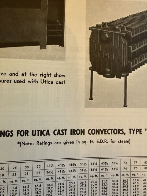

I'm on a residential job where I have to find out the connected load of hot water convectors in order to size the boiler. These are the kind of finned convectors that are recessed in the wall with large metal enclosures.

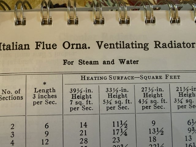

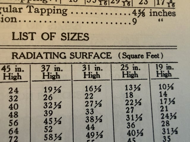

I noticed that the EDR ratings in Dan's book for these types of radiators specify "for steam" and even "for steam at 215F and 65 degree entering air temperature" where the EDR ratings for radiators just say "ratings" or "heating surface" or "radiating surface".
I can imagine that finding the EDR for the finned convectors is much more difficult than for cast iron radiators. The surface area of the fins needs to be calculated along with somehow figuring how much the enclosure adds as some of the convectors will have a greater output with a larger enclosure.

The BTUh power of a radiator is a function only of the average temperature of the radiating surface — a rather complicated function, to be sure, but reference to tables works if you have them — or, in a pinch, a simple linear relationship between the temperature of the working fluid and the space temperature works (the BTUh output is around 1.7 times the difference between the working fluid temperature and the space temperature — to two significant digits. Close enough, as they say, for government work…) Stick an enclosure around it, though, and it gets messier, since the balance between direct radiation of output by convection becomes very different. And honestly I'd really want to have experimental data for hot water convectors…
If you have Finned convectors just measure the size of the fins (4' x 3" for example) and the length of course. Then go on-line to Sterling or Vulcan Radiator etc. there are others Tunstall assoc is another good source and find the rating for a convector of about the same size.
The MFG can tell you what the derate is for putting it in an enclosure.
Will it be exact? probably not but it will be close enough. 215 deg and 65 entering air is just a standard they use to rate baseboard.

If you have what has been the standard residential convector you have something that is about 6"x36"x24". If that is true then it will have a 5,100 BTU rating based on a 20°∆T over the entire system. Many of those convectors were installed with monoFlow® tees on a one pipe loop around the basement ceiling. If you have something else, then you need to look up that manufacturer's info. Are you looking at a MonoFlo® system?
But the question is this. if you are sizing a replacement hot water boiler then why are you not doing a heat loss. if your home is over radiated as a result of insulation and sealing up the envelope, then you don't need a boiler as big as the connected radiation unless this is a steam system. You mentioned "Hot water" so do the heat loss … not the connected radiation.
