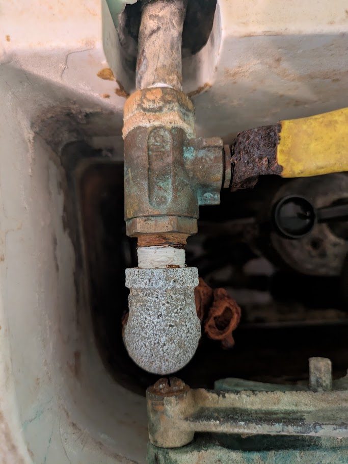

1929 house. Toilet tanks have no holes in the ceramic bottom of the tank. Instead, threaded pipe comes in, over a notch formed into in the the top lip of the tank, and then dives straight down, into the water. Galvanized pipe. Brass valve. Copper flush valve cage.
So. It turns out, that there's this thing called, "galvanic corrosion".
…And while, naively, you might think that maybe the name might be a bit of a clue, but… no.
So approximately 10:00 at night, having spent the last decade or more dutifully donating its iron to help electroplate… well… every other metal object in the toilet tank, and incredibly, half the plastic parts too… the 90 degree, formerly galvanized elbow in my son's bedroom toilet tank finally decided to spring the kind of leak that shoots water in a 6 foot tall fountain arch all the way to the other side of the bathroom, the moment that you take the tank cover off.
Yeah. Not only is that thing paper thin, but it has a rust brown stalactite hanging off of it that looks like it was transplanted straight off the side of the RMS Titanic.

i would probably use brass or stainless, not steel. the old ballcocks had a plastic or copper float.
does that fill valve have a vacuum breaker built in to it?
i assume that is copper coming out of the wall since it has a compression fitting.
Looks like someone piped a Fluidmaster 400A in there.
@jcwenger , can we get a pic of all the works in the tank?
