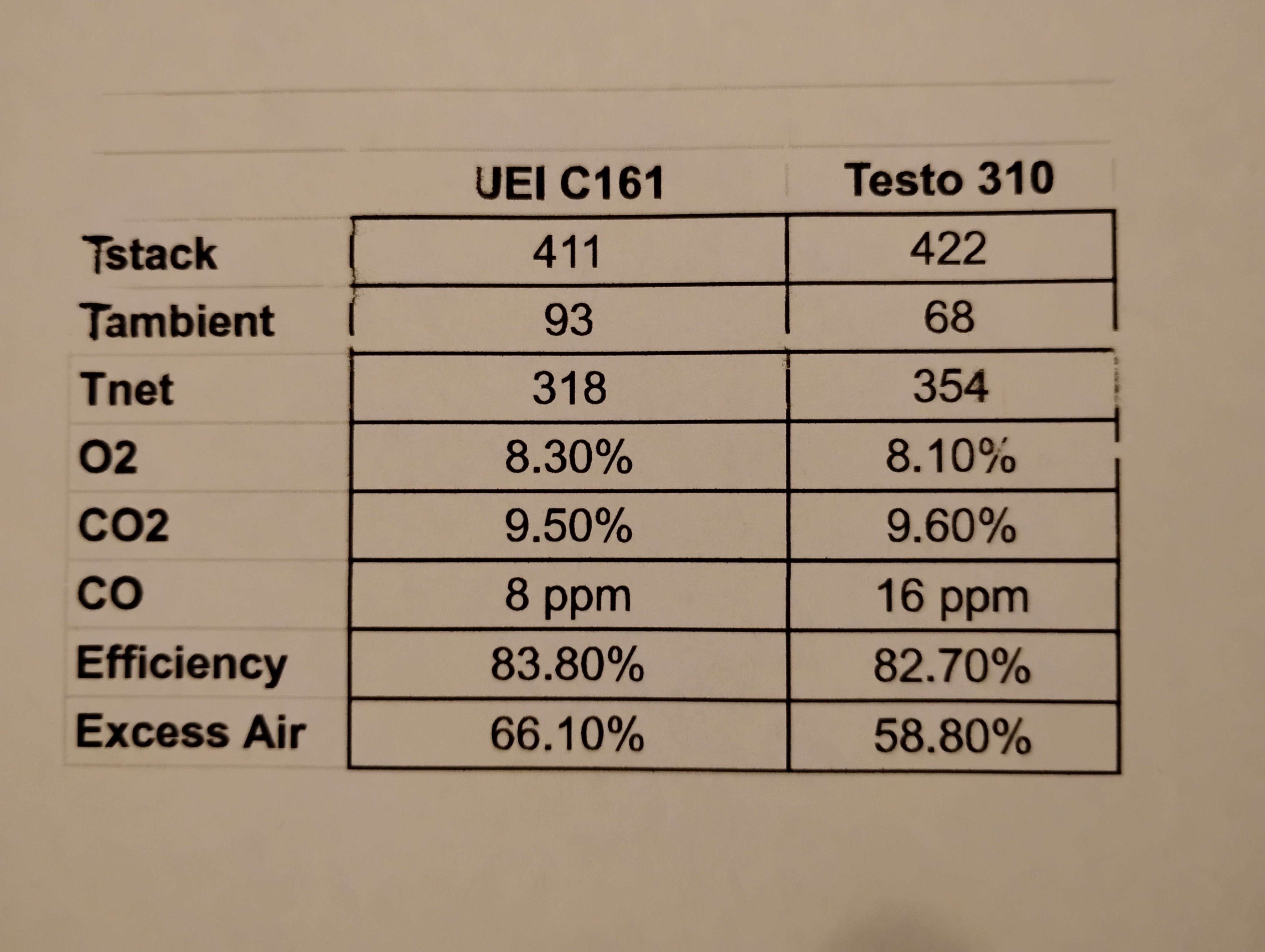

I took the plunge and bought a new Testo 310 which came yesterday. First test was to run flue gas analysis on one of our oil boilers that was serviced last month by our oil company. He left a printout from his UEI C161 analyzer last month, so I have good reference points for comparison.
Agreement between the two devices was quite good on the O2 and CO2. The main difference was CO, where he got 8 ppm and I got 16 ppm. I noticed his printout said "calibration due 1/22/26," which was 9 months ago, so his CO sensor might have been off. My new Testo was factory calibrated 5 months ago.
I also noticed his Tambient was 25 degrees too high, maybe because his probe was too close to the stack when he powered on, or maybe he had measured the draft first and the probe hadn't cooled yet. I made that mistake when I did a second run with the Testo without sufficient cooldown time in between.
Either or both of those discrepancies caused his analyzer to overstate the efficiency by about 1% and the excess air by about 7%. Not a big deal.

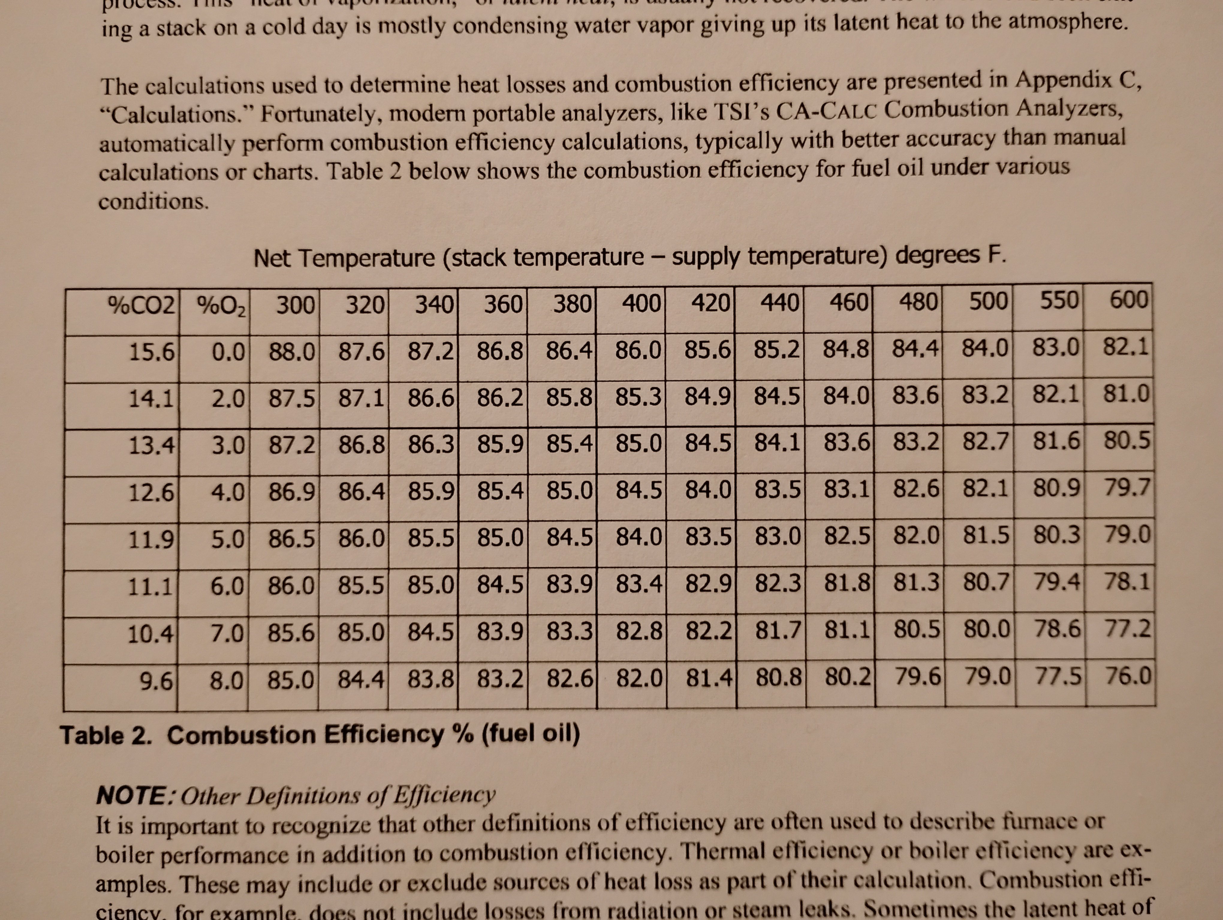

    Not sure what you're trying to say about combustion efficiency. As long as the flue gases are sampled at the proper location (right above the boiler and before the barometric damper), the Testo and the C161 will both give correct readings of combustion efficiency, which is basically a measure of how much heat is being lost as hot (dry) flue gas and hot water vapor. I've verified this by doing the hand calculations for both dry gas and latent heat of vapor losses based on flue gas composition and net temperature, and my hand calcs agree with both the Testo and C161 results. It would probably be news to Testo and UEI that both of their combustion analyzers are wrong.
    Since the combustion efficiency for fuel oil can be calculated knowing only the CO2, O2, and net temperatures, there are lookup tables already available. Here's one from TSI Incorporated's "Combustion Analysis Basics," page 12. If you look at the bottom line, you'll see those numbers for CO2 and O2 match ours closely, and for a net temp of 360 (close to our 354), the table gives a combustion efficiency of about 83%, very close to the results given by both the Testo and the C161.
    I understand there are other measures of boiler thermal efficiency (such as cycle efficiency), but that's not what we're talking about here, as the Testo and C161 are only measuring combustion efficiency, and are doing so correctly. If and when I try downfiring to a 0.75 nozzle, I will of course run the Testo again and see if combustion efficiency changes, and by how much. I would point out that we're already downfired to 80% of input spec, with no measurable loss of combustion efficiency. Even if we had a spec nozzle, we would still probably be around 83%-85% combustion efficiency.

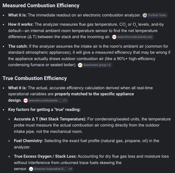

    Re the "true" combustion efficiency as taught by NCI, could you point me toward some technical references that explain how they define that mathematically? I'm curious, because the combustion efficiency measurements made by Testo, UEI, and other analyzers use widely-accepted standard formulas for calculating the heat lost to the flue gas and water vapor in the combustion process, and I've gone through those formulas by hand to make sure I understand them. There really isn't anything controversial about them, it's basic thermochemical math. I don't know Jim Davis but I've seen some of his posts here, and I gather he is something of a contrarian on topics like AFUE, but I haven't seen enough of his material to understand what he means by "true" combustion efficiency, and how that might differ from the widely-accepted definitions and equations used by pretty much the entire commercial and residential boiler industry. But I would like to understand what Jim defines as "true" combustion efficiency, and I would read what he has to say with an open mind if you can point me in the right direction.
    hot_rod Posts: 28,789
    edited October 8
    Additional info from a search. with references.
    Not sure where you are headed knowing that the poor cycle efficiency is, or should be your bigger concern. Tripping over dollars to pick up pennies.

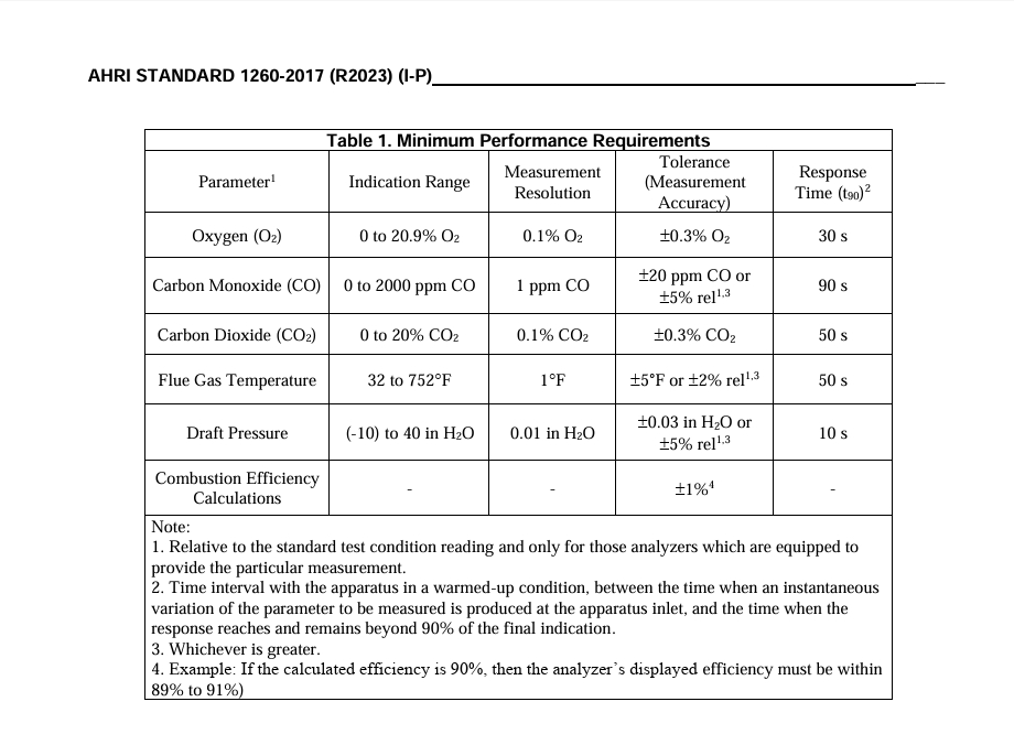

    @hot_rod Thanks for those references on "true" combustion efficiency. I understand the importance of taking correct readings on ambient combustion air temp, selecting the correct fuel in the combustion analyzer, and having a good/calibrated analyzer that will give correct O2/CO/CO2 readings. But as far as I can see, that simply means using the combustion analyzer correctly, as it was designed and intended to be used. I know you and other heating pros are trained on the correct use of analyzers, so by that definition, you're getting "true" efficiency readings when you use the analyzer per the mfr's instructions. And as I showed with my Testo vs. C161 example, when I followed Testo's instructions for correct use of the analyzer, I got basically the same results as my boiler tech did with his C161 (though I did note his lower CO reading which I suspect is a calibration problem, and his incorrect Tambient). So I would say that we both did get "true" combustion efficiency numbers, with the caveat that I think my Testo number is slightly "truer" than his.
