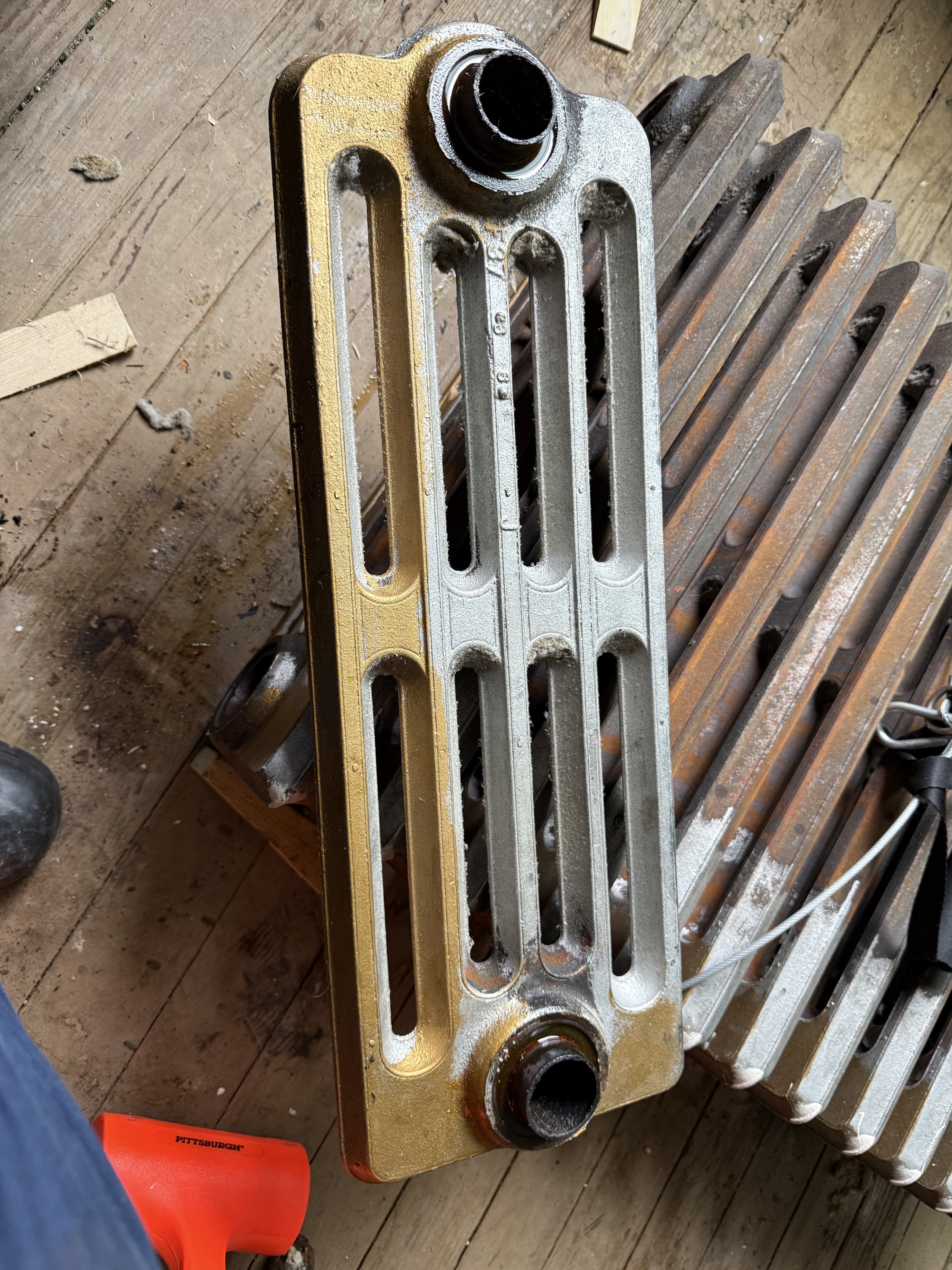

What it wrong w/ the current ones? You may very well be able to clean those up w/ steel wool and add a skin of sillicone to the male and female sides the use the draw rods to pull them back together. I have can great luck w/ that.
Depending on you location you will need to hit a established supplyhouse to see if they have old stock.
