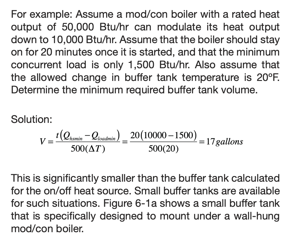

1,100 sq' ranch over a finished walkout, 4 different types of heat emitters, fan coil, heats entire main floor, fin tube base board, (heats half of basement, family room, laundry room and a mud room entrance, a 30"x30" Runtal panel (used as a point of use towel warmer) and radiant under 3/4" engineered hardwood over Warmboard, this is in the most recently finished second half of the basement, a small gym 12'x'22'. The radiant, 250' of Pex-Al-Pex has the lowest estimated figure of 7.5k btu/hr. This boiler has a 10-1 turndown (15.5K), sizing with a run time of 20 minutes comes up with a tank size of 16 gals, 10 minute run time yeilds 8 gallons. SupplyHouse offers two Zilmet Buffer tanks, one at 14 gals and another at 7 gals.

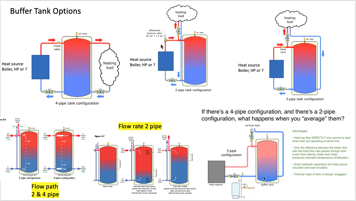

2 - 2 or 4 pipe configurations? Idronics #17 gives a great overview of the two scenarios especially with respect to liquid flow rate and path through the tank. Would the two pipe config be a better fit with the three different types of heat emitters? I don't think a delay in heated supply is a concern in such a small dwelling. The fan coil gets the most use during the heating season, fan coil target temp will be at 155f, I'm thinking the 4 pipe might give a lower return temp?

    Here is the math to answer the question. Basically the lowest turndown which should be around 15,000 for that boiler, the manual will tell you.
    Against the smallest load (zone) it could see.
    Shoot for at least a 10 minute run time.

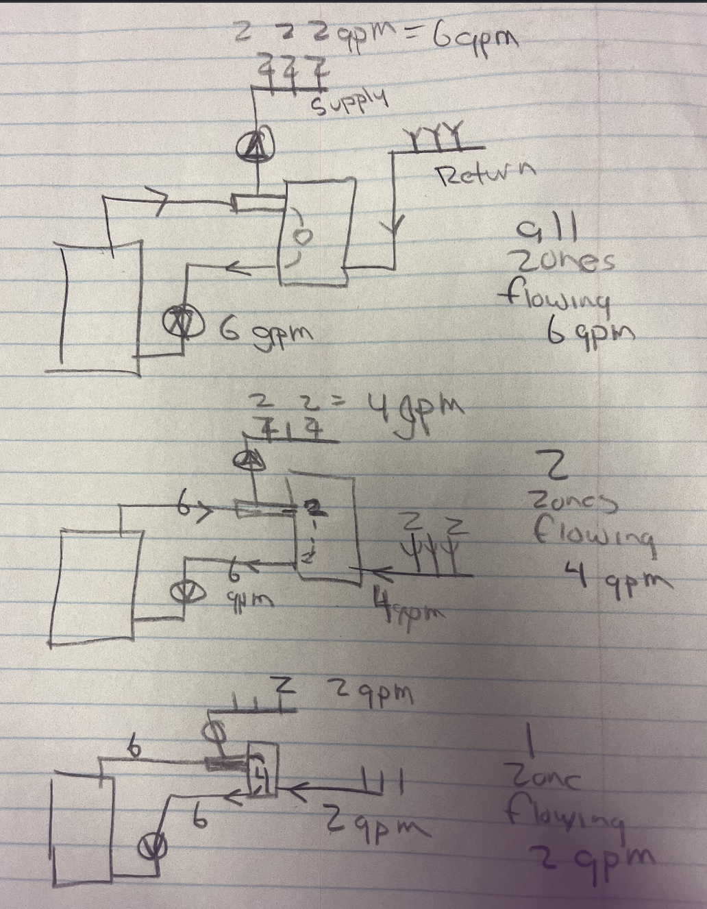

    I like the 3 pipe buffer piping. The Zilmet tanks work nicely, good connection size and location, well insulated with a wall mount bracket. I like everything except their piping diagram :)
    Direct to load, 3 pipe buffer piping bottom right here.

    hot_rod Posts: 28,799
    A 3 zone system with zone valves. 2 gpm per zone
    Boiler pump is 6 gpm constant, system pump is 6 gpm.
    With all zones calling 6 gpm from boiler goes to system, no flow movement through the tank. The large pipe at the tank is a hydraulic separator.
    With two zones calling 4 gpm total goes to zones, 2 gpm moves down through the tank.
    With 1 zone calling 2 gpm load, 4 gpm moves through the tank.
    When all zones are off 6 gpm moves through the tank until it reached the desired temperature. It will stratify a bit.
    Next heat call flow comes only from the tank, until it drops low enough to call on the boiler. This is the buffer function at work. The wider that control delta the more tank buffer you get. Try 30 delta. If the system under-heats on the coldest day, try a 25 delta.

    Bob we just fires up a system this week- my guy sent the boiler supply to the bottom and the boiler return at the top. It’s just a 20 gallon tank.
    the system supply is at the top and the system returns at the bottom
    Boiler is 85k and the heat loss of the home is maybe 1/2 of that. 8 heating zones. Seems like we are “mixing” the entire 20 gallons. Should we swap the boiler pipes ? Won’t take long. It’s heating the home (it’s barely cold here in New England).
    I would suggest the repipe change. Sounds like a 4 pipe buffer?
    Consider the 3 pipe direct to load, you can pick up about 10% efficiency on the HP. Going from a 4 to maybe 4.4 with a 3 pipe.
    The 4 pipe blends the return temperature lowering efficiency. Both with a HP and mod con.

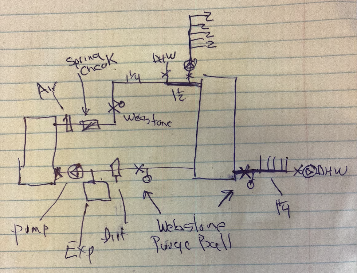

    Thanks much for your replies and insights on different buffer pipe options, I like your suggestion of the three pipe set-up, Ive been following several similar discussions and you suggested and drew up a diagram to jesmed1 that would mimic my system.
    Question: If my Lochinvar supplied boiler pump (Grundfos UPMS 20-78) has an internal check valve, is the spring check you show on the supply line in between the air sep and purge valve necessary?
    The large 1-1/2 header will have just two pumps, one going directly to an indirect and another feeding four separate zone valves (I've decided to go ZV in stead of circulators, these two pumps also have internal checks.

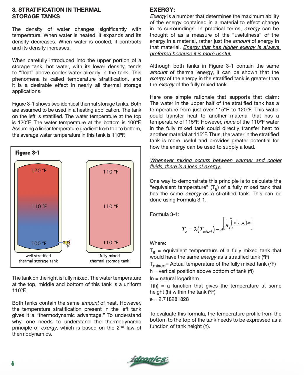

    When the loads are off and the boiler/ tank reaches setpoint, no circs are running, no flow through the tank. Hotter water rises just as it does in a gas fired water heater. The boiler side pump runs off the boiler pump relay. No need to run that when no load is present.
    In larger tanks there is some value to this exergy available in a stratified tank. It may be worth the chase..

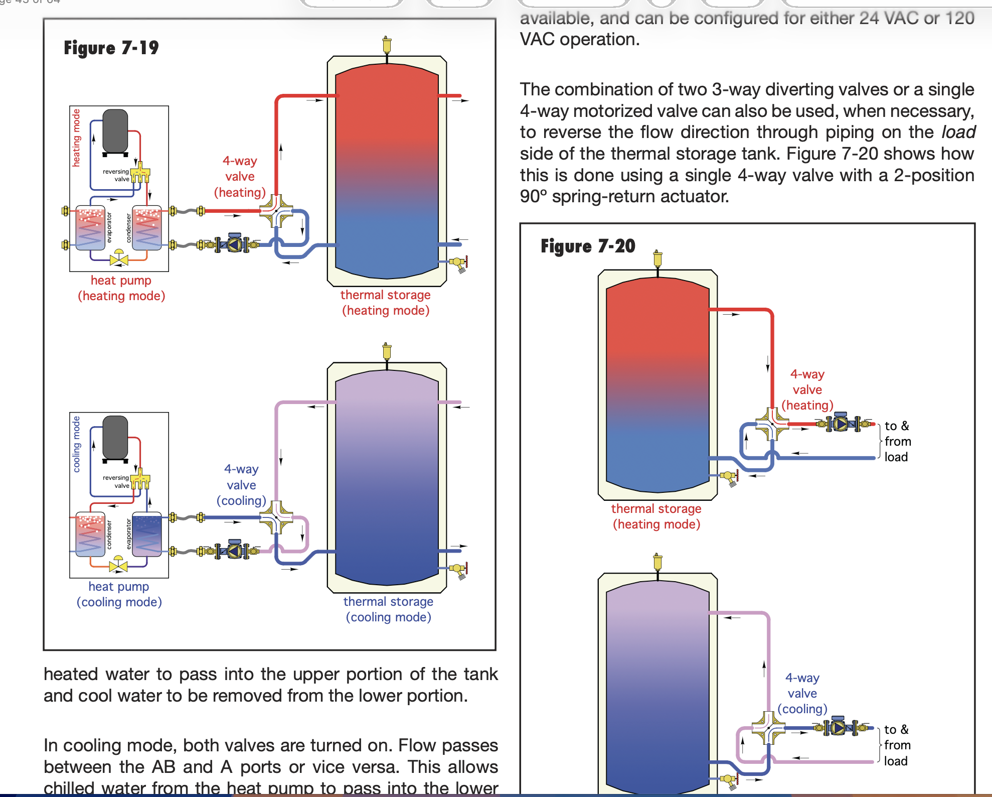

    There are a number of way to pipe and control depending on how far you want to take it.
    The small tanks are often considered inertial hydraulic separation and have some content for defrost cycles.
    When a single tank is used for heating and cooling, flow can be reversed to maximize the tank. A number of piping control options in various Idronics issues.
    you would not beed an additional check on the boiler loop if the boiler pump has a check
    You would need a check in the zone valve pump.
