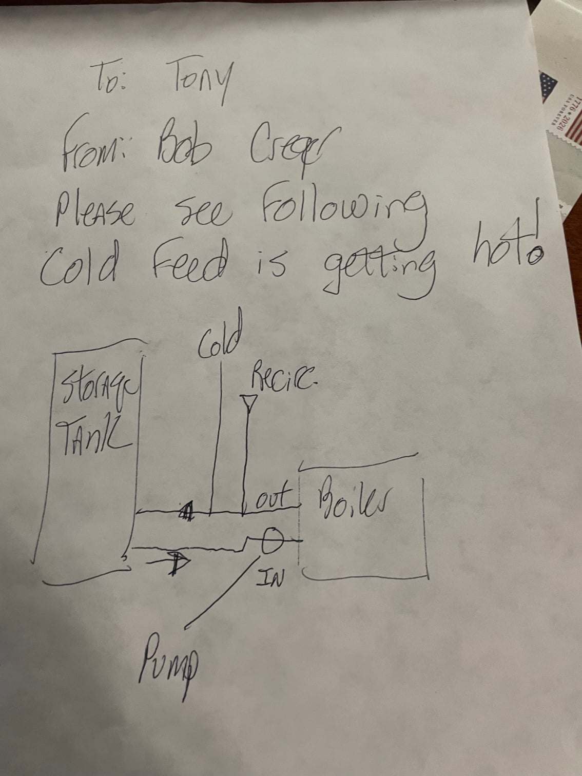

where should cold water feed be tied into boiler and recirc line-
this is existing system how water backing up into cold feed
Maybe put a check valve on the cold.
Hi, I'd follow Ed's advice and add an expansion tank in the cold, downstream of the check. 😉
Yours, Larry
