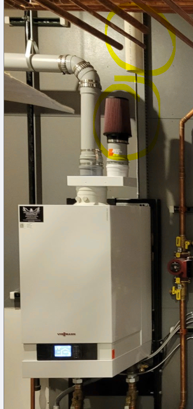

  • GGross
    GGross Posts: 2,104
    It's more of a recent install method. Personally I only know one guy that does it. he calls it a hybrid intake. basically he pipes the fresh air to the boiler but cuts it off before the connection at the boiler, adds a high performance k&n filter to the intake port on the boiler. He uses it on all of his Viessmann installs. while it would help with bees, they would end up in the boiler room 😂

    GGross Posts: 2,104
    larger ones still look like the pic above, they use an adapter to get to 2 pipes. the standard residential units are all built in though. they have a concentric connection and 2 intakes that come factory plugged. one for polypro, one for PVC. so you just take the plug out of whichever intake you use.

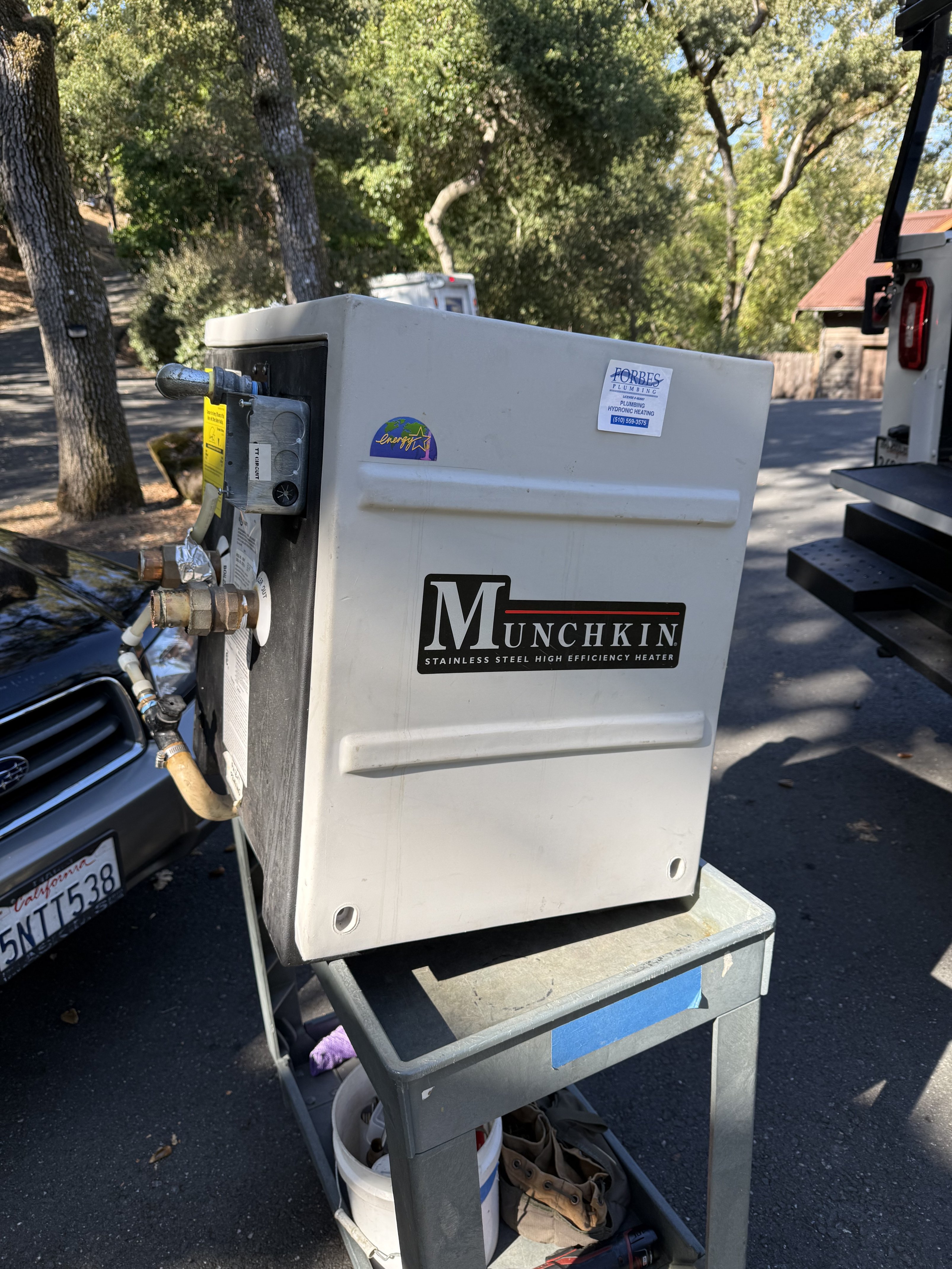

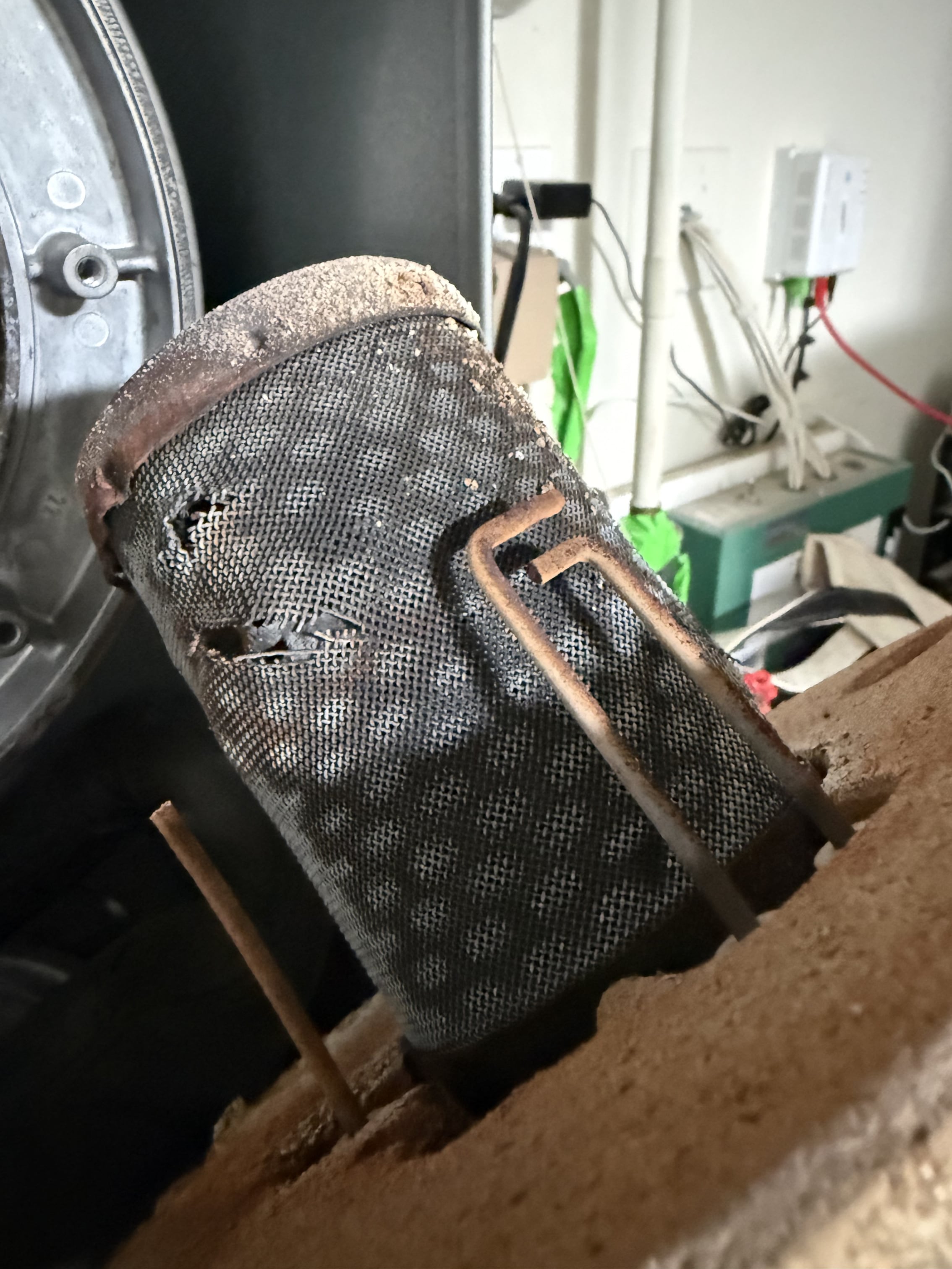

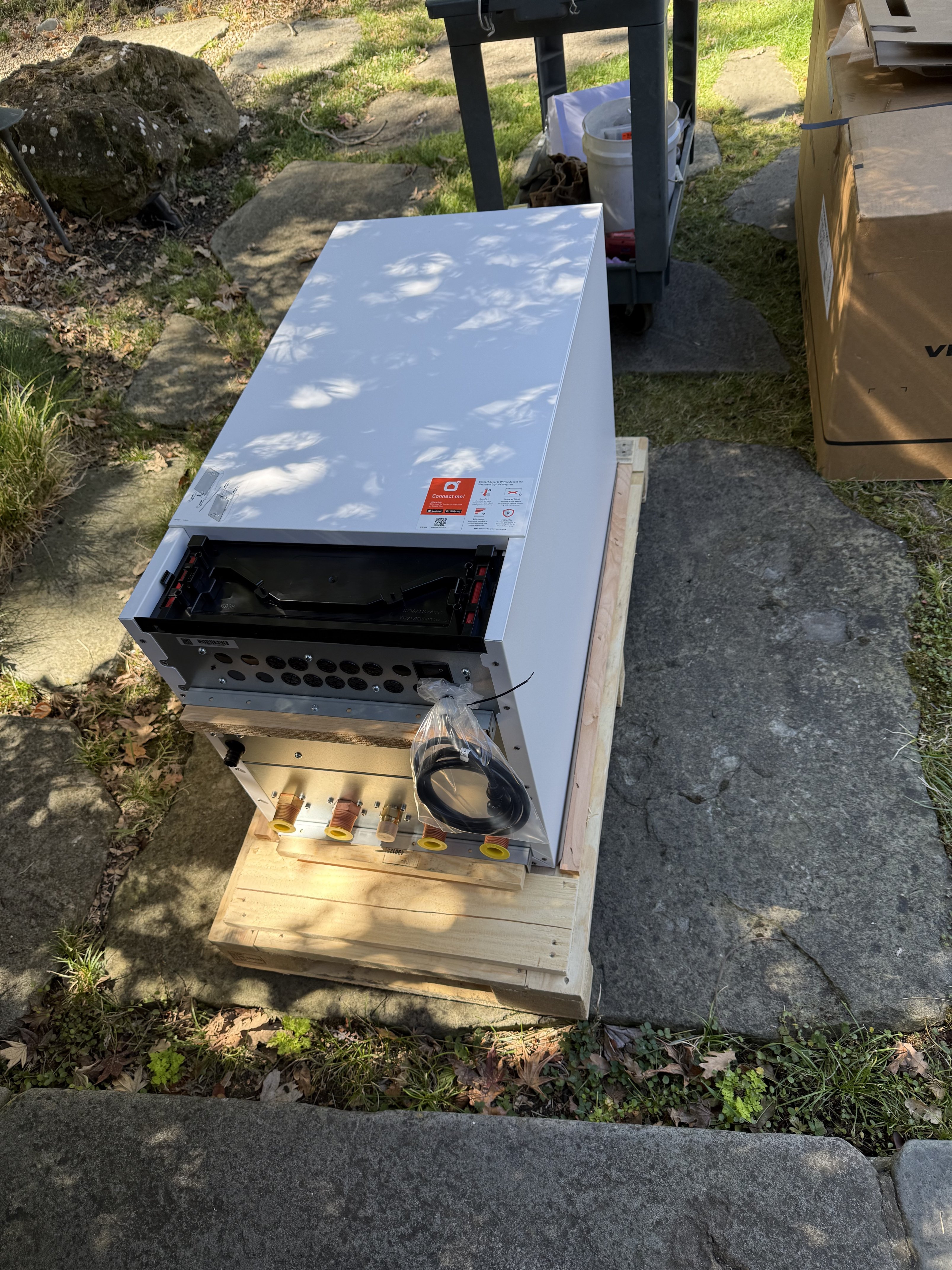

    We are just replacing this 20 year old Munchkin with a Vitodens 100 (model B1HC-150) because I advised the owner it was time. The Gianoni heat exchangers will spring a leak at this age and then you pay a lot more for emergency services in the middle of winter.

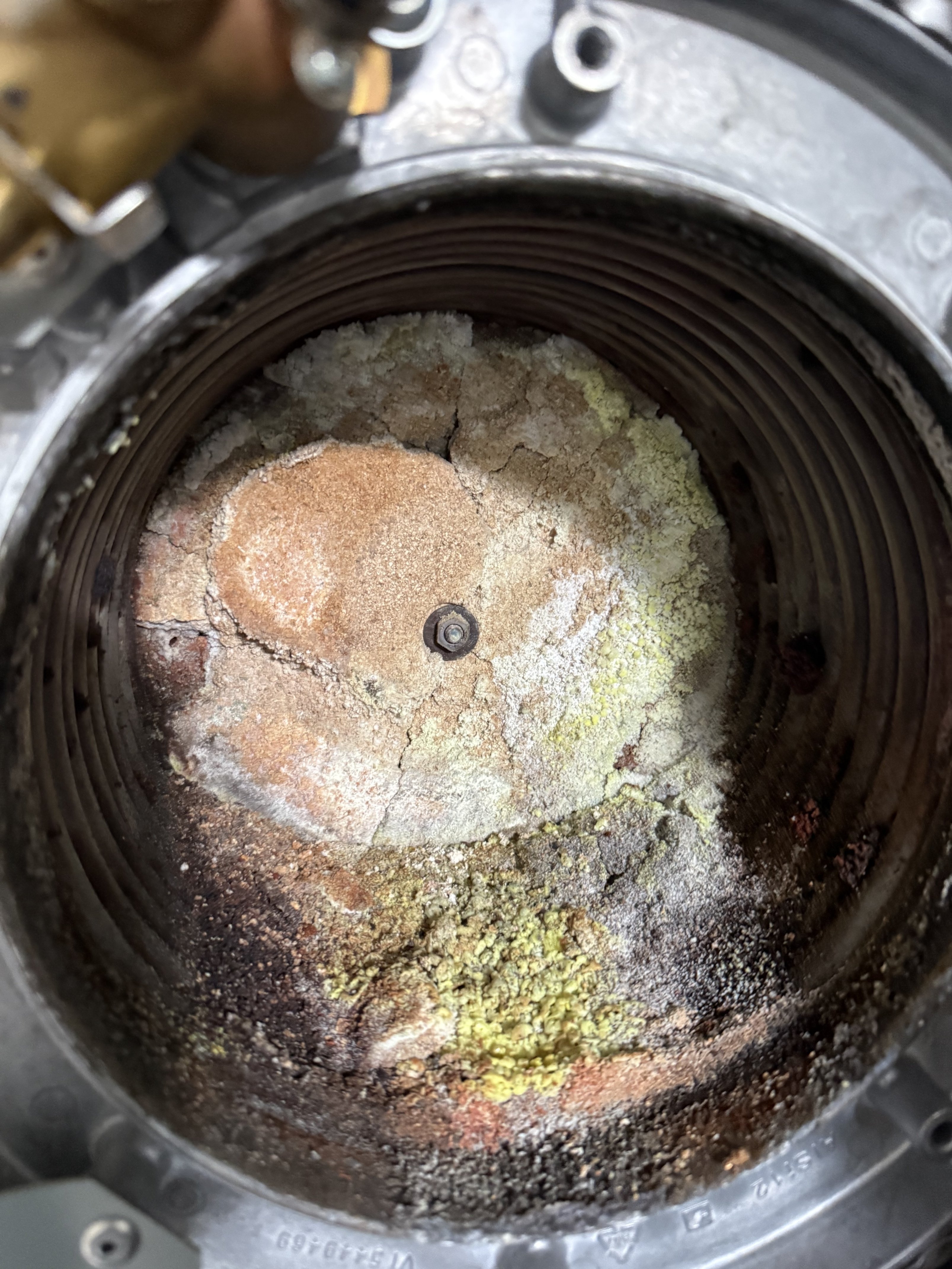

  • And then there’s this Viessmann that wasn’t maintained properly.
