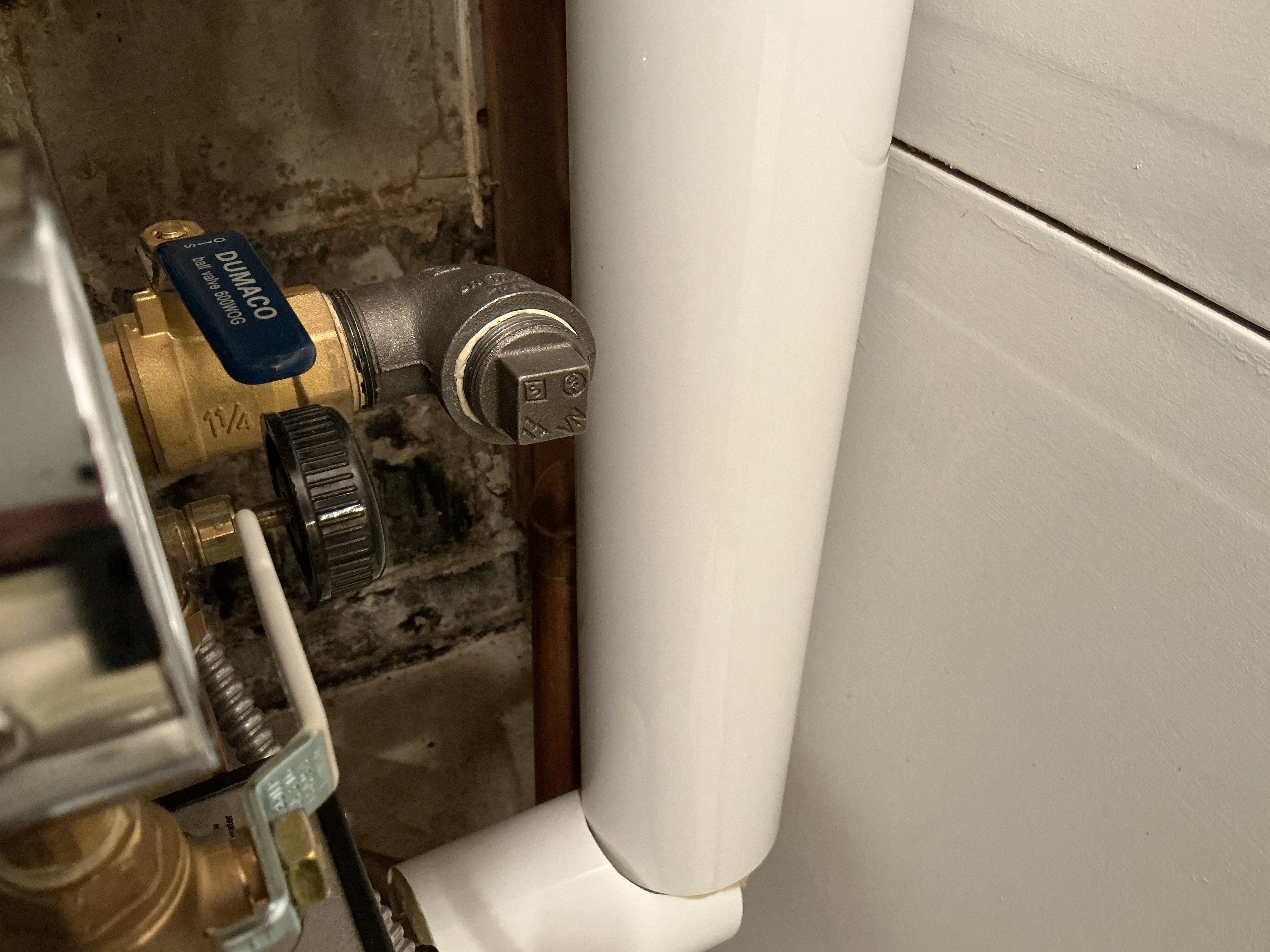

Woke up to some cooler temps this morning so I decided to turn on the heat this morning. Prior to turning it on I went and checked my water level and I noticed it had dropped about 5 inches in the sight glass from the normal level since sitting unused since about April? I don’t recall that ever happening before, or at least not that much of a drop. I added the water (manual feed only) and ran the system. Everything seemed to work fine.
How concerning is it having dropped that much over the past 6 months?

    There's a leak somewhere. Do any of your return lines run underground?

    and the leak has to be in a return or in the boiler itself. Critical question: was the water level below the Hartford Loop?

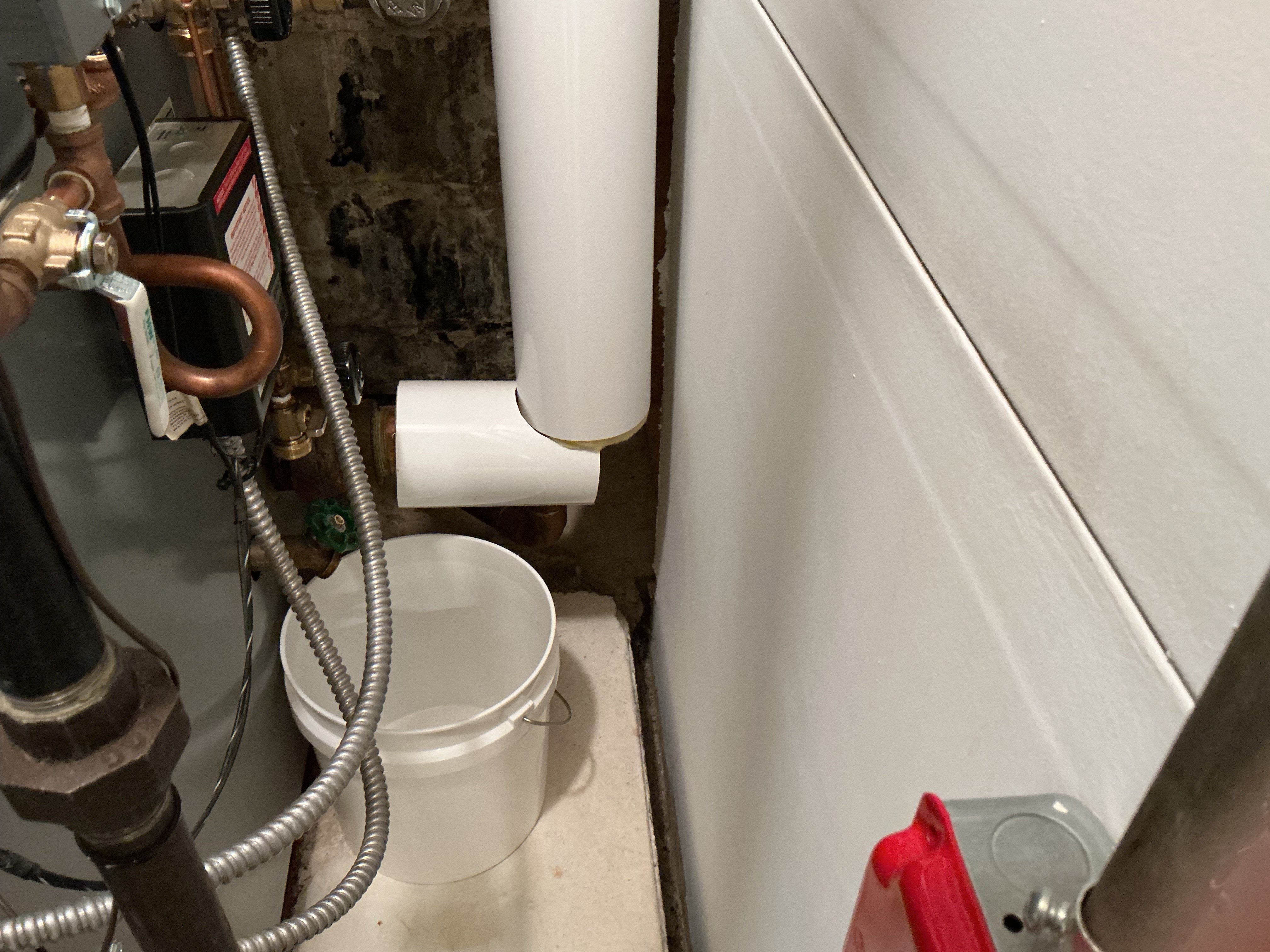

    None of the return lines run underground. The water level was right about at the same level that the Hartford loop returns to the boiler line. The return line is behind the vertical pipe, you can faintly see it in the second picture directly below the 90 degree elbow

    is the return overhead until it gets to the boiler?

    The return starts out about 4 feet high at the opposite corner of my basement. It has a slight downward angle as it works its way back along 2 walls to about 5 feet from the boiler. From there it drops 90 degrees down to about 6 inches off the floor. Proceeds to run back to the Hartford loop line seen in the picture. Turns 90 degrees back up and the makes another 90 degree turn that’s shown in the second picture.

    The water level should have stayed where it was in the Spring, assuming the boiler is not used to also heat DHW (Domestic Hot Water).
    It may be a coincidence that the water line stopped at the Hartford loop level. Even so I would inspect (very carefully with adequate lighting) under the boiler, the bottom of the boiler's block and the short wet return for any evidence of leaking, like any disturbed dust where water was dripping or any corrosion on any of the metal parts and piping.

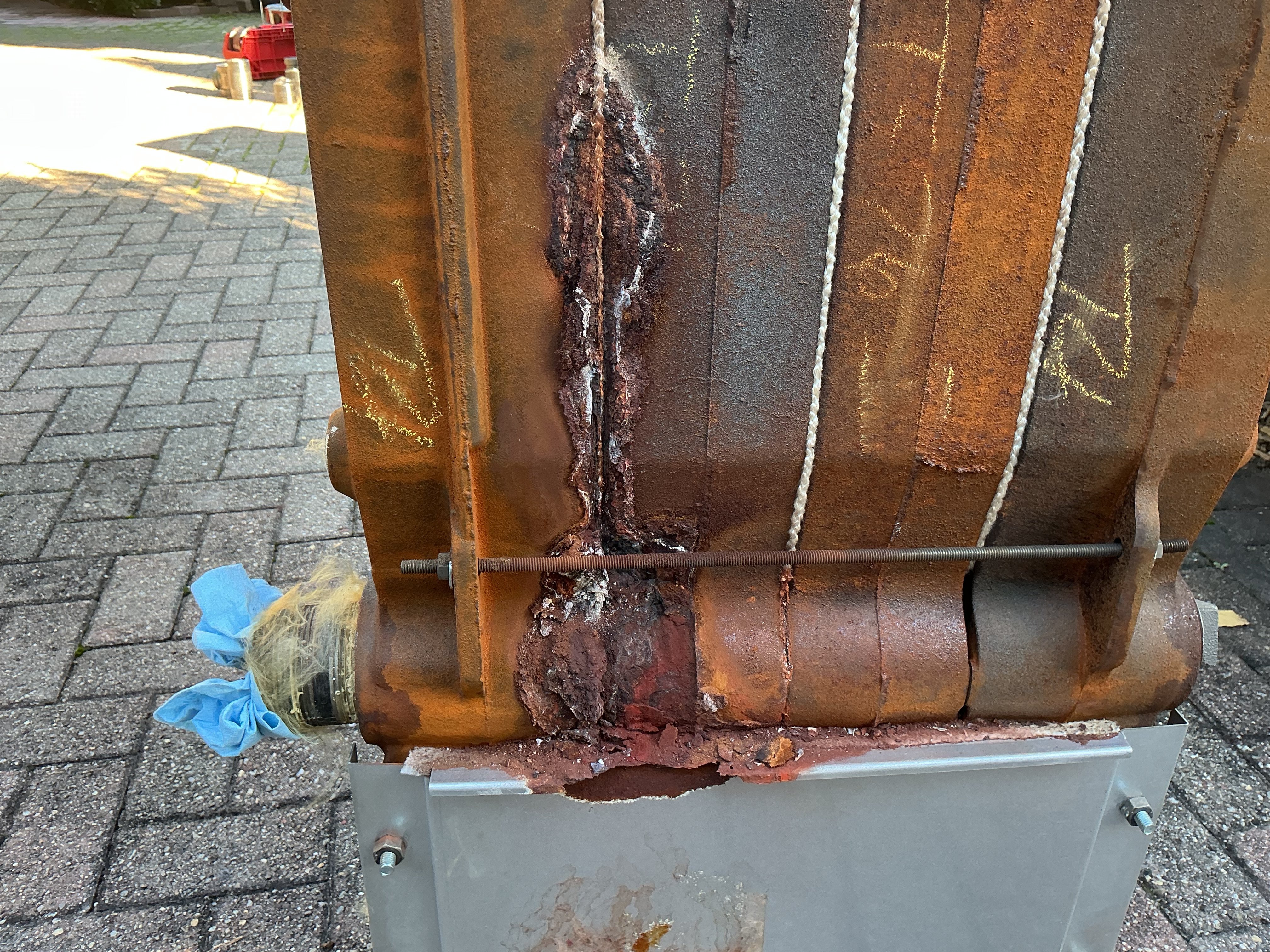

    Just bringing this back up…….after a review of the situation, the source of the issue was located.
    ugh
  • geemalar
    geemalar Posts: 110
    I don’t know what’s worse, the rusted out boiler or the pair of gloves the installer left on the top of the body casting underneath the top finishing cover.

    " or the pair of gloves the installer left on the top of the body casting underneath the top finishing cover. "
    New boiler or the old one? If it was the old one, I'm surprised there is anything left of them. Must not have been on the flue gas side of block.
    Sad, other than the leak it does not look that bad.

    If that was mine I'd be taking it apart to find out what actually happened.

    Gloves were found on the top of the removed boiler. They were right next to where the flue section connects at the rear of the boiler. I should have held onto them or taken a picture, but the contractor was working at a pace to try and get the new unit installed and operating by the end of the day. I was trying my best to stay out of the way of moving forward.
