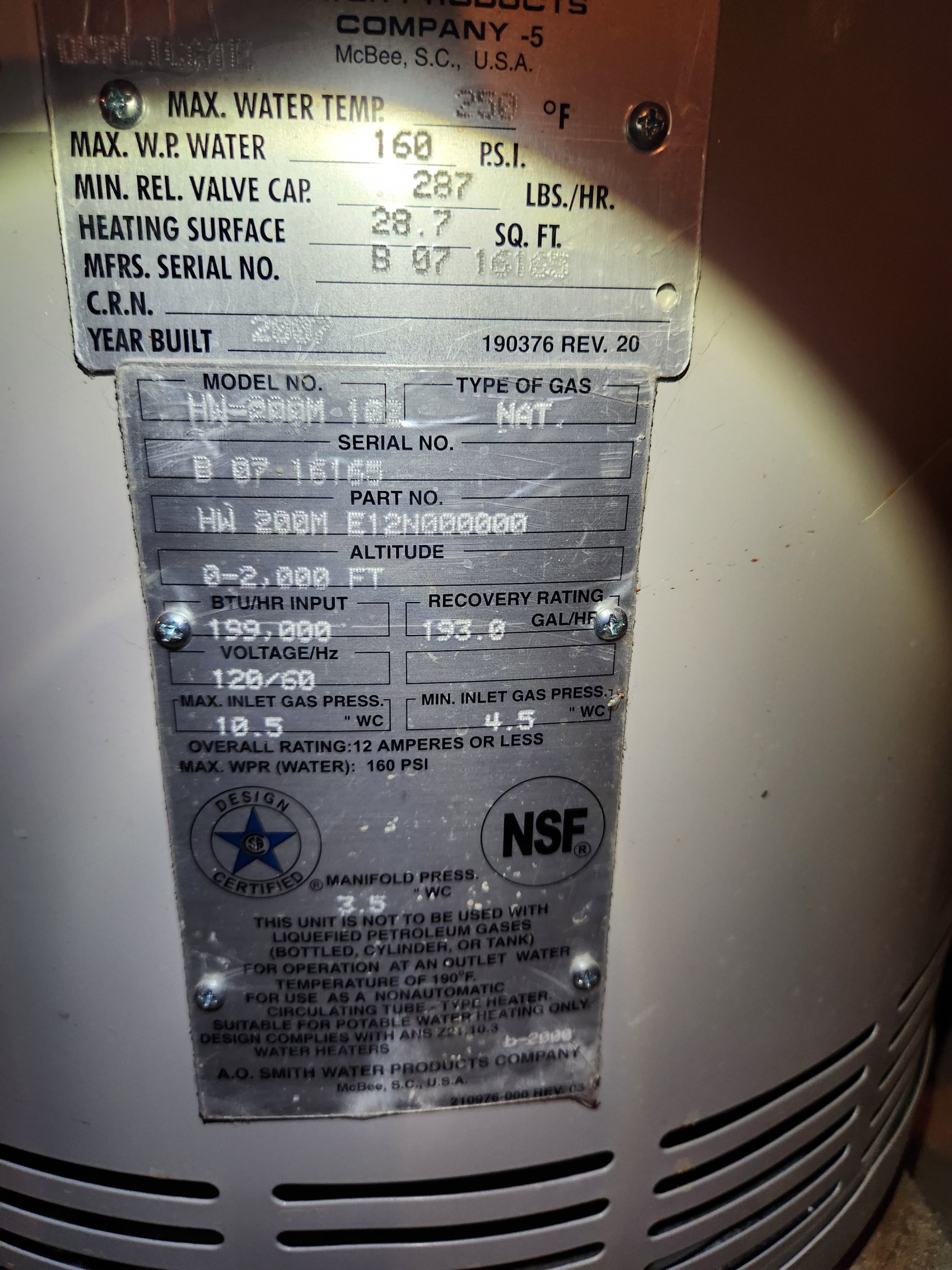

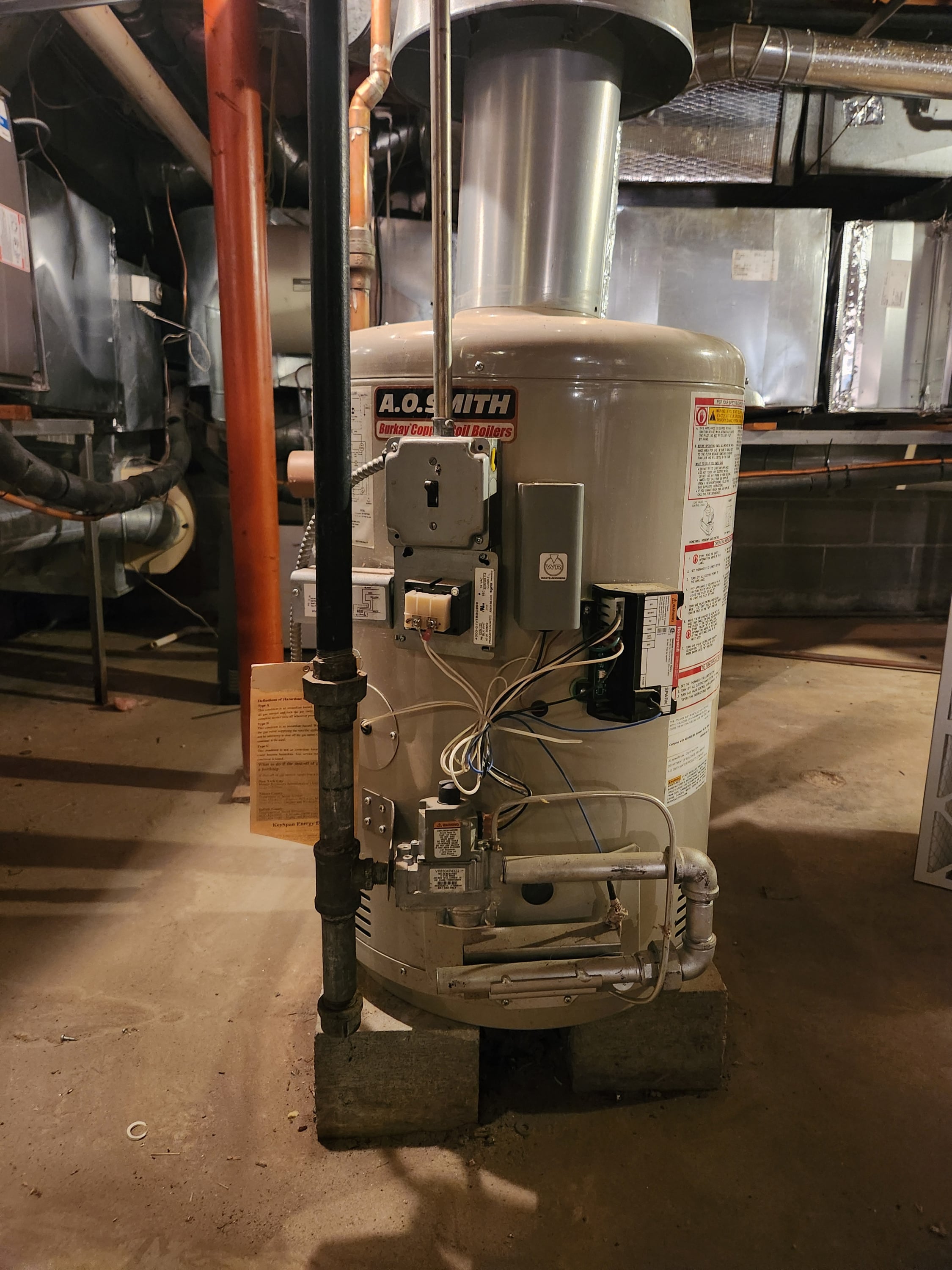

Amazing @Alan (California Radiant) Forbes . I don't think I've ever seen that boiler before you started this thread. Today I show up at a house that air filters were owed from the maintenance, and what do I see in the basement?
This one is feeding a 119 gallon indirect.

back in the day almost every school I ever did service at had going back 50 years or more had an AO SMITH Barkay heater piped to an asbestos covered storage tank. I guess they held up pretty well, but I noticed they always seemed to short cycle a lot.
Seems that the smallest one they make now is 300,000 input.
