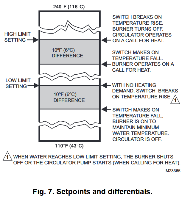

    Is this a new symptom ? Only happens during the shoulder season ?
    Sounds possibly like the Aquastat differential may be too small and/or the boiler is oversized.
    Jamie Hall Posts: 28,006
    aquastat?
    What I'm reading is that the thermostat comes on, the boiler fires and then runs fine until the water temperature hits 180 — which is probably the high limit of the aquastat. Then the burner starts cycling..
    Without knowing which of several controls or safeties is shutting off the burner, it's a little hard to make an intelligent suggestion — but the first thing I'd look at is finding out if it's the aquastat which is misbehaving.
    109A_5 Posts: 4,790
    If it is the aquastat that is causing the cycling, Honeywell recommends setting the aquastat to the boiler's manufactures recommendations. The settings should be at least verified. Boiler Make and Model ?
