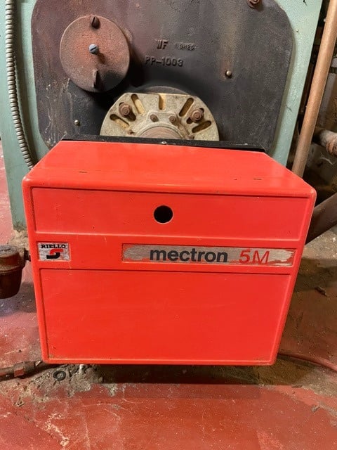

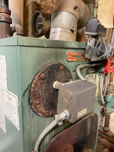

Is this boiler a good candidate for conversion to gas using a Carlin EZ gas boiler?
Picture 1.jpg Picture 2.jpg Picture 3.jpg Picture 4.jpg Picture 5.jpg Picture 6.jpg Picture 7.jpg
First off thank you to Steamhead, hot_rod, EBEBRATT-Ed, Jamie Hall and jesmed1 for the education provided in my last post on boiler sizing. Thanks!

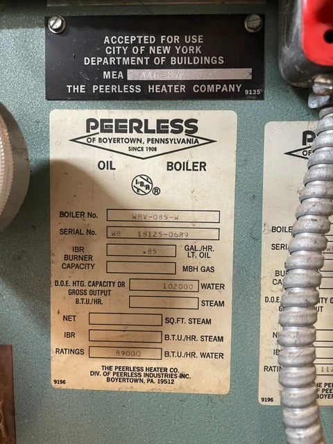

This Peerless boiler is from 1989. Steamhead recommended converting to gas using a Carlin EZ gas burner. jesmed! seconded that suggestion.
I gather the answer to my question is the boiler could last one more day or ten more years...
  • But, given these pictures, I'm wondering whether there are any visual red flags that would change your thoughts on that recommendation?
  • Also, would I be correct to be looking to use one of these?

  • And finally, is a stainless steel flex liner a must for using this Carlin EZ gas burner for the boiler?
At a certain point the cost of the conversion and a liner may approach half the cost of a new boiler installation.
The alternatives are a gas boiler, standard efficiency with a separate gas hot water heater, or a high efficiency combi-boiler providing heat and hot water. There is natural gas in the house.

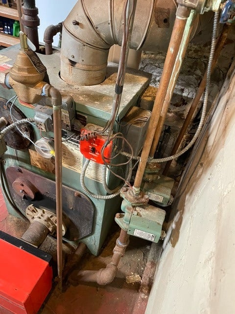

    it could be converted. given that the boiler looks like it has been neglected the money might be better spent on a conventional atmospheric gas boiler if the chimney can take it or a mod con if chimney repairs would be expensive.

    Yes, you will need a stainless flex chimney liner for the Carlin EZ conversion.
    I think I would still lean toward doing the conversion. Yeah, the boiler looks old and ratty but you could still get lucky and get 10 more years out of it. Even if it doesn't last that long, you'll still have the chimney liner in place if/when you opt for a new conventional boiler, and you'll have the gas line run. So it's two steps forward.

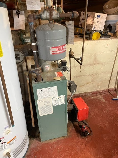

    As is often the case there is no right answer to this question. Personally, I would never suggest putting significant money into a boiler that is close to 40 years old. As much as I love conversion burners, they come with a major risk. And that is the fact that there are very few technicians out there that know how to service them. Even if you get the top of the line guy to put this in for you, what happens if you need service and he's not around? Life could be pretty miserable, if this happens on one of those cold winter days.

    IMHO $$$ would be better spent on a new boiler.
    Reasons:

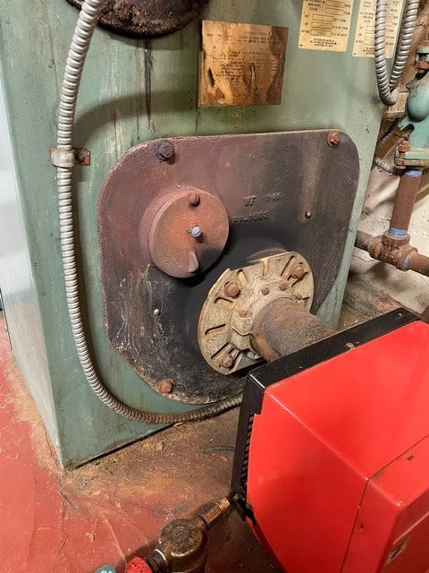

    Tankless heater cover plate needs a gasket that no one will want to touch due to risk of breaking bolts
    Boiler needs cleaning and probably new front plate refractory
    Chimney and flue liner
    Boiler age
    Removal of oil tank and oil.
    Its time for something new IMHO

    @EBEBRATT-Ed Has a good point about oil tank removal. I don't know how it works in NY, but here in MA we would have been required to remove our 2 existing basement oil tanks if converting to gas, and that would have been additional $$. We ended up sticking with oil for a variety of reasons.
    But in your case since you're converting to gas, you would presumably have to remove the old oil tank for whichever gas boiler option you choose.
