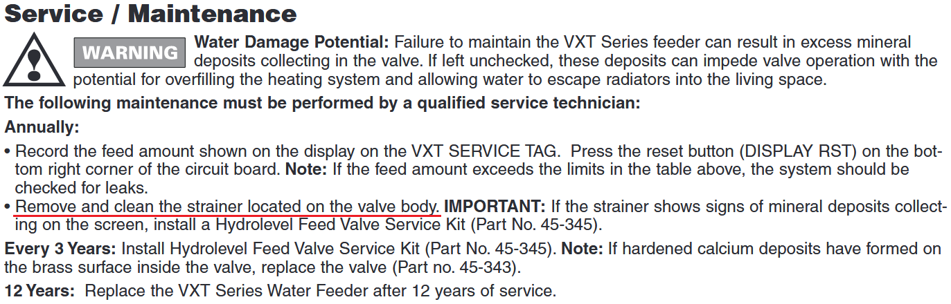

I found this very unsatisfying, when the manual for the water feeder says to clean the filter annually, and install a service kit every 3 years.

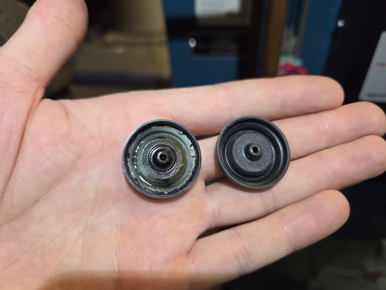

Finally installed it yesterday. Previously when feeding water, after stopping (i.e. releasing manual feed button) it would take about 5-10 seconds sounding like the valve was gradually closing to stop water flow. After installing the service kit, the valve sounds like it shuts almost immediately.

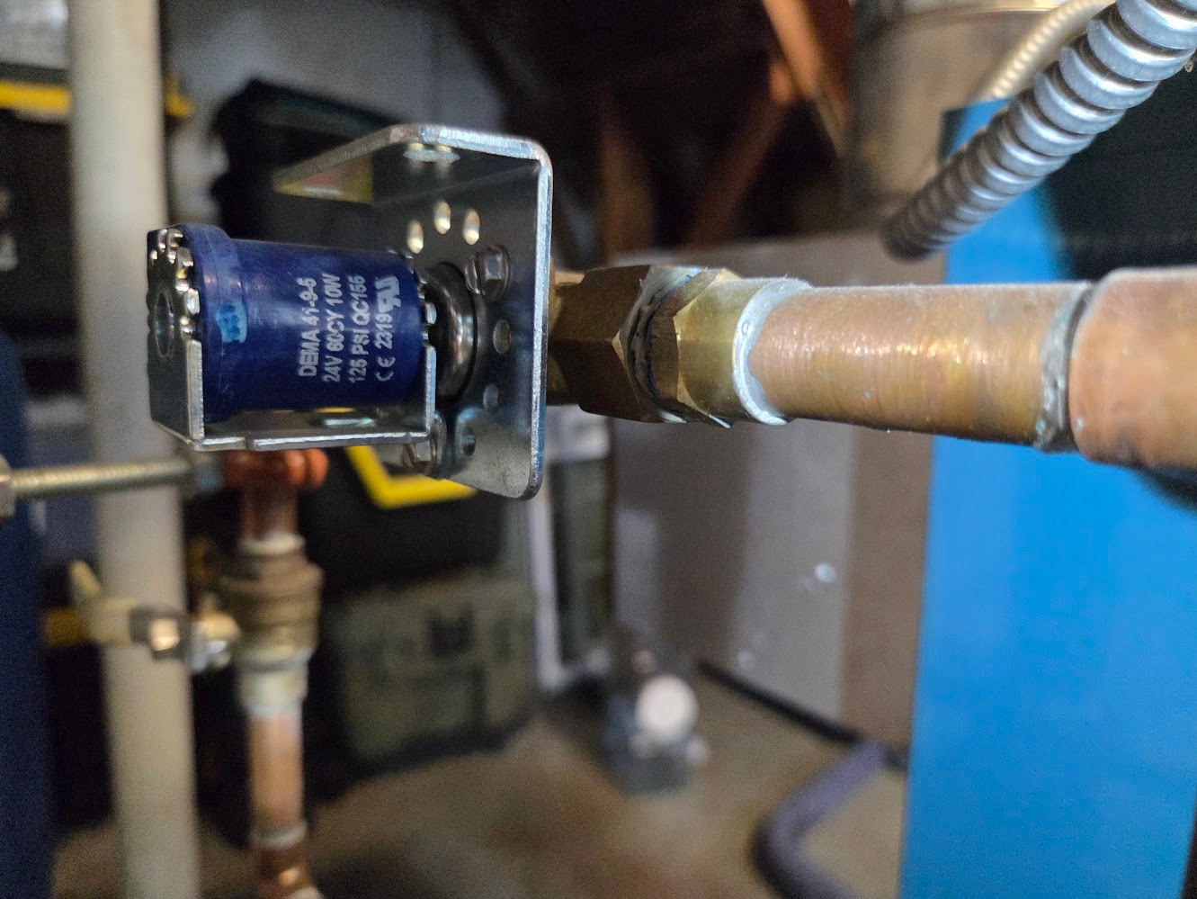

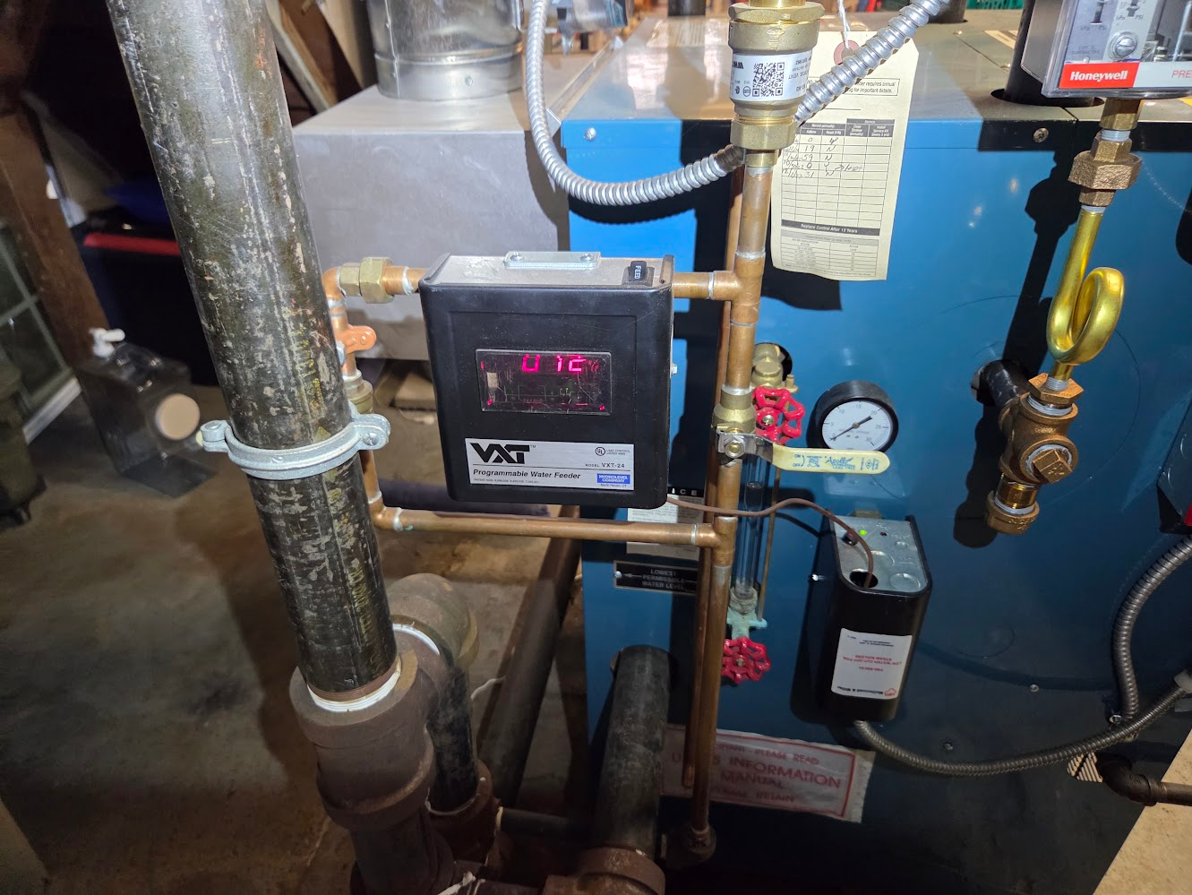

My water feeder: (There is another valve above just out of frame, which is shut to cut off water supply for service)

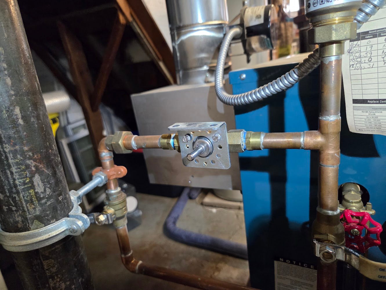

VXT housing & electronics removed:

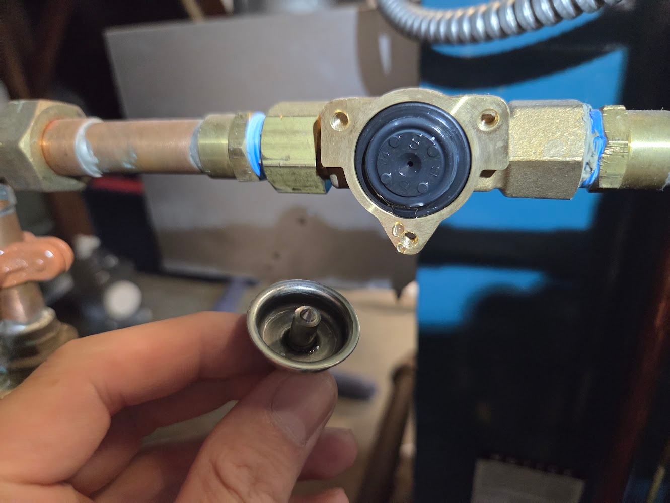

Plunger cap removed:

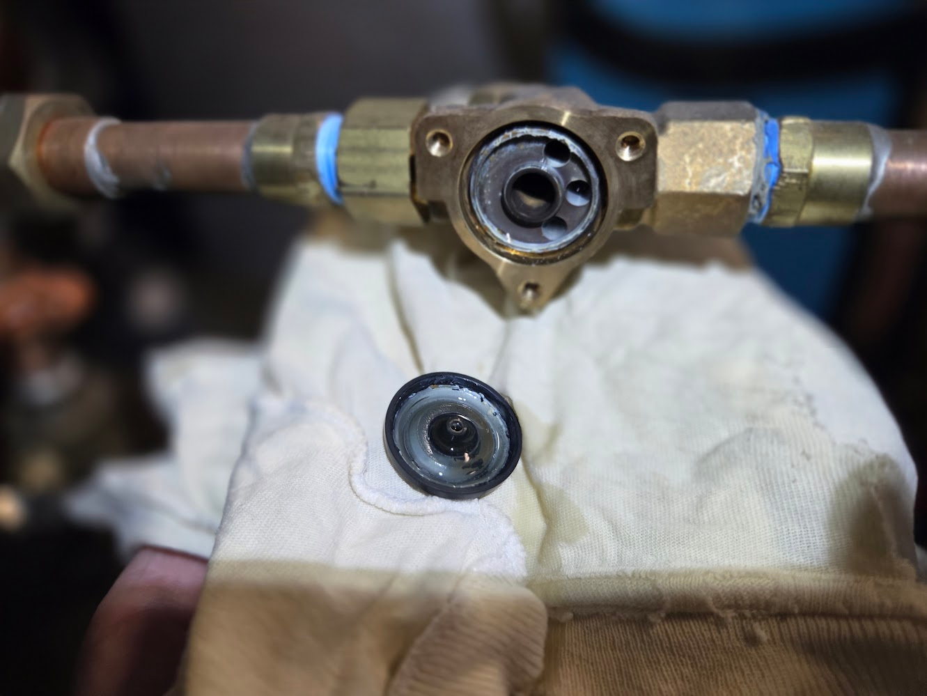

Rubber diaphragm removed:

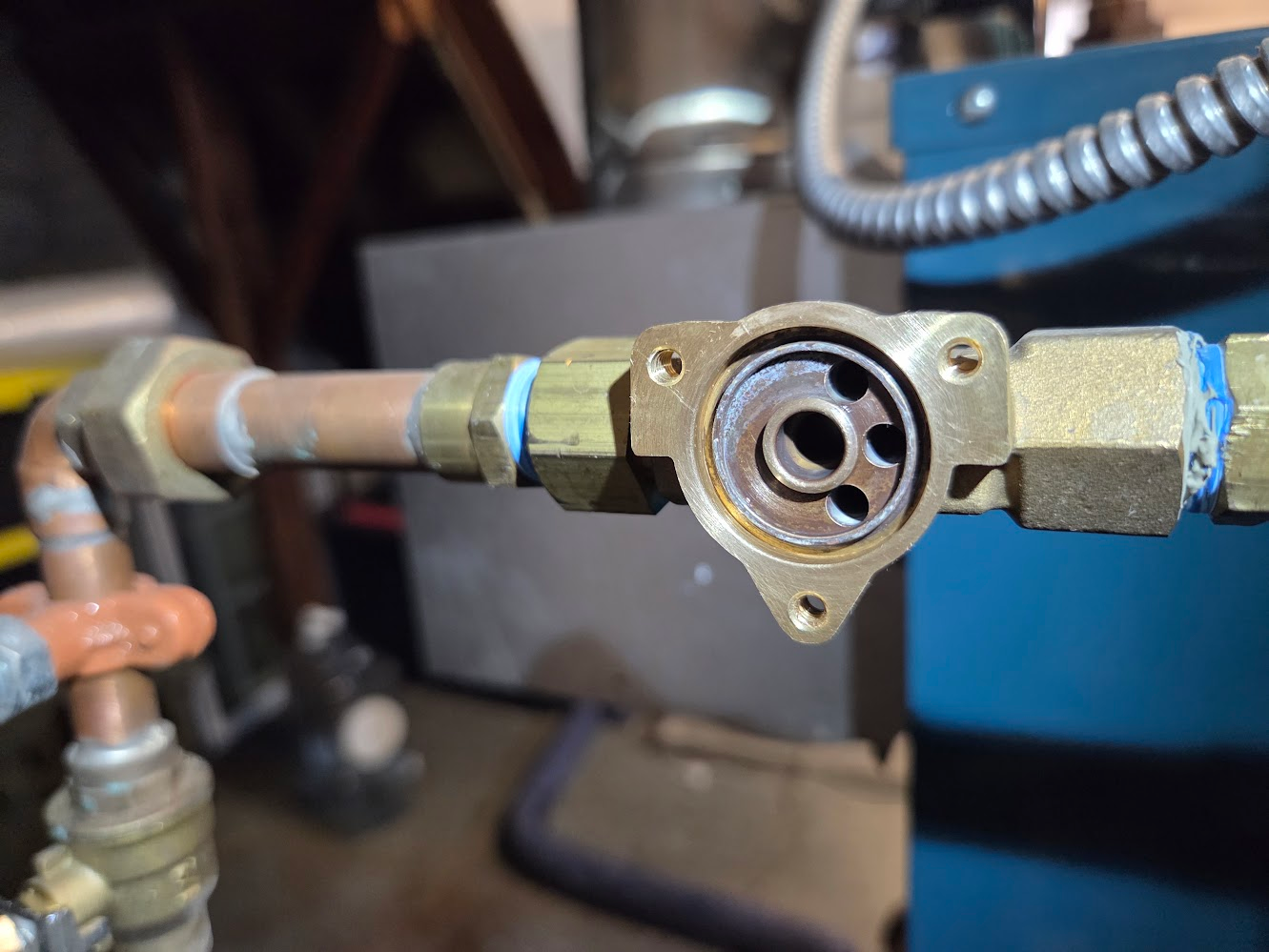

After polishing valve surface with provided scotch brite pad. I also gently used a pick to scrape around some of the recessed parts.
Old and new rubber diaphragm:

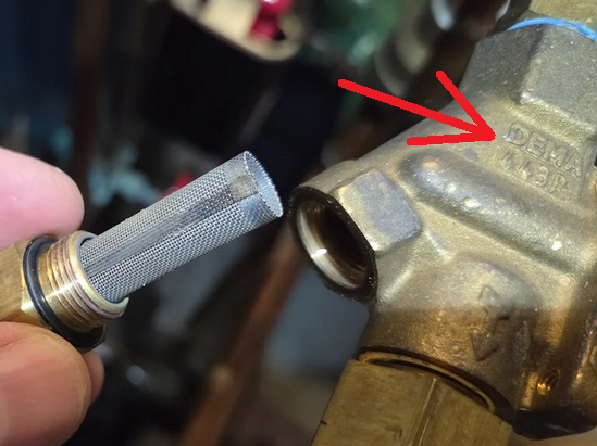

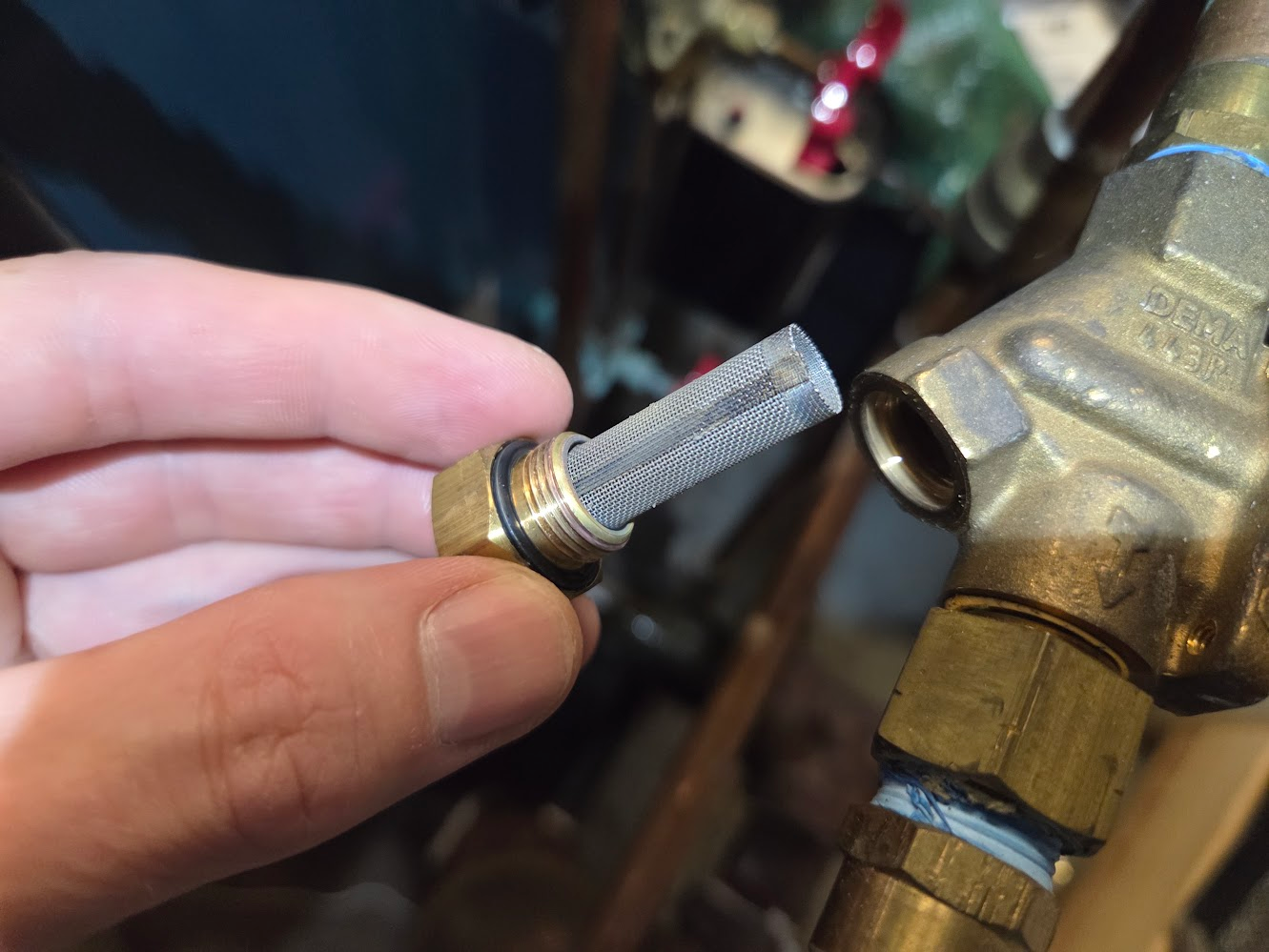

Filter on the back of the valve. This had been another mystery to me, since I still had not found any information about the filter despite that it was supposed to be done every year. The filter seemed to look in very good condition I thought.
Back together, with new rubber diaphragm, plunger, and spring.

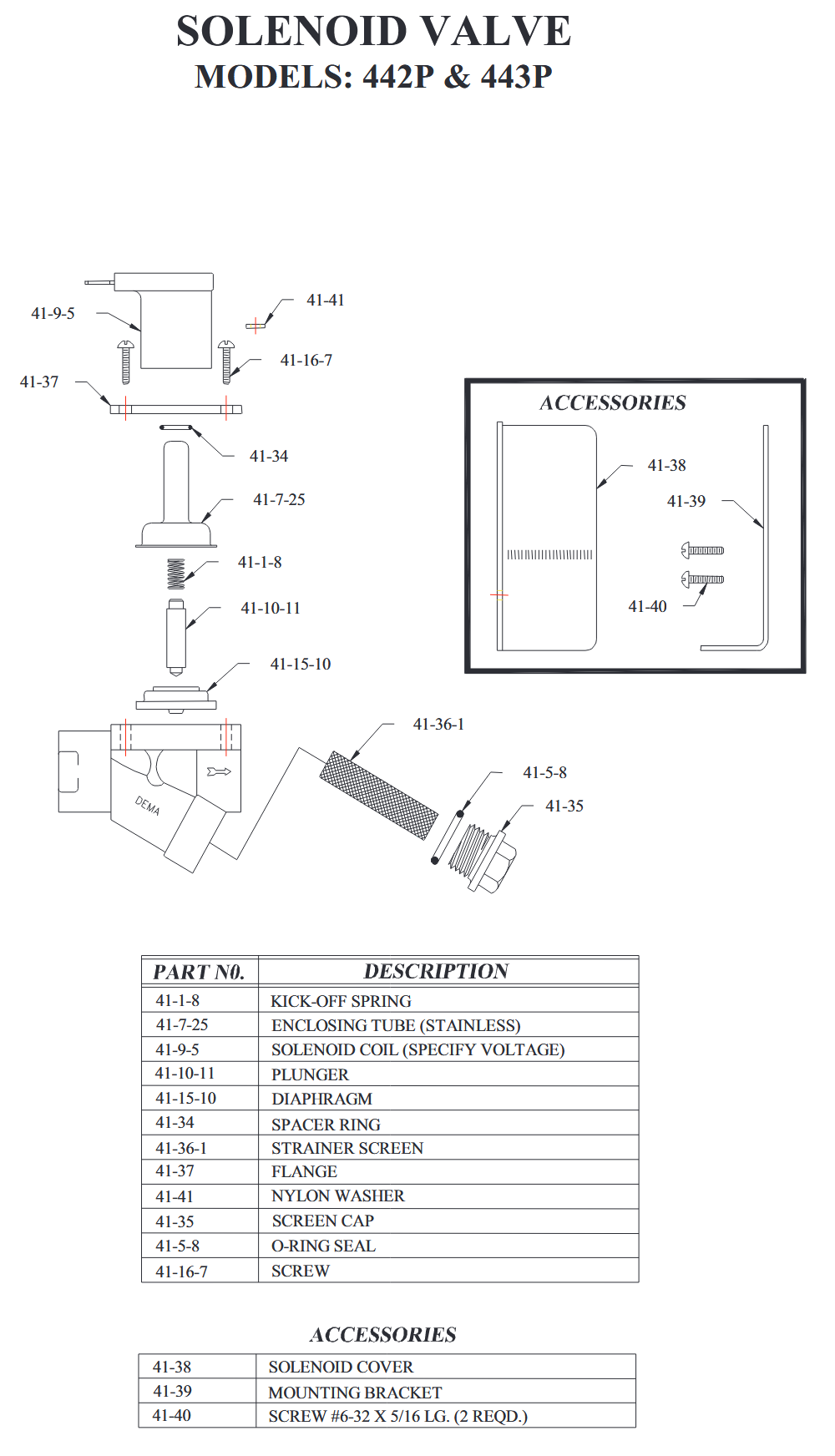

The way they tell you to install a Service Kit Part No. 45-345 if the strainer shows signs of mineral deposits collecting on the screen, you would think a new screen would come with the Kit. Apparently if the screen or the valve body gets too bad they want you to replace the whole valve.
PDF page 340.
https://www.demaeng.com/wp-content/uploads/2020/12/DEMA_Parts_Catalog.pdf
