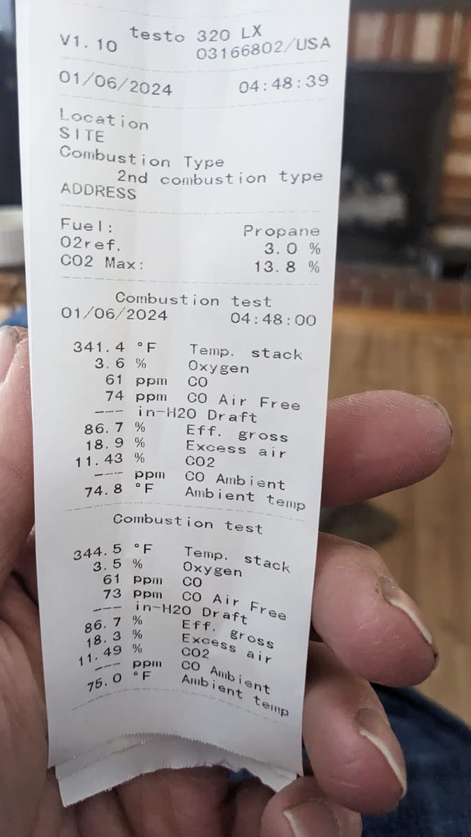

What were the combustion numbers with the EZ Gas? I'm sure the rumble is curable.

Here are the numbers when I first got it running. Blanket in the bottom did not help much nor did removing the baffles.
