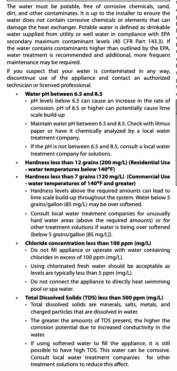

If you go stainless check your chloride levels, on the SuperStor
Glass lined steel tanks can last a long time, they are not so sentive to Ph, chloride and TDS.
I think the Buderus is a steel tank?
Living the hydronic dream0 -
If the water chemistry isn't agreeable with the stainless, a glass lined tank with a powered anode is another option.
