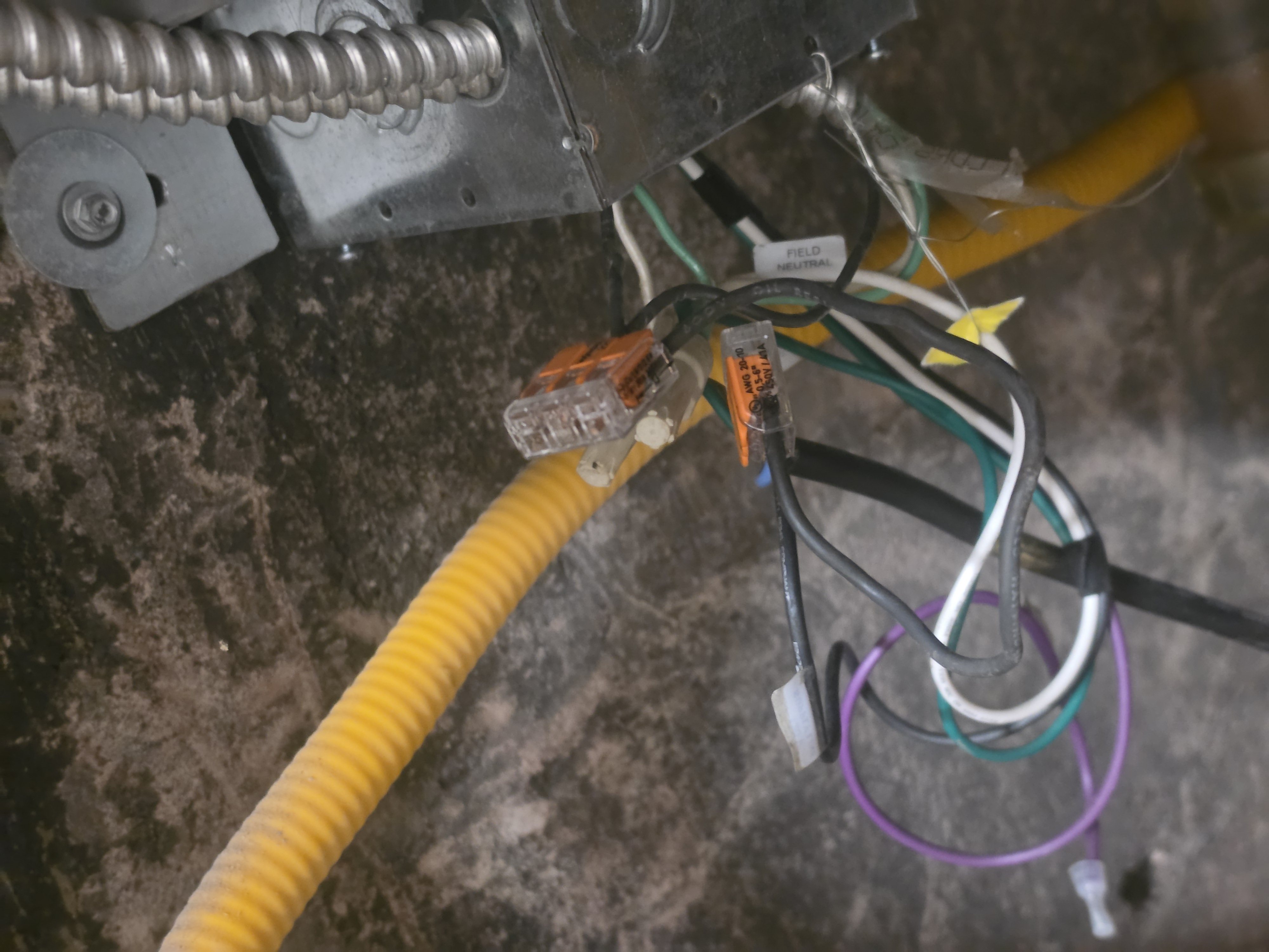

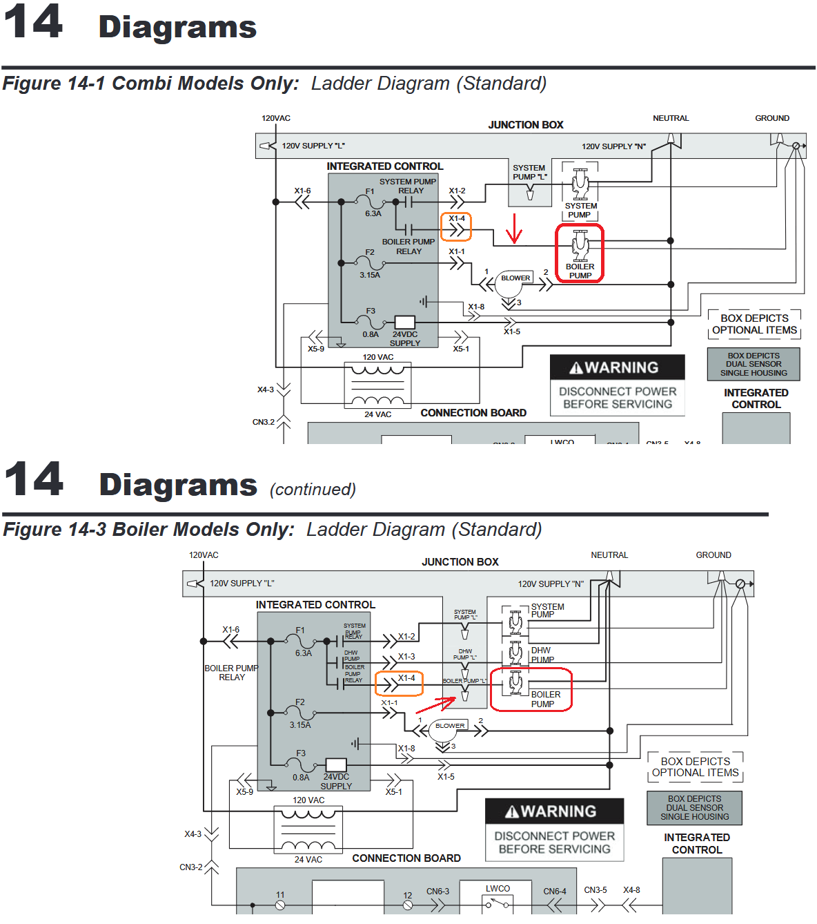

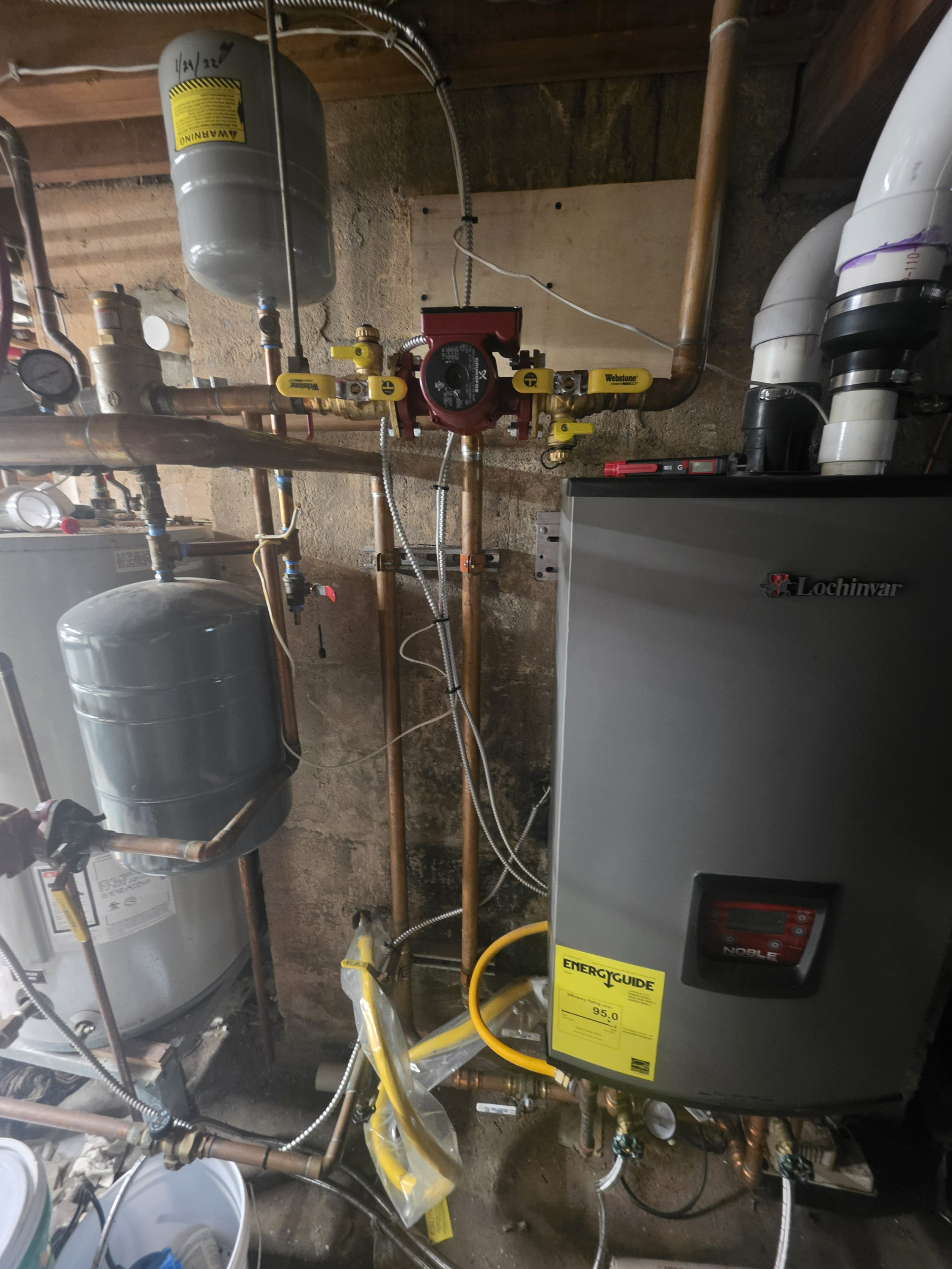

Installer hooked up circulator direct with WAGO so it runs constantly. I dont see where circulator connects inside to boiler.thought about using taco relay controller externally. Heat and combi hot water works but not correct

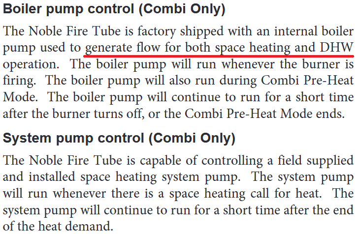

    the combis have an internal circ that is factory wired
    Is it piped primary secondary? A loop pump snd zone pumps may need to be wired

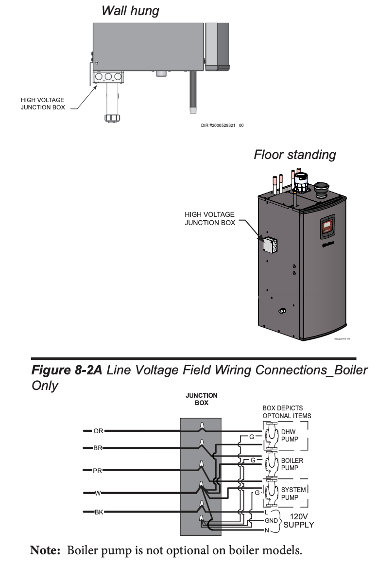

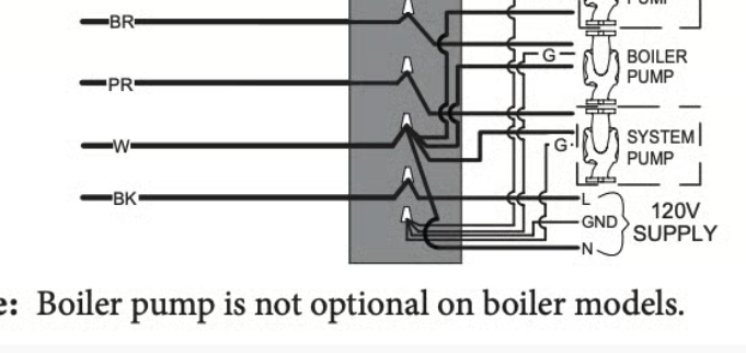

  • Schematic shows brown wire no brown in bundle to lower junction box. Purple but no brown.

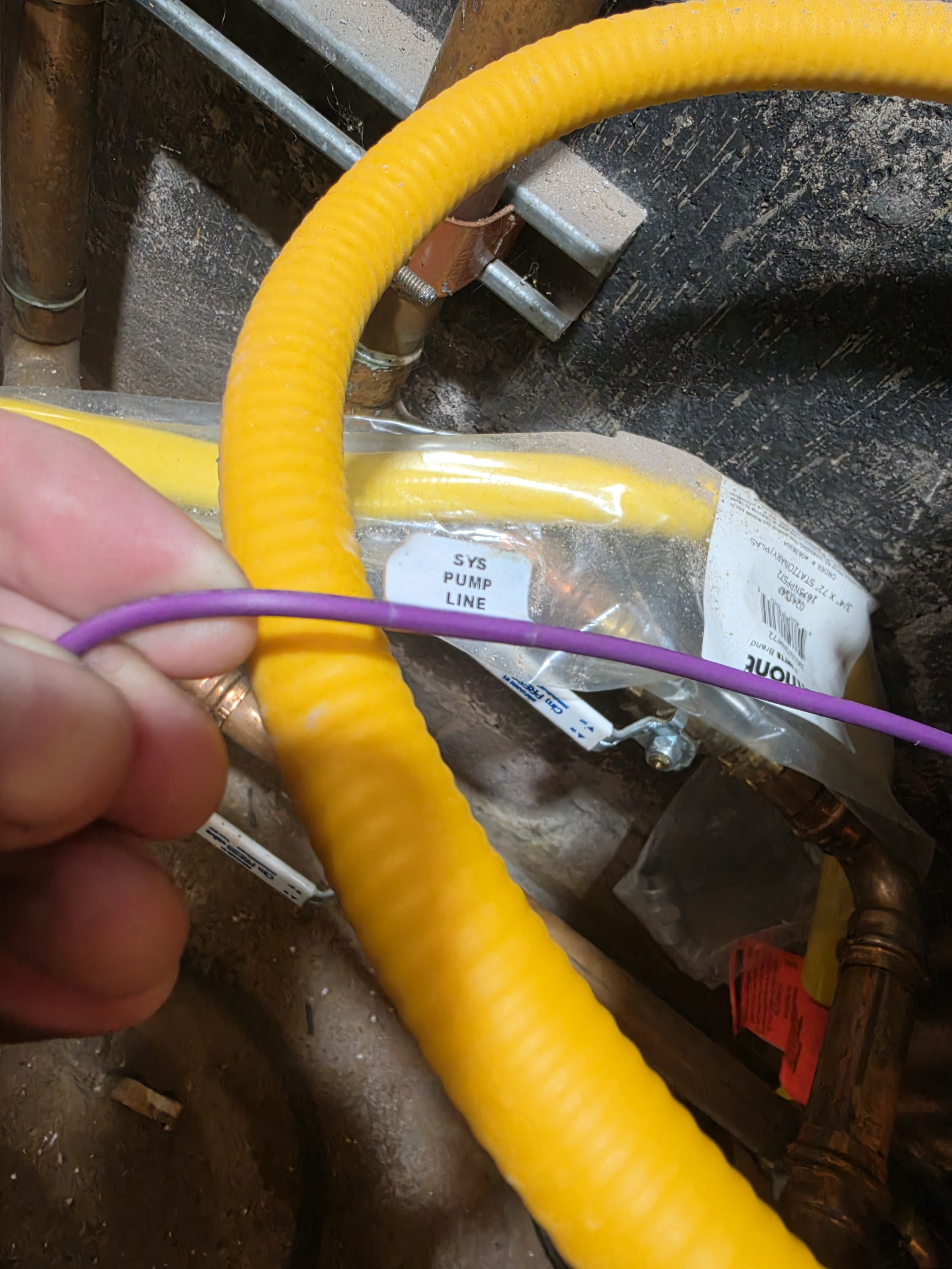

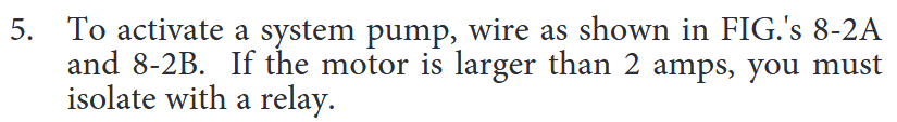

    You can use the purple (system pump) wire. Do you have only one pump on the heating circuit?
    If the pump is more than 2 amps, you must isolate with a relay.

  • I guess i can call for heat and ck if purple energized. Schematic shows purple going to pump also
  • You could just connect the pump and see if it turns on.

  • Interesting installation. One pump, 2 zones (must be zone valves) on a 199,000 BTU boiler.
    I hope that each of those zones is large, especially since there’s no primary/secondary piping. Otherwise, the boiler might just short-cycle itself to an early death.

  • Big monoflow tee system no short cycling
    Works great,other than circulator wired direct. CO perfect
  • Original utica was 100k btu but no water treatment only lasted 10 years

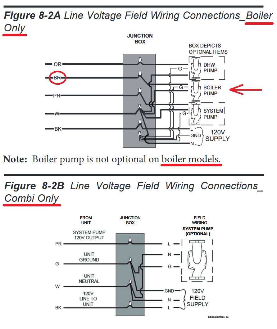

    Show us how it's piped. Noble combi boilers don't have a brown wire because there is an internal boiler circulator that's wired from the factory. The purple wire in the J box is for the system pump, as the label on it very clearly shows. How do you have two zones without zone circs or zone valves? Just two large TRVs? The purple wire is energized on any call for heat- just disconnect the line voltage currently feeding the pump and run a new hot wire back to the purple wire and you'll have a properly controlled P/S system if it's piped appropriately. If the circs are in series, it either needs to be repiped or the external one can probably be removed altogether.

    The Combi version does not have external Junction Box access to the Brown Wire, since I suspect the Boiler pump is internal to the unit (as @hot_rod stated). The 'System pump' wire (the Purple wire) may do what you want.

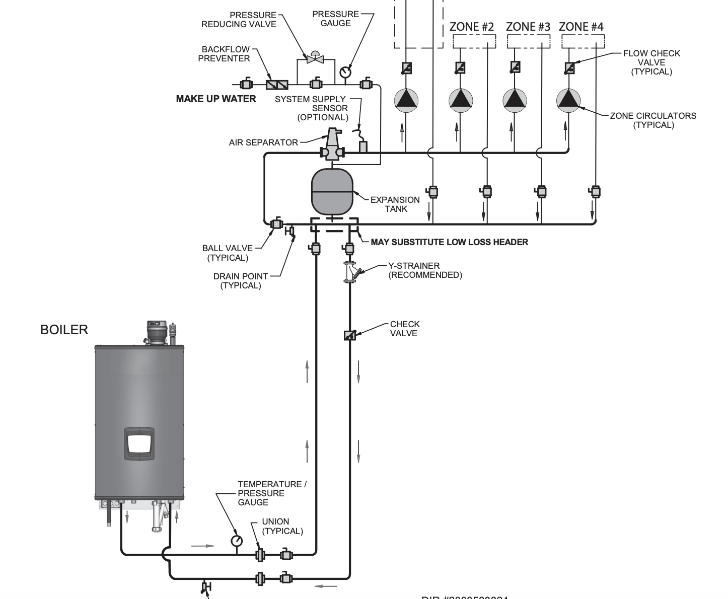

  • @wildwillyjohn The internal pump is your boiler pump. The external pump is your system pump. The two should be connected by either closely spaced tees (shown below) or a low-loss header. Can you verify?

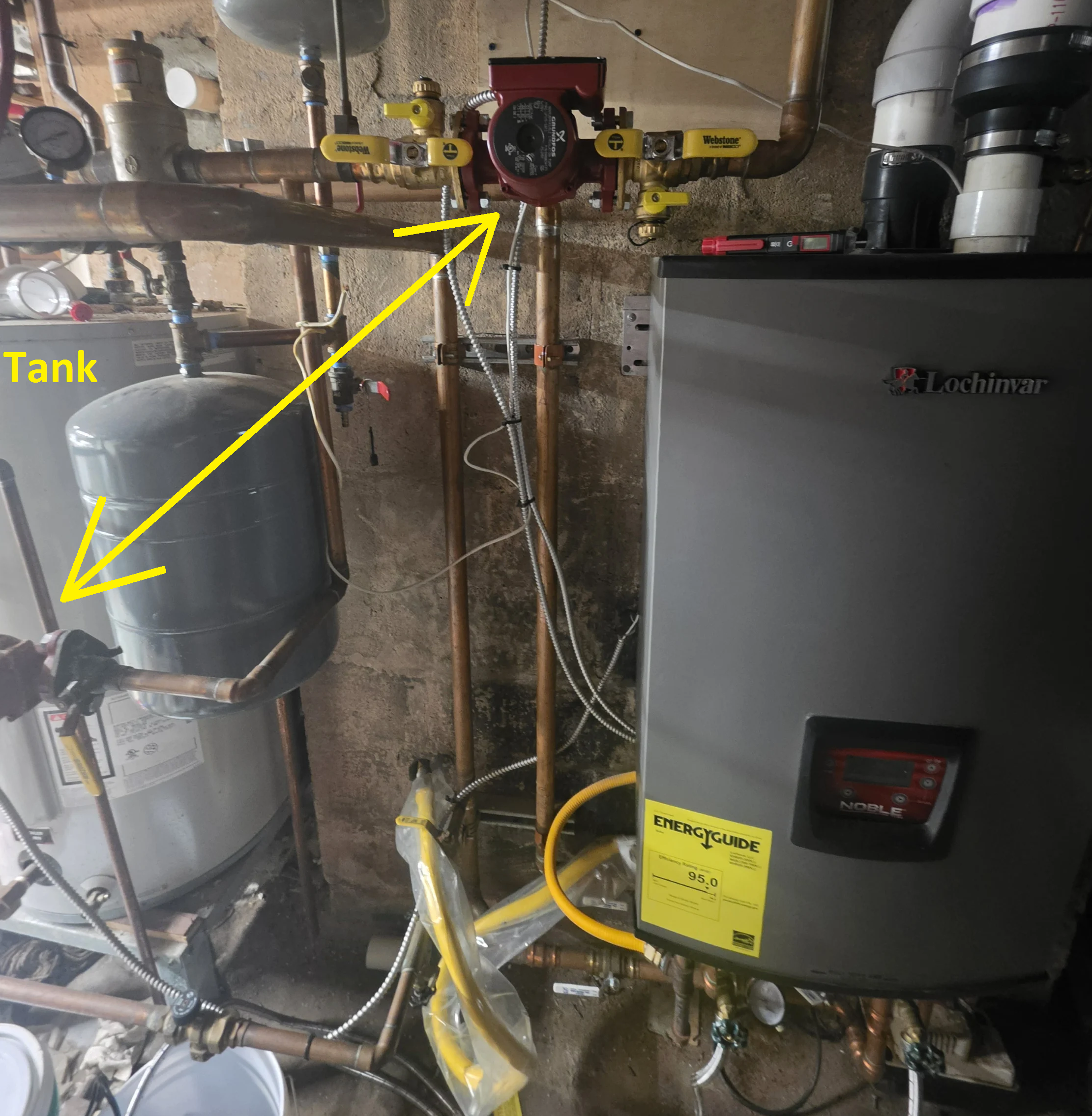

    That does not show the primary/secondary piping. We need to see further to the left and verify whether there is any hydraulic separation. Also there are two external pumps but one has the valve closed. What is that for?
  • I don't see a second pump and from what I can tell, it looks piped directly. If so, the system pump and boiler pump are in series, doubling the head.
    I can't tell if that's a Grundfos 15-58 or 26-99.
    109A_5 Posts: 4,687
    Are there two external circulators and a Buffer tank ?
  • Attached purple wire to circulator. Problem sol-ved
