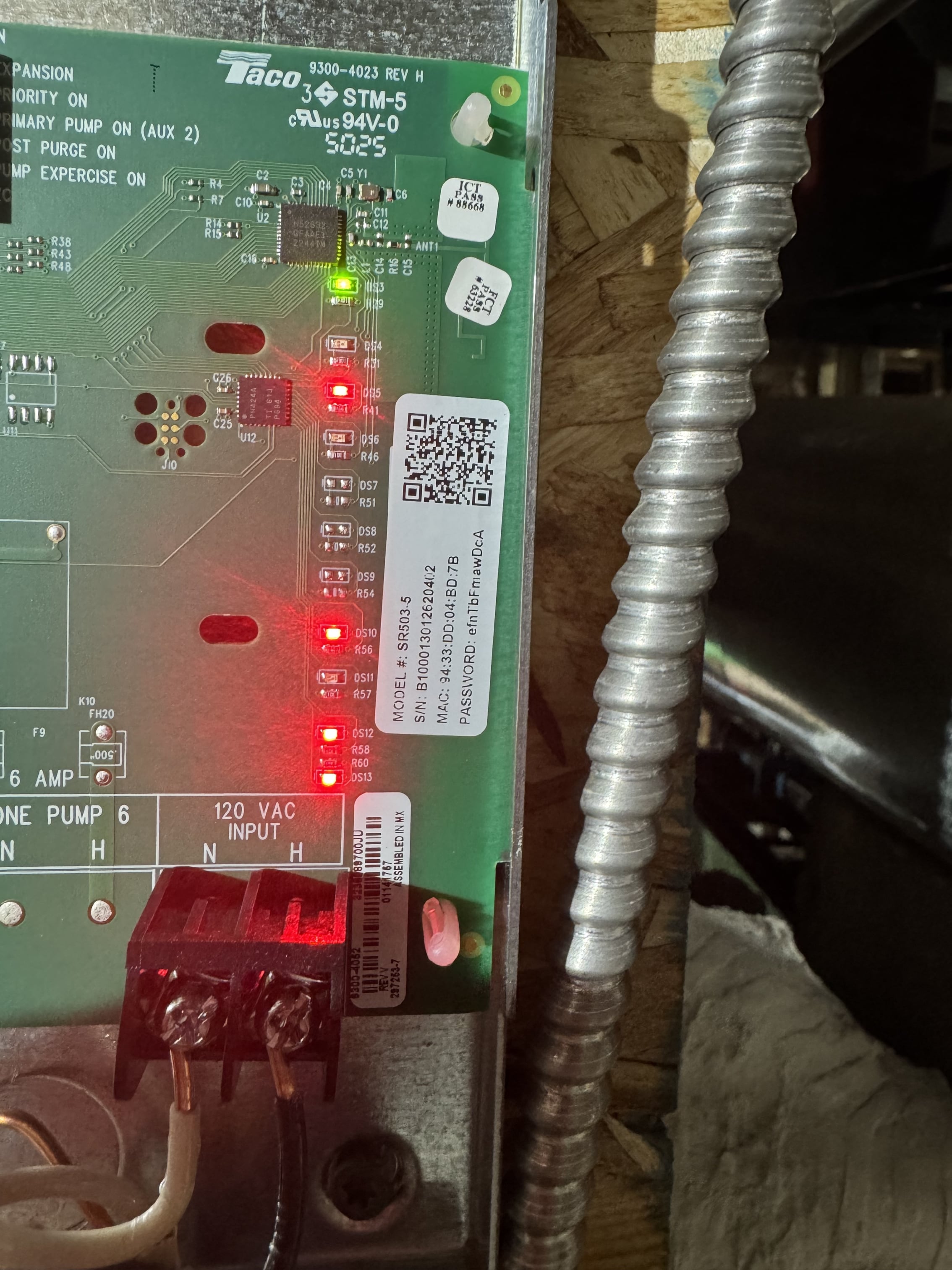

just added a some radiant loops to an existing system

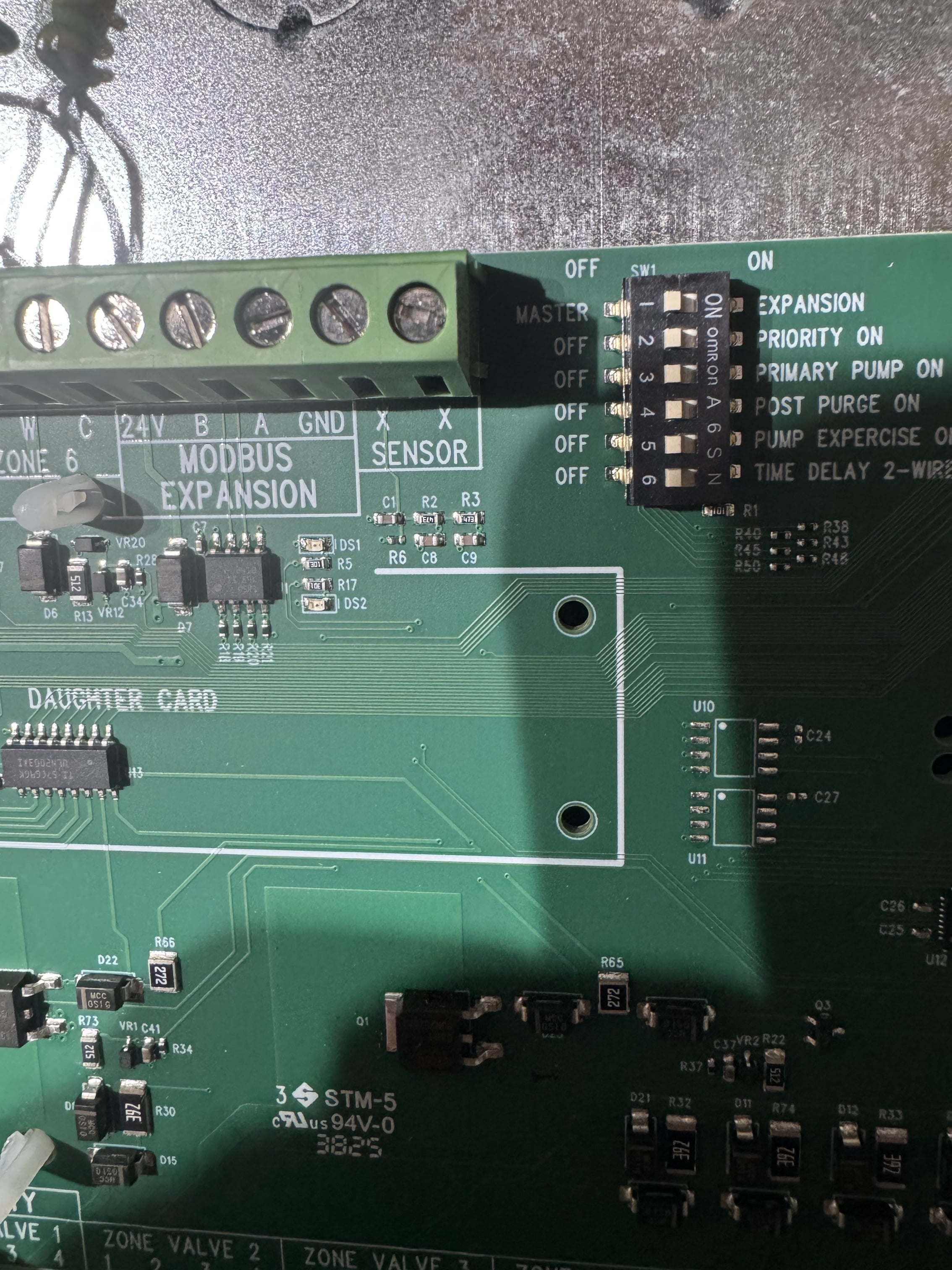

Both new controller and the Swithing Relay have a tiny LED UNDER THE Modbus connector that is label DS2 (below R17) and flashes 6 times fast and then repeats?
The SWITCHING RELAY works as it should when the thermostat calls for heat. Haven’t tested the radiant side yet. Can’t find info on the tiny LED though…
Anyone know if it’s normal operation?

    That DS2 is just a status LED if you are connecting two boards together.

    so is flashing quickly a “normal” status I don’t need to worry about? I’m not connecting two or more boards.

  • I think it a good question that we can all appreciate an answer to as I’ve never seen that light flash. @SteveSan ?

    I don't recall ever seeing that either. It's been a number of years but I've installed dozens of both the zone controls.

    On the -5 controls, that is normal operation. If you do connect two controls together, then that status will change to one green, followed by one red LED. Once you place the cover on the control, you won't see that LED. Just the zone LED's should be visible.

    Too bad the instruction documents just don't tell you. I guess even the manufactures expect no one to read the instruction documents. Looks like there is room to silk screen the info on the circuit board.
    If everyone needed (and wanted) real time information that funneled you into a limited time period and often playing the 'on hold' waiting game, forums like this and email would be useless.
    In this case I suspect since it is configured as Master with no Expansion units connected that is the flash code you get. And / or MODBUS activity or lack of, just maybe polling with no responses. I'm sure they put DS2 near the MODBUS interface chip for a reason.

    it’s probably only on the newest models with the Modbus expansion capability
