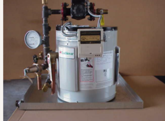

I need a very small electric boiler. Small enough I could use an 1400watt water heater if it was rated for heating. I haven't used their products before. Are they any good? Thinking of using this guy.
https://www.supplyhouse.com/Electro-Industries-EMB-R1-01-120-1-Electro-Mini-Boiler-R1-Staging-1-kW-1-Phase-Electric-Boiler-120V
Backstory:
I have a small (30sqft) bathroom I need about 800btus to heat. The apartment is heated with mini splits and there's currently no gas or boiler. They put tube in the floor, finished the bath then decided to switch from baseboard to heat pumps not thinking about about where to get hot water for the radiant. They're dead set on radiant and don't want to tear out the tile to go electric.
    Electro is ok AFAIK.
  • Heat source dependant.. Maybe you could get away with something like a Taco X Block off the existing water heater for such a small load like that?
    hot_rod Posts: 28,708
    I've use small water heaters for those jobs. Low pressure, low temperature. I add a 30 psi relief valve, leave the T&P also
    pecmsgGrallertLarry Weingarten
  • GroundUp
    GroundUp Posts: 2,573
    Electro makes the best electric boiler available, in my opinion. The 1kw is pretty expensive for what it is, but I have several hundred Electro boilers in service without any complaints. The water heater thing is also an option, I've done small jobs like this both ways
