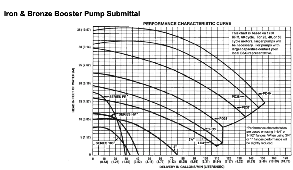

  1. Is the Grunfos Alpha 15-58F (link https://www.supplyhouse.com/Grundfos-92603115-ALPHA-15-58F-Smart-ECM-High-Efficiency-Circulator-Pump-with-Optimized-Setpoint-Control) a good choice for replacing the Taco 110-338, and for putting on the newly split zone? This pump is attractive to me because it can show head and flow, and the output can be programmed. I cannot find a pump curve for the 110-338 to see if I can run the 15-58F at the same point.

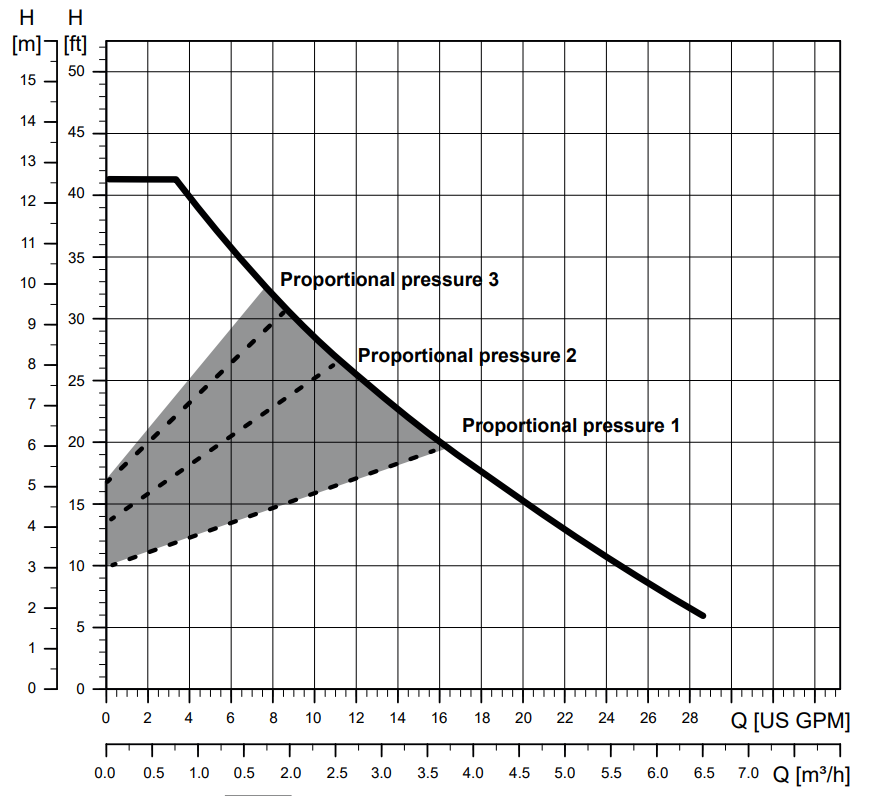

    The B&G and 110 are similar pumps. Sometimes considered high flow, low head circulators.
    How many gpm do you need. The 15-58 will not run out to the gpm of theses two.

    Thanks for finding that curve for me! Maybe adding the -338 on the model number was messing up my results. It seems like way too high flow of a pump for a 3/4" pipe! I would guess that it was originally on the main zone, and was switched over at some point.

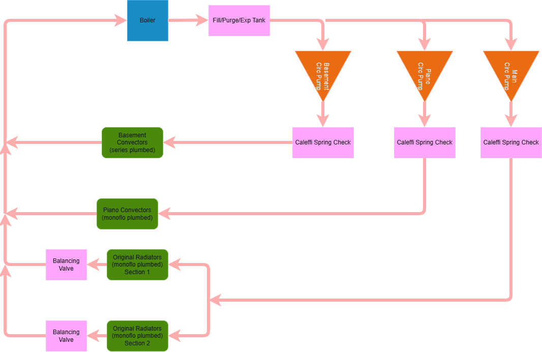

    Here's a link to a diagram of the system as it exists. https://us.v-cdn.net/5021738/uploads/MD4E42AR8SSK/heating-system-existing.png
    So the big zone was originally for the whole main house. It does a split which I think may be unusual. At some point not long after the house was built, a small addition was added, and the heat for that got scabbed onto the monoflow zone. There are balance valves to make sure all legs of the single zone get flow. I want to remove the "scab" from the main zone, and add a pump so that it can be its own zone.

    hot_rod Posts: 28,699
    those two pumps , the series 100 and the 110 are known as flat curve pumps . They are ideal for zone valved systems
    Pumps like to run in the middle of their curve for best efficiency and long life
    So about 15 gpm, and 6-8’ head
    If the design was around a 20 delta, estimate 15 gpm= 150,000 btu/ hr

    I've completed the plumbing, and I bought (2) Grunfos Alpha 15-58F since there was some consensus that they would probably work for the addition (piano room in the diagram) and the basement zone. Here's a diagram of the new plumbing for clarity. The working fluid is water.

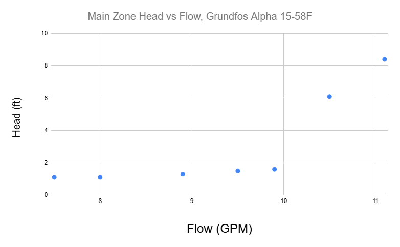

    I have installed one 15-58F on the addition. I also installed one temporarily on the main zone. I looked at each convector with a thermal camera, and they look fairly even. I also collected some flow/head data from the app, though I don't know how accurate it is. It is not as linear as I expected. Here is a plot:
    If this data is accurate, it looks like the 15-58 is pumping more than the B&G 100 would pump, since it is a low-head pump:
    You have a lot of adjustability with those circulators.
    When you take readings, especially temperature, you want the system to reach thermal equilibrium.
    All hydronic systems are going through a transient condition until the supply temperature and return temperature stabilized, neither rising or falling. At that point the radiators are moving all the boiler is providing.
    The distribution and heat emitters always drive the boilers operatuing condition. Good or bad.
    Delta T across S&R will, and should move during the transient period also. High load, cold start expect a wide ∆, closing as the room nears setpoint.
    Regardless if the design was 20, 25, 42, whatever, the heat emitters will drive that delta, up until equalibrium, it will move. Maybe at equalibrium condition the ∆ will match design. Maybe not :)
    It is at that thermal equilibrium condition you want to observe temperatures and deltas, with your camers or strap on temperature gauges. This confirms heat output, expectations, etc.
    On high mass, large system volume systems you want to observe the boiler return, assure it is adequate if you have a non condensing boiler.
    You would want that data on a design day ideally to assure you cracked the nut.

    I think it might make sense to keep the pump where it is for now until it gets colder and I can better assess if it is operating well when it is close to the design point. I didn't get anywhere near equilibrium with my test recently, since it isn't really cold out yet. If I see return temps dropping too much (I do have a non-condensing boiler) I'll get a pump that will actually make more flow, maybe something like the Alpha2 26-99, which I think could do in the range of 16-20GPM.

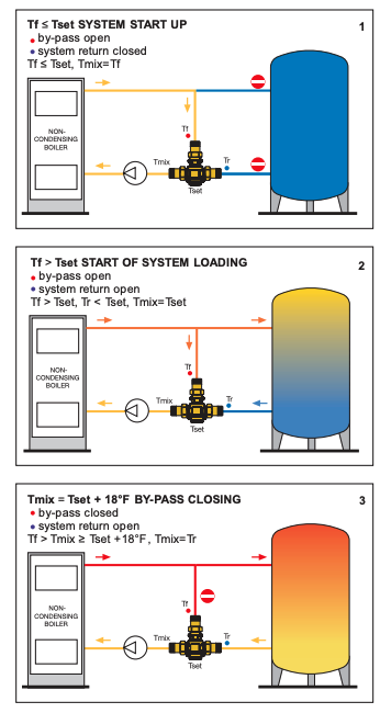

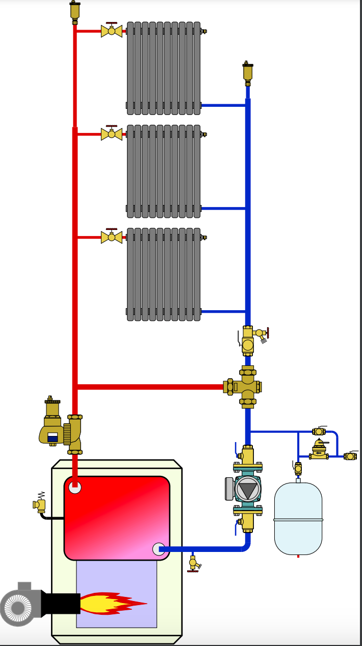

    If you do find the return is dropping below 130 for over a 10 minute period you would want a boiler protection valve or device, not a larger pump. The boiler needs a "thermal clutch" to allow it to keep up with the load of the system. The pump should move just enough gpm to get the job done, no need to over-pump.
    The graphic below shows how the valve monitors return temperature and blend boiler supply to maintain 130. The tank as a load is to show a big hungry load. Pellet and wood fired boilers are often connected to large buffer tanks. That is the most common application for return protection valves.
    Now if the boiler is oversized, taming short cycles gets trickier.
