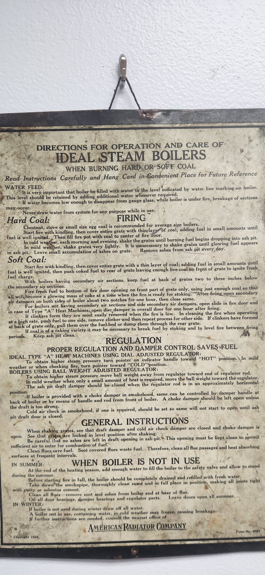

  • Cool, I found two of these metal plates from the American Radiator Company with instructions to do a wet layup. I've never heard of a dry one, that must be more industrial?

    @SteamNow That's cool thanks Yes the dry layup is used for industrial boilers.
