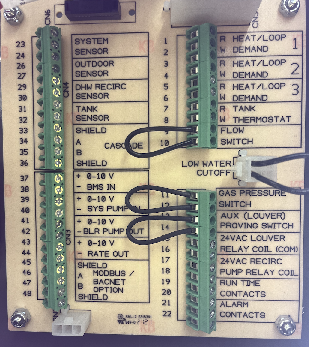

The tank sensor will be wired to the SYSTEM SENSOR (terminals 23 & 24) on the control board. But I've read the manual several times and still can't figure out how to program (or wire) it so that the boiler will run only based on buffer tank temperature. Many setups with this boiler would benefit from using a buffer tank, so it seems strange that Lochinvar wouldn't write at least a simple paragraph in their 84-page manual explaining how to set up the boiler controls so it runs only to maintain buffer tank temp.

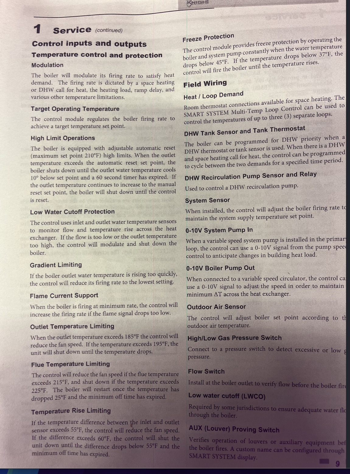

    You can download the manual for the specific boiler you intend to use. The Service Manual explains settings, as an example
    You can also call Lochinvar tech support, but it is good to be at the unit when they help explain how to sdjust parameters.

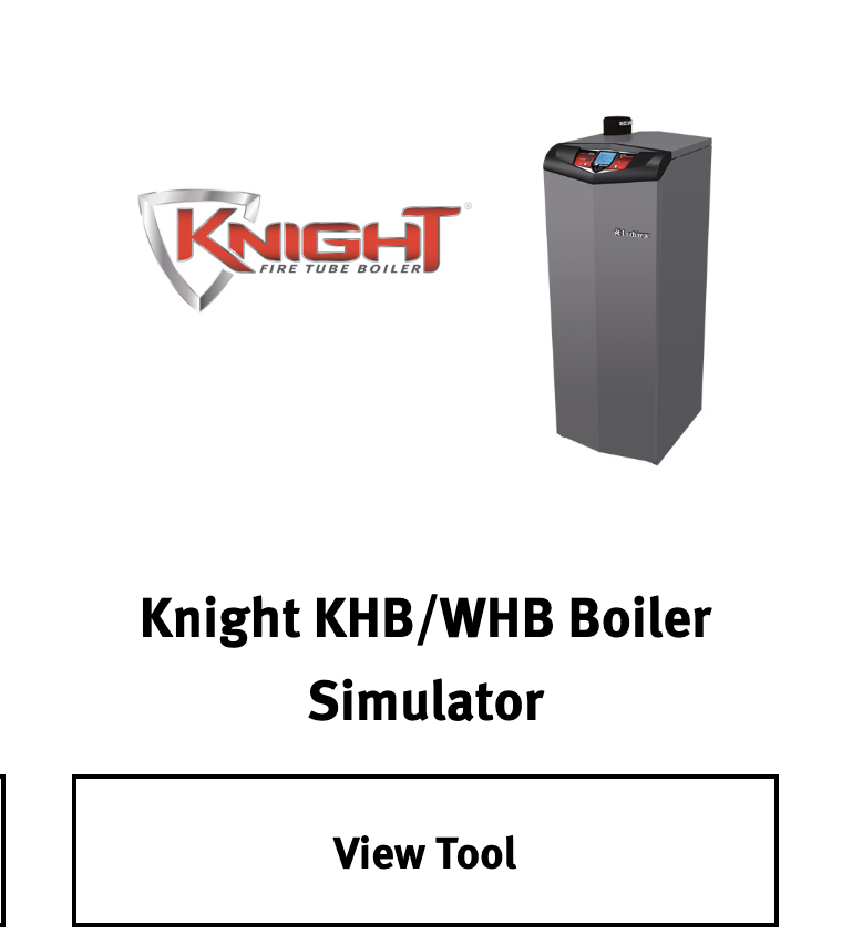

    You can get up to speed on the control before you buy the boiler with the online simulator, here.

    The Lochinvar Knight has 3 thermostat connection points they call "Heat/Loop Demands" numbered 1 to 3. So I would jumper, say "Heat/Loop Demand 1" (terminals 1 and 2) and probably put a simple ON/OFF switch on the jumper so that at the beginning of the heating season, I'd turn that jumper circuit ON to activate a continuous heat call on that loop for the entire heating season, only turning the jumper switch OFF at the end of the season. (Boiler power would stay on year-round for periodic exercise of the boiler circ.)
    Then with the system temperature sensor placed in the buffer tank, and the outdoor temperature sensor outside, program the ODR setpoints for the "Heat/Loop Demand 1". The boiler should then fire to maintain the target temp in the buffer tank based on the reset curve for that loop, and will stop firing when the system temperature sensor reaches the target temp plus the "SH1 offset" (SH=space heating). Then when the buffer tank water cools and the system temperature sensor reaches the target temp minus the "SH1 differential", the boiler should fire again to begin raising the buffer tank temp.
    The factory default for "SH1 offset" is 10 F, and the default for "SH1 differential" is 20 F, so adding those gives a delta T of 30 degrees in the buffer tank. Those parameters can be adjusted for larger or smaller delta T's. Obviously, the larger the delta T, the longer the boiler run time.

    The manual explains this Gradient Limiting function as "If the boiler water outlet is rising too quickly the control will reduce it's firing rate to the lowest setting"
    The manual explains Outlet Temperature Limiting "When the boiler outlet exceeds 185F the control will reduce the fan speed (burner modulation) If it exceeds195 the boiler will shut down until temperature drops.
    Temperature Rise Limiting "If the difference between inlet and outlet (boiler sensors) exceeds 55° the control reduces fan speed,. If it exceeds 60°it will shut down until the difference drops below 55°
    This will control protection conditions be experienced if you do not purge the boiler properly, temperature race up to this protection mode.

    Once you know the model boiler you will get, download ALL the manuals. Read these two pages to get a start.
    Yours will be a newer model so it may not be exactly as these pages show.
    Should be a I&O, Service Manual, examples below, and a User Info Manual. The Service Manual has the most info on the control.
    5309 is the pass code to get into Installer Mode on the control. That is where parameters are adjusted.

    As you look at the board you see where to connect sensors for the various functions.

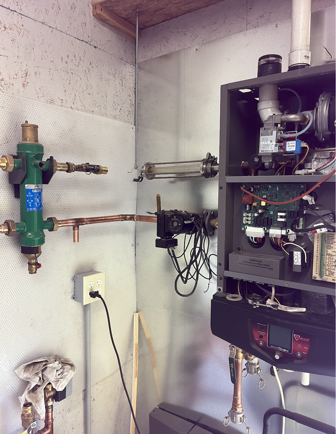

  • @jesmed1 i have just implemented this, using a Raspberry Pi Zero 2 W connected to the PC port to collect modbus data, and set up Home Assistant to see what the boiler was doing 🤓
    My Knight KHB085 has a 21gal system buffer and 80gal indirect tank.
    There are 3 zones for space heating:
    SH1 - radiant floors
    SH2 - hydro-air coil (for backup)
    SH3 - system buffer
    Tekmar zone relays for SH1 and SH2 calls/pumps
    System sensor installed in buffer tank and SH3 call is jumped
    Lochinvar Knight KHB085 with Buffer and Indirect tanks
    950 sqft of WarmBoard on 3 floors, 5 loops in 3 zones
