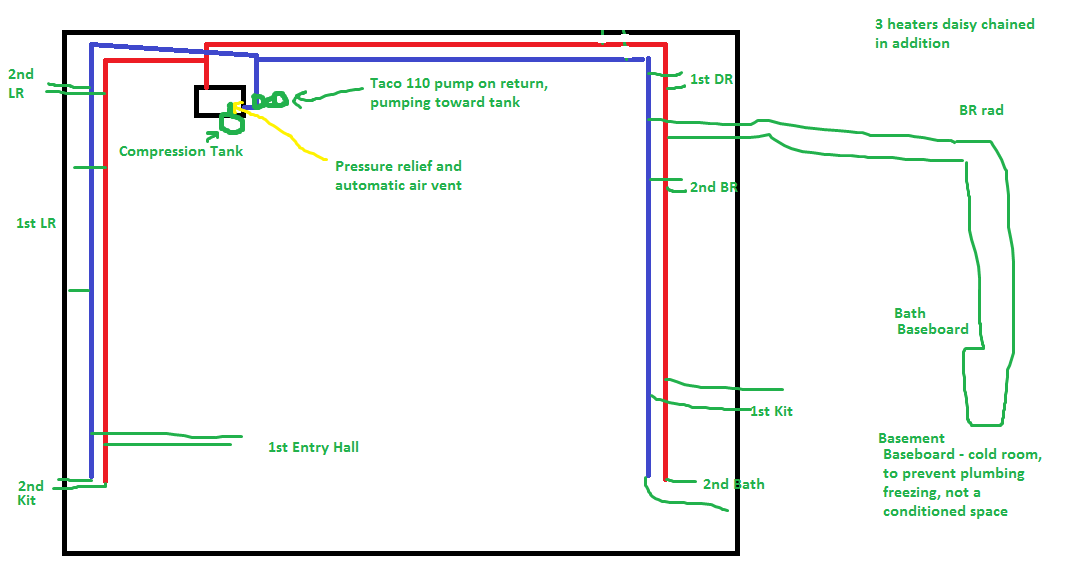

    This is the current rough layout, if it helps. Main trunks are 2", slowly stepping down as you get away from the boiler.
    New layout puts the boiler right under the 1st Kit supply/return. I also plan to split the BR rad at right onto it's own loop, then run the bath fintube, followed by basement fintubes, on a separate run - the basement is just to keep the addition area warm enough to not have frozen pipes in the bath above it, and this should be sufficient w/o a separate circuit. This area is slightly colder than the rest of the building, so think that making the bath fintube get full temp water will help balance that better.
    The eventual basement additional heated floor zone will be about 3/4 of the main square floor area - all but the bottom right which is a laundry/utilities/storage area that already has a new concrete floor and won't be directly heated. For now, just want to be ready to add this on later w/o changing out controllers and totally repiping the near boiler/main trunks to do it. It likely won't be activated for a few years.

    Sounds like the boiler may be at least twice the size you need ?
    Those large pipes acted as a buffer tank, if you start zoning and reduce the system volume and steel piping mass, you may run into worse cycling issues. Which can really drive down boiler efficiency and cause cold run cycles

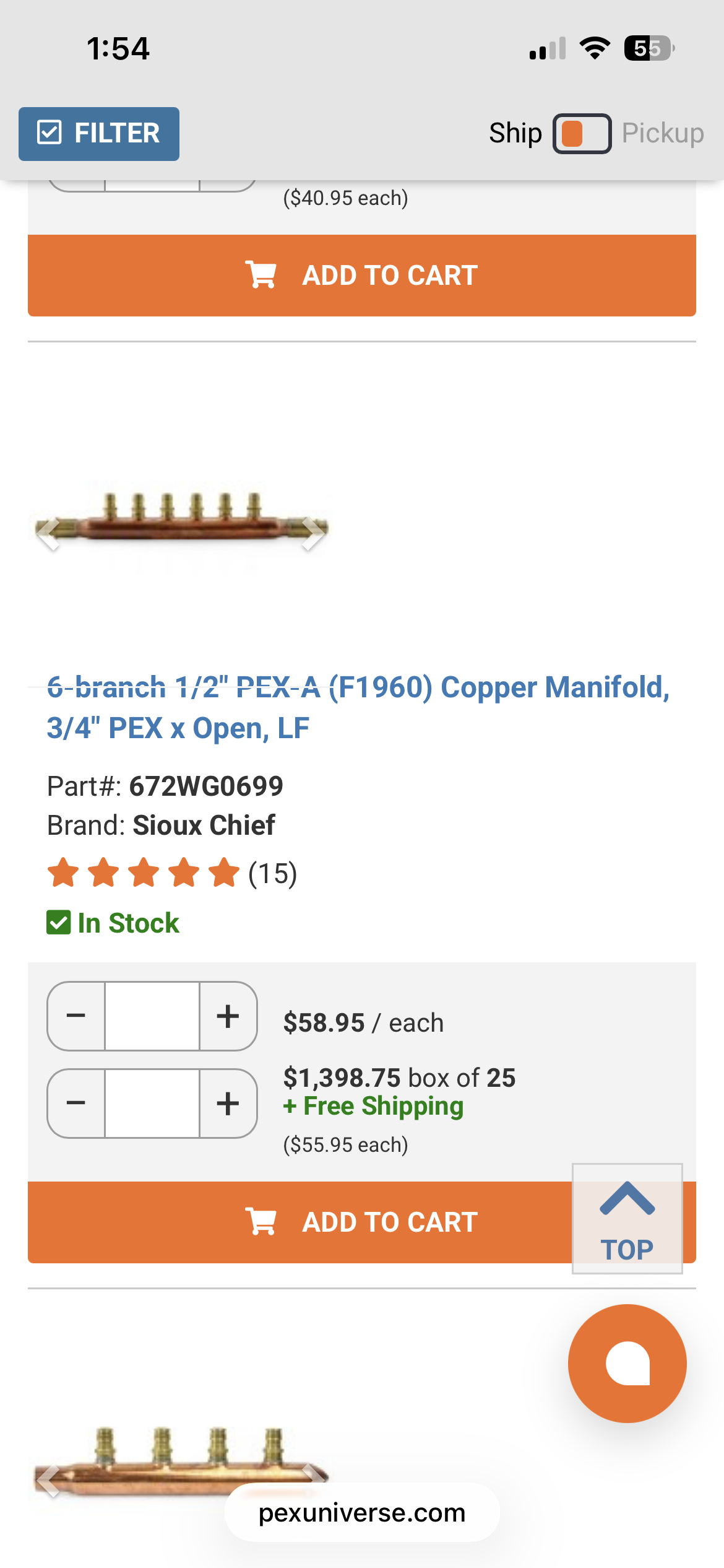

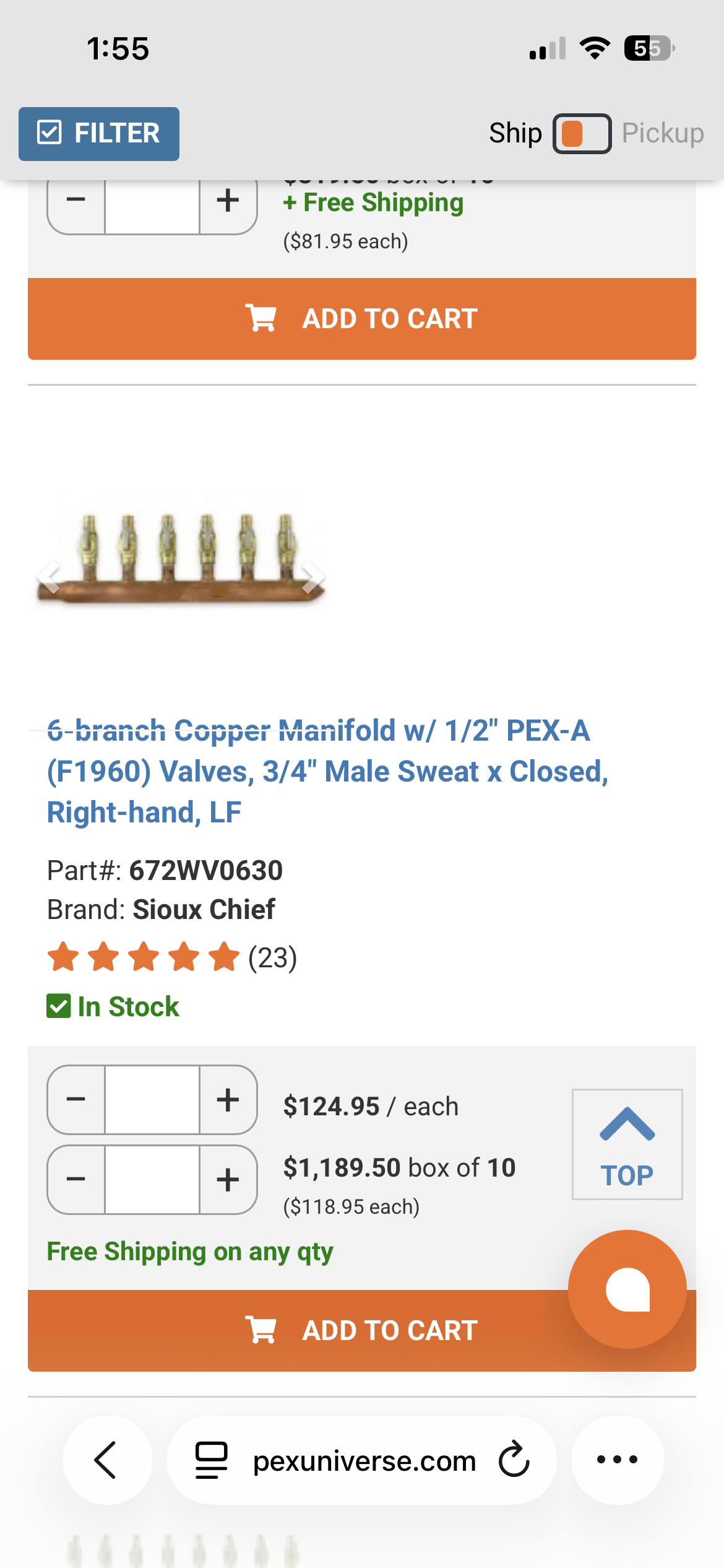

    you can buy copper/ oex manifolds, valves on the supply side, just pex adapters on return. That usually works out to be less $$ out

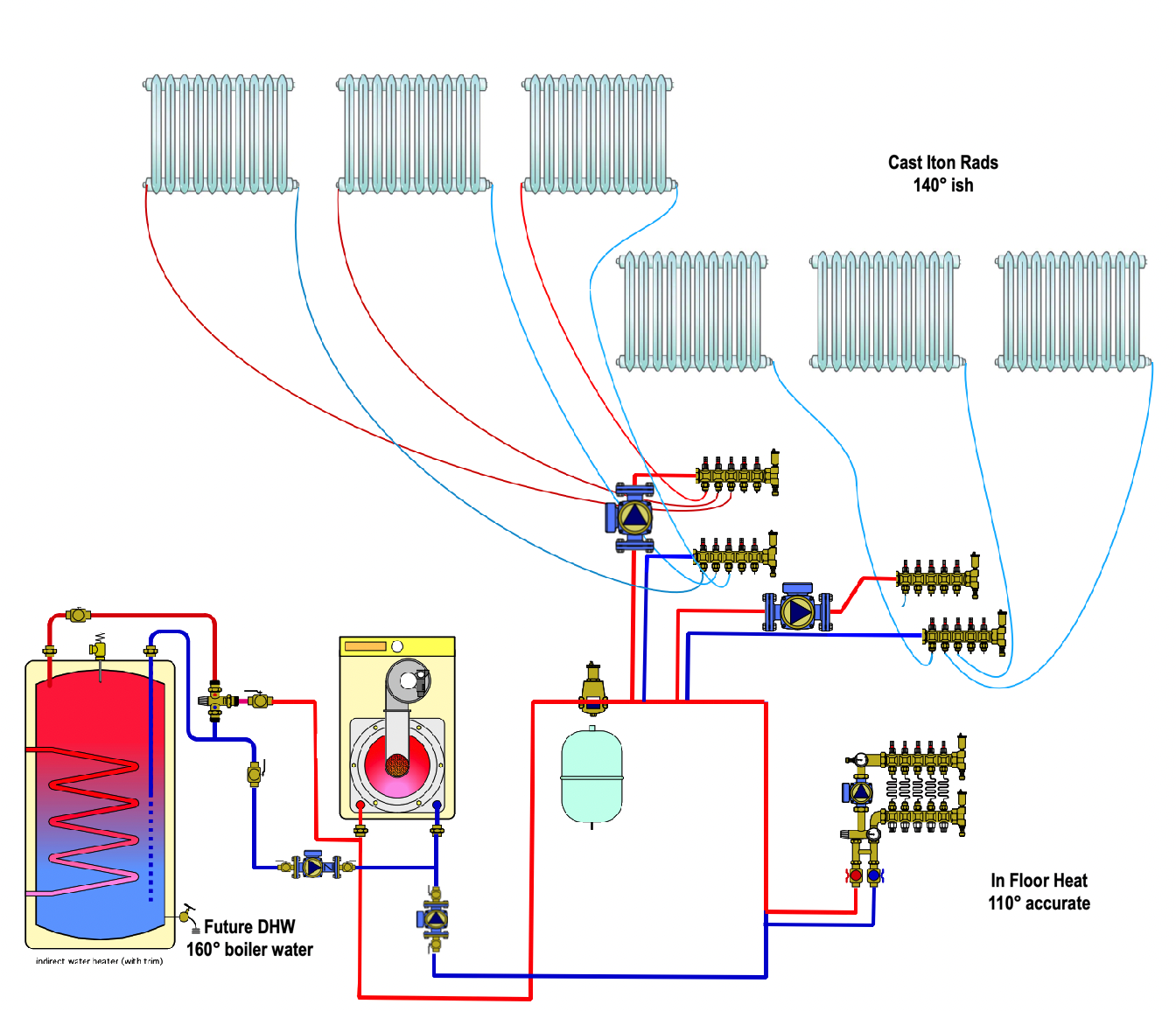

    PC7060
    EdTheHeaterMan Posts: 12,864
    edited September 8

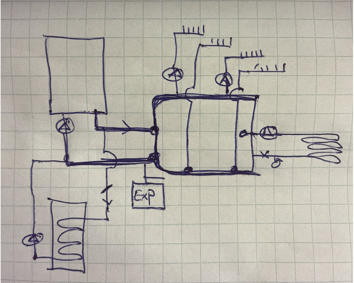

    By no means is this what your finished product will look like, but this is a concept of what you mighr look to be doing. after you have this goal then you can implement one stage at time. leaving the existing boiler in place than removing the big pipes and install manifolds for the cast iron radiators

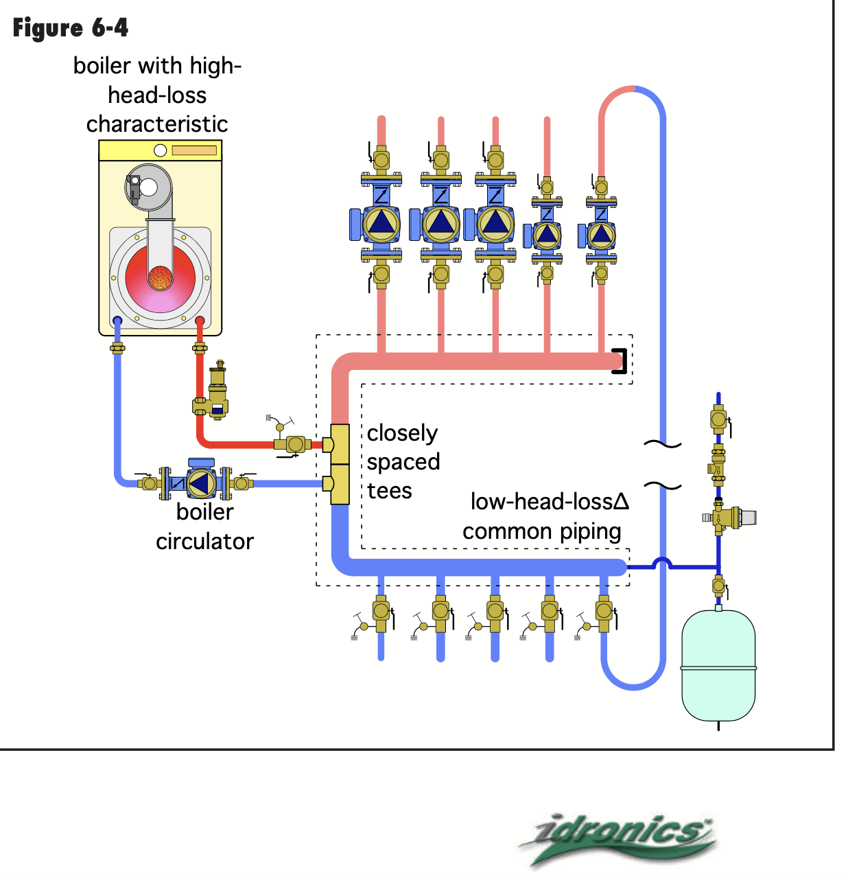

    I have used closely spaced tees for hydraulic SEPERATION. There are other ways to design that idea. My idea is that in the future, if you decide to have a indirect water heater on priority the boiler can feed over temperature water to the DHW tank than go back to providing low temperature water when the cal for DHW is complete. the floor heat zone can be more accurately controlled with a mixing pump or mixing valve.
    I didn't see the one loop of baseboard hot water heat until my diagram was completed but that is a different kind of radiator altogether and should be on it's own separate zone

    Thanks Hot Rod. I have used a ton of those for DHW applications (ironically, have one of them at my home leaking now on the factory brazing and considering going to a homemade manifold made out of 1x1/2 tees in a loop arrangement). Do you think there is no real need for balancing in my setup? I'd be thrilled to not deal with flow valves, which I hear tend to be among the least reliable parts in a system like this. Some of my rads have valves on them, some do not… so might be able to do some minor adjustments with those. TBH, I try not to touch them, as I find they leak most times I mess with them and create more problems for me… but could be used as necessary.
    Ed, thanks for the schematic. I don't anticipate doing indirect hot water, as I have each unit with it's own electric water heater (they pay for the heating, not me) already. Without splitting to 2 boilers (and adding second gas service), I don't see a value for my situation in doing that. The rest makes sense.

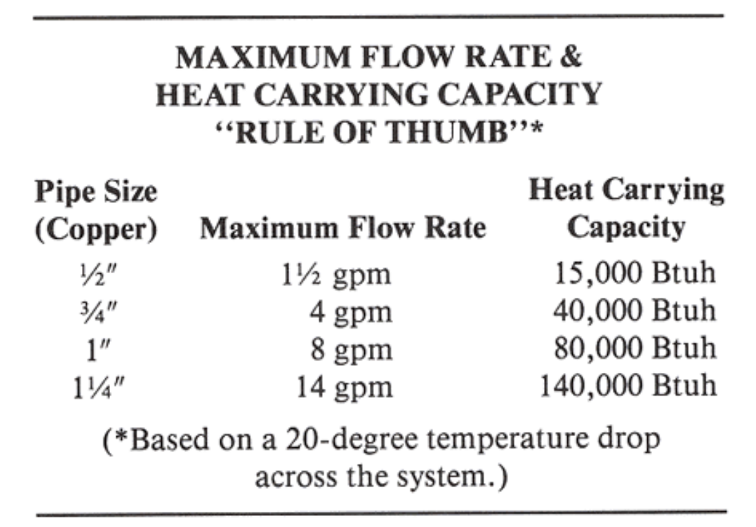

    @MTC said: "Do you have any thoughts on the pipe sizing? Can I get away with 1/2" for all but the big boy radiator? Maybe 3/4 for that one? Or should I do 3/4 and 1"? I'd rather keep the piping smaller if possible, and I think 1/2" has plenty of capacity for all those btu capacities, especially if I'm operating in the 140* range. FWIW, all the existing rads in the house at least end up on 3/4" risers by the end (some start 1" and go down along the run, most are 3/4" the entire way from the main trunks), except the big boy, which is on I think a 1 1/4" set of risers. The house is pretty evenly heated now (other than the 1st BR/BA area being slightly cooler, which I think will be enough just to split those into 2 loops instead of having them in series)."
    This booklet might be helpful as a quick reference: Zoning Mase Easy. I used it as the Textbook for the one day Hydronics class I used to teach. Iy is good to read it several times in order to get the concepts to sink in. At least that was my experience. There are rule of thumb charts throughout the book and all of them are in the last page. You need to know where the numbers come from and not just use them "because I said so", or "because it is in black and white". The chart about pipe size = BTU comes from some pretty standard stuff but know that those source numbers can change so the chart needs to change.
    For example in this rule of thumb chart a 1/2" ID pipe cand move about 15,000 BTUh. that is based on a 20° temperature change across the system. If the temperature change is actualy 15° then the BTUh will be different. So you need to understand the charts before you use them as the gospel truth about pipe sizing.
    But. to answer your question, a 1" pipe is probably the largest pipe you need in your system since your boiler may not have much more than 80,000 BTUh NET output. That NET number is important ince there are three BTU numbers on a boiler the one you use on the radiator side of the boiler is NET. The one you use on the gas pipe side is Input and the other one in the middle is only there to comapre the boiler efficiency to a furnace (duct work system) efficiency. But that is a whole other class for the afternoon secession not relevant to near boiler and radiator pipe sizes.
    The 1/2" pipe can be used for the the runs to each radiator, as long as the radiator is not bigger than a 15,000 BTU output. That would be a pretty big radiator. Also you can
    You will want to consentrate on the first few pages of the book for this basic pipe sizing info. However I encourage you to read the entire text for your complete understanding.

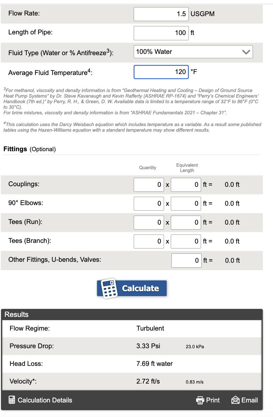

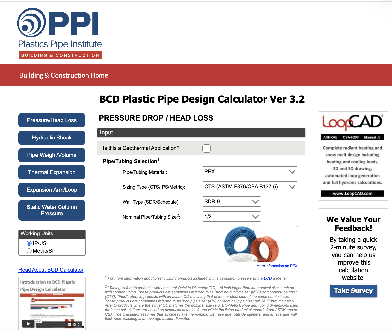

    A few more thoughts. Pex ID is a
    it smaller than copper. Use this free calculator at the PPI website to confirm you numbers. Enter tube, length, and gpm you are considering.
    A basic ball valve is fine for minor flow adjustments. If you use an actual $$ flow setter or balance valve you would want some Y strainers to protect them also. Stick with a ball valve pex manifold.

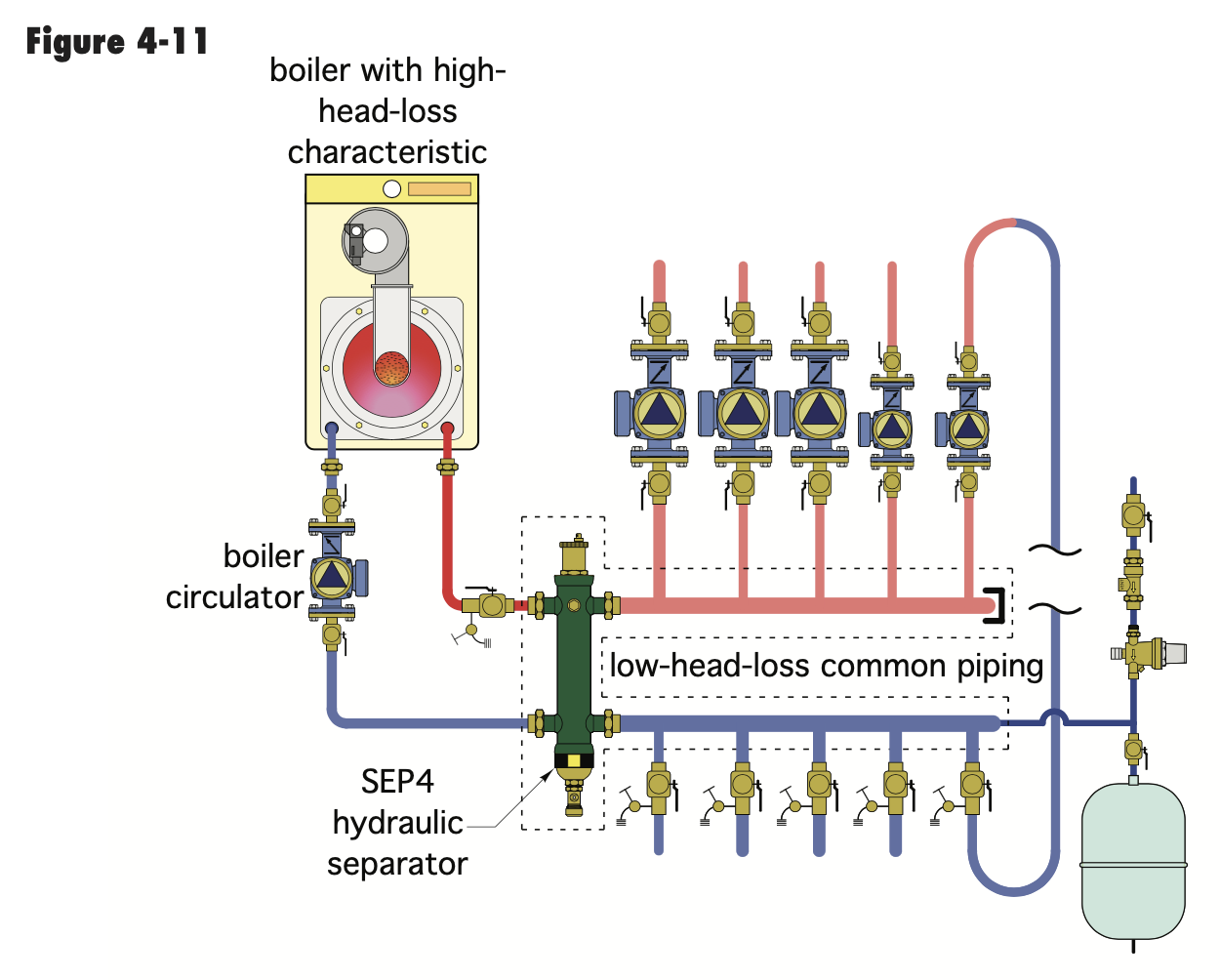

    Here is another piping option the Harvey's Horeshoe primartyloop.
    This eliminates the series temperature drop and the tricky primary pump size. It takes the boliler out of the primary loop. Loads are parallel so they get the same SWT.
    It also puts the indirect directly off the boiler, as a priority and no temperature blending it gets full boiler SWT, and gpm based on it's circulator size.

    You may use hydraulic separators and not use closely spaced tees (Primary Secondary) piping. Just have a plan and stick to it.

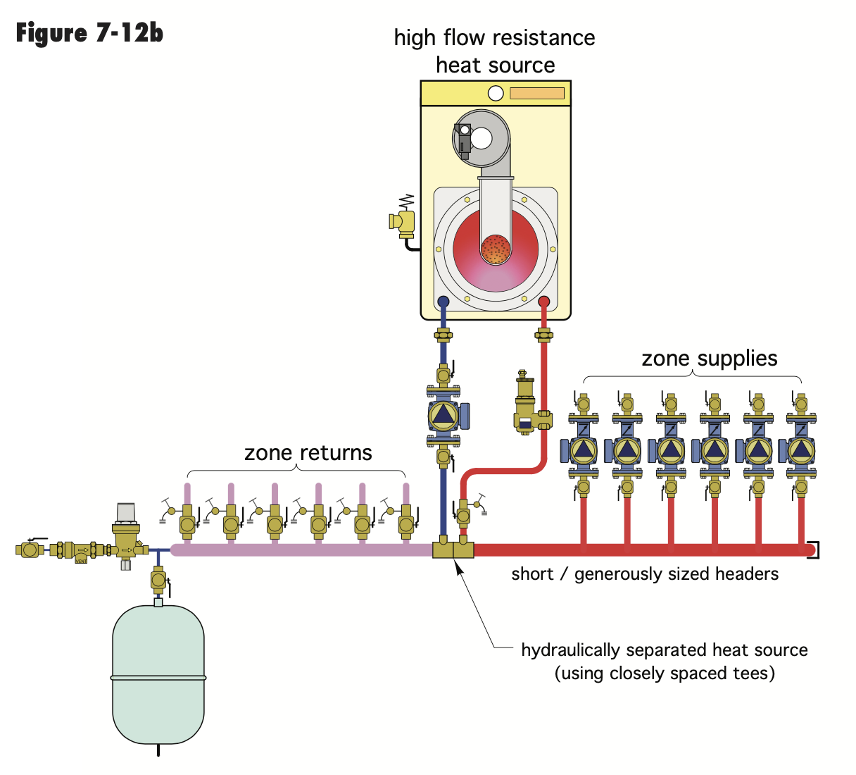

    There are any number of ways to pipe the boiler room.
    I prefer a hydraulic separator as you get air, dirt, magnetic, and hydraulic separation all in one "box" A nice space saver.
    Any of the methods here will allow for future revisions, and protect all the $$ components, and give the system the best shot at high efficiency operation.

    Can you buy and solder tees cheaper that a factory formed copper manifold? You will have a lot of solder joints. Even pex tees are getting $$.

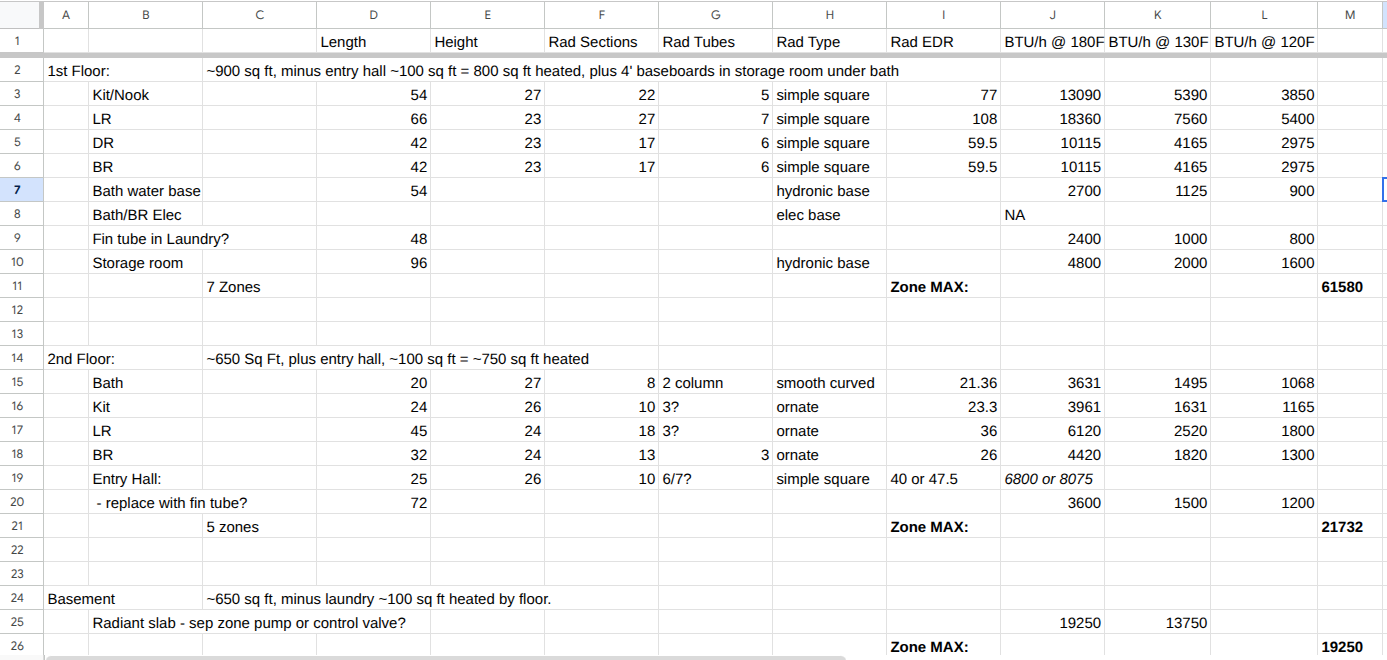

    I just ran another heat load estimate (as a sanity check, as my manual j skills are limited) for the coldest month of last winter based on gas usage, based on this article's instructions: https://www.greenbuildingadvisor.com/article/replacing-a-furnace-or-boiler
    The property is in Pittsburgh PA, and we had a particularly cold month, so this should be nearing the worst case for the building. I took that month's usage, and subtracted the average usage in the summer months (about 1MCF for stoves - water is separate electric heaters), to get about 23MCF, then used 65 degree HDD, 0F design temp, etc to calculate that my building's actual heat load consumption for that month was about 43k BTU/hr. Again, this was a very cold month.
    I had gotten a little under 60K using a SlantFin heat load calc app a while back that approximates a Manual J, using pretty conservative estimates.
    If I look back to the EDR calcs in the first image I posted in the original post, these numbers pretty well align with the 140F design temp BTU outputs of my existing radiation (I didn't total them on the image, but its about 46k output for the existing radiation). Am I making the correct assumption here that I should be able to design my system around 140 degrees (and therefore a mod/con makes sense) without any real trouble? Maybe bump it slightly higher to account for a cold snap, but that should still give me well under 140 return temps…
    Also to take into account - I don't directly heat the basement currently, however a lot of heat is "lost" there now via piping/boiler (largest pipes are insulated, but still losses). This should mostly serve to reduce the additional load from the future radiant floor in the basement, and will likely be reduced losses to the basement with the new system.
    For the immediate, I need to run piping. Given these outputs at 140F, should I run all 1/2", or bump the one larger radiator up to 3/4?
