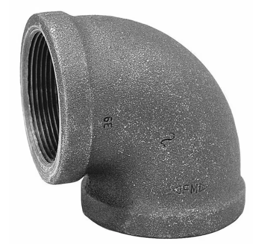

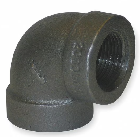

    Here is what the fittings typically look like. The heavier, thicker hub is an iron that you can split with two hammers.
    The lighter version is a steel, it will not crack, you need to saw a notch or two and peel away the fitting, or nipple inside.

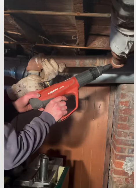

    If you plan on splitting fittings with force, gloves, face shield, hat maybe the hard type, long sleeve clothes, pieces can fly.
    You can find videos of plumbers splitting fittings. An Instragrammer recently showed a concrete anchor gun being used to split cast fittings!

    Got it. I did see similar videos. We used to call them Hiti guns. Brand name of course but it's the type of nail gun that uses what we called shots. Basically, like a blank that would be use in a pistol. We used them to drive nails into steel beams on one job we did. Those things are no joke. Thank or the help.

    it seems like a ricochet could be deadly using the desa or remington…
