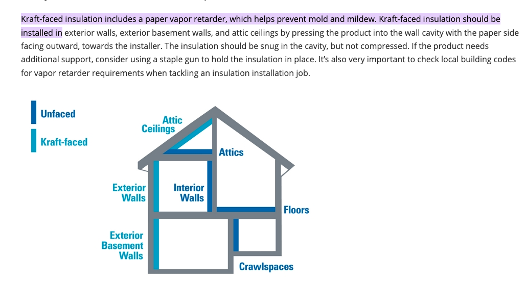

    I think you are talking brown kraft paper, not the foil faced stuff? Seems the Kraft would keep any crawl space moisture out of the batts?

    If the crawl space is conditioned it shouldn't matter. There's no vapor drive between two conditioned spaces.

    Kraft, no foil. The outside walls of the house have poly sheet and the blue board against the inside of foundation serves as a vapor barrier there. The ground is also lined with poly. The rim joist is insulated with eps and xps insulation and sealed with canned spray foam so the ends of the fiberglass won't be against a cold face. Also, we are not in a high humidity area and the poly on the floor does a good job of blocking any water vapor coming from in the ground. I also have an HRV for the house.
    My thoughts go along with those of DCContrarian, the temperatures will be relatively close. I'm not attempting to keep the crawl space cold, I just don't want it to be warmer than the house.
    My experience with kraft faced is that it's less effective as a vapor barrier compared with poly and that unfaced is subject to air infiltration. Infilitration may not be an issue in this application since the bottom of the plywood floors and joists would prevent most air movement if there is no air space above the fiberglass.

    Using heat transfer plates, no face, no space is fine. Without heat transfer plates you get banding, not an efficient transfer of heat energy. I like two runs of pex per bay, but may necessitate shorter circuits.

  • Is there any fire hazard / danger in putting the paper face insulation with the paper in direct contact with the aluminum plate ?

    Ignition point is probably 450°F or so. Rarely do you need to run over 130, 140F max. on any plate system. 115- 120 is a design temperature example.
  • Ignition of kraft paper faced fiberglass, styrene foam insulation, or the wooden structure isn't an issue with the temperatures used for hydronic heating. However, expanded or extruded polystyrene isn't suitable above about 165 f. The hydronic heat won't ignite it, but it softens and causes it to lose the properties that make it suitable for insualation. If the temperature exceeds the design limit, polyiso insulation or fiberglass should be used. When I was designing my system I found that polyiso (more expensive and not as readily avaiable) was frequently recommended for use in radiant walls, but I didn't plan for the water temperature to ever exceed styrene's limits. The higher heat used for baseboard could easily exceed that limit if the pipe/tubing is close to the styrene.
    In some places building codes require that flamable insulation be covered with a flame resistant coating such as drywall or plywood, but that's to protect it from an external ignition source, not from the heat from the hydronic system.

    mine is no face no space as mentioned above over heat transfer plates. Less costly and gets the job done.
