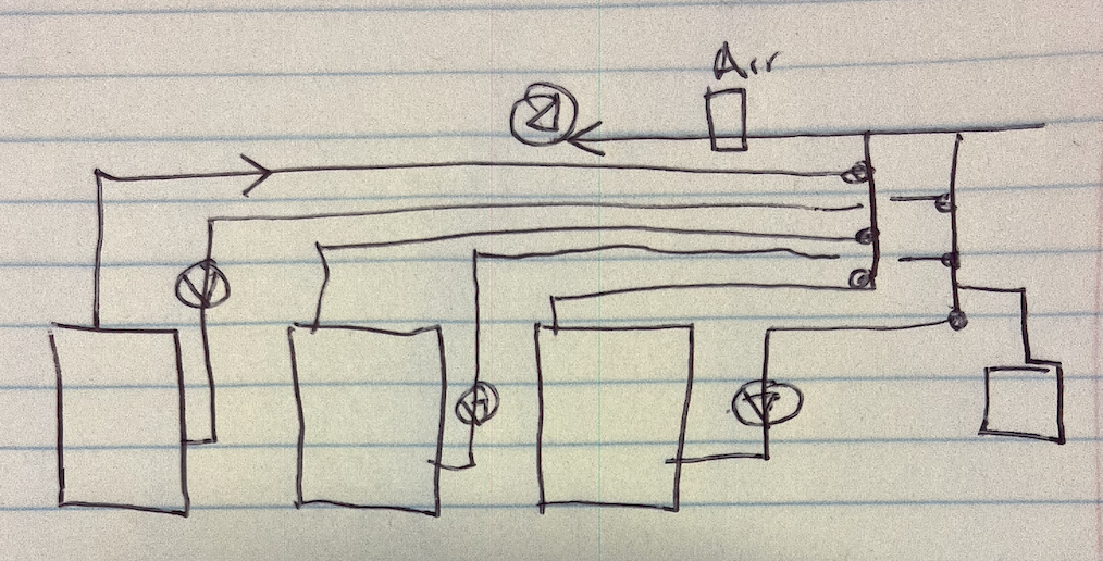

Few questions in regards to multiple boiler piping..

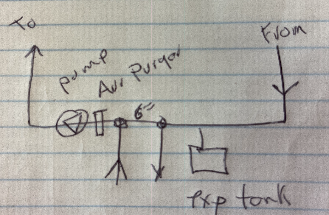

1st is about system circulator.. I included a quick drawing with 2 options for circulator location. Can anyone suggest the proper (or better) location for the system circulator ??
And this job is gonna have 3 boilers installed, obviously each with it's own circulator…
So question 2, is there a preference as to which side of the boiler each boiler circulator should be ? On supply or return of boiler?
And 3rd, does each individual boiler need a check valve in the piping ? Again, is it preferred on supply or return of boiler?
Thanks for any advice.

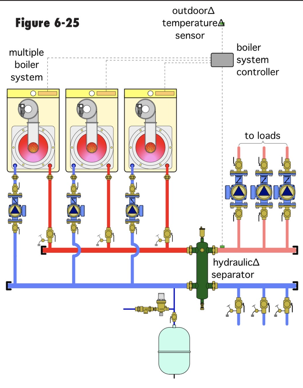

With conventional CI boilers, pumps could be on either Sor R
With high pressure drop mod cons, pump into the turn.
A hydraulic separator make for a nice installation, giving you air, dirt, mag, and hydraulic separation.
If it is a high mass distribution, CI boiled may need return protection.

Option 2 I like better regardless of the boiler as far as the system circ goes.
As far as the boiler(s) circulators I would put them on the return if it is a mod con with a high pressure drop. CI boilers it probably doesn't matter.
They will be cast iron boilers
The expansion on the inlet side of the boiler and system pump.
Air purger at supply from boilers
