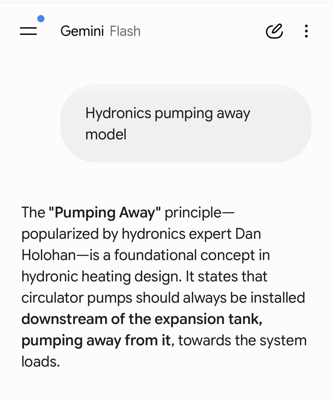

    Gemini is in the know!
    The Core Physics
    The point where the expansion tank connects to the main piping loop is called the Point of No Pressure Change (PONPC).
    • The expansion tank acts as a pressure reference point. The static pressure at the PONPC remains constant regardless of whether the circulator pump is running.
    • Pumping Away (Correct): When the circulator is placed downstream of the PONPC and pumps away from it, the pump's head pressure adds to the system's static pressure. Higher pressure keeps entrained air dissolved in the water and pushes it toward the air separator to be vented.
    • Pumping Towards (Incorrect): Placing the circulator upstream of the PONPC pumping toward it causes the pump's head pressure to subtract from the system's static pressure. This drop in pressure can pull air into upper radiation units, cause cavitation at the circulator impeller, and create noisy "pinging" pipes.

    The Carlson- Holohan award goes to Gemini
    But you specifically asked for pumping away? Ed didn't? So he got the pumping at option?
  • PC7060
    PC7060 Posts: 1,980
    edited August 26
    I’d say so. So keep spreading the word, informed users get better results!
