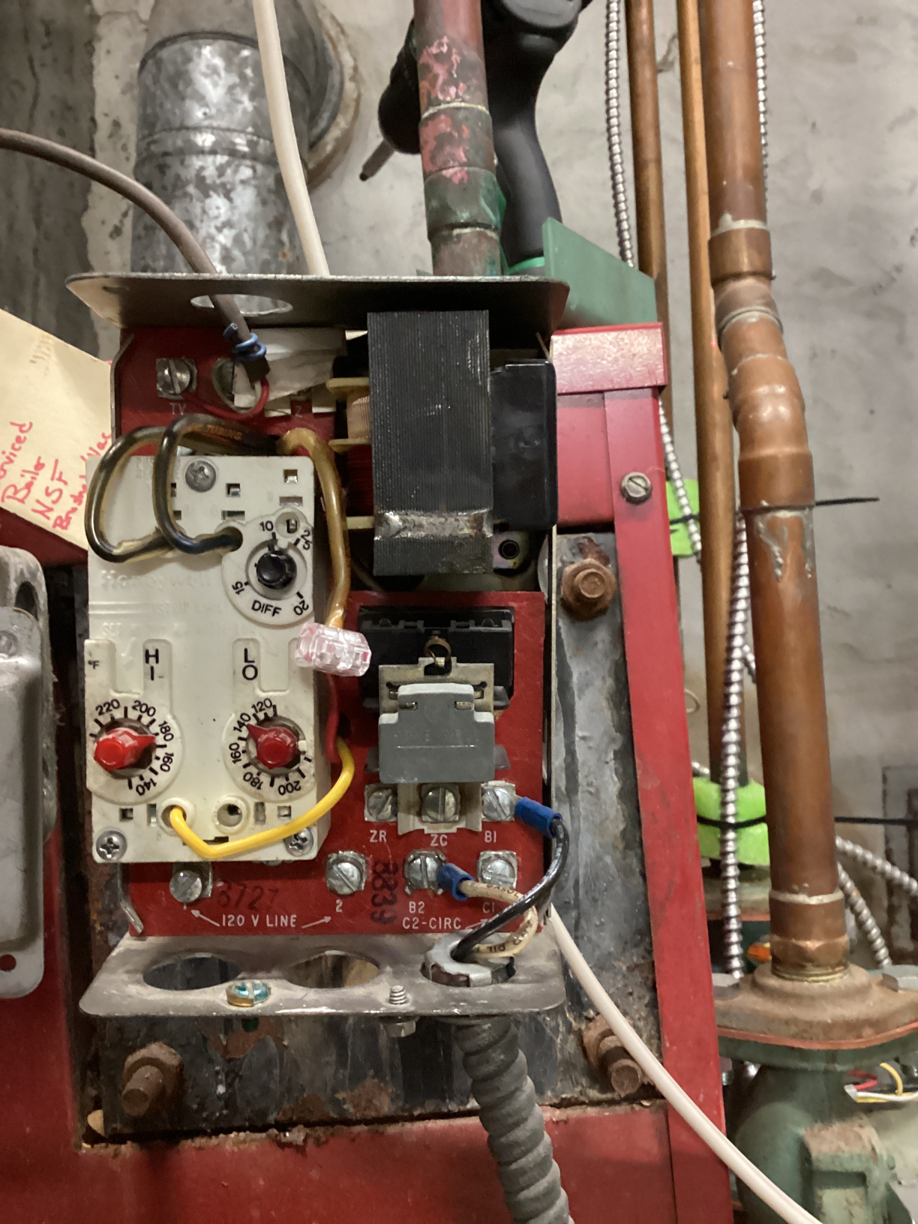

    Hi, I’m new here and would like help with an issue. First, can you tell me what Honeywell aqua-stat is in the pic above? I have the same model but no label to indicate which variation. Also, I picked up a Taco sr504-4 to control 3 circ pumps and an indirect water heater pump but am not sure how to wire it up. Do I run everything to the Taco or leave the boiler circ pump wired to the aquastat and run the other pumps off of the Taco? Thanks for any help I can get.
    HVACNUT Posts: 7,784
    This aquastat
    is an L8124E. You might have the A instead of the E.
    All circulators will go to the Taco zone panel with the water heater being the priority zone. Since you have an indirect, you can run a 2 conductor thermostat from TV-T ( If you have the "A" aquastat, it's T-T or R-W) on the aquastat to X-X on the Taco panel and turn the Low side down to 135° if its a cast iron boiler. If its a low mass CI or a steel boiler you can turn the Low all the way down. No need to use ZR/ZC since there's no longer a tankless coil to maintain temperature.
  • DStreet
    DStreet Posts: 15
    Thanks HVACNUT. My aquastat is the ”E”. It’s identical to the one in the picture. I was curious about the low side temp because of the indirect water heater. I bought my house a year and a half ago and it’s ago and the water heater tanks is showing signs of leakage. I need to figure out what to replace it with. I’m only staying in the house for a few years and don’t want to spend a lot of money.

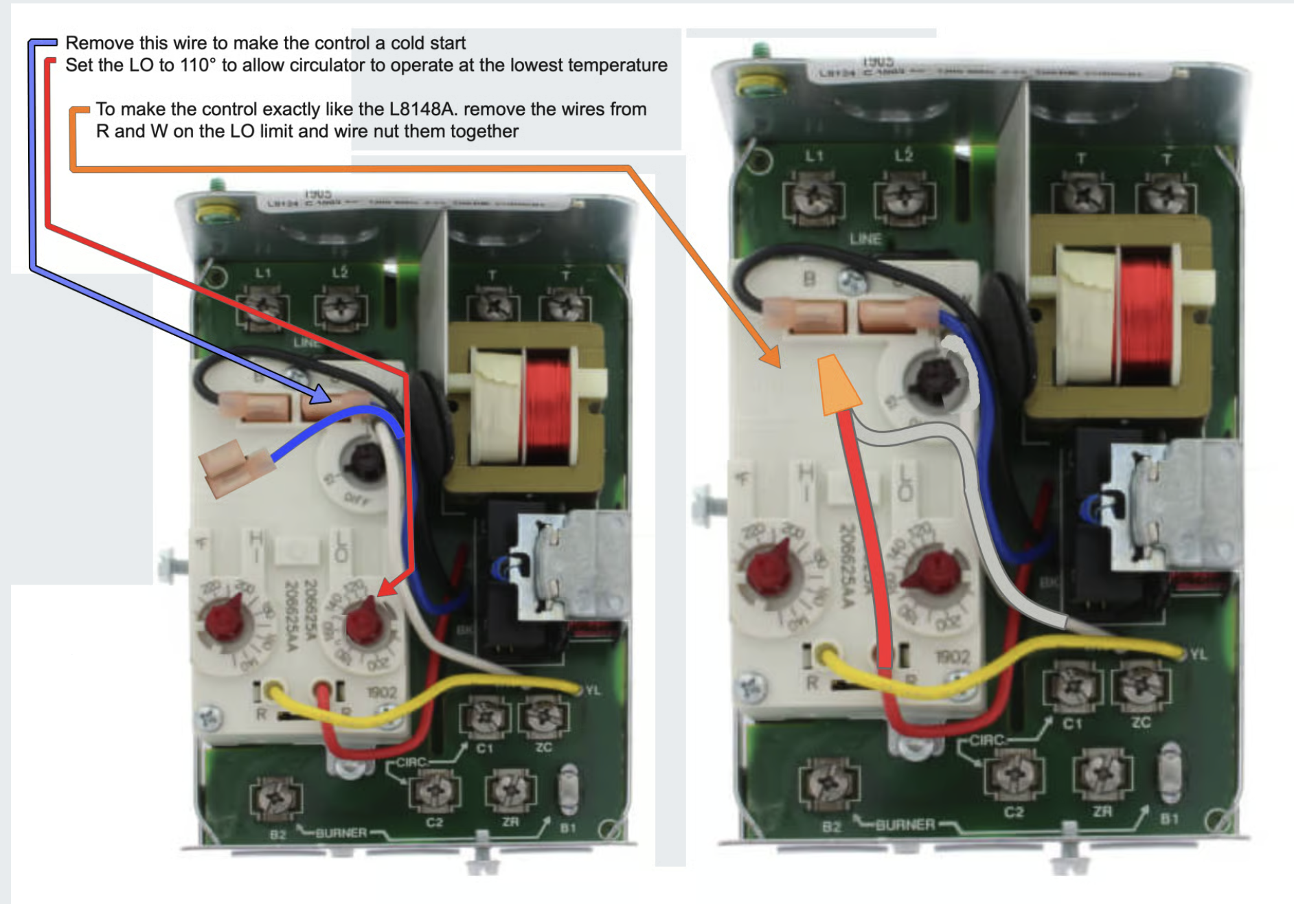

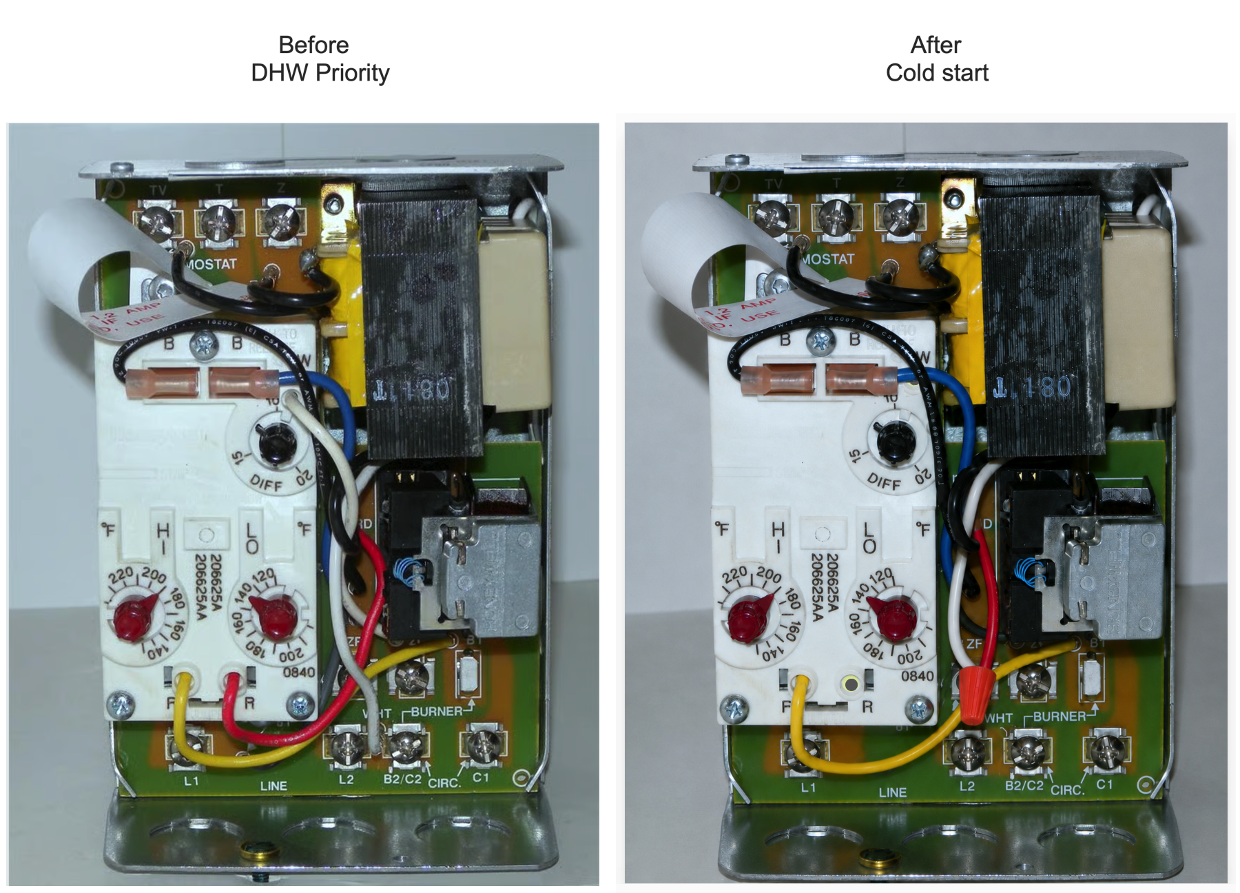

    Here is the easy way to make that L8124E into a cold start control.
    Remove the Red wire from the R terminal on the LO side of the control block and remove the White from the W terminal on the LO side of the block. Now connect both Red and White wires together with a wire nut. Now you have a cold start control. See the illustration on the right.
    After you do that, and you find that you are getting return water to be below 135° for more than 10 minutes (or for the entire call for heat) then you need to have boiler protection to reduce the chance of flue gas condensation. This is easily done without a separate control. just put the red and orange wires back in the control in the original location and remove the blue wire from the B terminal of the LO side That will prevent the burner from running to maintain temperature but hold the circulator pump off until the boiler reaches the temperature setting of the LO limit. I would try 140° with a 5° Diff for starters just to see how that works out.

    EdTheHeaterMan Posts: 12,940
    Here is a picture of the control after the red and White wires have been connected together with a small wire nut. you can hardly see a difference

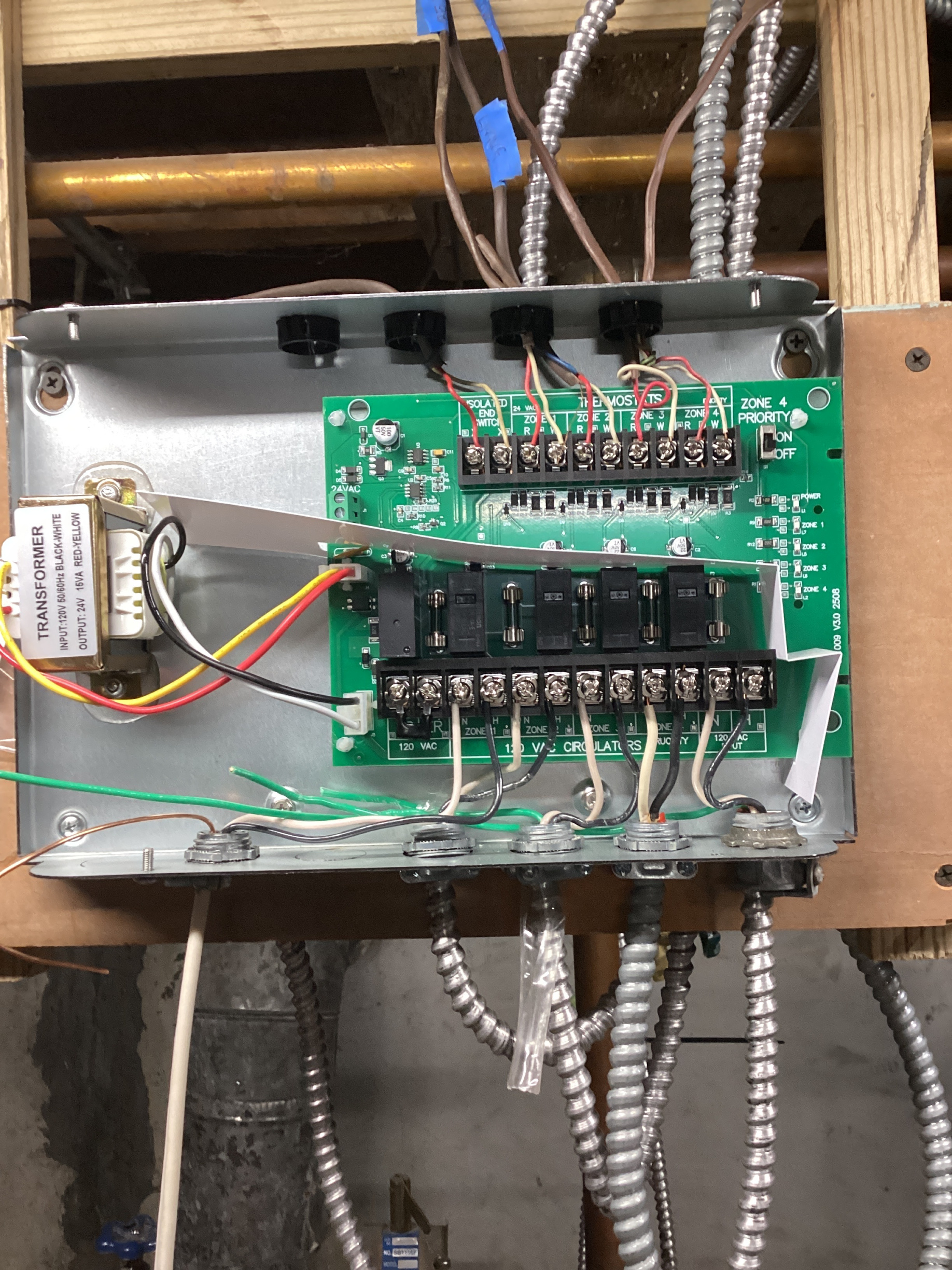

    I have wired the Taco 504-4 as the instructions say and the boiler doesn’t fire and circulators pumps don’t work. I ran the low volt wire from XX to Tw T and 120v to the L and N connections. I don’t get how the boiler aquastat is powered without a 120v feed.
    Is the green power light lit on the Taco zone panel?
    If you're using X-X to Tw-T, then its a cold start aquastat? What model aquastat?
    If you jump R-W at any zone on the Taco panel, does anything happen?
    Is anything wired to C1 in the aquastat?

    I have no power to he aquastat. That’s the problem. The boiler doesn’t fire because the aquastat isn’t getting power from the relay.
  • JMWHVAC
    JMWHVAC Posts: 134
    Yes, the aquastat needs power to the 120v terminals.
    HVACNUT
    You need to connect to "120 v line" in the aquastat.

    The biggest problem I’m having is power to start the boiler when a t-stat calls for heat. The directions from the Taco say 120v to the circulator connections and a wire from X X on the relay to the T Tv on the aquastat. Well I did that but when I turn on the power I get a green light and 4 red ones. The circs run but the boiler won’t fire.
    Originally the boiler was tied to a circ pump but I moved it to the relay thinking that was the right thing to do. How would you establish power to the boiler?
    Quick question. When one or more of the circulators calls for heat, does the relay close? Check to see if X-X is a closed circuit.
    Now… I notice that X-X is on the low voltage side of the Taco board. Further, X-X is for an isolated contact set on the Taco board — among other things, that means it can't supply power to anything — just open and close a circuit.
    In this instance, I expect it is closing a 24 VAC circuit from the aquastat, which includes the power transformer on the aquastat and the coil of the aquastat's relay (which, in turn will send a closed circuit to the burner control.
    BUT. to have 24 VAC for that relay, the aquastat has to have a 120 VAC power input, as @HVACNUT mentioned. That 120 VAC input only powers the transformer on the aquastat — it's not connected (or shouldn't be!) to anything else. I'd take it off the same circuit which powers the Taco and the burner. That way if you flip the breaker for the system, or open the service or emergency switch, everything will be dead.
    So what will happen is this: the Taco board senses that one or more zones needs heat, and does two things: closes a relay to power the appropriate zone or zones, and also closes a relay which closes the circuit between X-X on the Taco board. Now on the aquastat side, there is a 24 VAC power source (which you just hooked up!) and there is a relay; if X-X on the Taco is closed, and the temperature sensed by the aquastat is between its limits, that relay will close and send create a closed circuit with the control terminals on the boiler, and the boiler will fire.
    I'm honestly not sure which pair of terminals on the aquatstat are the burner control termnals. I THINK they are B1 and B2.

    You need to feed 120 volts to the triple aquastat. It will power up the tv-t circ. The tv-t circuit will land on the x-x of the switching relay. The x-x on the taco switching relay are dry contacts and when any zone calls the x-x circuit will close causing the triple aquastat to function.
