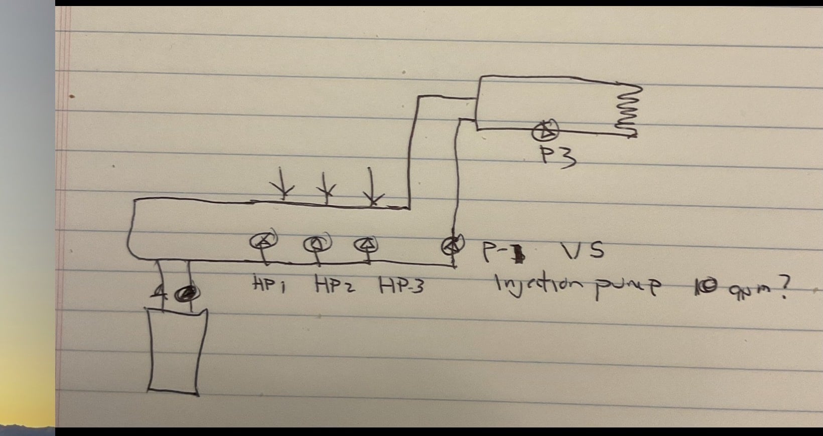

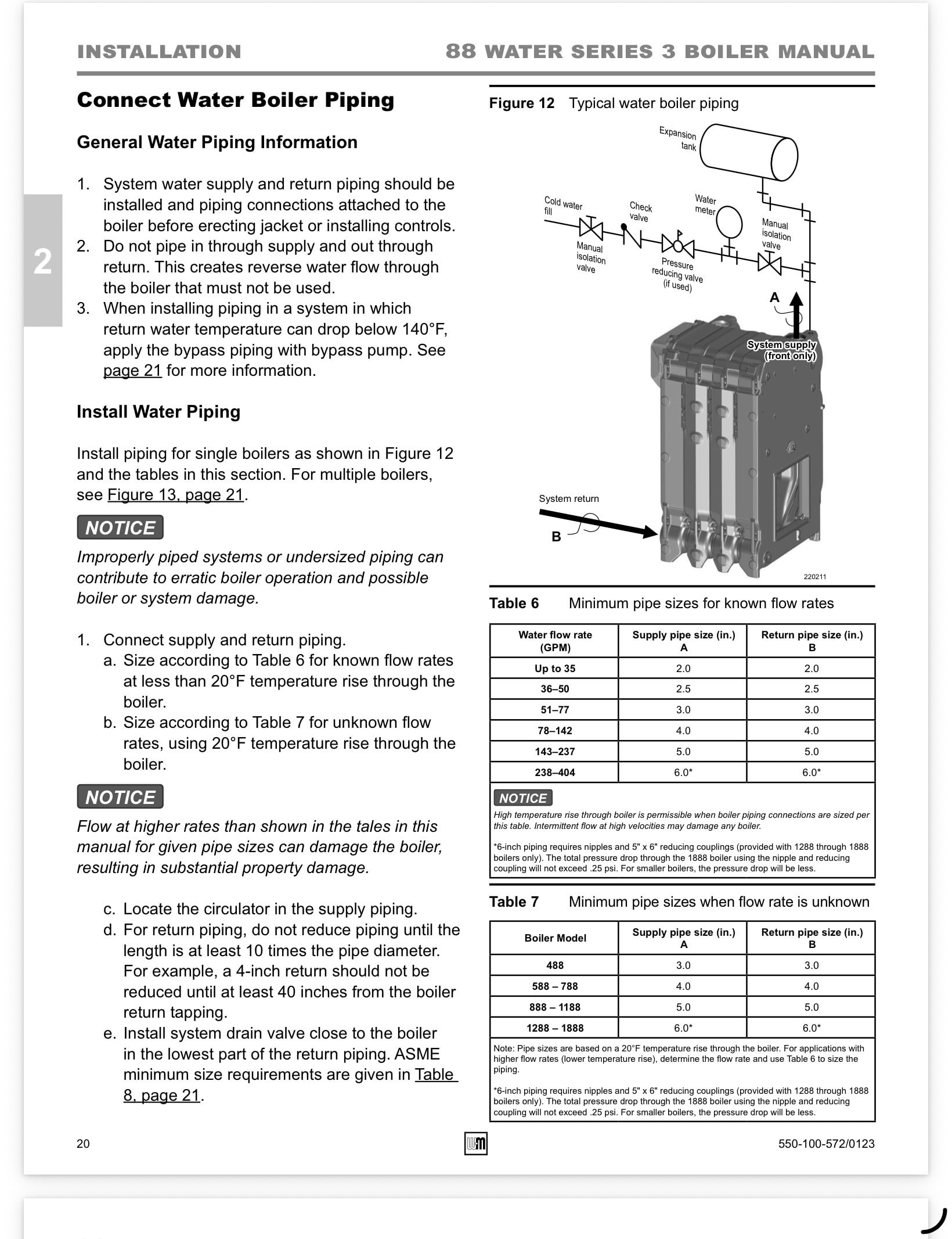

    Your drawing shows a primary loop with close tees, or Taco tees, that works. 33 gpm from P-2 may not get a 20∆ through that 662,000 boiler, assuming it is a single stage firing?
    1" would be adequate for the injection loop, just over 10 gpm..
    In your drawing your high temperature loops are parallel to the primary loop.
    Seems those zones should be sets of tees off the primary loop? Or else P 2 may, probably will push some flow through the HP zones. Idronics 19 talks about a boiler primary loop with parallel secondaries.
    I think what you are trying to accomplish is equal temperature to all the HP zones? So taking those off the primary loop as closely spaced tees would present temperature drop, depending on which zones may be calling at any time. So a series primary loop is not an option.
    My chicken scratch drawing at the bottom shows the boiler "injecting" into a loop that assures all zones get the same temperature. They are parallel loads. Then a injection loop for the ceiling zone at 140 SWT. 45 gpm around the loop, 2" may be adequate?

    EBEBRATT-Ed Posts: 21,217
    @hot_rod IDK the main being 3" is way oversized for the flow. I don't see much pressure drop across the 3" at that flow.
    The circs on the 3 HPs added to P3 give him the 66 gpm he needs for the boiler
    hot_rod Posts: 28,569
    but the boiler only gets 66 gpm when all HP are running?
    And they are in series so what gpm goes to HP 1,2 and 3?
    Checks will be needed at all 3 HP or you can get reverse flow
    If the system is getting repiped, why not do it correctly? What is the downside?
    You are talking two tees at the boiler to make an accurate p/s. The boiler gets the flow it needs always, no pump interference in the distribution, no potential ghost flow.
    The installation manual does show a bypass pump to assure the boiler gets enough flow. P/S solves that concern also.
    Although the boiler may short cycle it’s brains out on low load conditions if it is twice the required size?
