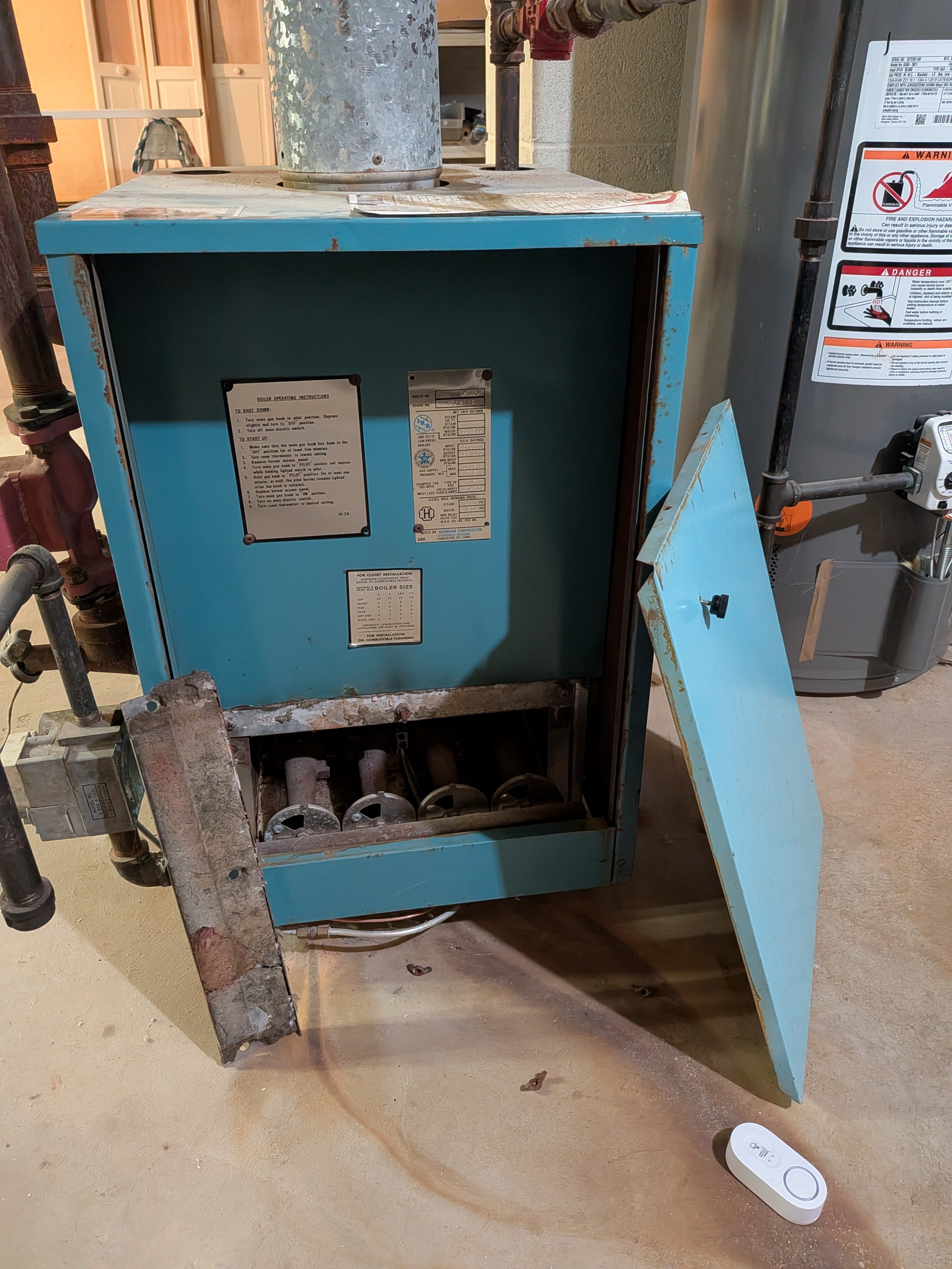

Hi All,
I'd appreciate some input on considerations for removing my old hydronic boiler, its a Burnham Series 22a from the mid 1970s.
How much might it weigh? Has to be taken out of a basement up a flight of stairs with a turn at the top.
Should I attempt to dismantle it at all? Might it contain asbestos, so this should be avoided?

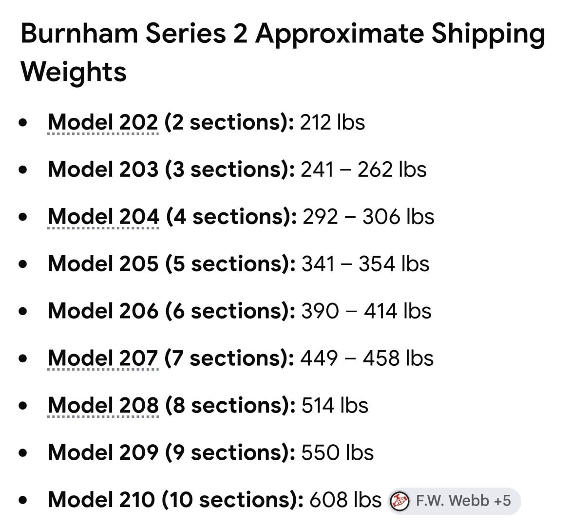

    That should weigh about 500 pounds. If you are careful and have three men and a boy, you may be able to get the cast iron out in one piece. If you are alone, then you can separate each section and take them out one at a time.
    That is a lot more work, and the stuff that spills out of the water side will make a real mess of your carpets.
    In the 1970s Asbestos was still in many heating systems and may be part of the cement that seals the joints between the sections and in the gaskets that seal the flue collector to the cast iron. It is not as lot, but it could be there.

    It came in in 1 piece so it can go out in 1 piece if you know how to do it. I worked alone most of the time so I would take it apart.
    Drain it and cut it loose from the piping. Dump a bag of speedy dry on the floor to soak up any water, dust and soot.
    Remove all the controls and jacket and burners and the cast iron sections will come off the base.
    This will remove some weight then you can decide whether to take the CI block out in 1 piece or dismantle it.

    less than 100,000 btu I seriously doubt 500# Probably 250ish.

    That's cast iron sectional, so it's heavy — probably 400-700 lbs assembled depending on how many sections it has.
    Good news is these aren't one solid piece. They're held together with tie rods, so you can pull it apart into individual sections (maybe 60-100 lbs each) instead of carrying the whole thing up the stairs at once. Way safer and easier.

    That boiler is not as large as everyone thinks.
    I had an old Crane boiler in my house 125,000 input. Crane sold-out to Burnham so it may be the same or similar boiler. The Burnham in the picture looks like the same CI burners I had. Two people could take that out in one piece without much trouble. Strip the jacket , burners and controls and base off it.
    I took it apart because I was alone. I think it had 5 little sections (maybe it was 4). I was 67 at the time and I could very easily pick up a section and carry it. But I was used to moving Smith #28 sections that the front and back sections are 800# or more. We used Johnson Bars, Chain falls, come a longs and hand trucks wherever we could.

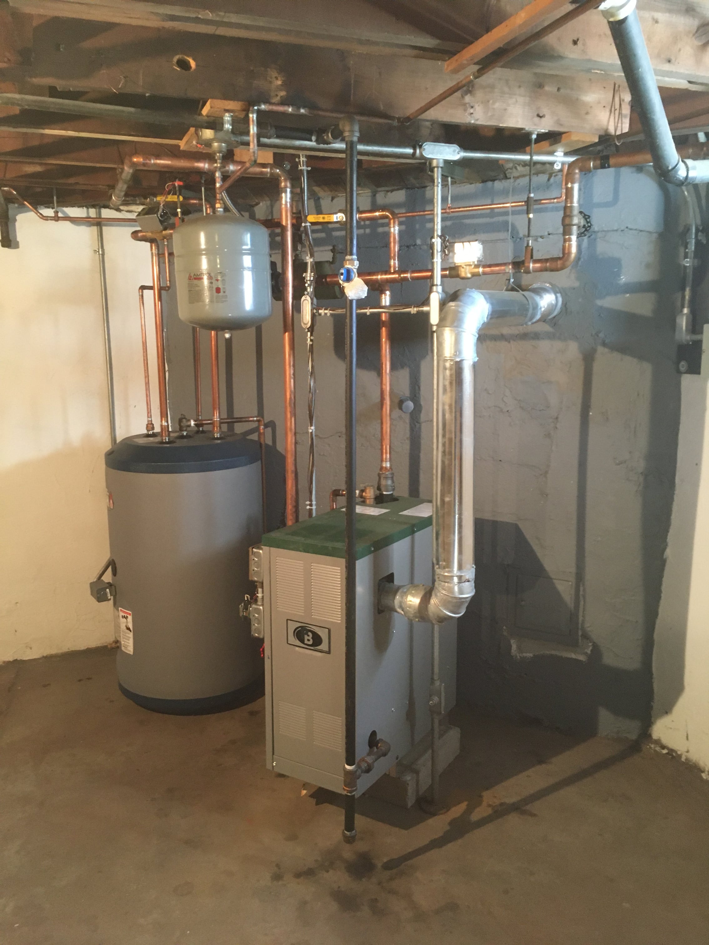

    Once you strip the jacket, controls, burners and base it is not very intimidating, The amount of asbestos is negligeable. I would wet it down and scoop it up. Replaced it with this Peerless which I also moved in myself. Piece of cake the new one is a
    PSCII-03 330lbs in the crate. Installed during COVID October 2020
