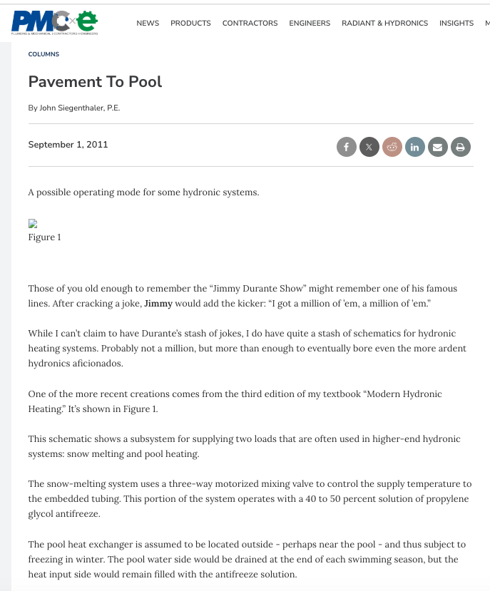

    Ok. I've sketched where I might add a HX for summer auxiliary usage. The system will use a Tekmar 671 for control in the winter. I was planning to power the 5 system pumps through 5 of the 6 boilers, to balance the electrical load. However, if we opt to use the system in summer, should I think about a separate switching relay that could turn on just 1 or more circulators in summer? I doubt we'd need them all for summer auxiliary.
    hot_rod Posts: 28,699
    edited July 27
    where is this located? How large of a pool?
    In sunny warm climates pools can too warm in the summer.
    The driveway is basically a large un-insulated collector, efficiency can be quite high, but when ambient is near pool temperature.
    So how many days is the driveway surface warmer than the pool? And the pool actually needing heat? Will it be worth the $$ to try and capture this "free" energy.
    A handful of pool specific solar collectors may be a lot less $$, if you have a place to mount them. Typically the pool pump circulates through pool collectors. So no HX additional piping, controls. Or tying into those 4" lines near the sep!
    More ideas here.
    https://www.pmmag.com/articles/94473-pavement-to-pool

    PhillipJones Posts: 19
    Good point, HR- I may just try to steer this back to basics. Adding a bunch of tech to save a few bucks is not always worth the squeeze. The project is in Ohio, and I doubt the pool or domestic heat load would be sufficient to merit the additional cost. Just because you can does not always mean you should. Thanks!
    I’d guess if they have the $$ to run six boilers to melt snow, they could afford a pool heater or HX 😉

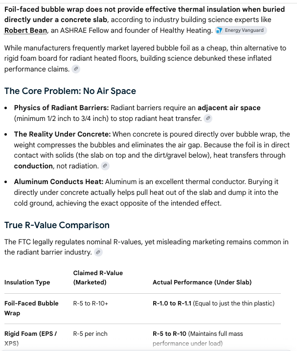

  • As we gear up for the pour this fall, I read a recent discussion here on the topic of tubing and rebar placement, and the pros and cons of various methods. Our install game plan at this point is for about a foot of compacted limestone, a layer of Insultarp, 3/4" tubing on 6" spacings tied to #4 bar in an 18" grid, on 1-1/2" chairs. @GroundUp , I'm interested in avoiding the air pockets you mentioned that can result from bridging of tubing tied alongside the rebar. Is this avoidable by using a higher slump concrete mix or something? When I hear you've torn some out, I get palpitations. :) The input from this group is appreciated; I've got one shot to get this right. There is natural slope in all this driveway, and there will be trench drains crossways every so often to dewater the drive during snowmelt operation. Anything else we are overlooking?
  • PC7060
    PC7060 Posts: 1,980
    edited August 27
    Insultarp is designed to be rolled out over new concrete as temporary measure to prevent it from freezing while it cures.
    Is it rated for below grade installs?
    Why not use 2" XPS (R10)?

    @PhillipJones Bubble wrap and radiant barrier are things that feel like should provide insulation, but they don't. For radiant barrier to work, it needs to be facing an air gap, that is hard with gravel under and concrete over it. I don't know what testing those Insultarp folks did, but nothing out there will get you over R10/inch, which is about 2x what most real rigid insulation is.
    Use real insulation like XPS or EPS. Around me (north edge of zone 5) for residential snowmelt the common way is with radiant PEX panels (EPS with vapor barrier facer and bumps for PEX) like:

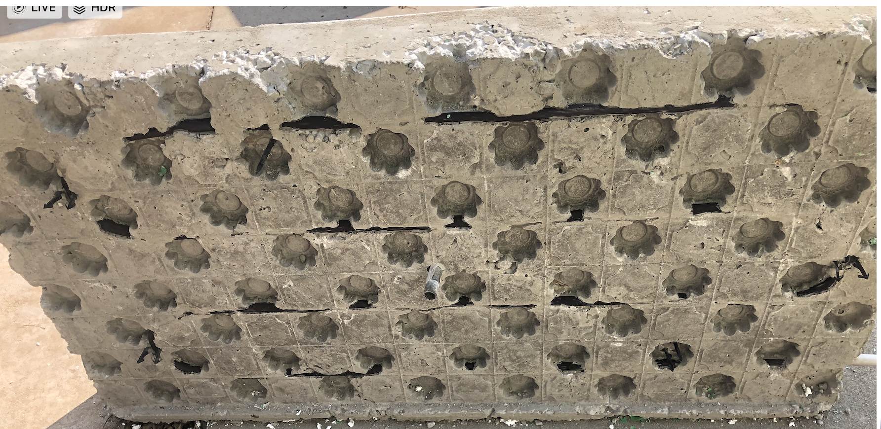

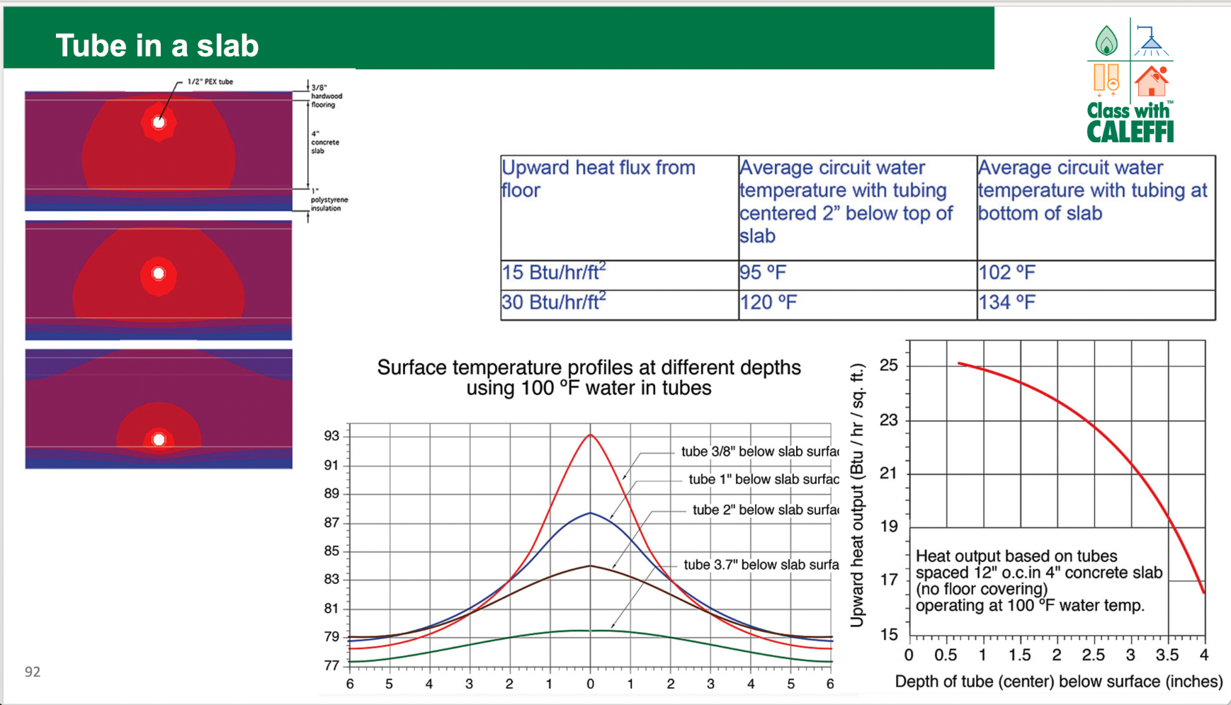

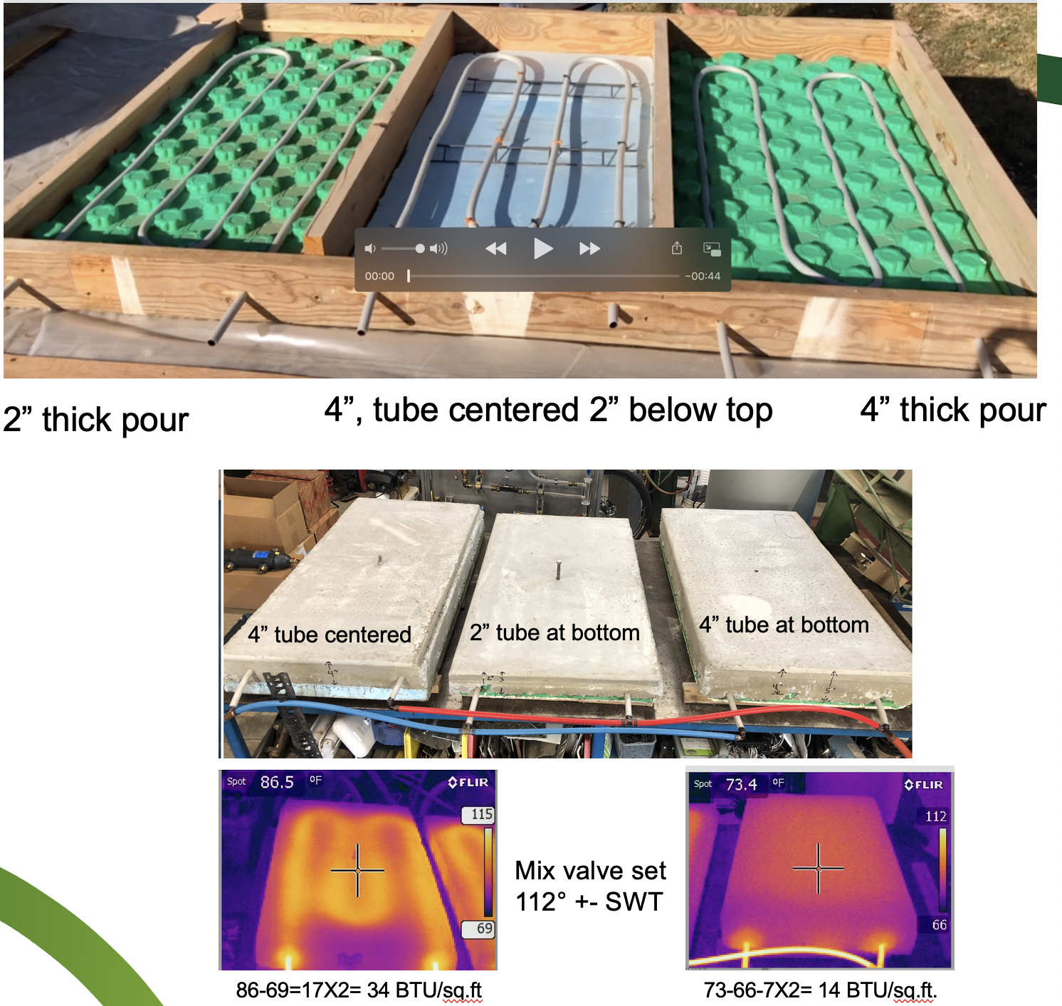

    Personally I feel those nob foam panels are a bad idea. Puts the tube at the worse spot in the pour, at the bottom. It creates air space around and under the tube, and the foam nobs isolate concrete away from the tube.
    Tube at the bottom of a slab slows response time, requires higher SWT, and increses downward loss.
    Yet another product that has not had a lot of independent testing. IMO.
    Here is what the bottom of a slab on nob panels looks like.
    It's worth some time getting the tube into the slab, surrounded by a conductor. Like concrete :)
    https://www.pmmag.com/articles/101229-john-siegenthaler-tell-me-more-about-nubbed-foam-panels

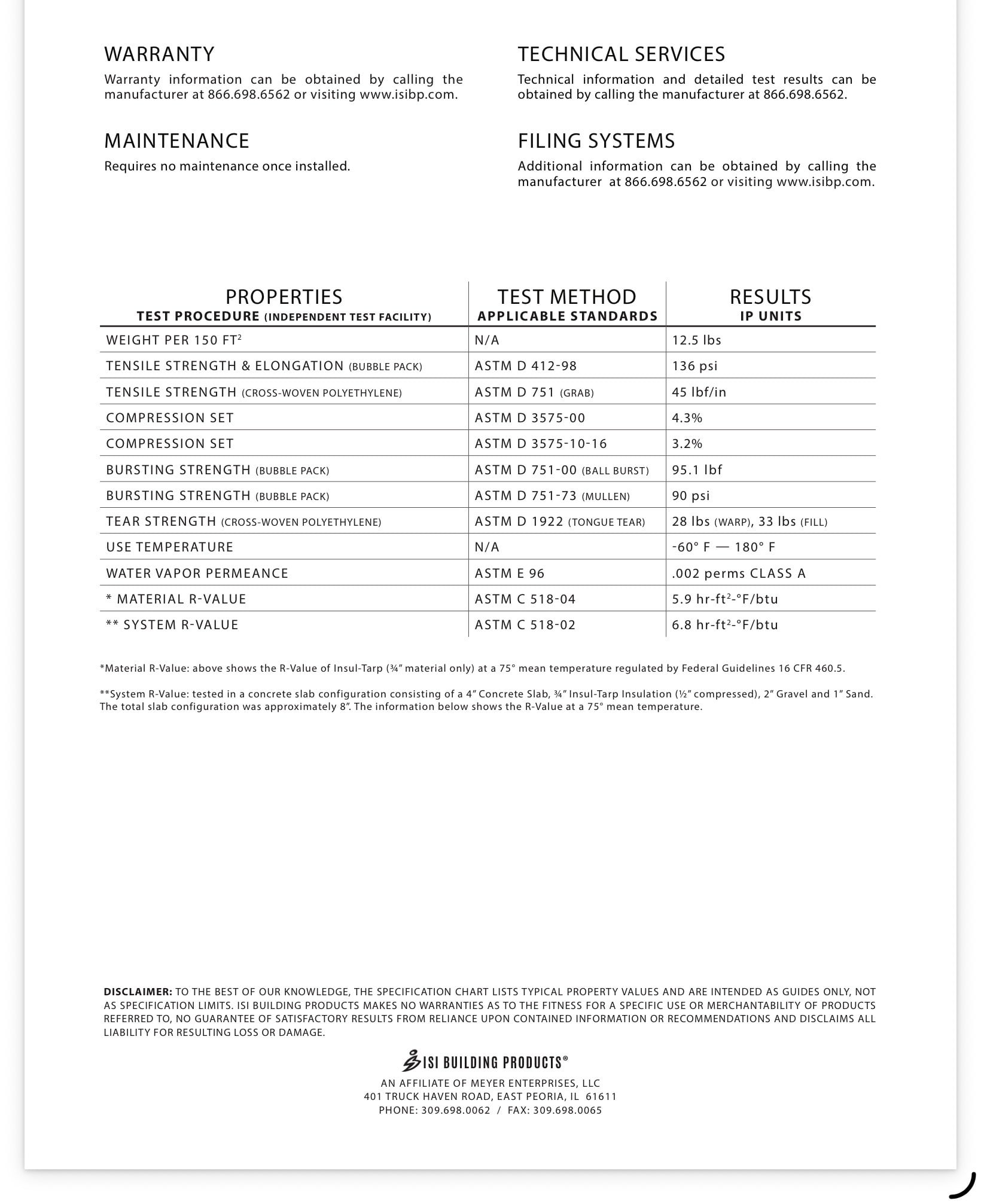

  • Thanks for all the input. There is a trade-off with each system it seems like. If you focus on R-value, you have to face a structural compromise in PSI rating. If you focus on structural, you compromise efficiency. If you focus on safety of the tubing, you compromise output. If you focus on output, you put the tubing at risk. The various insulation systems out there is interesting. I notice that Insultarp and Barrier both use the same disclaimer terminology, and wonder about their posted R-values. But at the same time, I think they are better than nothing, and at least they won't raise concerns about PSI rating. We inherited this design from a manufacturer's rep, whom I trust, and the Insultarp is bought. We plan to tie to the re-bar, and avoid tying alongside, but rather at cross-points. Thanks everyone for sharing, and @hot_rod , thanks especially for your test work on the panels. Keep it up!

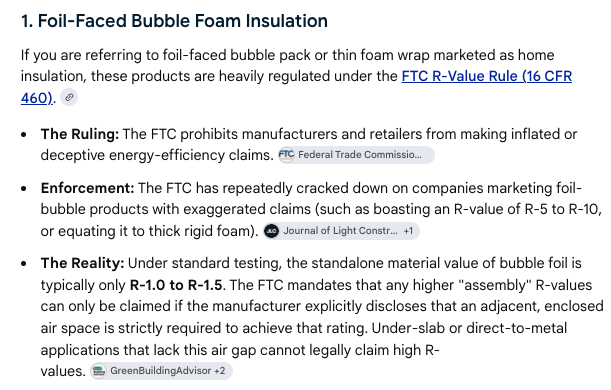

    The tarp is advertised as a thermal break and vapor barrier.
    If you read the fine print the r-value is rated with 2” gravel and 1” sand over the product.
    I recall the FTC came down on the bubble foam products early on, and made them change their claims.

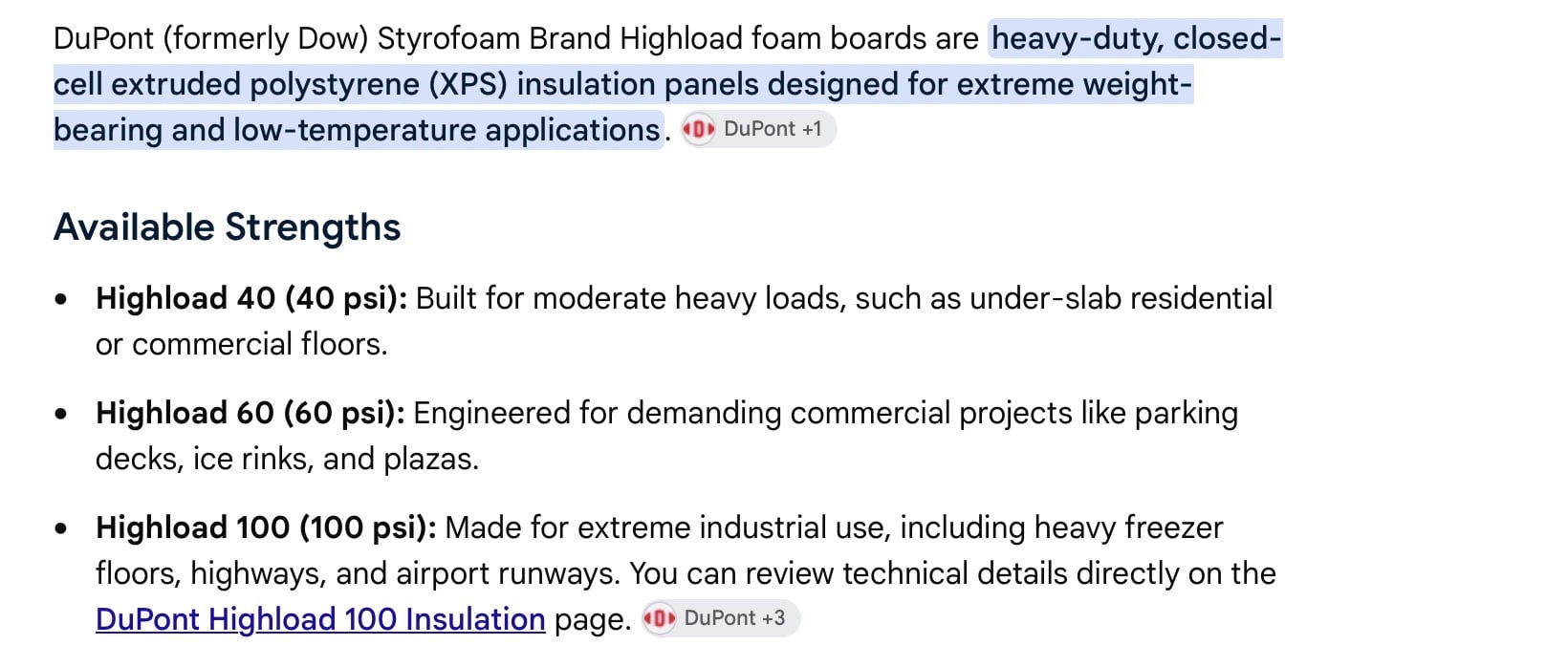

    I can’t imagine a residential drive or home would need more than a 250 psi foam?Dow offers hi-load up to 100 psi. If you are doing a runway?
    I asked a rep why he sold a product considered a little better than nothing? He told me it makes him a lot of money.
    Is “better than nothing” an actual engineering criteria 😳

    Insultarp is literally just a thin concrete blanket with a few layers of the thin roll foam you'd see in packing boxes. When compressed under the weight of the concrete, R value goes to almost nothing so it's effectively just a really expensive vapor barrier.

    @PhillipJones Say you take a car that is 4000lb with 35PSI inflated tire. Each tire has 1000lb of load which the tires distribute to 1000/35=~30 sqin (so say roughly 5"x6" contact patch).
    When you have a load like that over concrete, the load spreds out at 45deg slope as you go through a slab, so under a 5" slab, the 30sqin contact patch spreads out to 160sq in. So the load on the foam drops to only 6.25PSI. Typical XPS is rated for 20PSI, so you are barely loading the foam. That doesn't take into account any mesh or rebar that will further spread the load. Unless you are parking a Mack truck, regular foam is plenty strong.
