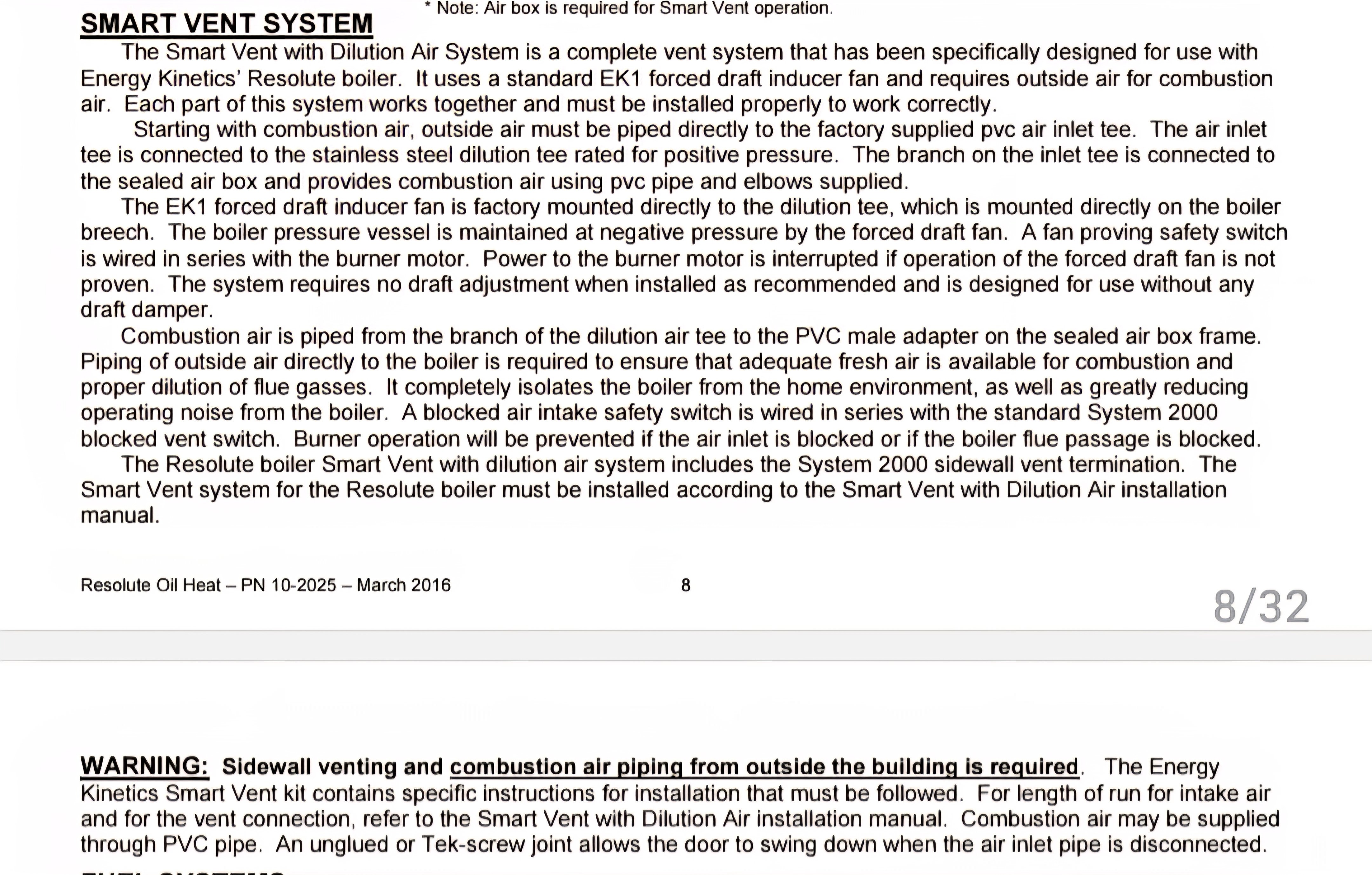

I don't see an awful lot of oil power vent boilers, but the ones I have seen were due to a fault with the PV itself or its operating controls.
Unlike most retrofit PV applications, you'll have full serviceable access to the PV and the controls with the Resolute.
Note that with the Resolute, it MUST use outside combustion air.

Contractor, not a owner of a Resolute but you can't compare it to other power vented and direct vented oil boilers. It uses a dilution venting system, using outside air to dry out and temper the higher temp, vapor laden exhaust. The odor and temp is VASTLY less than other options, barely noticeable to me and I've smelled too many PV and DV boilers over the years
