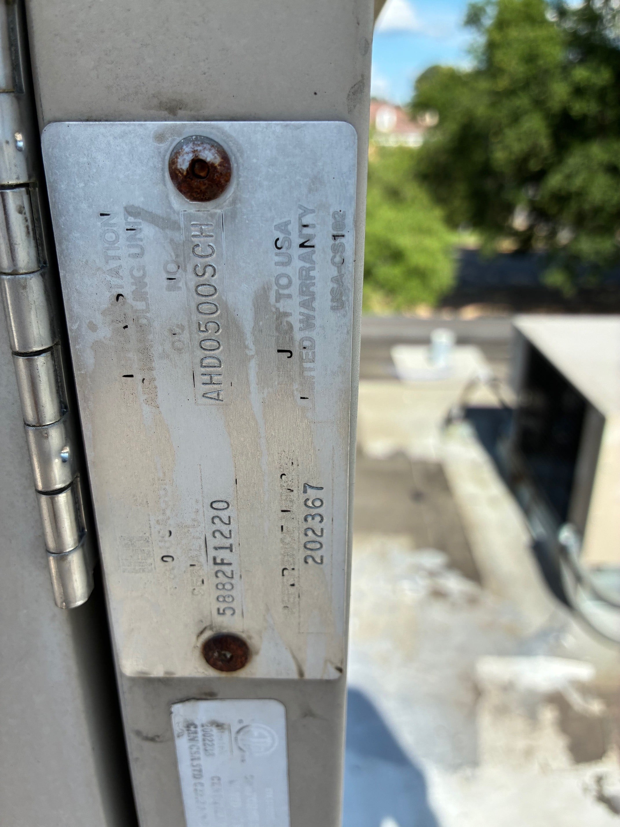

I'm trying to locate a Blower Assembly for an old Central Air Station Air Handler and having trouble determining the original OEM
I know there is a chance the parts may be no longer available, but from my search, it looks like several manufacturers make these units, so I am not sure if it is Daikin, York, Carrier or someone else.
MODEL: AHD0500SCH
SERIAL: 5882F1220
Is it possible that the actual OEM unit information could be different, or located somewhere else on the unit?

    need the #’s off the motor and dimensions of the wheel
    what is wrong with it? you can replace the individual parts and there are universal replacement blowers if the whole thing got destroyed somehow but you probably won't find the oem assembly.
    EBEBRATT-Ed Posts: 21,328
    There are 100s of companies that made Air Handlers in addition to the ones you mentioned.
    I wouldn't say blower assemblies in those AHUs are standardized but you can probably find something that will fit.
    If the blower wheel and the blower housing are ok any other part can be obtained like shaft, bearings, motor, belt and sheaves.
    Blower wheels are probably available

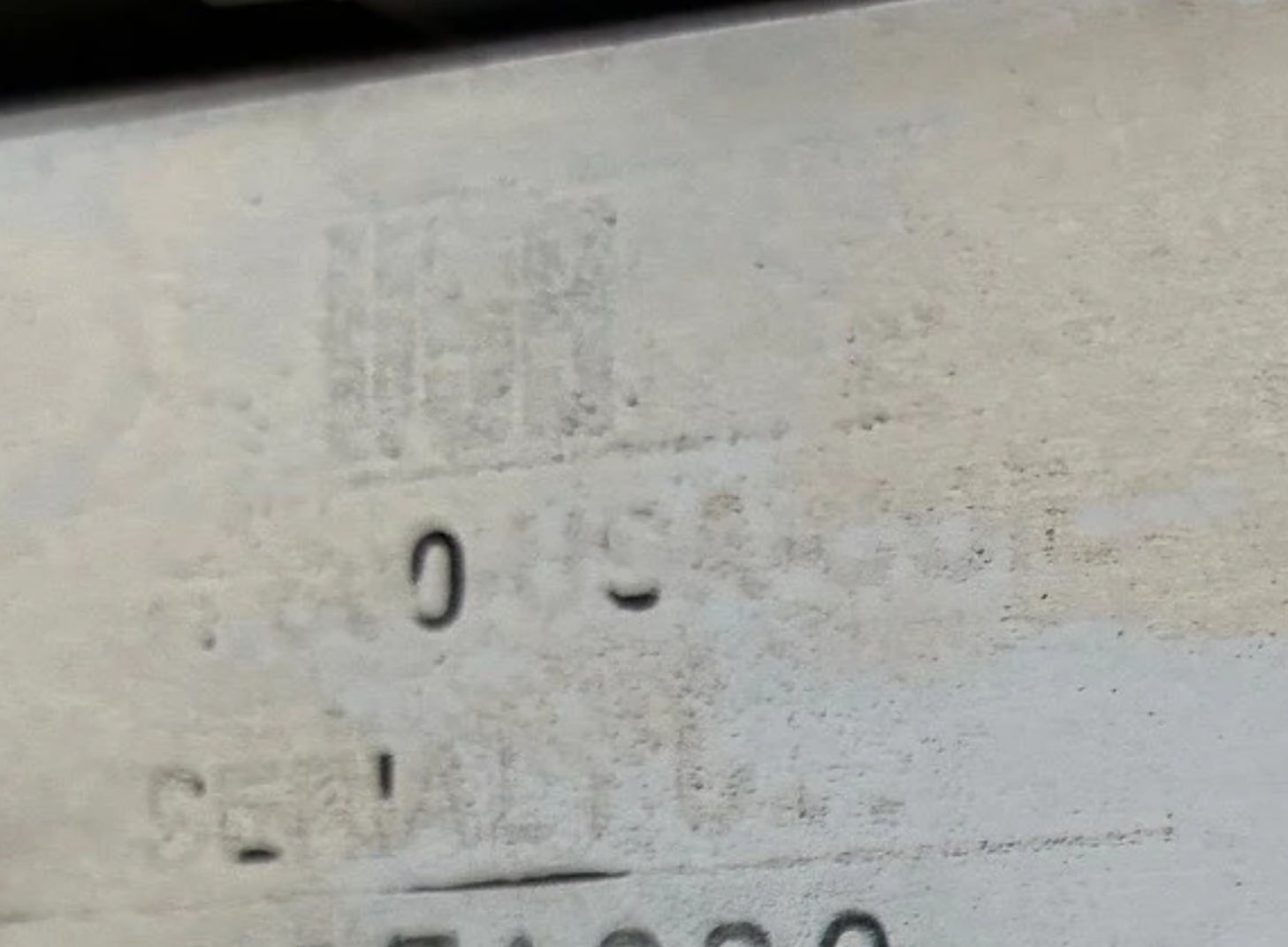

    It looks like the logo might read "USA", and it definitely reads "USA COIL" underneath. Doesn't ring a bell in my neck of the woods.
    @HVACNUT
    USA Coil & Air has been in business for a long time. Started in the early 80s They mostly make replacement coils, but they do or did make AHUs as I recall. Also, fluid coolers, steam , HW and CW coils, coils with special coatings etc
    1-800-USA Coil
    They are located in PA.
    Good eyes I did not see that. They probably made that AHU.
