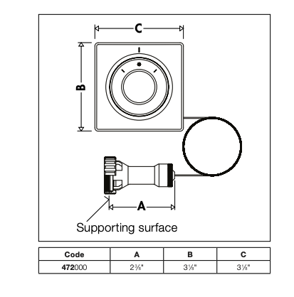

I have some Danfoss RA2000 remote thermostatic operators (one is 13G8562) that I'd like to cleanly wall mount (no drywall yet). The european mounting holes don't align with a single or double gang US device box, and they are shorter than the boxes. In my case, the longer operators will also be fed through smurf tube, in the event replacement is needed in the future.
Anyone have a trick that works well for mounting these to a box, which can feed the smurf, looks good aesthetically, and meets IRC and fire codes?
Adjacent switch plate covers are lutron, and matching whites is always hard than you'd think. Ideal would be no plate showing, so maybe an adjustable box against the back of the drywall?

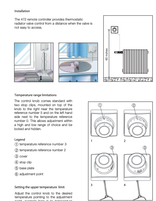

    I think there is a mounting plate behind the cover. Just put some backing in the wall to fasten it to. I don't think it needs to be in a box, there is no electricity, or code to cover a capillary tube. As far as I know.
    End your fish conduit near the backing blocks.
    I thought I had a sample, but it is MIA
    Screenshot 2026-07-22 at 4.41.04 PM.png Screenshot 2026-07-22 at 4.46.25 PM.png
    although you really don't want air blowing through a hole in the wall and affecting the element.
  • Big Ed_4
    Big Ed_4 Posts: 3,585
    I would assume the controller was designed to just be mounted on the wall and the tube is tucked behind .
