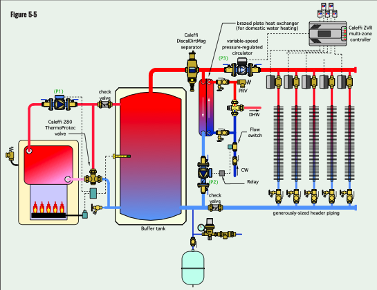

Here is a system I have done several times, including my own system with a wood fired boiler.
The parts list will give you an idea of many of the costs for piping.
A setpoint control runs the boiler, a 120- 160 or so range may be possible with the correct FPHX sized to the needs of the job.
Run the tank temperature as low as possible on design day, for example. The electronic setpoint controls are simple to adjust and you read tank temperature on their display. Sensor can go into well or push against the side of the tank under insulation.
The 280 protects the boiler return
The tank could be a basic insulated storage available from any WH manufacturer. Or a specific buffer tank from Boiler Buddy, Lochinvar, Zilmet, System 2000, Wessel, and most tank manufacturers. Most all tanks have 1.5- 2" foam insulation now to minimize loss.
A Tankless valve kit valve on the HX, B side.
A delta P circulator with zone valves. Multi speed circ for the boiler and HX for some flow adjustability.
One large Webstone purge valve, on the blue return pipe, is an option to purge all zones from a single valve.
If you know how many gpm you need for DHW, size the HX with help from a rep

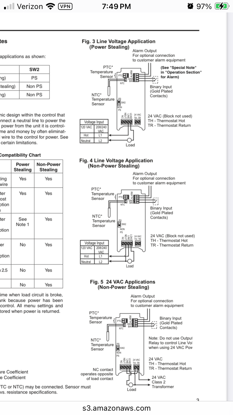

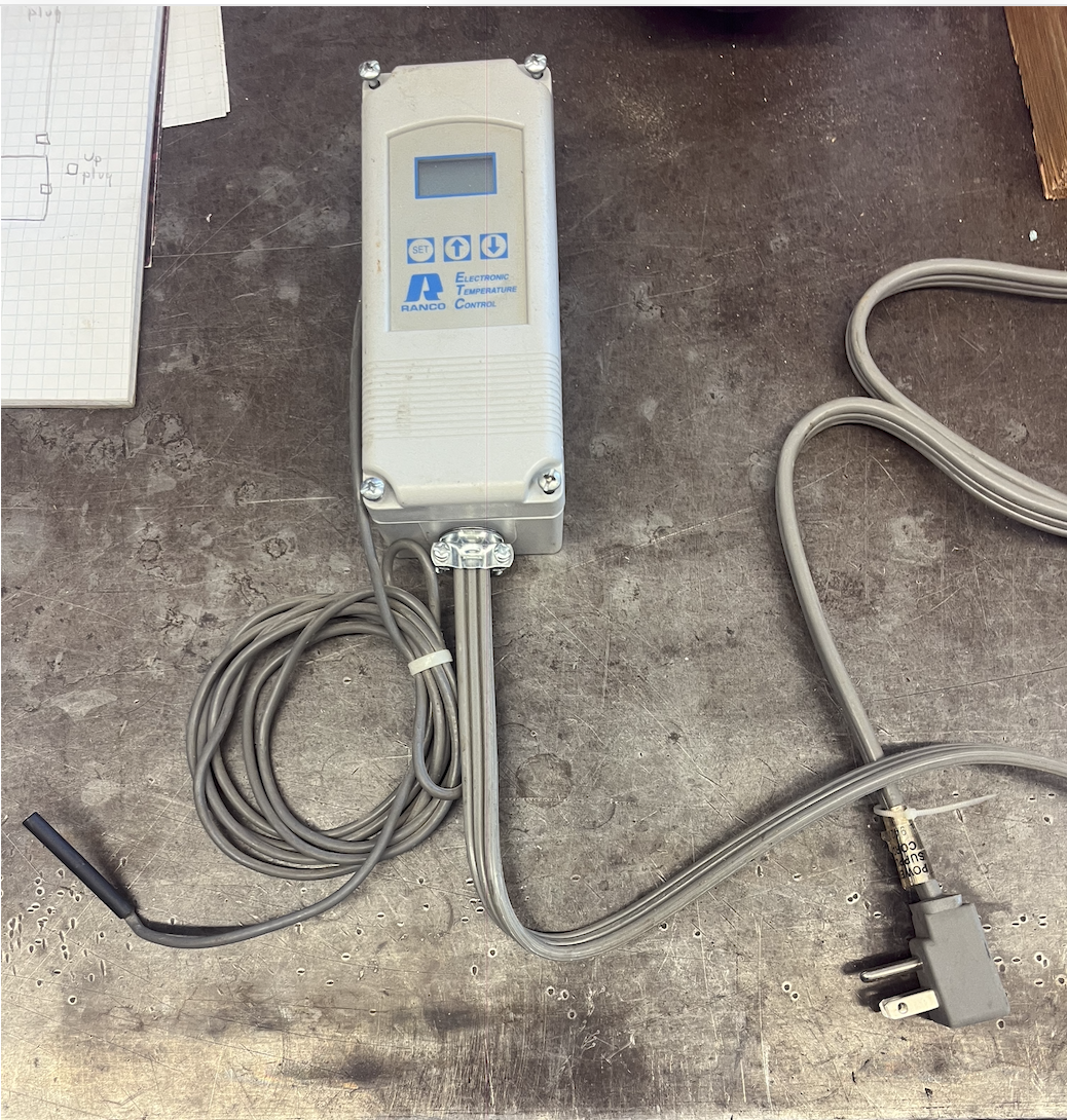

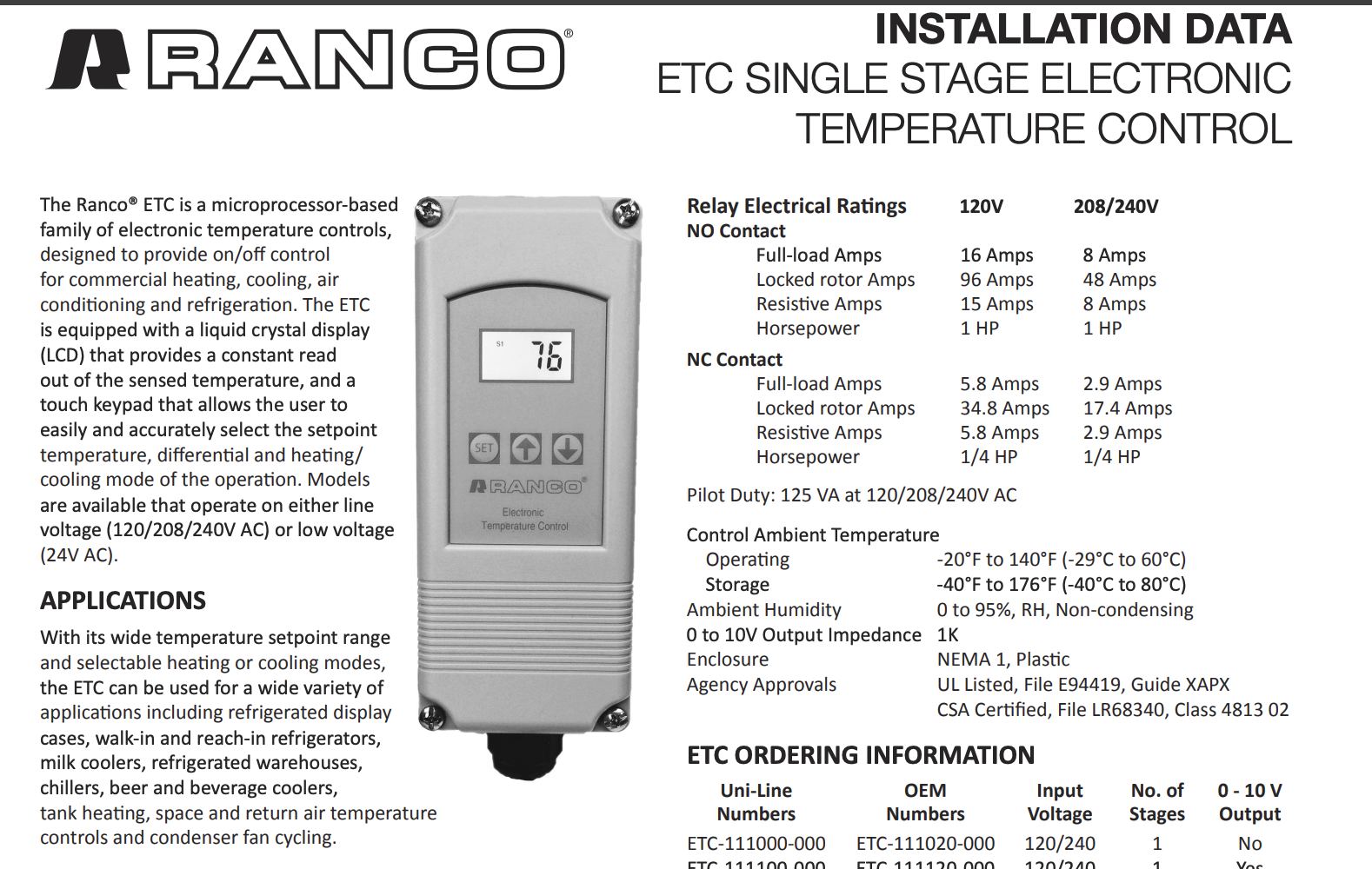

    I’m struggling to understand the wiring of this. Sensor goes to the well. Binary Input would go to boiler TT? But how is P1 communicating with the set point control?
    hot_rod Posts: 28,699
    P1 is powered off the boiler pump relay.
    Whenever the setpoint calls for tank heat, the boiler is enabled via TT.
    The setpoint control needs power to operate. You can get either 24 or 120V. So wire that to any power source
    Use a 120V and plug it into a receptacle with P3
    The output contacts of the setpoint control are dry contacts, no power applied.
    They “make” the TT which is powered by the boiler 24V transformer
    P3 the system pump wires to a receptacle, powered all the time. It wakes up when a zone valve opens
    A flow switch in the cold feed to the HX turns on P2
    I used a Sika .50 gpm switch. Same switch used in combis and tankless water heaters
    SupplyHouse has them under the LAARS brand name
  • Ok. P1, P2, and P3 make sense. Set point power makes sense. Tank sensor makes sense. Communication from set point to boiler TT would have to come off the “TH” and “TH” from the set point control, correct?
    the communication from set point control to boiler I’m missing.
    With this brand and model, you have 3 connections at the bottom.
    NC normally closed
    NO normally open
    Common
    When the control is in heating mode common and NC are "made" , a closed contact, wire that to TT. So as temperature rises, that contact (Com and NC) will open and turn off the boiler. Thermostst wire is fine, it's 24VAC.
    The control is really just a switch, that happens to be activated by a temperature signal.
    Many brands of this type of control Honeywell, Johnson Control, Ranco, Penn, etc.
    This brand and model has a easy to follow instruction.

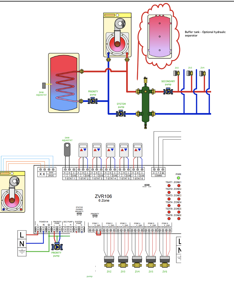

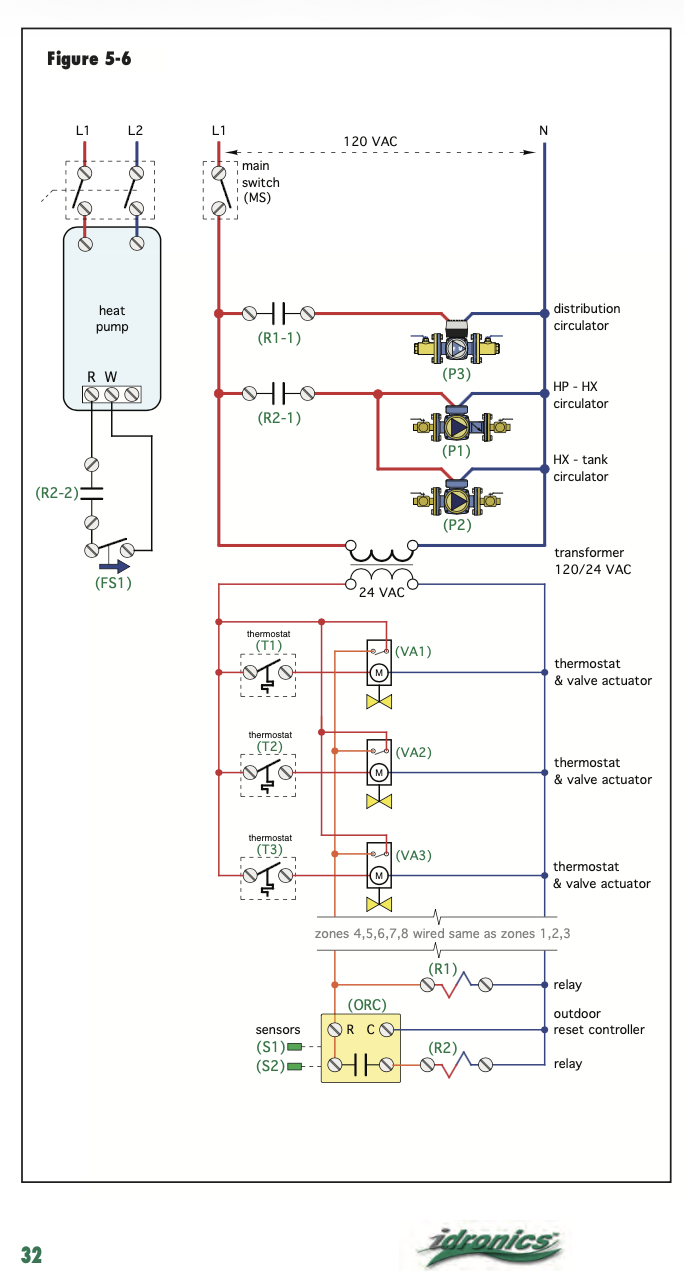

    This isn't your exact piping, but the control logic matches what you want to do.
    Use a relay in the Calefi zone valve relay box for the flow switch/ pump interface
    If you have 3 zone valves buy a 5 or 6 relay box
    3 zone valves
    1 for the flow switch
    1 or 2 spare for any future zones or a backup if a relay fails
    Wires like this:

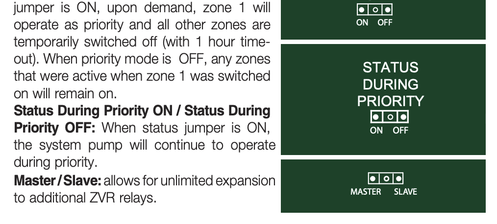

    Flow switch (shown as DHW aquastat) wires to the R W, zone 1 at top. Zone 1 is always priority zone on the Caleffi relays
    jumper end switch on zone one, at bottom.
    Put box in priority mode, on the jumper at the bottom of the circuit board.
    HX pump wires to priority pump connection at bottom 120V
    Now when the DHW calls, all zone valves close. Full boiler output is available for DHW production
    System Pump in this drawing is your boiler pump, wired to the boiler pump relay, not the relay box
    Secondary Pump is your Grundfos Alpha zone valve pump which I would just power all the time.
    Ignore the blue wires labled DHW from relay to boiler, the setpoint control is handling this function.

    So control logic:
    Thermostats wire to relay box 2,3, & 4 connections Run 4 conductor wire to t-stats if you plan on using electronic power stealing stats.
    Zone valves wire to relay box 2, 3 & 4 connections (4 conductor wire)
    XX on relay box, upper right goes to boiler TT. Boiler and pump enable when any zone opens. So boiler pump wires to boiler relay 120V
    That covers the heat control logic.
    For DHW you need a setpoint control, sensor on or in the tank
    Power the setpoint control, either a 120V plugged into the wall receptacle. Buy the 120V control and cord at SupplyHouse.
    OR a 24V version powered from the relay box transformer, your choice. It needs to be powered continuously.
    The setpoint switch, regardless of which version you use, NC & C wire to zone 1 on top of the relay. Jumper the end switch on zone 1, at bottom
    When this zone 1 (DHW) is enabled the boiler is again switched on via XX. If you enable "priority" on the relay box, heat zones drop off when DHW calls. With your oversized boiler maybe you do not need to prioritize DHW, maybe it can handle both at the same time.
    The Caleffi relay, when in priority, will drop that DHW call after an hour, so you don't lose heat for more than 1 hour.However if you want continuous DHW why not use priority? Try it both ways to see what suits your needs.

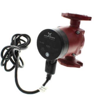

    Depending on which part number you order some Grundfos Alpha ship with a power cords. They would not do this if the pump could not be powered?
    Screenshot 2026-07-19 at 3.43.44 PM.png Screenshot 2026-07-19 at 3.43.56 PM.png
    The pump learns the hydraulics of your system. When all zones close it ramps down to 0 flow. It is not deadheading.
