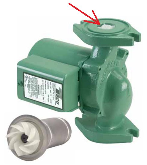

    If you have circulators with flo check valves or check valves those can fail due to a little dirt or sludge and you can get gravity circulation. If you have zone valves that could also leak by.
    Need to try and figure out if a zone is actually calling for heat when it should not be due to a short circuit, bad stat , bad relay etc
    or
    Do you have a bad check valve or flow check valve cause gravity flow

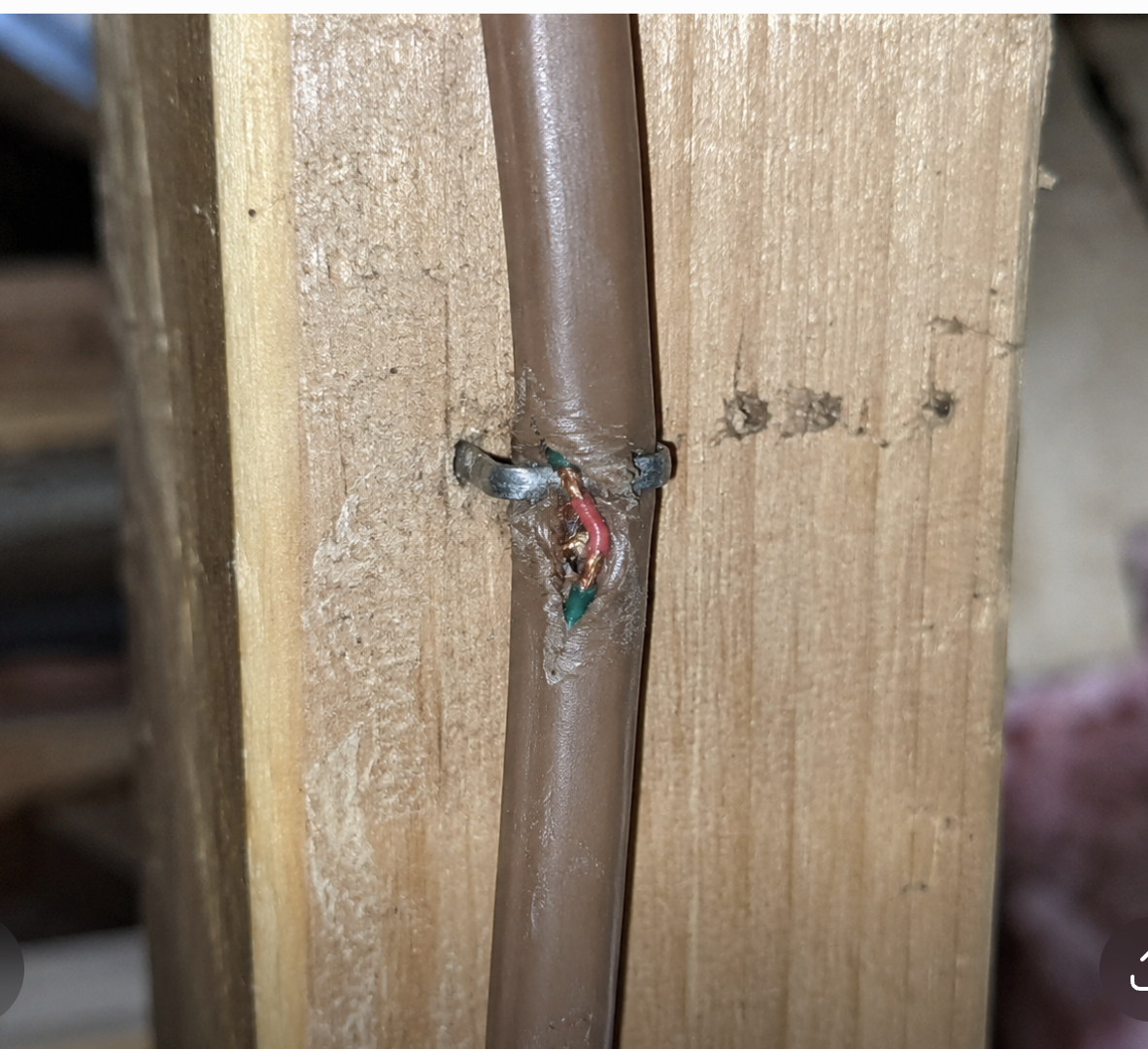

    This sounds like there may be a compromised thermostat wire. My guess would be the wire between the thermostat and the Argo control. Look for something like this:
    As the temperature changes, the wire may expand from the heat and make contact completing the thermostat circuit while the actual thermostat is not calling for heat. When the damaged wire cools, the connection may open again.
    The process of elimination would begin by removing both of the suspect thermostat wire connection at the Argo control. If the problem is resolved, then you have a place to start looking. If the problem still occurs, then the issue may be within the control itself.

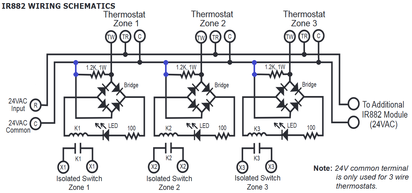

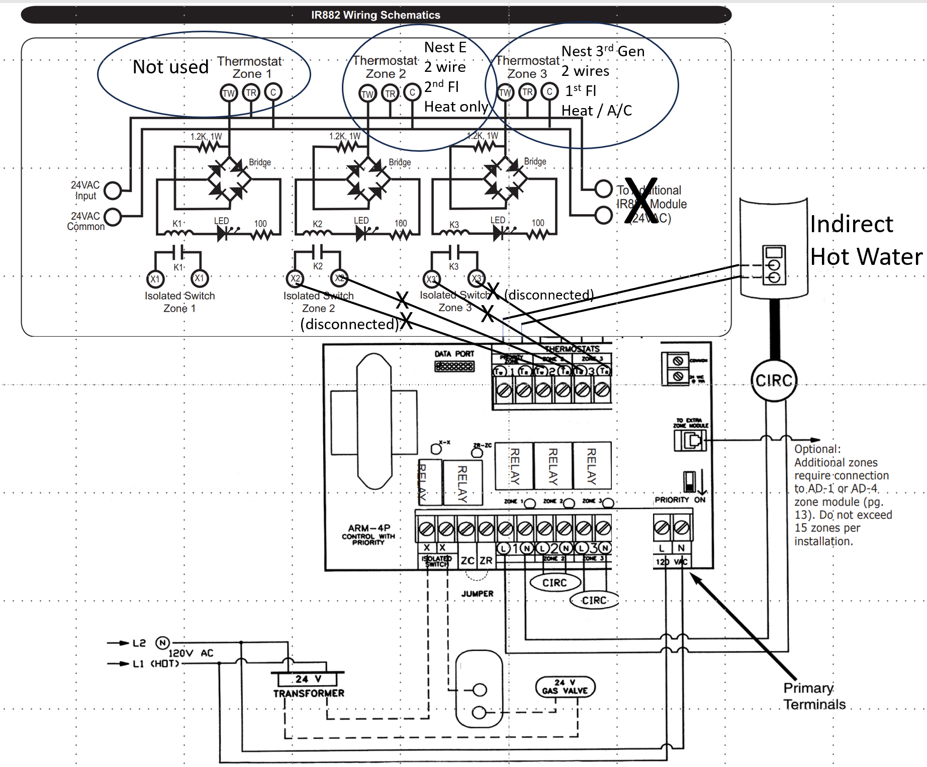

    Just for clarity, is the Argo IR882 isolation relay module wired between the NEST and the Argo Control Module (3P) ?

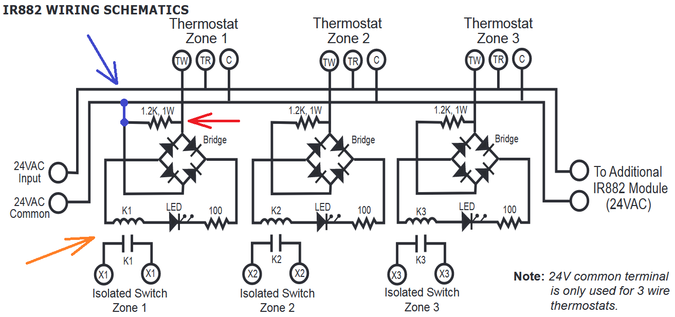

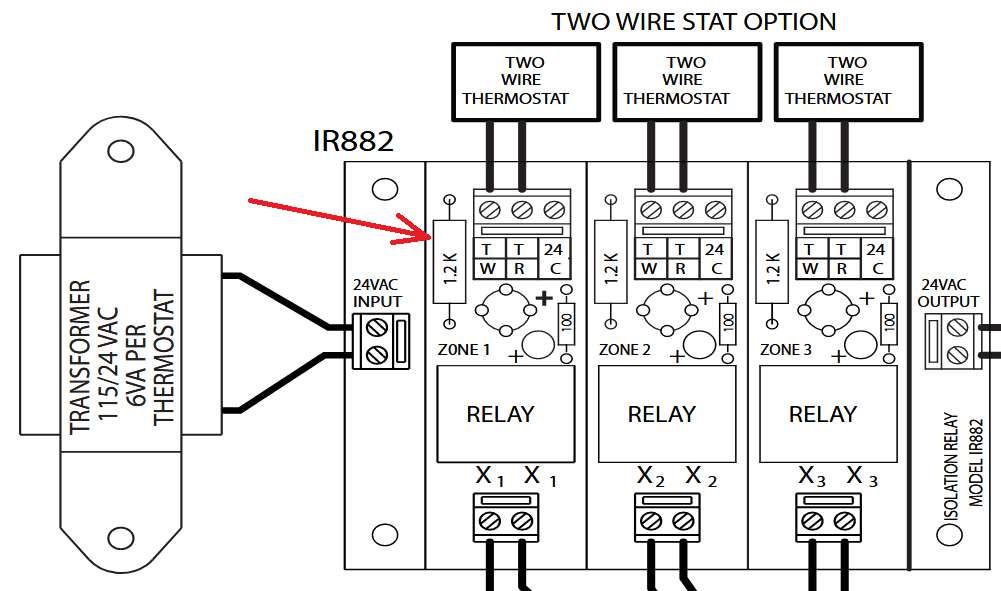

    If removing the NEST from the base plate seems to solve the issue, the 1.2 K Ohm bypass resistor (Red arrow) may not provide enough current bypass around the K1 relay circuit to keep K1 (Orange arrow) from activating occasionally with the fluctuations of the electric utility's voltage. The NEST's continuous parasitic current is to power the NEST and keep its battery charged up. If the Argo IR882 isolation relay circuit (in this case) is too sensitive to the NEST's continuous parasitic current it may cause intermittent zone activation. If the NEST load changes, like a Back Light or the charge rate of the battery changes for some reason that could cause issues too.

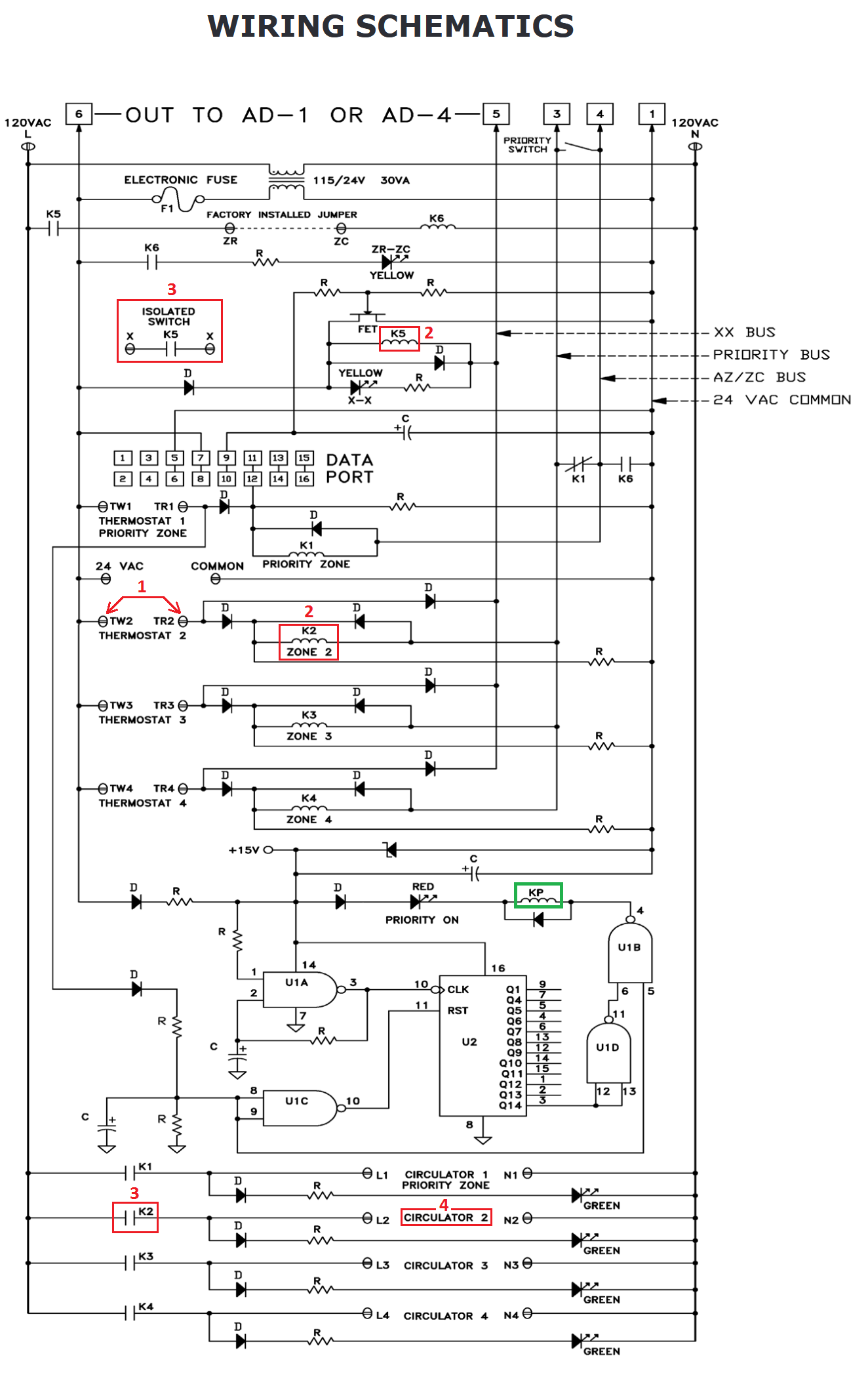

    It appears the schematic in the manual of the IR882 isolation relay has a wiring error(s). The Purple wire I added (Zone 1) makes the circuit for Zone 1 make sense. I did not bother to modify zone 2 or 3. Also the LED symbol is drawn backward too.
    109A_5 Posts: 4,759
    I believe by your description it should not be a normal or expected behavior, assuming it is an electrical issue.
    Is there 3 circulators ? One for each zone and DHW? Or maybe 120 VAC zone valves ?
    You could wire and audible alarm to that zone's flow control device to alert you.

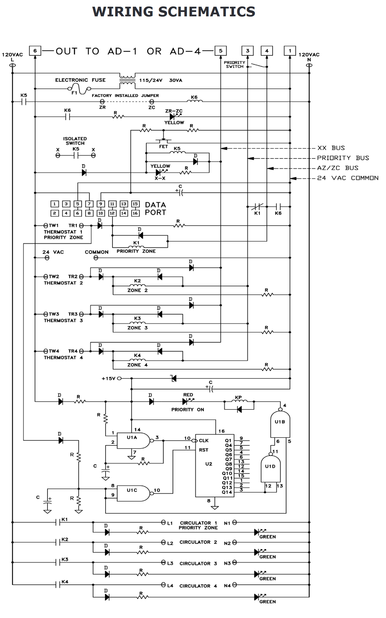

    Looking at the schematic of the ARM Series controller, I'm thinking it is not an ARM controller issue. Looks like you need a TW to TR connection to activate the zone relay and energize the flow control device and the XX Bus.

    Mercy. I was just plowing through the circuit diagrams that @109A_5 kindly provided. I think I have a headache.
    However, they are actually straightforward enough. But is it really necessary to start poling into the controller? Either it works as advertised — or it doesn't. But — like some other things which are complex — it is best to be sure that it is the complicated thing that is causing the trouble.
    So. First things first.
    I am very interested in the comment that effectively disconnecting Zone 3 seems to have affected the problem.
    The very first thing I would do is disconnect the Nests — both of them — completely, bases and all, and the 1.2 K resistors used to power them. Substitute for the moment at least plain vanilla battery powered (or unpowered, even better) units; both heating and heating/cooling varieties are available and cheap. Now I have nothing really against Nests, but in a two wire setup with the resistor for power they are, bluntly, what we used to call a kludge — and may, or may not, play well with other systems in quite unpredictable ways. If that approach helps or even solves the problem, go ahead an reinstall the Nests, but run a power feed to them in addition to the control wires and ditch the resistor. Alternatively, if running the control wire is impossible, use the individual Nests to control an individual relay — one each — which in turn, through an isolated contact, sends the T-T signal to the rest of the system. That isolating relay should be a nice dumb insensitive one. What you are doing with this is sending the rest of the system a nice clean closed or open contact — power high or power off — signal, rather than a signal depending on a varying voltage.
    If that playing doesn't help, move the control location to the thermostat input to your controls — disconnect the thermostat wires (label them!) and substitute a simple on/off switch. Play with that. Switch on, heat on; switch off, heat off? OK. Your problem is in the wires or still in the thermostat. Not OK? then you can start looking at the controls
    If your system has cascaded controls (control board A signals board B which signals… etc.) repeat for each step in the cascade.

    Hi Jamie - Thank you for your reply and I was also scratching my head at the Argo control module diagram (it's very difficult to understand if connections exists or they just cross on the diagram without use of a "dot" at the junction). As things happen, shortly (no pun intended) after I disconnected the zone 3 wires between the IR882 and the Argo controller I noticed that zone 2 was warm.

    But briefly what I get is with the IR882 relay X2-X2 Zone 2 is disconnected from the Argo controller Zone 2, TW and TR, the Zone 2 circulator and the boiler still activate randomly and intermittently. Hopefully the interconnect wires are disconnected at the Argo controller end of the wires. Everything else works as expected.
    Is this correct ?

    It looks to me the schematic of the ARM controller does use dots for connections and where the lines just cross they are not connections. The IR882 is a bit more confusing, but there is less going on there.
    Also I believe these drawings are to give conceptual information and are in no way 100% factual. That being said I tend to use whatever information I can find.
    @Tomd514 do you have a Multi-meter ?
    109A_5 Posts: 4,759
    Added the dots and some corrections to this schematic. Hopefully it makes more sense now.

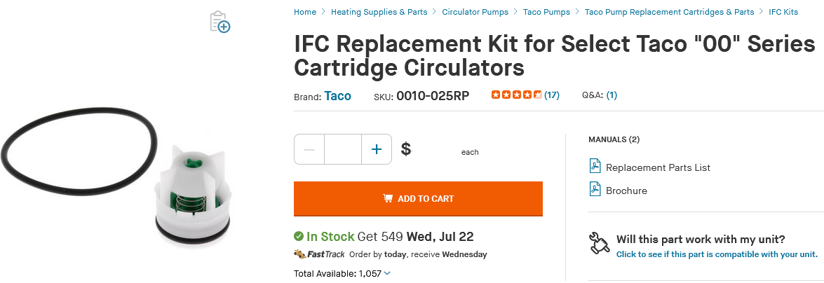

    Prior to obtaining a replacement Argo ARM - 3P control board I ordered a replacement Taco circulator check valve and if necessary a complete Taco 007 with IFC as suggested by those who suggested the problem was ghost flow to the 2nd floor zone due to a bad check valve.
    Upon accessing the old check valve I found it to be rusted solid and had to chip it out. After installing the replacement check valve I ran the other zones and couldn't sense any heat in the 2nd floor riser (Yahoo!). It's been 24 hours since the repair and I am hopeful the ghost flow is resolved. I restored all the disabled thermostats and wiring.

    Well the actual problem is at the circulator end, water is moving heat when it should not be, however NEST thermostats can be problematic. Disconnecting the the IR882 from the Argo ARM - 3P control board, to me helped and also @Tomd514 stated he could never catch it in the act.
    In this case disconnecting the power from the circulator may have been the best first, fast, easiest test that provides troubleshooting direction. But how do you know that initially ? And if you don't know about the integral check valve you may be scratching your head.
    To me the circulator part number was a clue "TACO 007 F5 71FC", "FC" = Flow Check. Kind of why I like knowing 'what's inside' the box whether it is electrical / electronic or mechanical, it almost always helps me with the troubleshooting logic.
