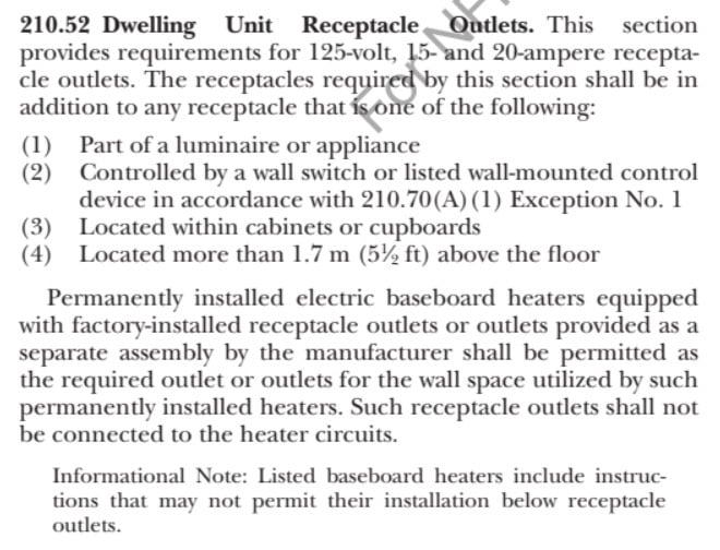

    The code reference for electric baseboard heaters and receptacles is in this informational note.
    Matt and @hot_rod, this system will be a medium temperature system running on outdoor reset with an AWT of 130F, so 140F peak. Of course, that turns out to be 60C. Someone could raise the temperature if they find heating performance low in this area, but I think I'm likely over-spec'd. I had not thought about the rating of the receptacle or wiring, given there would be more than 1" of separation and wiring behind a faceplate and in the wall.

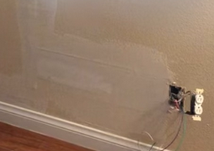

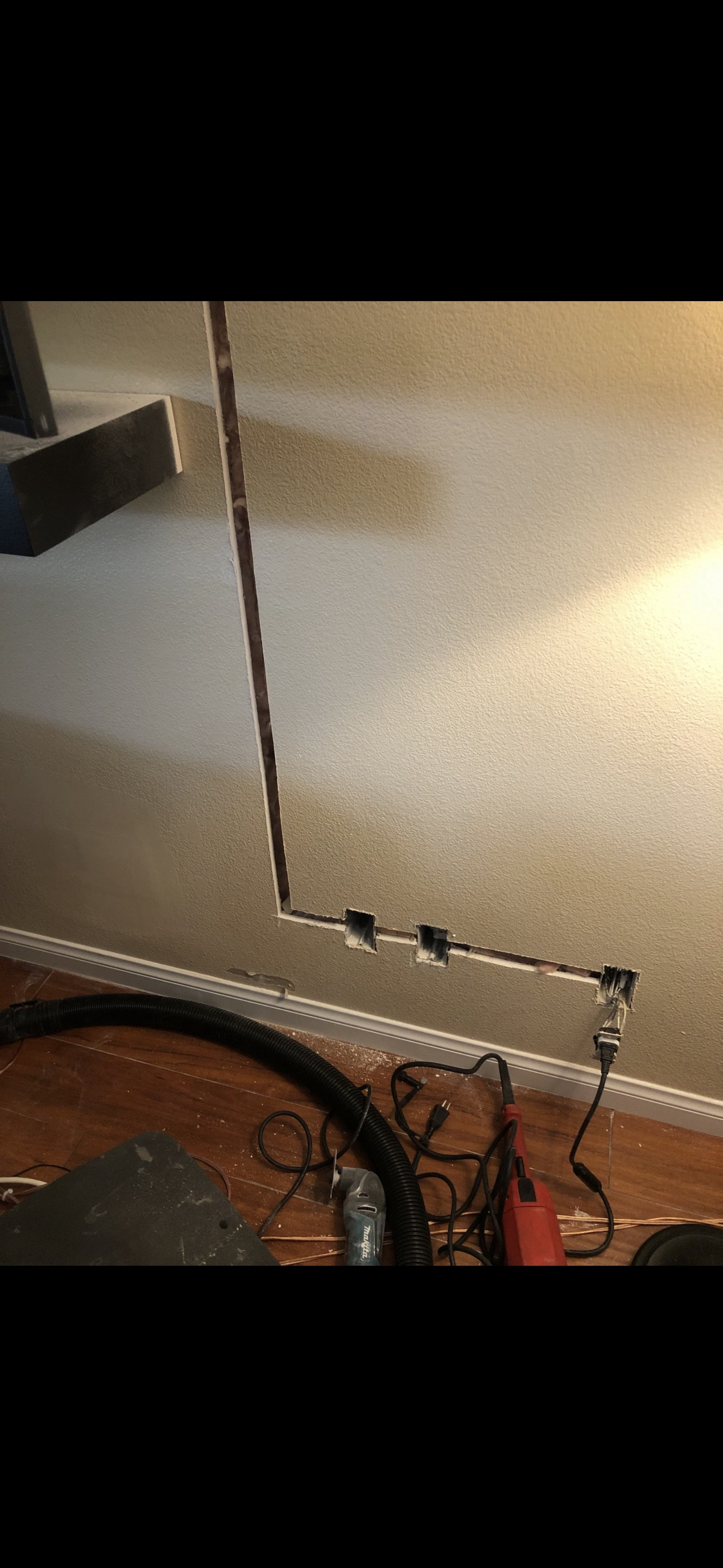

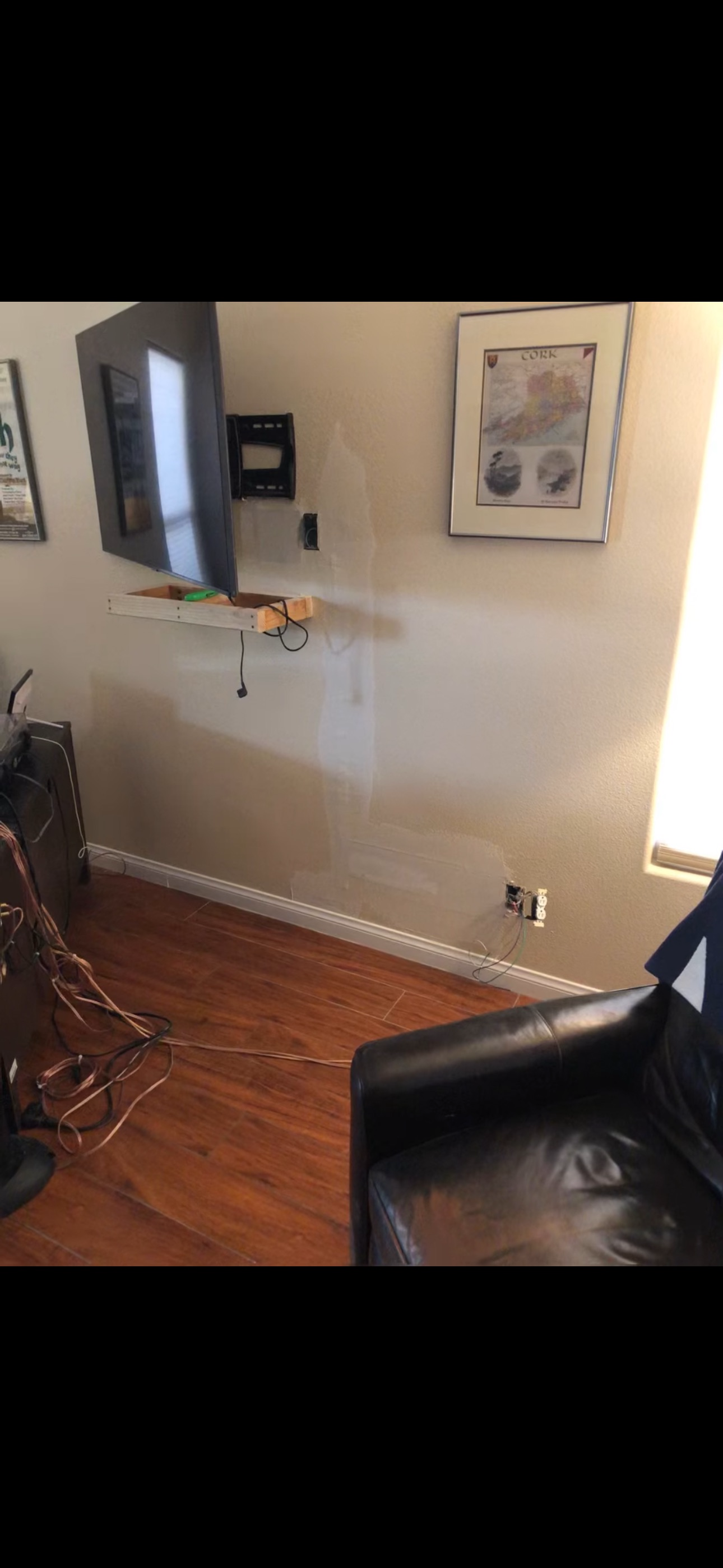

    I’ve made it a habit to add, relocate, or do whatever is necessary to put receptacles where they should be. I don’t use extension cords within our home.
    If it were my decision, I’d install the the baseboard on the floor in its typical location, and I’d move the receptacle 6” or so above it. I hate doing drywall but I end up doing for one reason or another all the time.
    Put in the extra work and in the long run, you’ll be happier with it.
    Steve Minnich

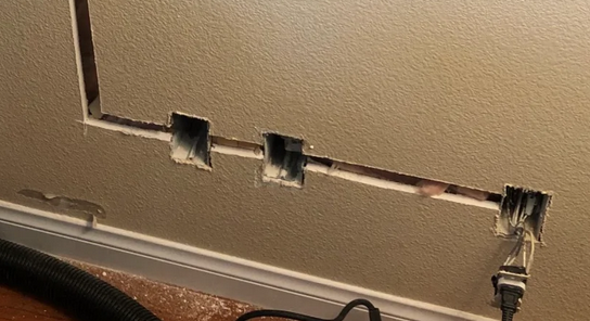

    Steve Minnichmattmia2
    109A_5 Posts: 4,759
    @Steve Minnich Now you see them (3 boxes total), now you don't. I'm a bit puzzled what happened here. Design strategy update ?
    Now I only see one box.
    extenders over twisted pair is the professional way to do that.
  • Steve Minnich
    Steve Minnich Posts: 2,964
    edited July 19
    The two abandoned boxes were a phone jack and a coaxial cable. They were unnecessary and in the path I needed, and now they’ve been 86’d. I needed an outlet behind the TV.
    Steve Minnich
    109A_5 Posts: 4,759
    Oh, OK, I assumed they were also added in the power extension process for more receptacles.
  • Steve Minnich
    Nah, we have them all over the house and little by little, I’m removing them.
