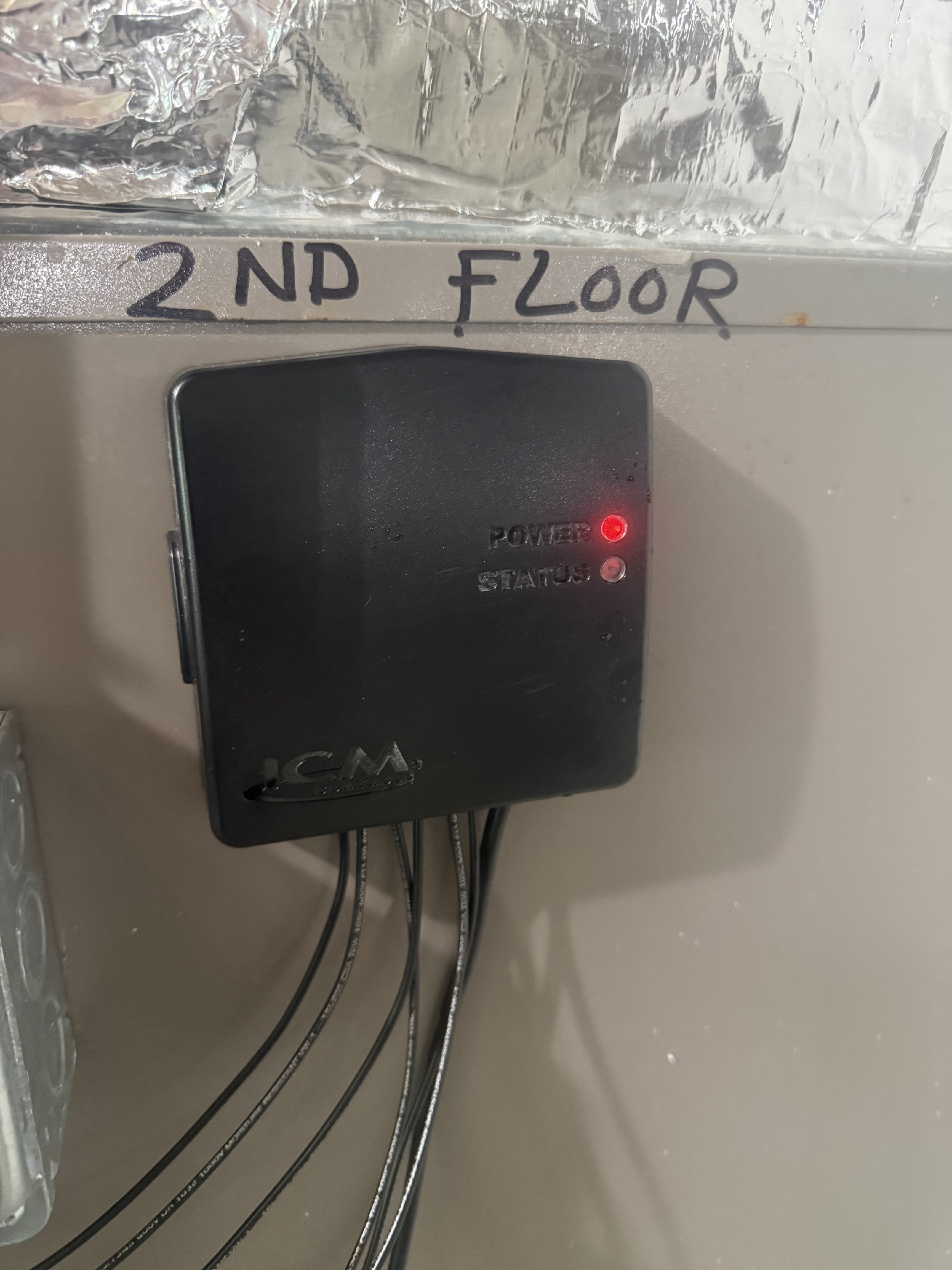

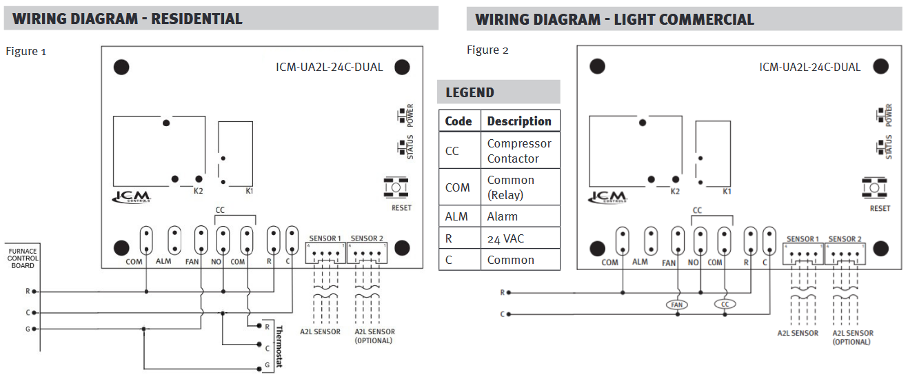

has anyone had the pleasure of installing this yet? Wiring diagram is a lackluster.

    what is the "cc" output?
    you have to put 1/4" qc connectors on all your field wiring or get screw terminals that push on to 1/4" qc connectors?

    all of the black wires are factory installed- just a buncha wire nut connections on the other side. Probably 18 or 20” of length.
    CC is the “compressor”, it took me 30 or 40 minutes to unravel the mystery with my multimeter (kinda slow I know- my left brain was fighting my right brain)

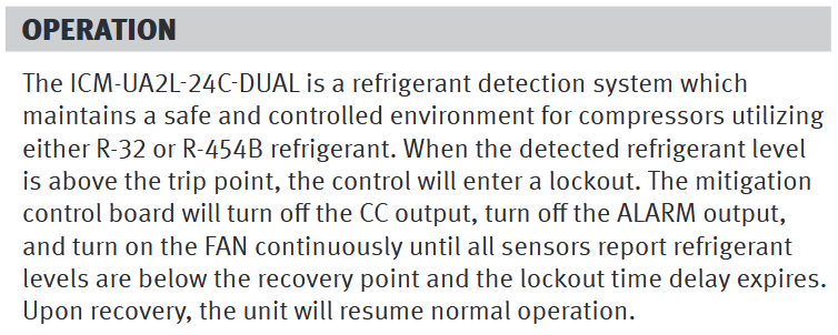

    apparently, if there’s an alarm, the outdoor unit gets disabled and the fan gets enabled

    I haven't used that specific brand, it's a little frustrating seeing that diagram…. The Allied Air brands had an external retrofit RDS controller but it just has full thermostat connections on each side of it (in from stat, out to furnace, 4 wire connections for communicating systems as an option) hardest part is setting the dip switch correctly for 1 sensor…. 410a TXV probably works OK but keep in mind there is refrigerant in that sensing bulb that matches the rated refrigerant of the TXV so it will react slightly differently than a TXV that matches the refrigerant in the system.

    One PITA time waster on an A2L system is, if power is interrupted for service, when you turn it back on there's a 5 minute fan only delay. You don't even have 24 vac at the terminals during this delay. So if the thermostat is 24 vac powered, its dead for 5 minutes. Then when 5 minutes is up and the thermostat powers up, IT goes into its own 5 minute compressor protection delay. Really grinds my gears. Yeah, I'm getting paid to wait. But that doesn't make it right.
    GWEBEBRATT-Ed
    mattmia2 Posts: 18,484
  • GGross
