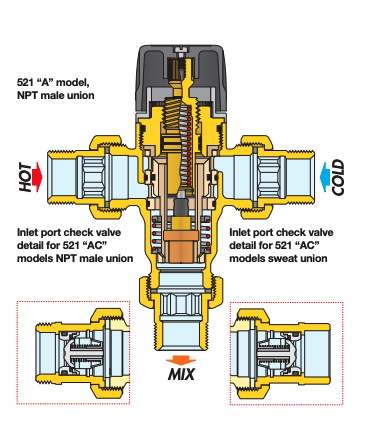

    Inside the valve as on port closes down the opposite port opens more, so the flow should not change much, see below.
    Is this a boiler with a tankless coil?
    You want a fast responding mix valve on a tankless coil or tankless water heater.
    Also, you need a temperature difference of at least 10°, some valves as much as 25° difference between the mix outlet and hot supply.
    So for accurate temperature control the hot water supply should be at least 10° hotter than mix outlet.

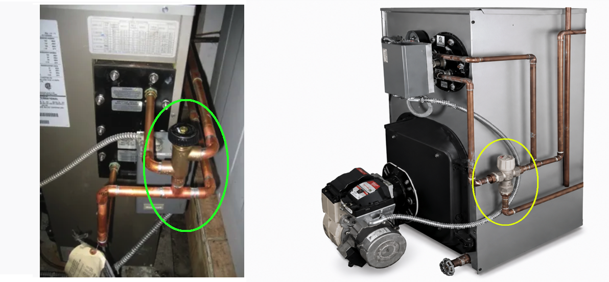

    @bluemoon71 said: "An adjustment was just now made to the Mixing Valve in boiler room by a friend of friend who opened it up much more to the Hot side. The temp at the showers and sinks didn't improve much, but the velocity of the water coming out of the shower has increased significantly."
    I am wondering what type of mixing valve you have. I have serviced thousands of boilers over the last 45 years and have seen this valve called a mixing valve.
    These boilers have tankless coils that have a proper mixing valve. The one on the left in the green oval, is an older version that was popular when I started this work many years ago. A better mixing valve is illustrated on the right in the yellow oval.

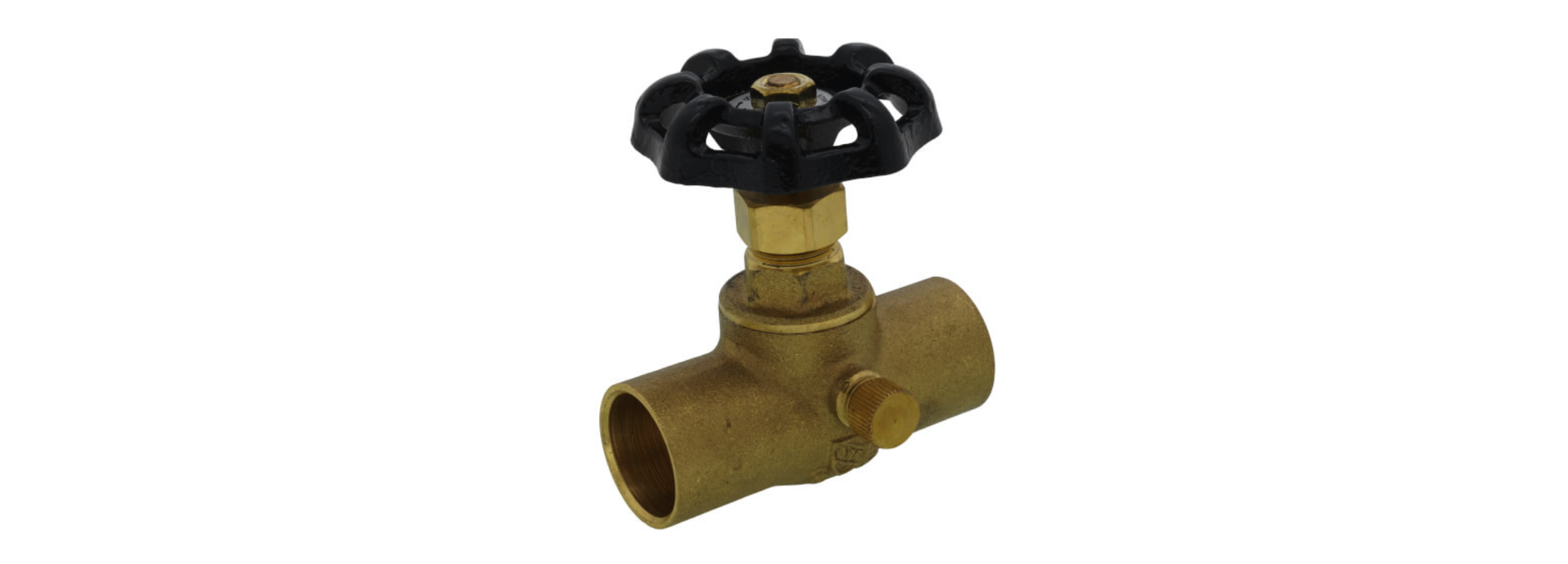

    Sometimes a installer may add this an believe it is a mixing valve.
    It can mix cold to hot but it is not self adjusting and therefor it is not a true Mixing valve
