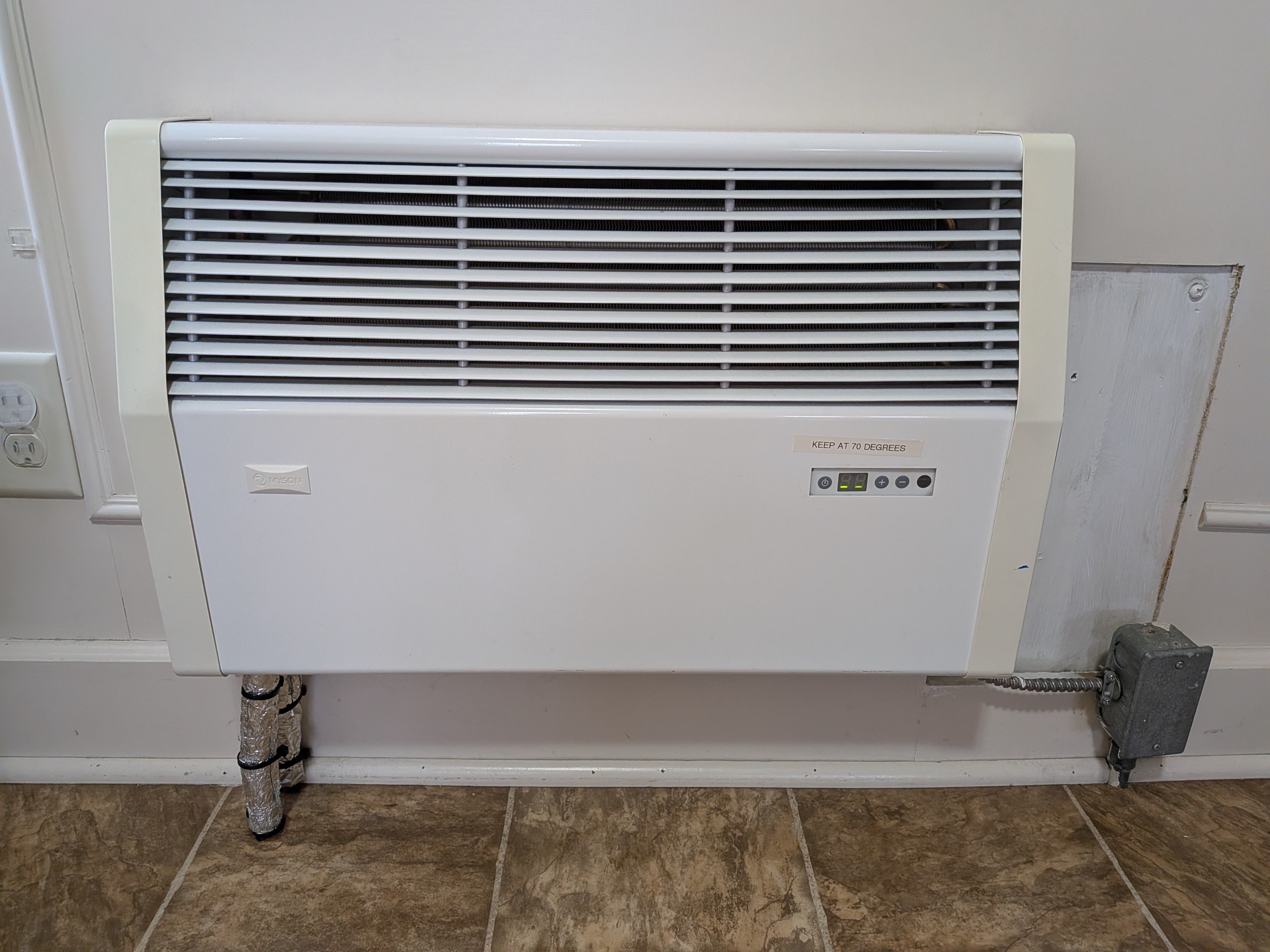

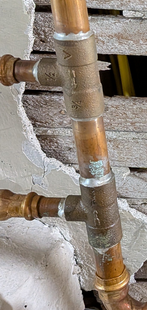

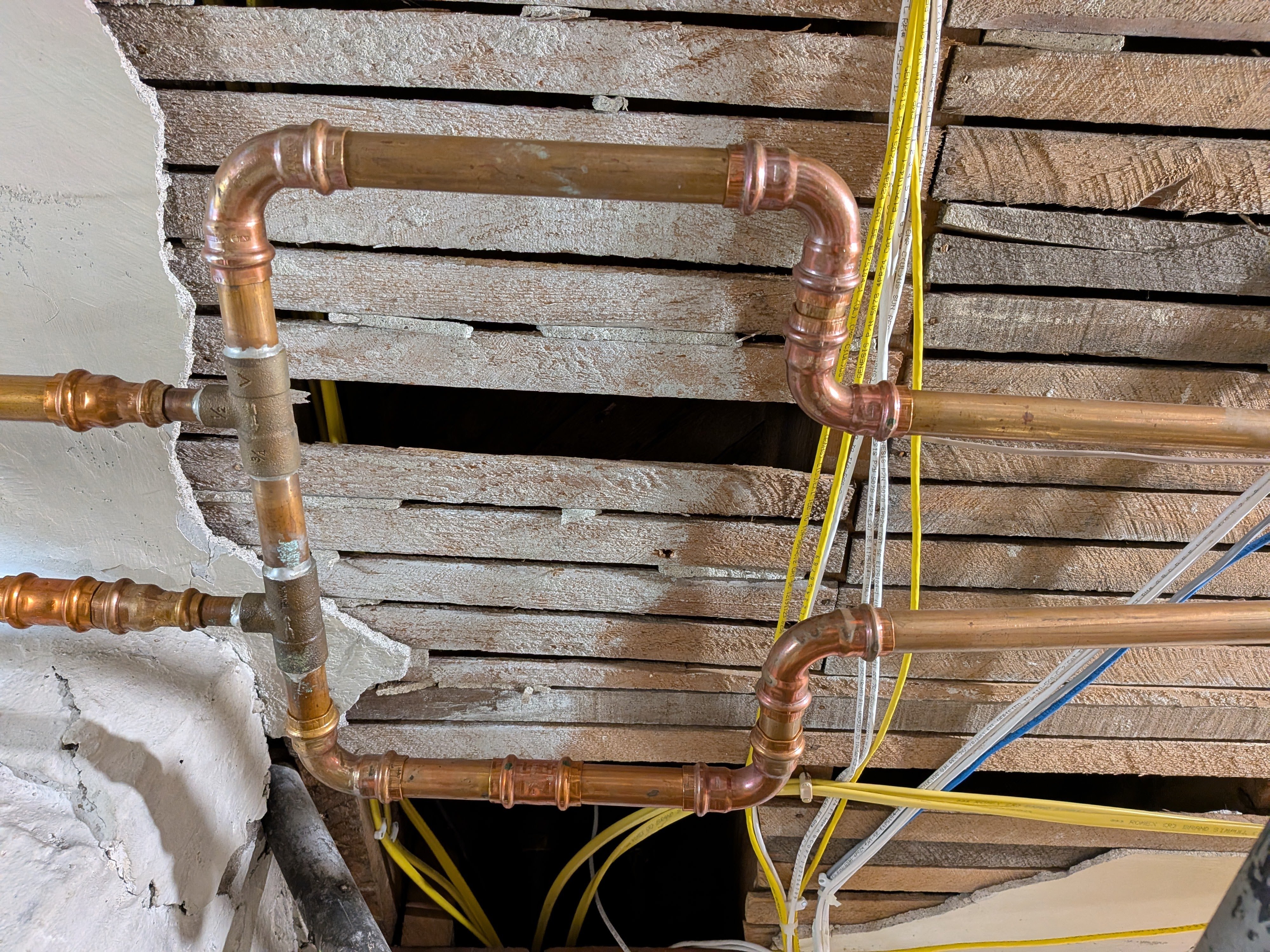

In the attached picture, what is the purpose of (what seems like) the unusual piping shown?
The pipes going to the left feed a wall mounted heating unit with the feed coming from the right. (I'll attach a photo of the wall unit and the piping)
What I'm wondering is, is there hot water always circulating in the piping going to the heater? Because those pipes running to left that feed it, run through an unheated crawl space and I wonder if they need to be insulated to prevent freezing. We wouldn't mind having that little bit of heat in that area that the pipes would give off if it was safe to not have them insulated.

    The unit shown must have its own water circulator in it. You have a primary secondary circuit. We would need to see the ends of both sets of pipes to see exactly what is going on. I am assuming the pipes on the left in the second photo go to the wall unit.

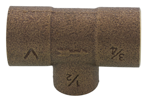

    Looks like two MonoFlo Tees to me.

    the unit heater's coil is likely always hot when the boiler is on and it regulates temp by turning the blower on and off. monoflo needs to have constant flow in the main loop and the branch to keep flow in all the other branches.

    Okay so if there is in fact constant flow in the circuit going to the wall unit (yes those are the ones on the left) am I safe to assume there is little chance that they could freeze in a non heated crawl space that is partially open to the basement?

    The piping going to the left is a common monoflow piping arrangement. There should have been a lot more space between the tees. It is concerning because the pressure drop between the tee's is what allows some of the water to flow to the branches, hence the wall heater. Although the Tee's are installed with the arrows facing each other to maximize the pressure drop, the tee's being so close together might negate that. Only you as the homeowner can check that with the heating system on. You can feel if the hot water is moving.

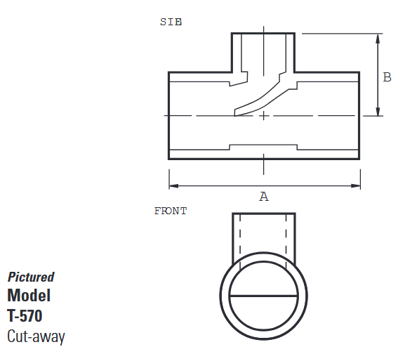

    the orifice in the monoflo tee is what splits the flow between the branch and the run. the resistance of the pipe is small compared to the orifice. you do need to have enough flow in the loop for the water to take both branches.

    It also depends on the type of heat emitter and how far the heat emitters are away from the monoflo tee's. Thats why you need to space them apart. Yes the orifices create the pressure drop but it has to be greater than the combined piping of the supply and return and the emitter. By spacing them your allowing additional pressure drop in the main. This increases the flow thru the branches. Monoflo tees were designed with radiators in mind and they still wanted separation as wide as the radiators.

    the tee partitions the main in to 2 sections. it would be a lot easier to understand if they main section of the tee were also smaller. the same thing could be down with a tee with 1 run the size of the main and the other run and the branch smaller. if you have a very restrictive emitter like a serpentine unit heater or certain kickspace heaters or certain panel radiators it isn't going to work but otherwise your problems are likely not enough flow in the main to make more flow than what what wants to flow through the reduced main alone or piping that isn't arranged to allow you to get the air our. just calculating the flow you need to move the btus you need to move at 20f delta won't do it for monoflo, you have to think about the pipe sizes and velocity. a problem with one emitter, either restricted flow through the emitter branch or a backward tee somewhere could cause some or all of the other parts of the system to not have enough flow to heat the emitter.
