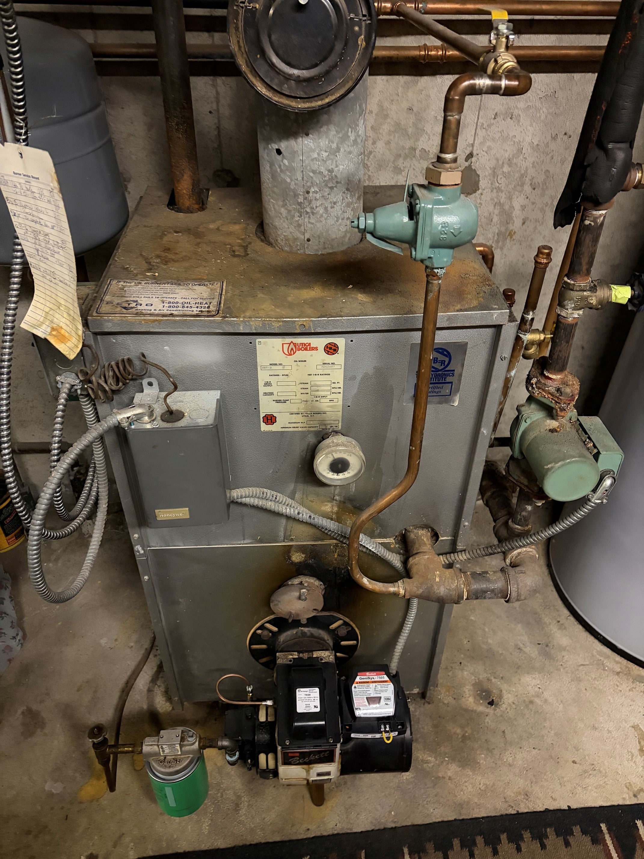

I have a few questions I'm hoping you guys can help with.
I'm considering leaving my very large oil-provider and looking into service contracts.
I'm in Suffolk County on LI and have a ~40 year old Utica OBT-3O which I believe is a dry-base boiler.

    Steamhead Posts: 19,007
    Either is a good choice.
    Regarding your present boiler- OK, it's older, but if it's the one I'm thinking of, it's built like a tank. Look at the return line from the radiators and see where it connects to the boiler- if it connects at the very bottom it's a wet-base (or at least wet-leg) unit. If it connects above the firebox, it's dry-base.
    Also, what burner is on it?
    Post some pics if you can.

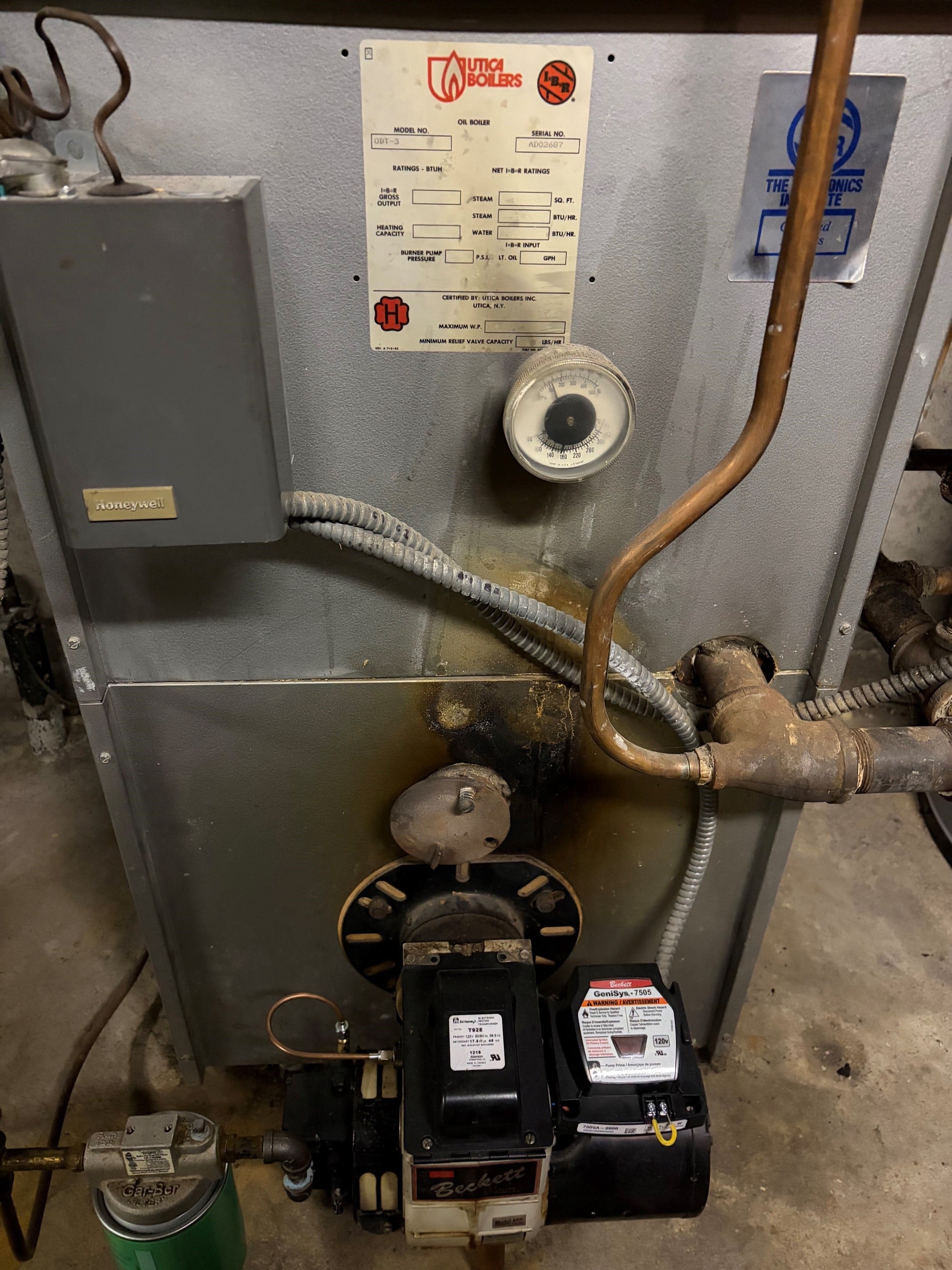

    charlie123 Posts: 76
    @Steamhead, let me know if these help, or I'll take another. I was told these burn out in the back but the back seems fine, the front looks a little tired but I was told the chamber is in good shape.
    EBEBRATT-Ed Posts: 21,328
    That is a dry base boiler.
    Yes, they can burn out the back but they don't have to.
    The reason they burn out the back is when the combustion chamber breaks down and needs replacement and if that is ignored they will burn out IMHO.
    It's because most "techs" will not replace a combustion chamber because it is a dirty job. They would rather sell a new boiler.
    Yup, dry base. It wasn't the one I was thinking of.
    I see lots of discoloration around the inspection port above the burner. When was the last time the top was removed and the baffles removed to clean the tubes? If they aren't doing that, they're simply taking your money.

    Thanks for the guidance, I called and there's no indication that they took this apart last year or even looked, so unless the record shows that this was done a year or two ago and it only needs to be done every few years, I'm guessing that this isn't part of their scope. I'm sure if I asked you the same question it would be clear from your reply that this is something that you do, they were kinda vague.
    Is this something that should be done every year? Also, do you have any thoughts about the water/scale issue?
